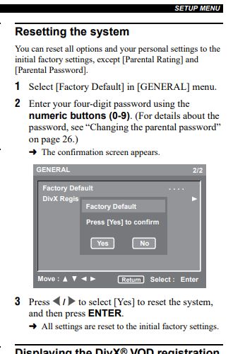

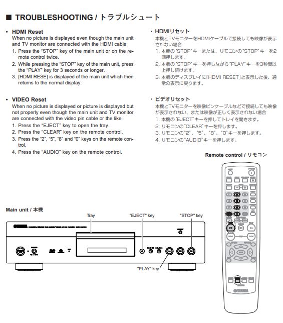

This may help.
Thank you. I have already tried resetting HDMI without any effect. For a while, it blinks the text "HDMI RESET," but nothing happens. Unfortunately, I cannot reset the device as shown in the first picture. This operation requires a remote controller, which my device does not detect.

Maybe cycle through the TV HDMI resolution settings as the player may not be on HDMI Auto. Is there a video signal via Composite or Component?
