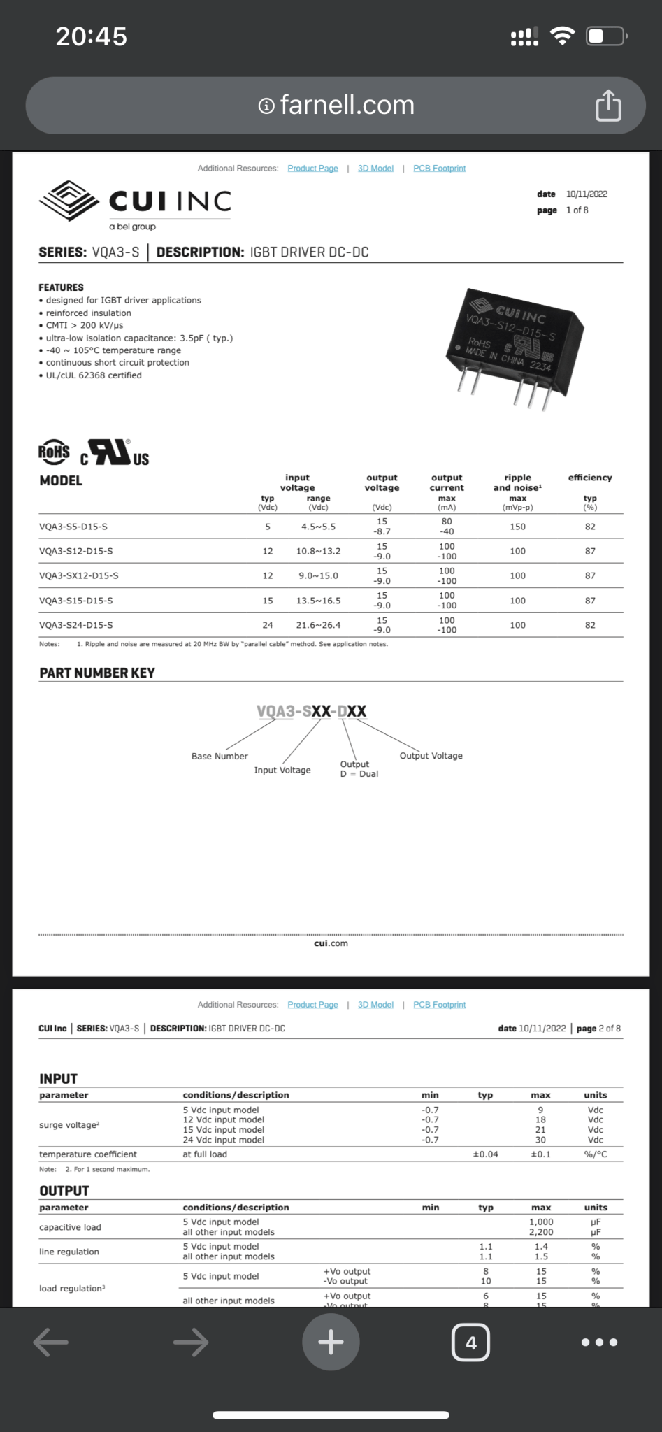

When I tried Sen with SMPS there wasn’t any mains hum, only switching noise. So I think the problem wasn’t magnetic coupling but that the isolation capacitance of the SMPS was too high. The isolation capacitance of those DC-DC converters is 10x lower than the JFET input capacitance. I think it has a good chance of working. The ripple and noise is quite high though so it might need to be cleaned up a bit perhaps. That isolation capacitance and the gate capacitance are the only ways the DAC current can differ from the current through the IV resistor right? It seems to me any junk from the DC-DC converter should end up down around the level of the harmonic distortion.
Min order quantity is 25 and lead time 78 days. It would be a £215 experiment.
I’m not in a hurry to do this but it’s still cheaper than replacing the 4 sets of batteries I have so I may try eventually.
I thought I could run them all off one set of batteries so I could still turn off the mains power inside the box which might help a bit.
I was looking at Farnell. I can order 4 from Mouser. I wanted sx12 which has a wider input voltage range more suitable for running from my batteries. That one is on back order so there will still be a wait.
£50.34 for 5 from Mouser including delivery. I have ordered and will have a go. I’m pretty busy though. It may take a while.

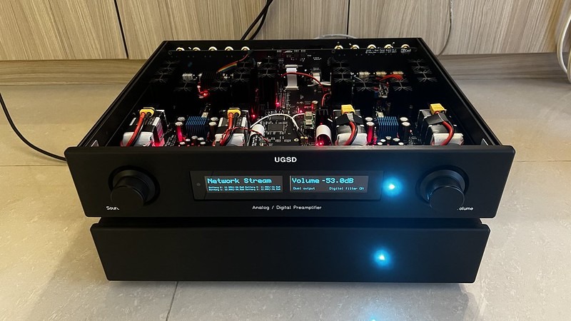

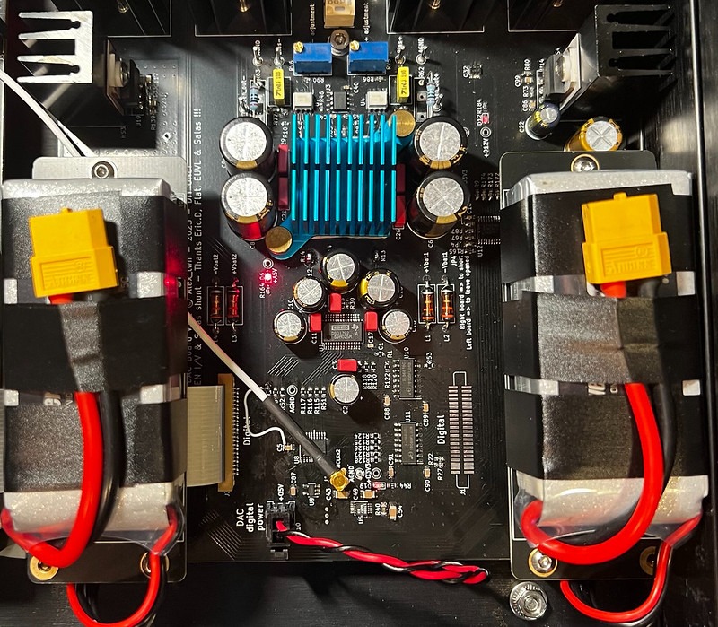

I forgot to give the latest updates on my side here but I completed my A/D preamp based on DSD1792A and using the SEN as IV converter.
It works beautifully, very low distortion and more important, the "old" DSD1792A with SEN sounds superb.
It is based on 2SK2145 paired (below the blue heatsink), 2x LiPo 3S and a servo to null the DAC DC current (a bit tricky to design the right one adding very low distortion level).
I have other JFET to try that gives in simulation even better distortion level than the 2SK2145, I'll update on this later.
Thanks so much again to EUVL and the few contributors here with excellent knowledge.
