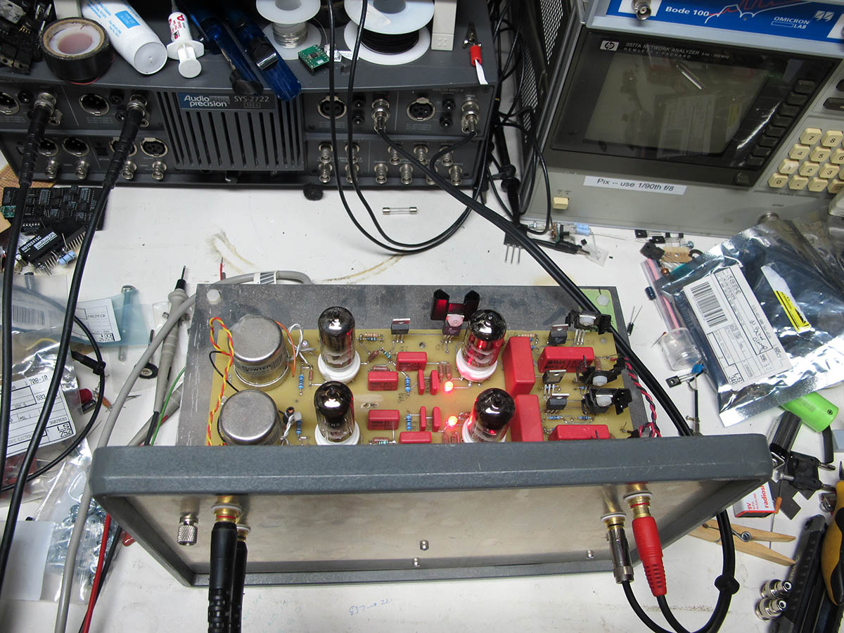

Le voila
Why, silly hare, are you fleeing from the fierce jaws of the lion now grown tame?

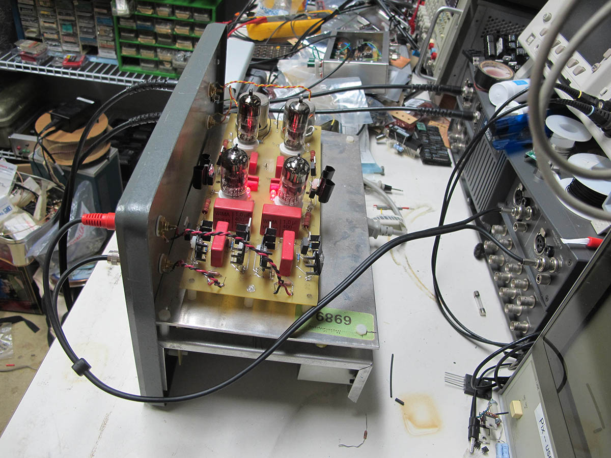

Nice!!
Looks like you laid out the board slightly differently than me, but used the same partitioning (amp and CCSs on one board, power supplies on another). Is the power stuff on the bottom side of the chassis? Do you have the raw supply in a separate box?

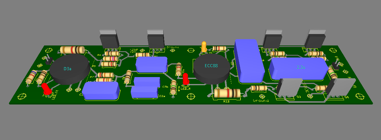

I would redo the boards -- with each channel on a separate pcb:

Why is that? Channel separation, or having exactly the same arrangement of parts?

Less expensive. Less clumsy organization of DMosfet heat sinks.
