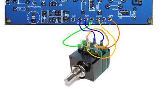

Pic. 1
As you can see – that’s pic of a plain ole potentiometer. The Optical Volume Control is however, not made physically of one resistor, with a contact track exposed to a wiper, but from two variable resistors pictured as this:
Pic. 2
These two variable pots are ganged in a way that, while the series one is decreasing in value, the shunt one is increasing in value. To complicate/or simplify things further, imagine that the pots are shaftless (funny term, isn’t it?) and that these two resistors are light-dependent, or better defined, their resistance is inversely proportional to amount of light to which they are exposed. So the pic can look something like this:

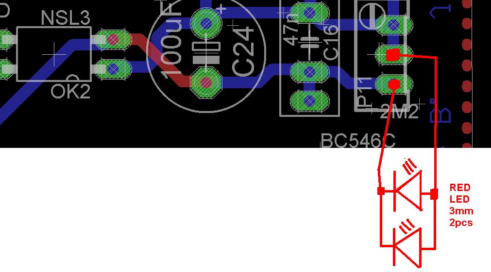

Pic. 3
Assuming that we are still following the same law of decrease/increase of series/shunt resistance, it looks that we have gained a couple of things.
1. We have contactless variable resistance, which means that we have succeeded in the first factor needed for losslessness, hehe...
2. We need a proper circuit to make these LEDs behave in the way we want them to exactly. But number two actually has a hidden benefit. We must make some unnecessarily complicated circuit blocks just to preserve the impression that we are still Macho, doing things which our Chicks really aren’t able to understand. The fact that they aren’t even slightly interested in understanding our toyz ‘n’ gamz isn’t part of the prospective of this clever document.

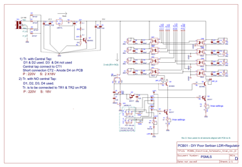

But we boyz from Serbian DiyA, had an idea how to ensure the good behavior of our tiny LDRs with current sources, which must be of course, both adjustable and variable. For the schematic look at “PCB01 Schematic” at the end of this document.
As you can see, we decided to use the old fashioned approach, without the use of fancy add-ons such as microprocessors etc. A pot is still the main adjusting part, but this time we use the cheapest 2x10K linear one, and the audio signal is nowhere near it. Its role is to handle variable voltages, which are steering adjustable Current Sources.
For your convenience, the dedicated power supply schematic is in upper left of schematic sheet. Of course both the PSU and the steering circuit are on the same pcb, accidentally named as PCB01. The supply schematic is pretty self explanatory. Center tapped or non CT transformer, a few diodes, an LM317 as a 70mA CCS, and a few Zener diodes working as a reference for the shunt Darlington on the output. Exact output voltage is the sum of Zener voltages plus 2x the Vbe of Darlington (that’s 1V35). 15V is drawn on the schematic, but who cares if we have 1V35 more...
So, now go back to the exact LDR circuit schematic. If you’re looking at these pages on your ‘puter screen, now is the time to either print these two schematics, or use two screens. Do whatever you wish if you are not ready to jump back and forth, reading text and looking at schematics. Here is what you will discover:
-Q6, along with LED1 and VR1 form a reference voltage string, with 3mA of current flowing through. We have available there two fine voltage points, 2V5 on top of VR1, and ~ 2V more on top of LED1 .
-We are using a reference voltage of 2V5 to inject it into our main Governor (Hasta La Vista - ring a bell ?) Pot itself, so we have nice clean and steady DC voltage to play with. Q3 is any small N type Darlington (or even two small signal diodes connected in series if you’re a cheapskate ) and is nothing other than a convenient voltage shifter. Using it there is to try to null TempCo of the same type Darlingtons used as control elements in two main Current Sources (look down) .
-So, we have clean and steady voltage (2V5 less two Vbe) on top of Pot1. Now look at the vertical string starting from 15V, made of LEDS in 4 LDRs (OK7,5,3,1), closed jumper JMP01, and dedicated Current Source, CS made of Q1 steered with voltage from POT01, cleverly cascoded (by Mighty ZM) with Q4. That one, Q4, is biased from the previously mentioned voltage tap on top of LED1. That vertical string is dedicated to series LDRs.
-I’m clever, so I’ll paste the above paragraph here for the right vertical string, just changing the appropriate part labels. So now look at the vertical string starting from 15V, made of LEDS in 4 LDRs (OK8,6,4,2), closed jumper JMP02, and dedicated Current Source, CS made of Q2 (steered with voltage from POT02), cleverly cascoded (by Mighty ZM) with Q5 . That one, Q5, is biased from the previously mentioned voltage tap on top of LED1. That vertical string is dedicated to shunt LDRs.
Idea is, with the main pot at zero (7 O’clock) position, minimum current is flowing through the left series LDR LED string (on top of Q1) so the mating LD Resistors have max resistance. At the same time, max current is flowing through the right shunt LDR LED string (on top of Q2 ) so the mating LD Resistors have minimum resistance. The result is that our poor tone signal is attenuated maximally.
That crossed behavior is achieved with a crossed connection of reference voltage to a two section of main pot, while the reference voltage is connected to the “start” end of POT02, and it’s connected to “end” end of POT01. Incidentally, at the 12 O’Clock position of the main pot these two voltages coming on both wipers must be same. But we are clever, so we introduce a “fake log law” inducing resistor in each section, R200 and R300. That’s an old trick, to use a linear pot because the section matching of them is better than with cheapskate class logs. Put a few resistors from wiper to ground and Voila!, we have an Audiophool pot for pocket money, or we hope we do at least .... where’s da :devil: smiley when a man needs it ?

The electrolytic caps and block caps, connected in parallel with LDR LEDs, are there for cleaning up any possible residual noise in the PSU. Use them or not, your choice, they aren’t critical at all.
The P4-P11, 2M2 trimpots are there just in case that the LDRs aren’t tightly matched. If you have tightly matched LDRs you don’t need them at all. Later in this text I’ll explain a better cure, in case you feel or measure that some section is slightly weaker than another.

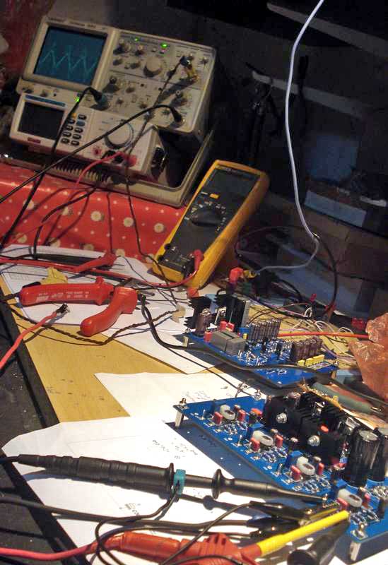

OK, shall we power up the bloody thing(s)? Naah, first we must be sure that you didn’t mess up a few things regarding LDR orientation. Lets look at some nice pics, brought to you courtesy of spavleski. See here:

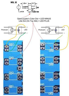

Be careful! The short (LED) legs are fragile. Even if you have a dot on the LDR body, re-check the dot position with the diode tester on your DVM. The rest of the picture is self–explanatory .
LDR’s are in opposite position in right and left columns. Nota Bene: LDR’s are drawn as photo-transistors on our schematic (now you’re saying before I can: “on end of document, PCB01 Schematic") But don’t worry, the LED’s are drawn the right way.
Its now time to ask you – Did you wire that funny pot in this way?
Now is also the time, assuming that you checked twice how the LDR’s are positioned and soldered, and that you already soldered all the other parts (including those funny PC-like jumpers JMP01 and JMP02). There is no need to mount any heatsink now on IC1 and Q7, just check their temperature later with a finger. Warm is OK, if hot then mount some small heatsink of any sort you have in your parts drawer.
Ready for powering up PCB01? Do not connect the transformer leads to PCB02. At this time we need it just for PCB01.

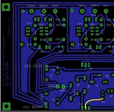

There is one slight omission in PCB02 ; you must solder a wire bridge between two bottom pads – look at the picture – drawn as a yellow line. Its on the rev.B pcb, and we are going to solve that mistake in later pcb issues. Then this note won’t be needed, along with this pic:
You don’t need heatsinks on LM’s and Darlingtons to start. Check later, as I mentioned before. Warm is OK, but if hot mount any small heatsink you have. Pads for buffer Jfets are oriented to ensure a face to pace position of little critters. Feel free to put a small blob of thermal goo between them and tie them with plastic wire tie or even small piece of heatshrink.

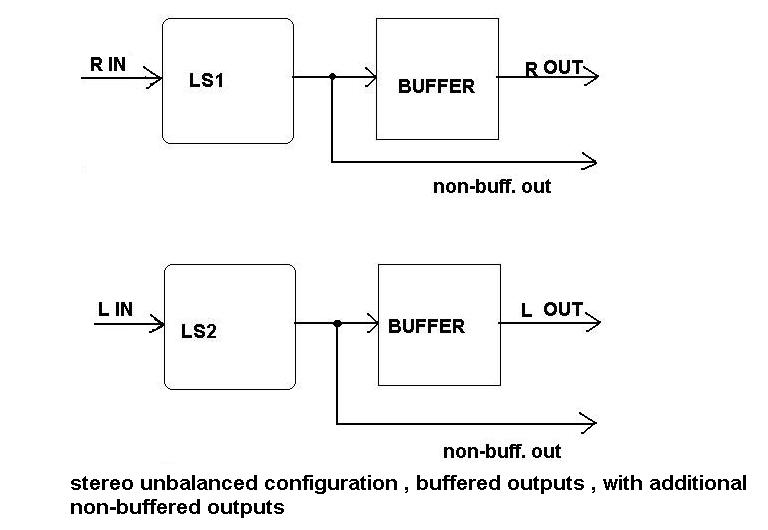

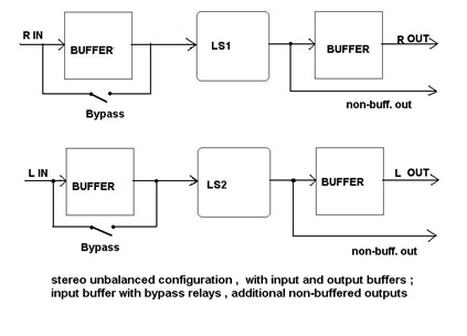

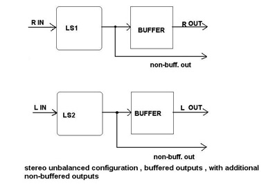

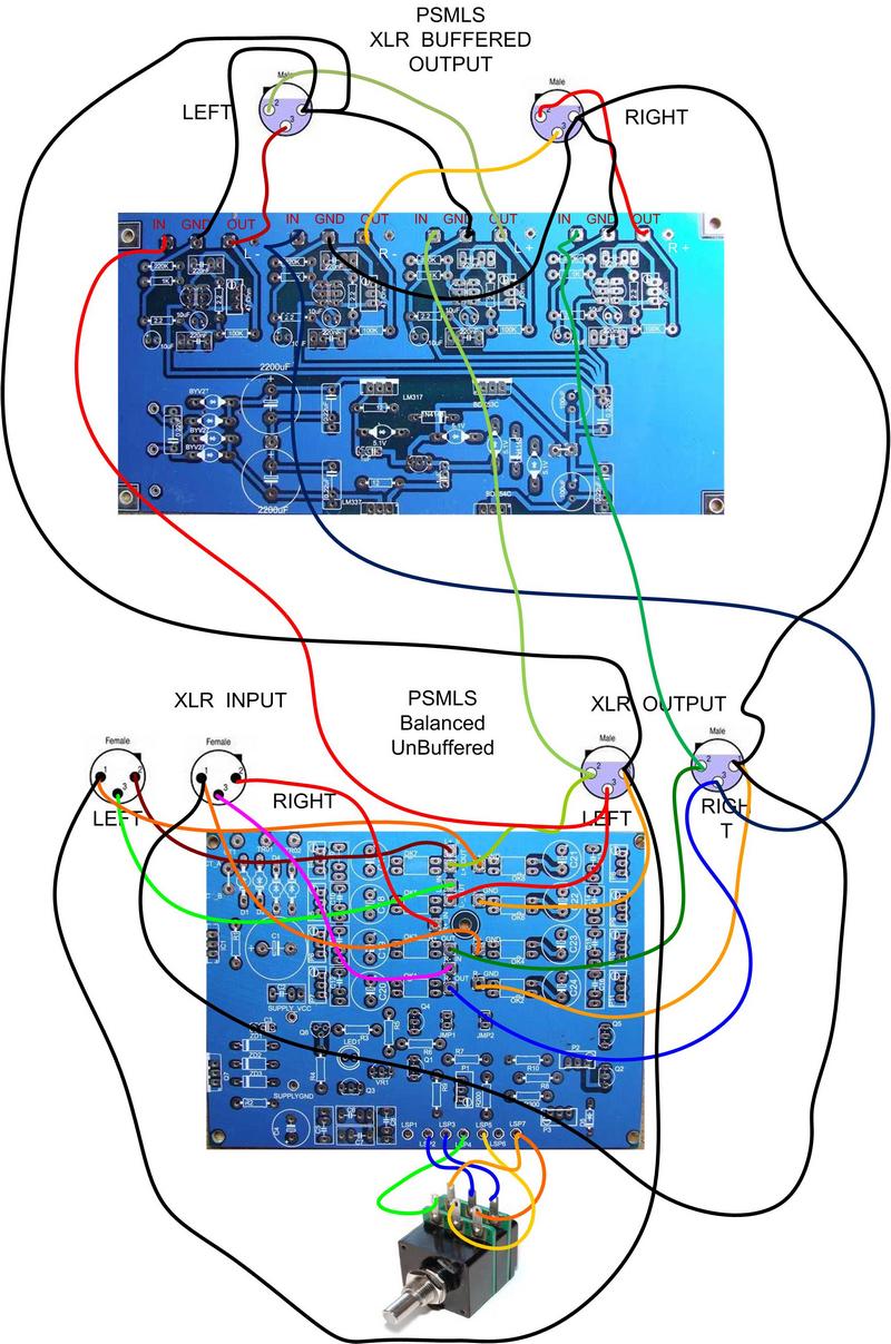

First – full blast ......... nope, just in case, I’ll start with simplest configuration:
It’s pretty obvious that this configuration is for plain stereo attenuation – two attenuator channels, two buffers. That means that each channel output is buffered. It’s handy to have spare pair of outputs so you can add an additional pair of RCA’s and feed them ditto from attenuator outputs, before the buffers.

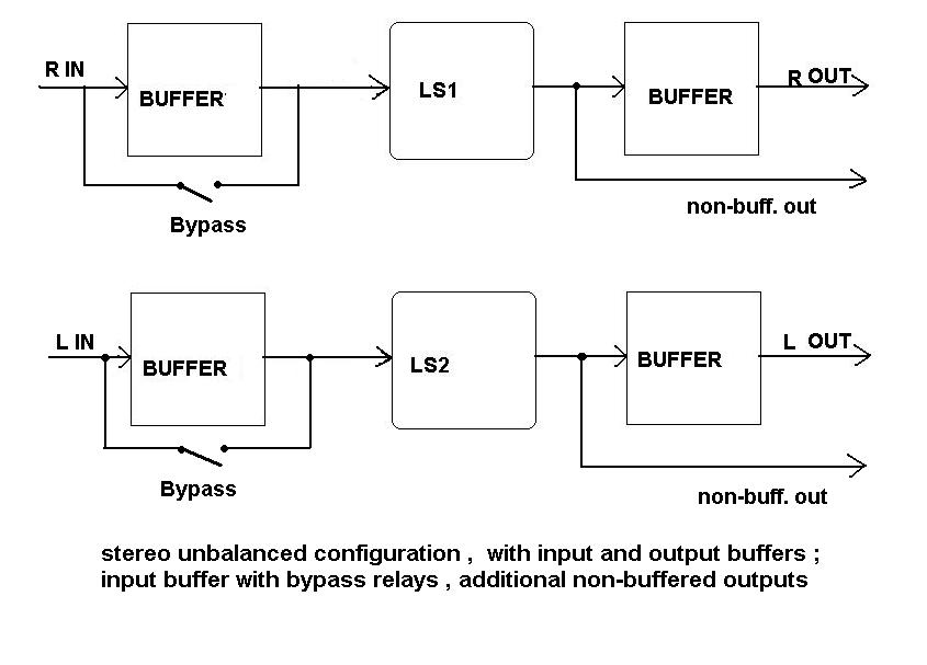

Next one is somewhat more complicated :
As you can see, two attenuator sections and four buffers. That way each of the stereo unbalanced channels is buffered on both the input and output. Same thinking applicable as in the previous configuration, you can mount an additional pair of RCAs and feed them pre-output buffers . You can also mount a small 2-deck toggle switch on the front panel and bypass the input buffers whenever you feel that’s wise in case that you have one source with enough muscles to drive the LS directly, and other sources that are weaker in driving capability. A toggle switch can be used to control a small relay, which will usually have better contacts than the switch itself, so it’s beneficial to use a relay as a bypass switch. You can steal a few dozens of mA for the relay from the raw PSU before the PCB01 reg. Be creative and find these points, or for a wiser/purist solution, make a small pcb with a tiny Graetz diode bridge and a small electrolytic cap, and put an adequate resistor in line with the relay coil. That way you’ll not pollute any part of the DC grid in the gadget.

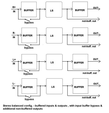

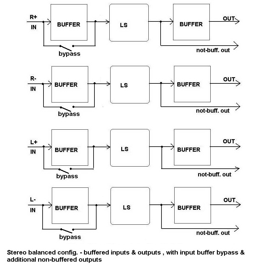

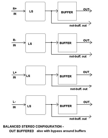

OK, the next one is the (in fact – almost) full blast configuration. A fully balanced attenuator , buffered on output. Look at this:
The picture is pretty self- explanatory, even without the text below
Now, just one final teaser ...... This is what I call full blast!:
You would need two PCB02 boards for that final configuration, and I firmly doubt that anyone needs that, or has the time and will to make it.

Of course – you can make a mix of XLR/RCA connectors on both ends, input and output, just like in this picture. And I presume that you must know how to wire and mix these two if you’re willing to make gadget like this one:
Be warned, this circuit isn’t any sort of balanced/unbalanced or unbalanced/balanced converter. You can use it balanced in/unbalanced out (or vice versa) but you must tie pins 1&3 on the empty XLR while using the adjacent RCA. And yes, I just recently remembered the XLR pin outs, just in case you recently forgot:
Pin 1 – Ground
Pin 2 – Positive Leg
Pin 3 – Negative Leg
Now I can presume that you have decided which arrangement is for you, that you read both the thread and this funny paper, that you wired all needed wires between the transformer, both PCBs, input selector (no, I can’t teach anyone how to wire the selector, hehe), and all input and output connectors, so we are ready for the final procedure.

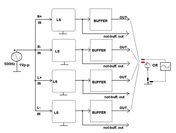

We need any sort of signal generator, set for ~ 500Hz and a DVM on AC voltage or a ‘scope. I’ll show block schematic for balanced stereo. If you’re using unbalanced stereo, just cover half of the schematic with blank paper. (if you are reading from a screen, tape paper on the screen hehe).
This procedure is brought to all of us by Mighty spavleski . OK – whazzat ?
Nothing other than a signal generator connected to ALL the hot inputs in parallel. Obviously, all input grounds are tied together. That way all 4 channels/sections are fed with the same signal. On right side, connect your AC meter, (either the DVM on AC or a ‘scope) to ground and to one output (HOT) at a time .
Step 1 – position main volume pot on 9 clock; measure Out 1 & write down, measure Out 2 & write down, measure Out 3 & write down, measure Out 4 & write down.
Step 2 - position main volume pot on 12 clock; measure Out 1 & write down, measure Out 2 & write down, measure Out 3 & write down, measure Out 4 & write down.
Step 3 - position main volume pot on 3 clock; measure Out 1 & write down, measure Out 2 & write down, measure Out 3 & write down, measure Out 4 & write down.
Step 4 - position main volume pot on 5 clock; measure Out 1 & write down, measure Out 2 & write down, measure Out 3 & write down, measure Out 4 & write down.
If you’re lucky, all values will be in 5% or even smaller bracket. If not, you have one beautiful trick as a weapon tnx to my clever engineer friend spavleski.

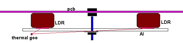

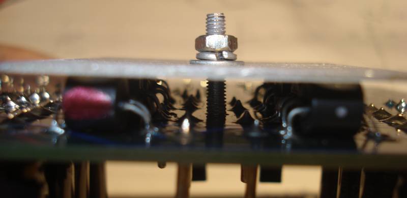

Final notes – to achieve the same thermal conditions for all LDRs, we prepared one nice 3mm hole ditto in center of LDR area. Look at these small pics :
