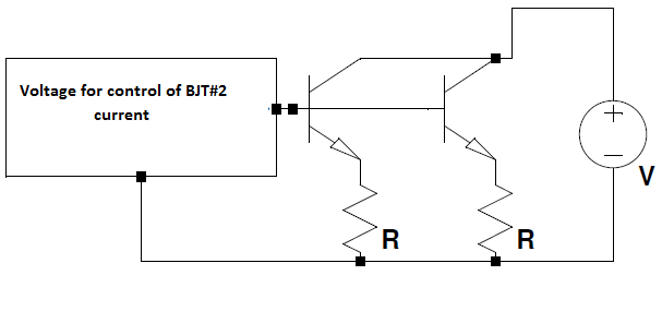

The goal is to find out how large the ballast resistors must be to prevent current runaway and to control "current hogging" to a given limit. Current hogging is a phenomenon with bipolar transistors when operated in parallel in which the hotter of the set draws more current than the cooler one(s) and so heats up even further. The fix is to put series resistors ("ballasts") in the emitter circuits (see the drawing), but I've not been able to find anything published that says how to calculate the value of the resistors.
The model is for two BJT transistors, with their collectors and bases commoned and their emitters summed through individual ballast resistors. You need to know what the process-variation-caused Vbe imbalance (in volts) is between the transistors, and how much imbalance (current hogging) you are willing to accept. Also, needed is the idle Vce voltage of the devices. You can also estimate the imbalance that would occur if the thermal resistance (from case to heatsink) is different fro the two devices.

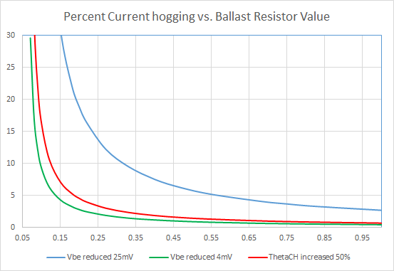

Attached is a graph of a situation I'm looking at with Vce~= 24V, Itotal = 2A, ThetaJC=0.83K/W, ThetaCH=0.25K/W. The y axis is "% hogging", the x axis is the value of R. The blue curve is for an assumed decrease of 25mV for Vbe of BJT#1. The green curve is for a decrease of 4mV for Vbe of BJT#1. In the blue and green curves, I hand-adjusted the target Itotal value to keep the calculated Itotal near 2A for all R values. The red curve is for an assumed increase of 50% for the thermal resistance of the Case to Heatsink for BJT#1 (might be about right for too much grease or a lump?). No target Itotal tweak needed for the red curve.
I picked the "4mV" value as something that might be practical matching for some 2SA1943N PNP transistors.
Hope someone finds this useful. (I did)
