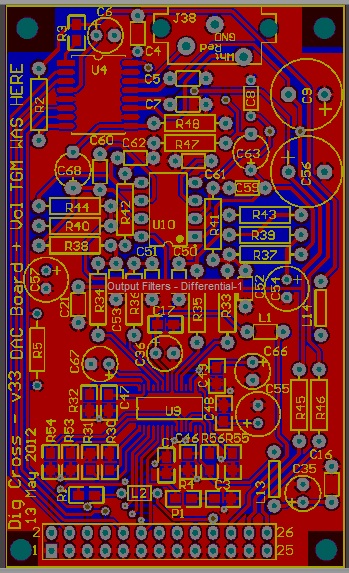

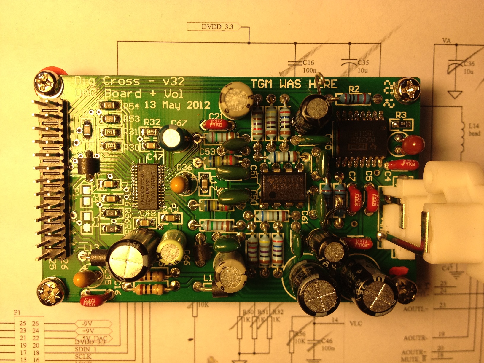

ID:	719Just finished set to work of the new DAC for the digitial crossover. This includes a PGA2320 programmable attenuator on the output of the CS4398 DAC.
This replaces the home made PCB thai I was using on the CS4398 output. I went the professionally made board mainly because PCBCART was able to deliver 16 of these to my house for $140, that includes tooling!!! The actual boards were like $3 or 4 each!
The quality of these baords is fine - though I must admit that I am not breaking any new ground in PCB technology here.
The board is only double sided - I thought about adding a seperate ground and power plance - but the routing density is so lot it would be crazy. The whole back side only has a handful of tracks on it - and is a ground plane in itself. The top side even has room for significant ground fill.
All the digital stuff is in between the connector and the DAC, with a few SPI lines up the left hand...

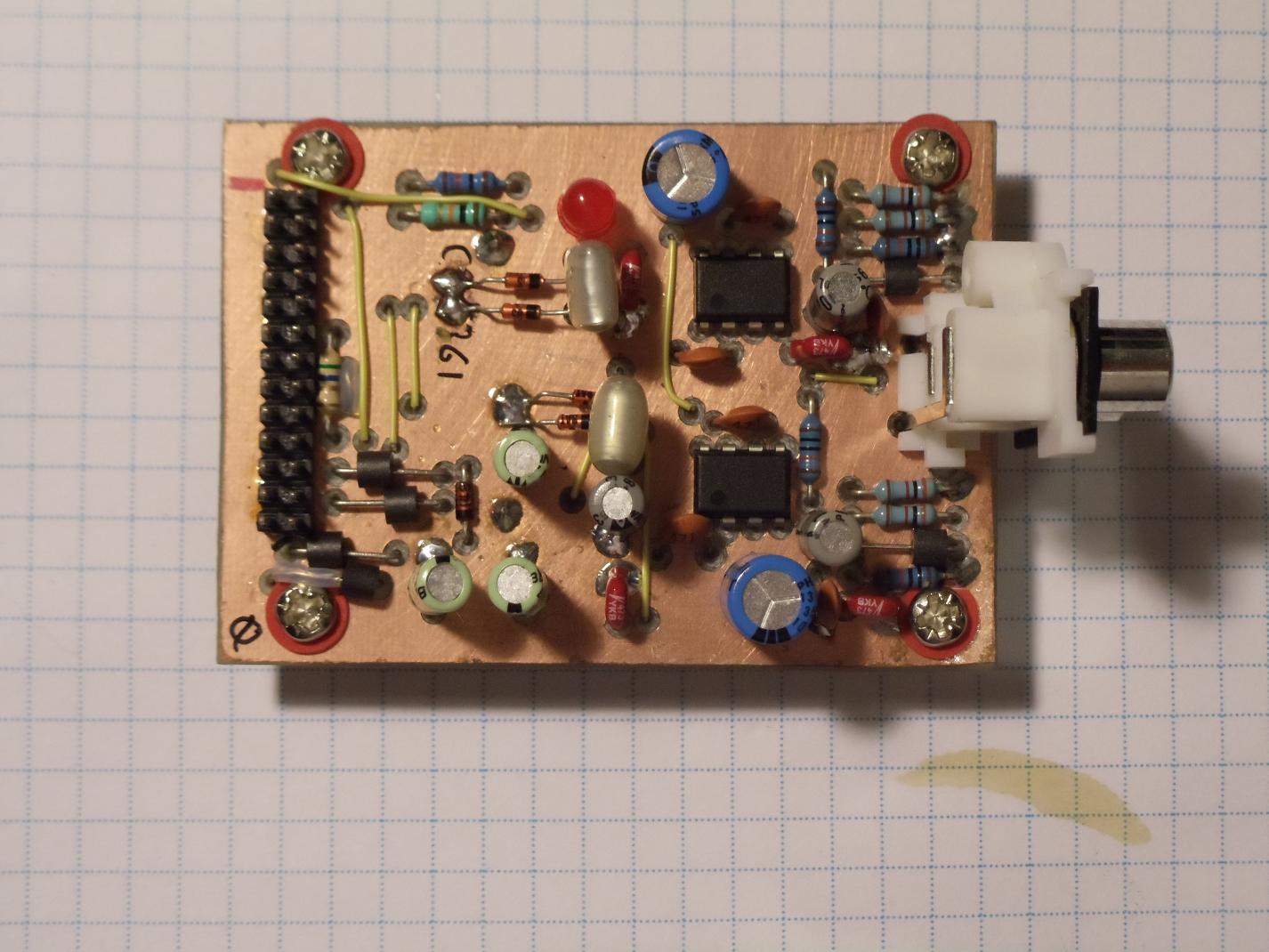

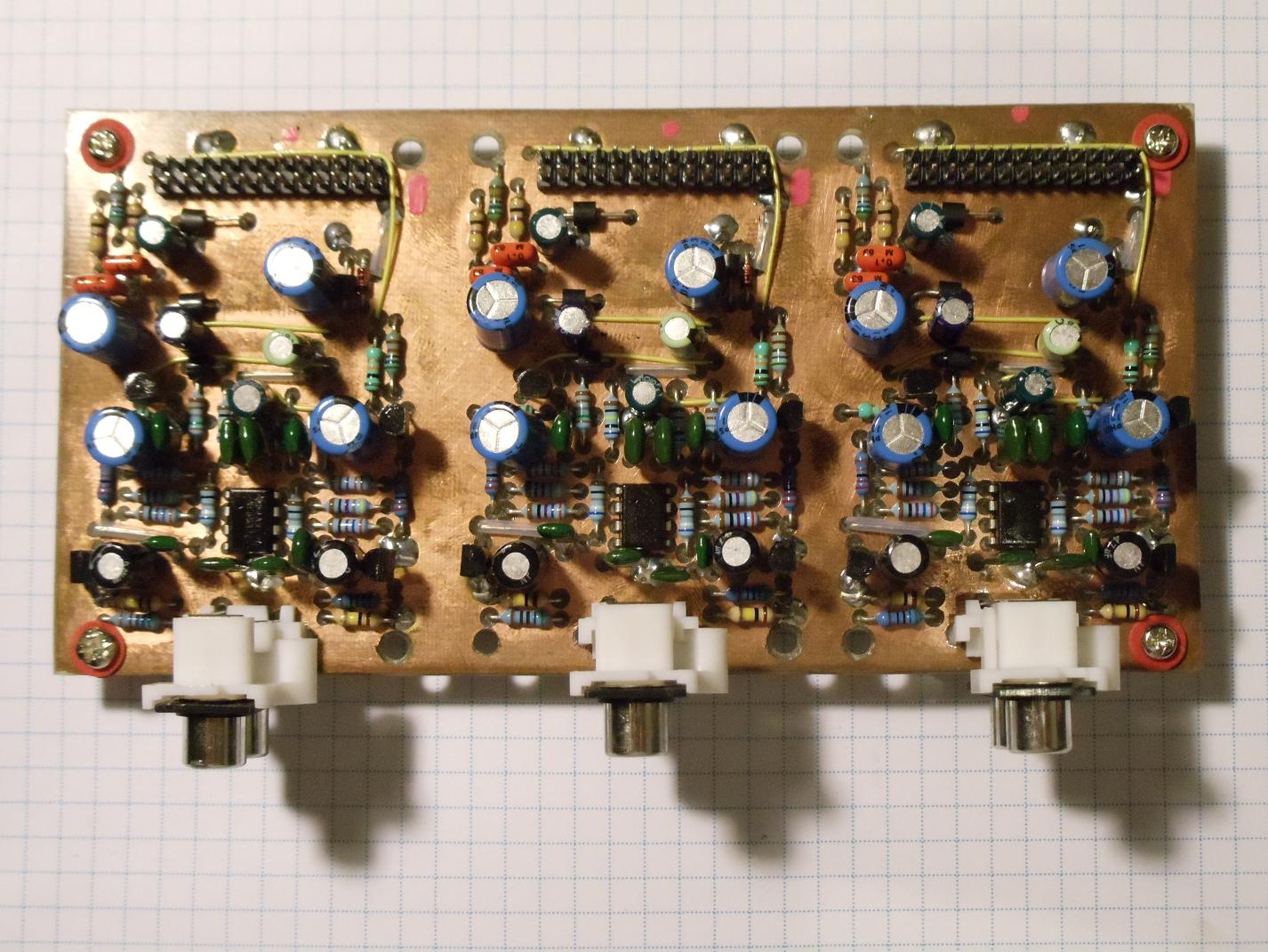

For my new DSP crossover I started with a simple CS4398 in the DAC output. even when I built the first boards I KNEW I would be going back to integrate a programmable attenuator.
Why didn't I just start with it? **** knows.
At lease with the modular approach all I had to do was respin my DAC board to include a PGA2320 along with the CS4398. I already had SPI to the board, sop I can sneakily use these lines for the PGA 2320, as the CS4398 is in hard wired...

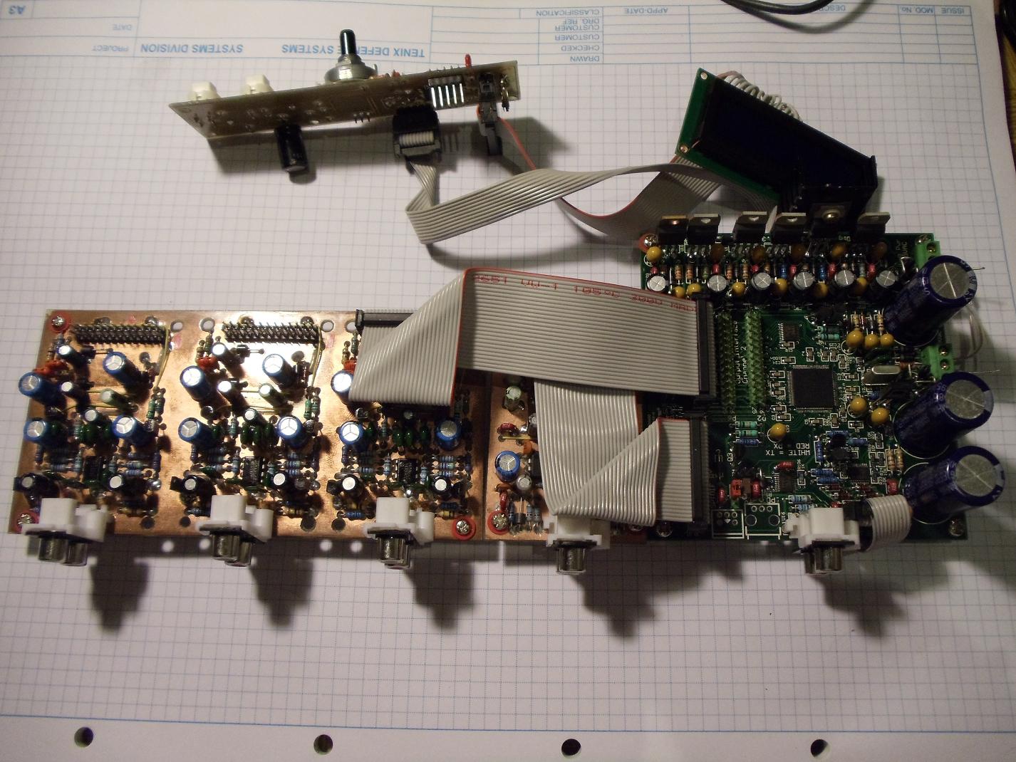

Well, it has been a few years since I built my last digital crossover - like six I think.
It is not that I was planning to do this - but a conversation with someone about my seemingly modest choice of the AD1941 DSP chip for my old crossover made me look at what else Analog Devices are offering.
The ADAU1442 is on the surface a very similar chip to the AD1940, but it has a lot more integrated into it, and offers significantly greater capacity.
So I set about designing a new crossover that used this, and also addressed a few of the shortcomings of my original design.
The goals were broadly:
- A modular DSP based crossover
- That provides a standard interface for the ADC
- That provides a standard interface for the DAC
- That includes SPDIF in and out
- That anybody can design digitisers and dacs for - no code level drivers built in, though the interface does ALLOW for SPI control of these
- That is controlled from a simple...

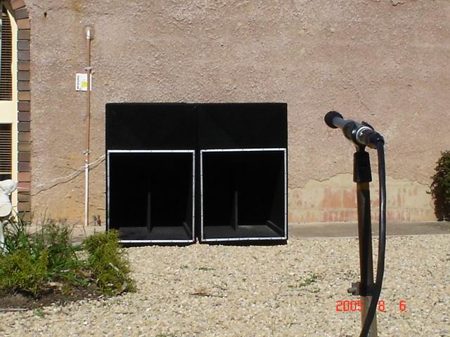

First is a pair of 25Hz horn subs I used to have - used 18inch p.audio drivers, placed facing one another along a wall to form part of the horn and achieve adequate mouth area for the 25Hz cutoff.
Efficiency was well over 100dB/w/m.
