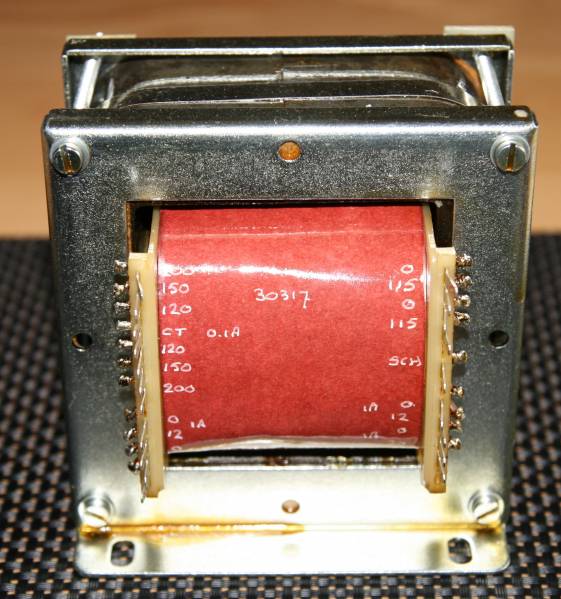

To make a real "Reference Project" you should think about each stage from the start to the end.
So letīs look to the start...
The Main Transformer
Custom build on double C-Cores
Input:
115V
0
0
115V
So 115V & 230 V is possible.
Output:
200V
150V
120V
0
120V
150V
200V
for various B+ of a tube output stage, including a center tap for a tube rectifier.
20V
salas shunt regulator input for the -15V line of the TDA1541A
12V
salas shunt regulator input for the -5V line of the TDA1541A
12V
salas shunt regulator input for the +5V line of the TDA1541A
12V
salas shunt regulator input for the +5V line of additional digital parts
