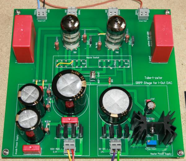

It´s a SRPP Tube-Stage with onboard B+ & Heater PSU.
I added my Heater switch circuit, so you could use the Russian 6N2P, 6N1P or the 12AX7/ECC83, 12AU7/ECC82 ect. on the same socket. |
