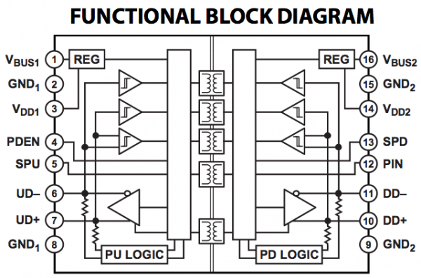

Here you see the internal schematic of the USB Isolator IC.
The uplink side (PC) is completely isolated from the downlink side (X2).
