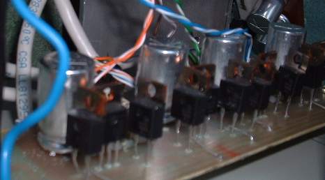

How do I attach more than one picture?

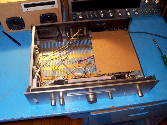

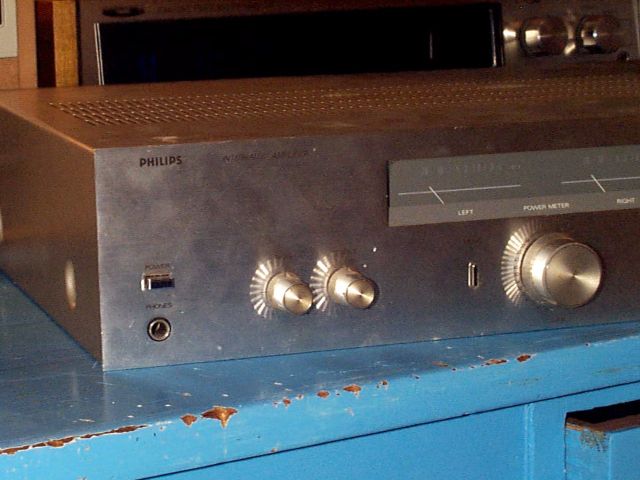

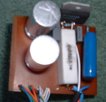

Skinnyboy, I did just what you're doing, but to a Sony amp. I had to cut down the supply rails a bit (using two transistors), but all in all it was really easy to lift out the old amps and put in the new ones. I used Rod's PCBs, which I highly recommended. I had to increase the gain a bit to more closely match the old amp, but otherwise no change to Rod's circuit.
