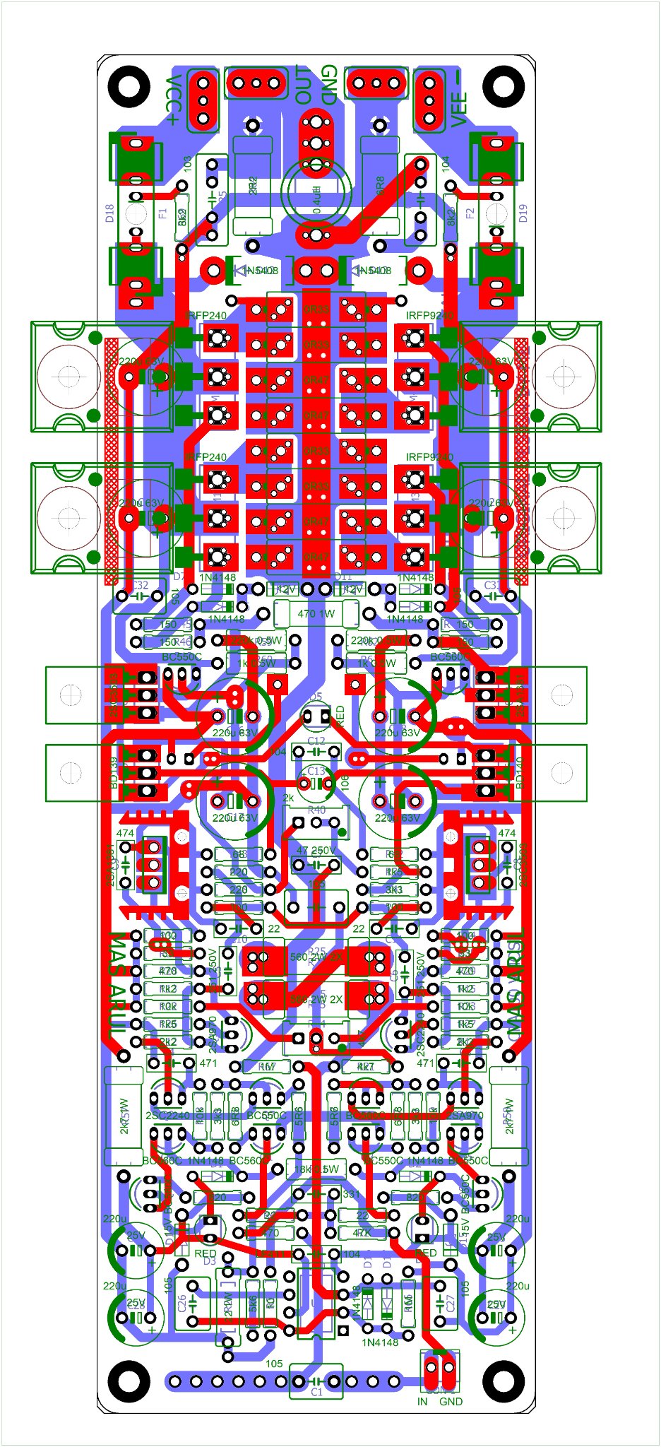

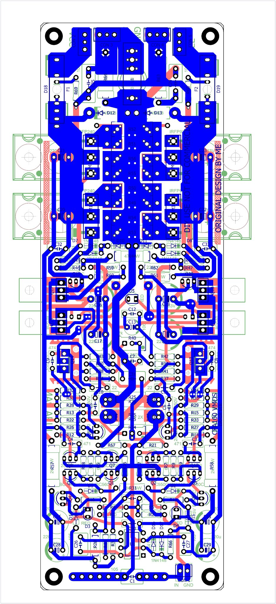

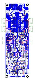

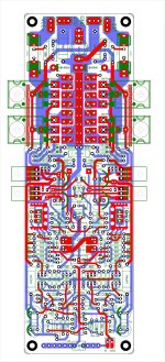

100W CFA with mosFET OPS
  • PSregulator-BJT-c-allBC rev 1_4.sch
  • 100W-CFA-VMOSFET-1.4-sch.sch
  • 100W CFA 1-1.4 gerbers.zip
  • PSR gerbers-ds-1_4.zip
  • BOM 100W CFA MOSFET 1.4.txt
  • BOM PS Regulator BJT-1.4.txt
Reactions: 2 users

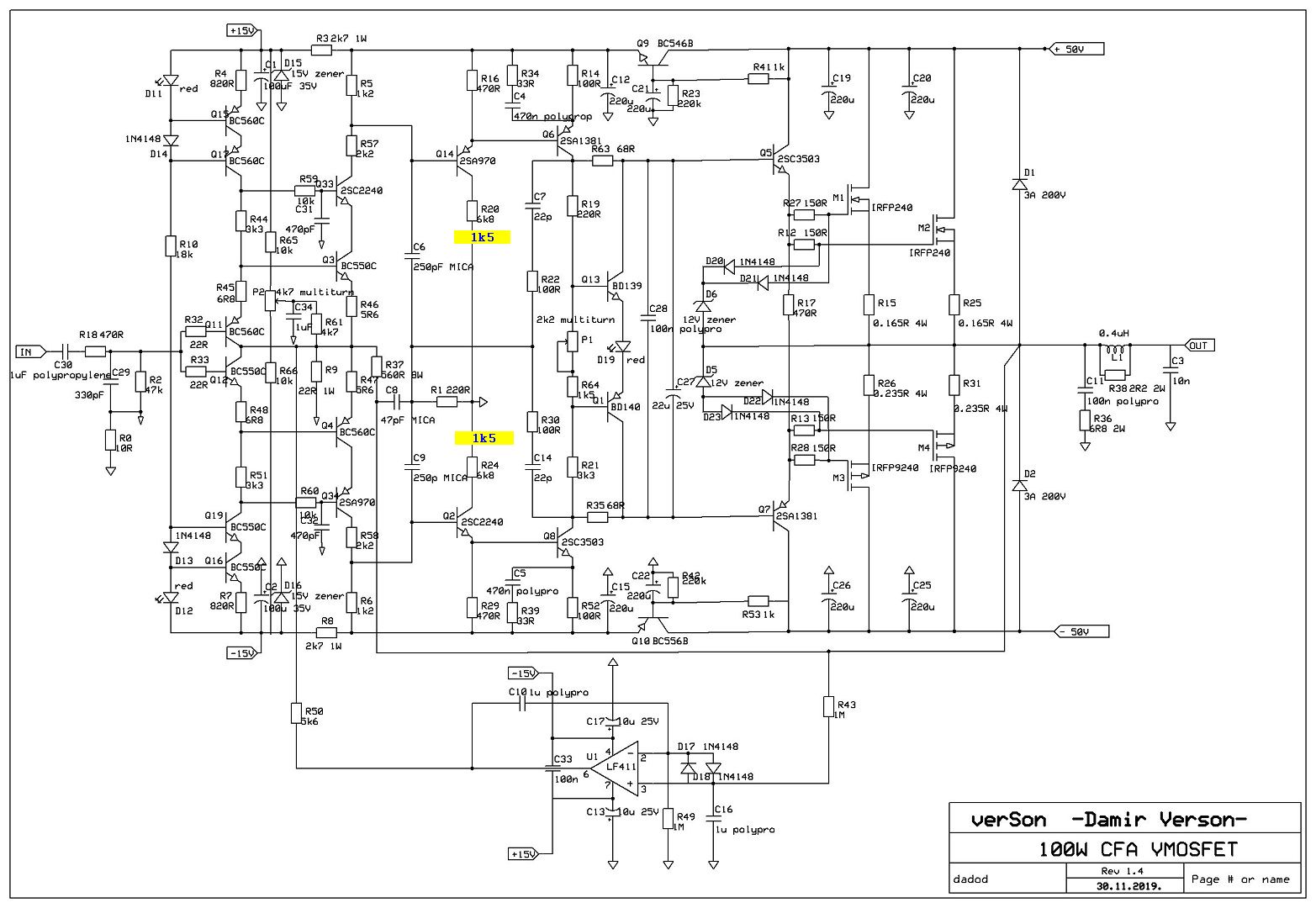

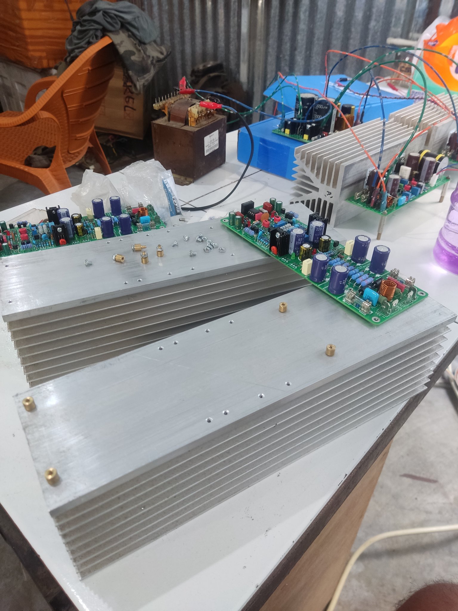

Here is the amp JPG schematic with new R20 and R24 values.

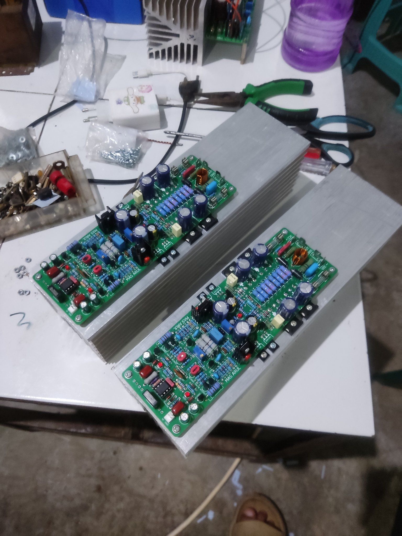

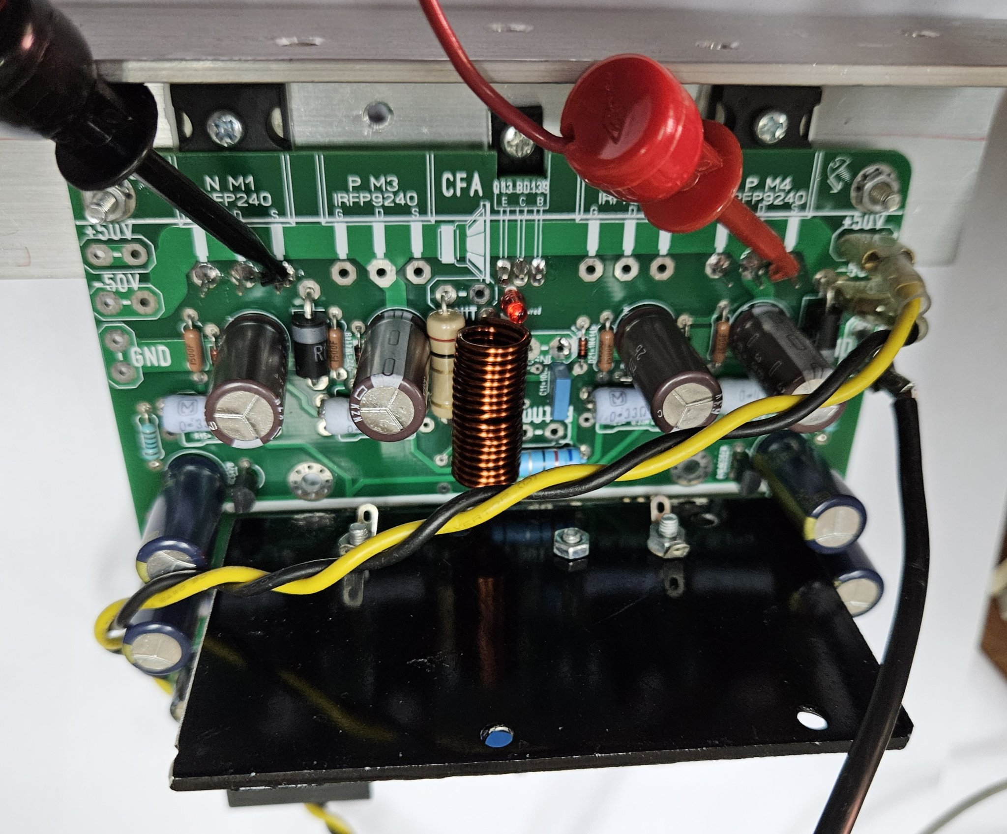

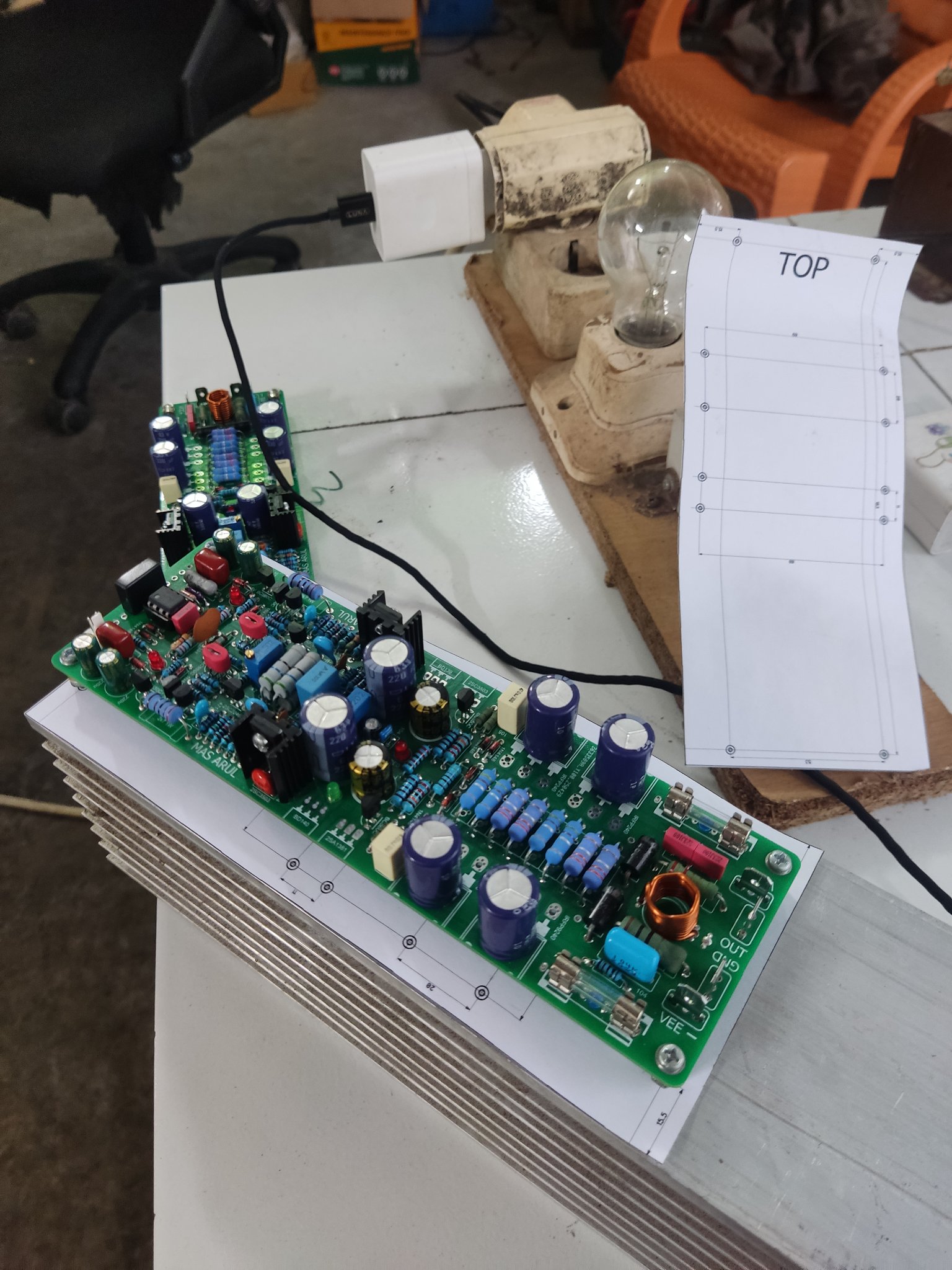

Ok I have time before I'm away, here is a finished 100w CFA. Excellent sound, CFA is growing on me. Supply is unregulated +/-50vdc, bias is around 100mA, VAS current is a bit high at 10mA VAS trs are heating up and current through R5 R6 are around 2mA.
