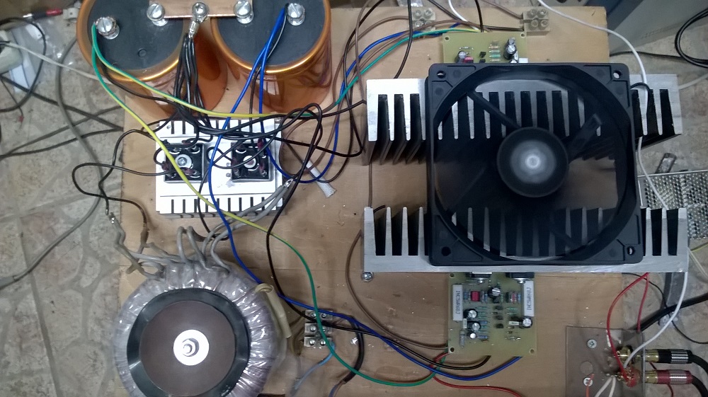

I've completed my AX6 build using the 2N3055h, and it works, whether it works properly is up for debate, but I was chuffed to bits (in English that translates to "very pleased ") to hear result of my efforts. All the more pleasing as it was through the bookshelf speakers I cobbled together.
Next up is the FH9 and I also want to try the FX8.

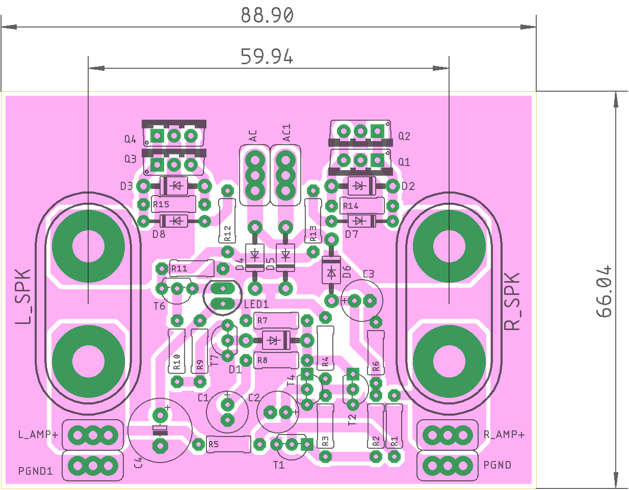

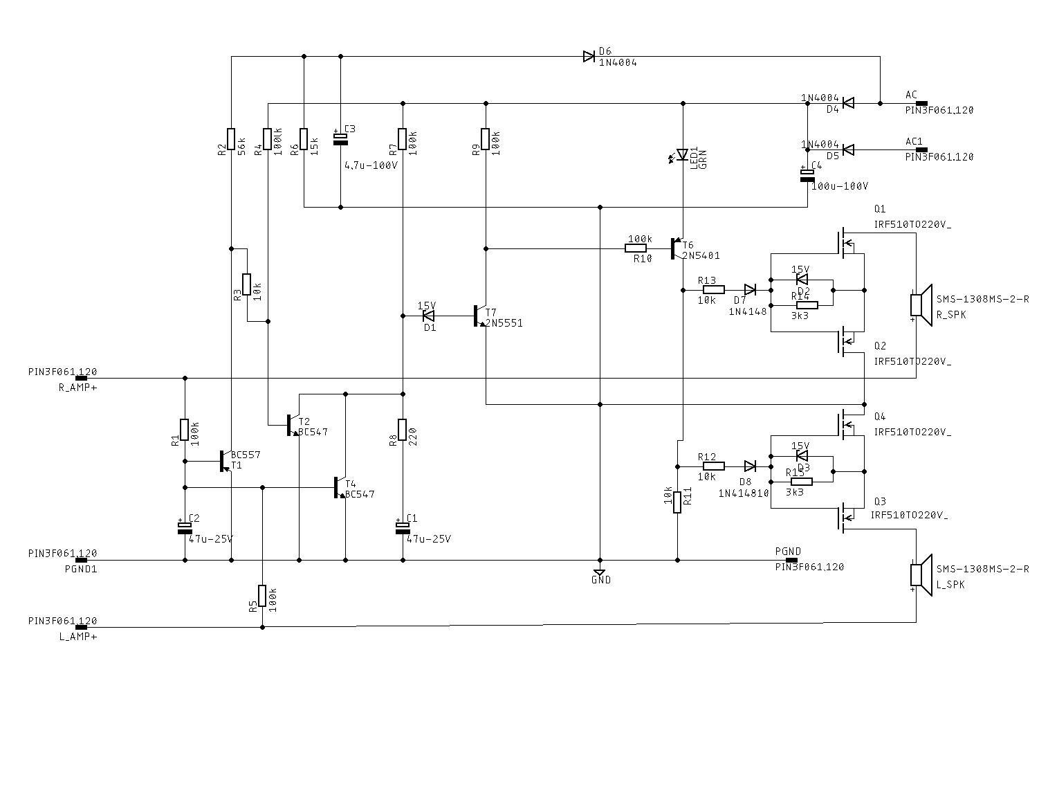

Thanks thimios and Terry,
I think the hum could be due to insertion of mosfet Rds between PGND and SPEAKER -.
I hope Mr. Mile can suggest improvements to remove the hum:cheerful:, otherwise SSR protect is a very useful for any amp from long term protection point of view.
meanwhile I just cobbled together a layout to use a double banana binding post.
regards
Prasi
regards
Prasi
No, the hum is because of no optoisolator use.
