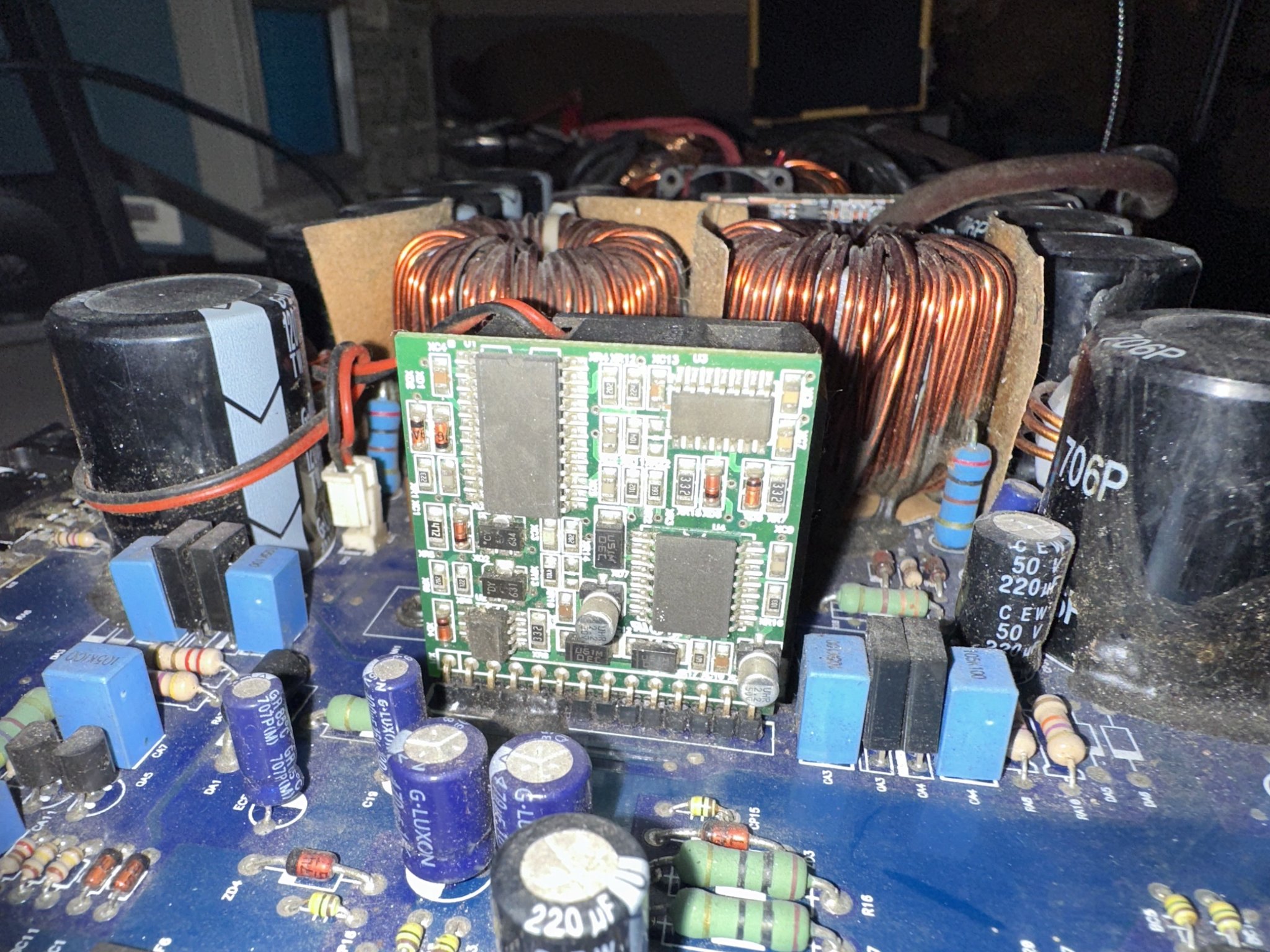

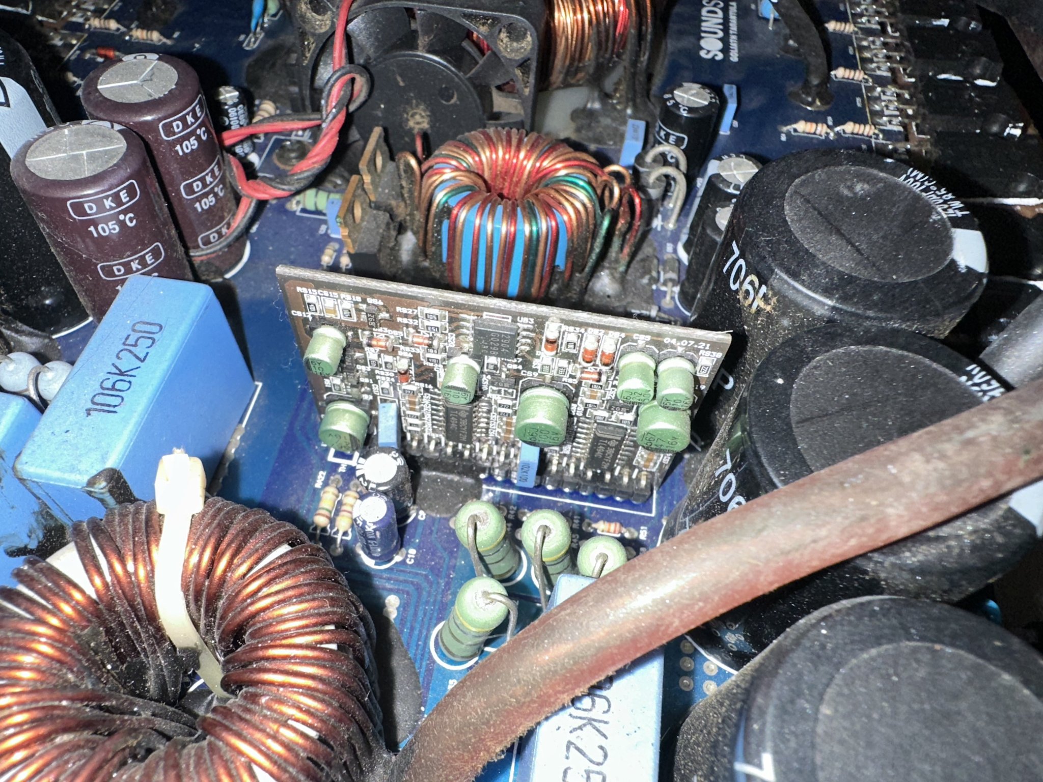

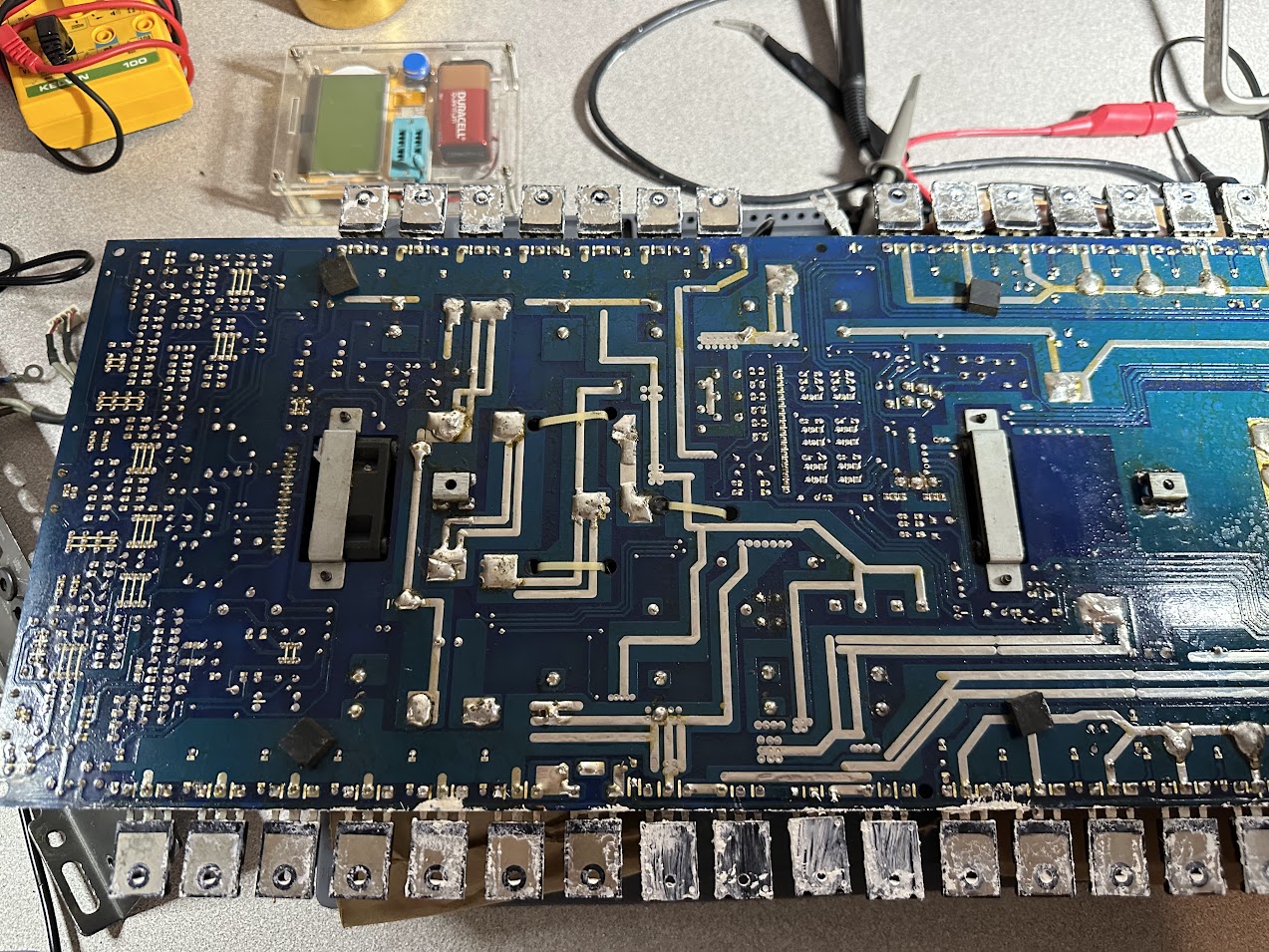

These are the two boards I see, I'm not sure which would be the driver board or how to test them
OK. Back to the amp.
To see if the relays are being told to engage, measure the DCV across the diode DP5. What's the voltage?

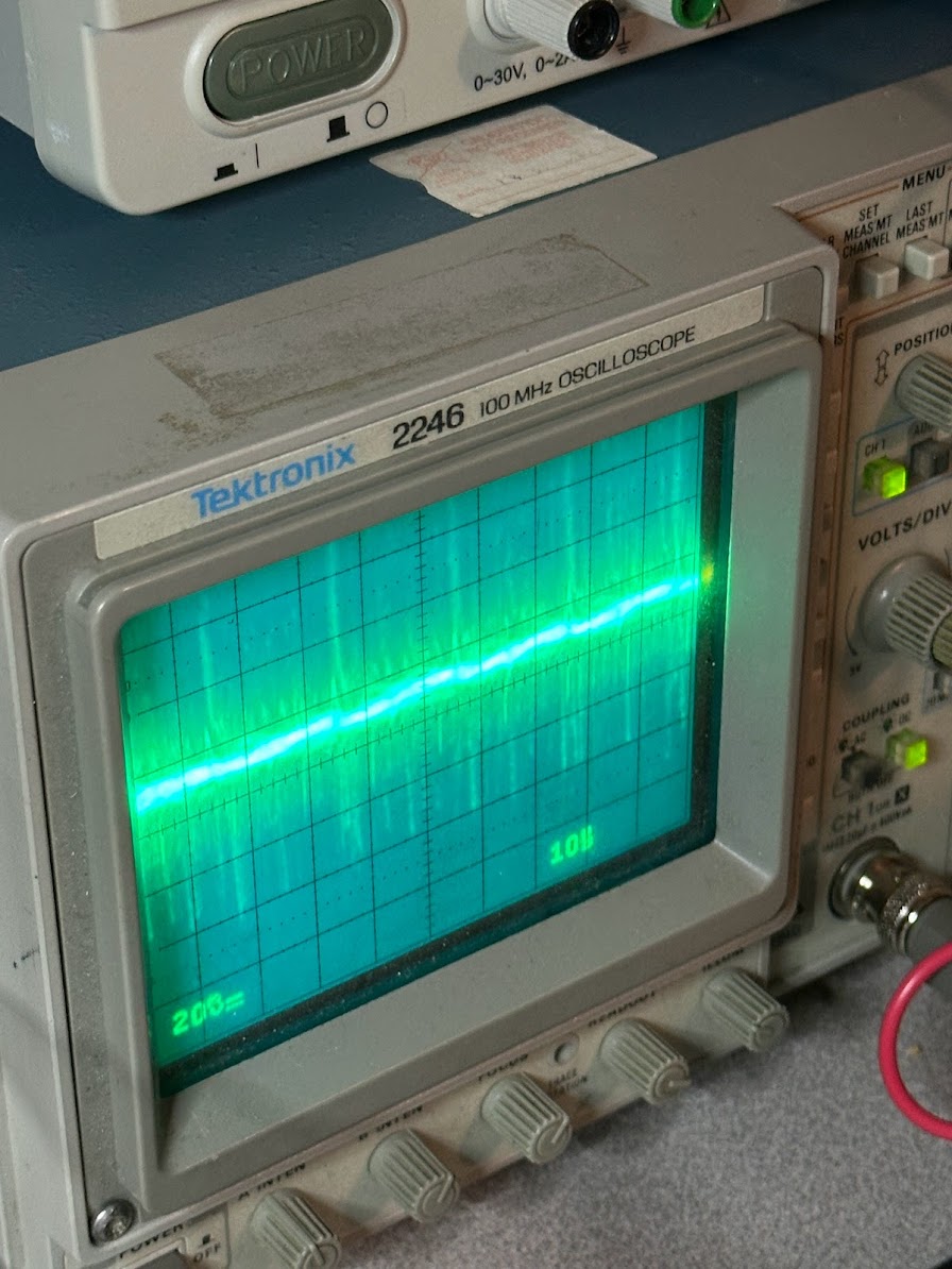

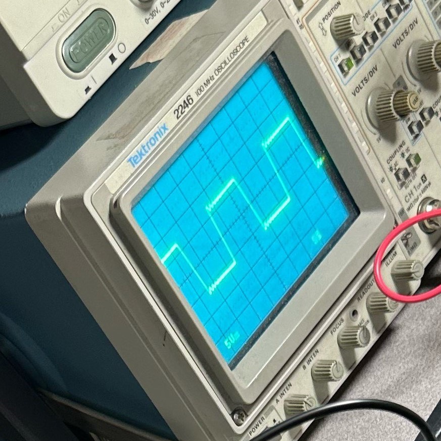

With your scope set to DC coupling, 10v/div and 5us, do you see any sort of signal on either terminal of any of the inductors in the audio section?
^^^ with a signal driven into the amp. Also try at 2ms.

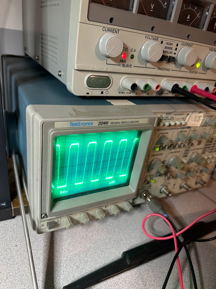

DP5 shows from -0.33v to -0.09v on multimeter, nothing the other way as expected, shows on the scope as positive voltage
Used a 40hz signal

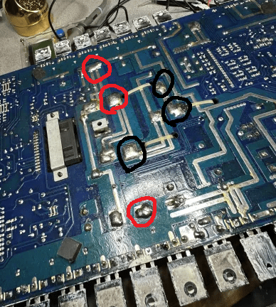

On the attached image I circled the points I probed
Red had shown a square wave (each line started with some frequency then faded to solid line, second picture)
Black had not shown anything some times and others I believe were just noise
I have a few questions though

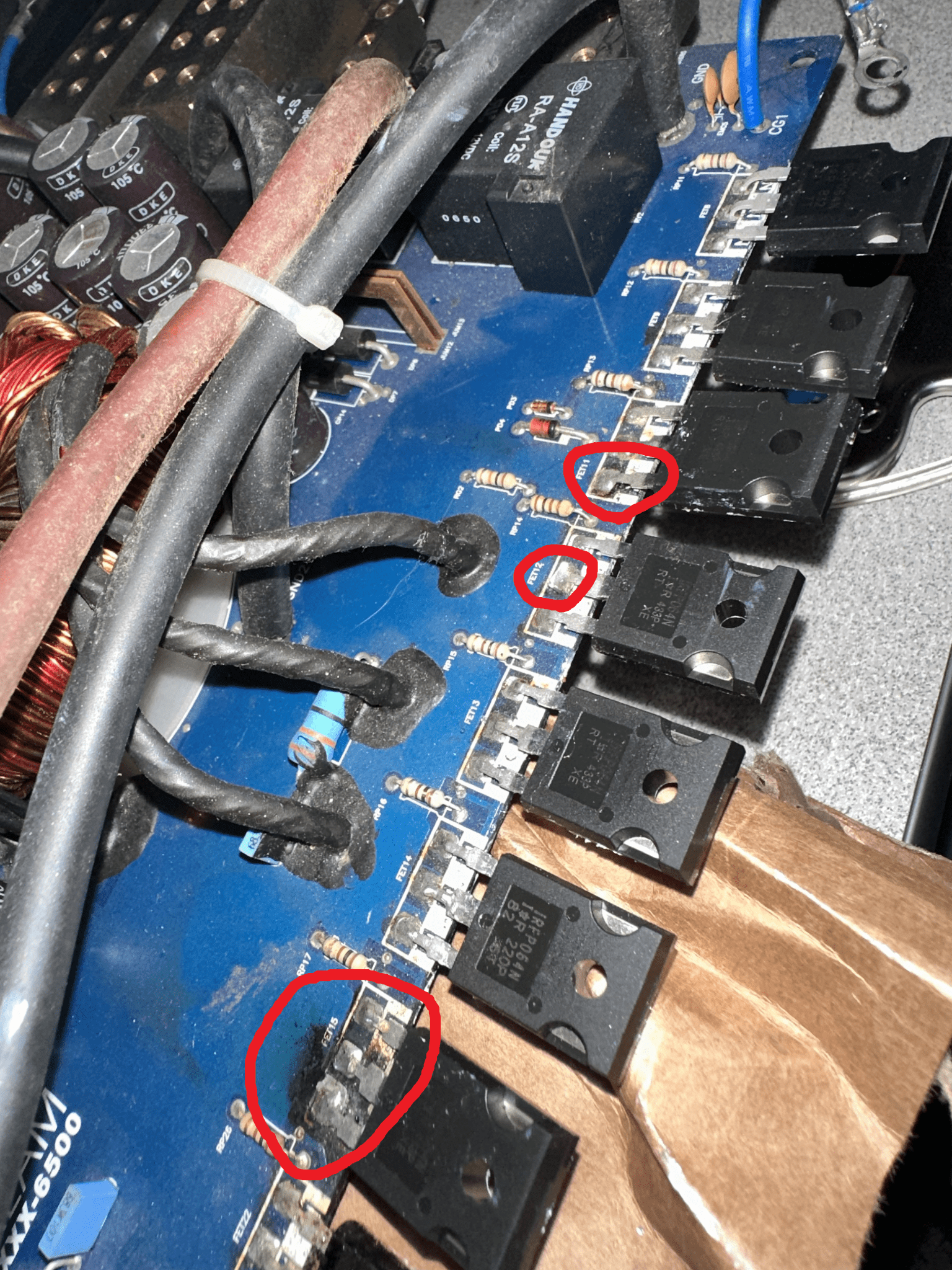

Finally, a few of the power supply fets have screwed up contacts, would this be a problem? (third picture)
(Fet15 and Fet11 first leg makes contact on top, not on bottom, Fet12 contact on top has been ripped off)

DP5, DCV on your multimeter with the probes directly across the diode?
The added current draw could be normal if the difference is the output stage oscillating (or not).
I doubt the buzzing is a problem.
The combination of the dirt and soot on the board and the angle/focus of the photo, I can't tell much about the solder connections. Clean it all up with acetone and a toothbrush and repost.
Between the glare and the low resolution, I can't tell anything in the first photo.
DP5, probes directly across the diode yes

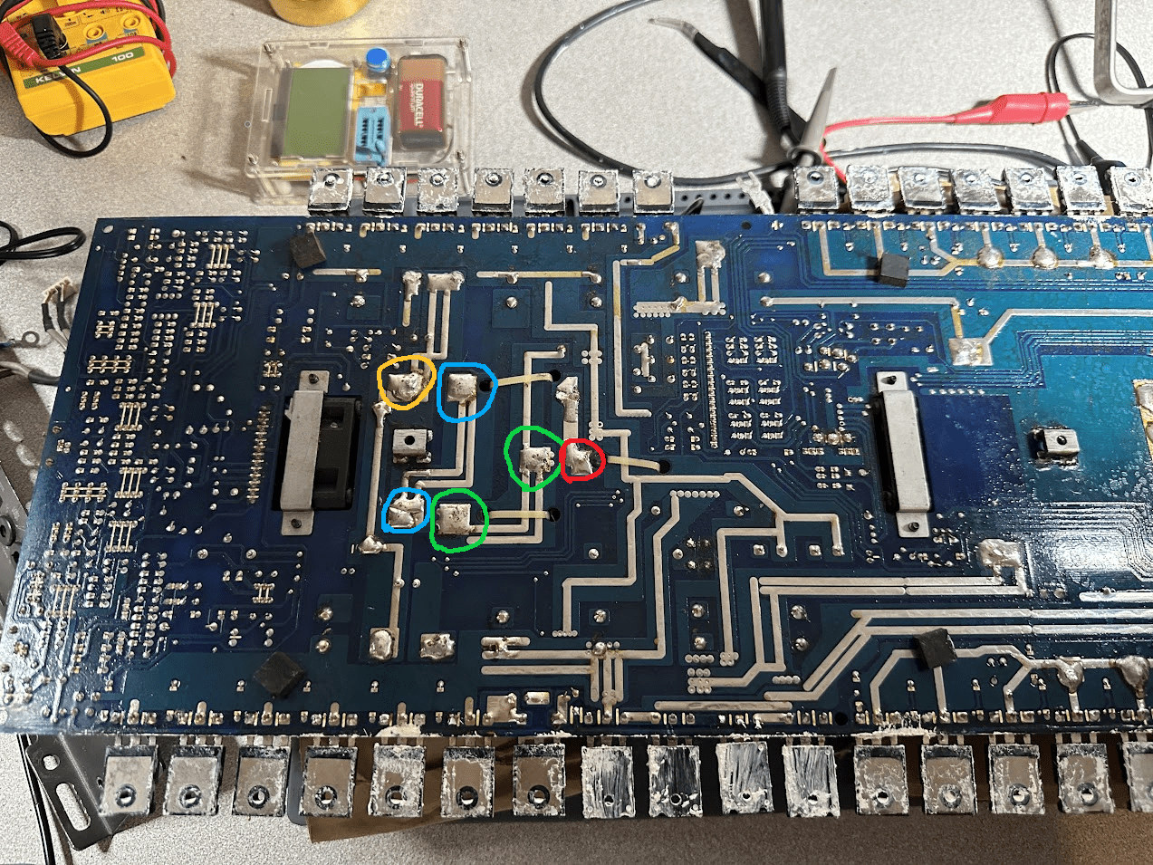

I color coded where I probed and what the readings were, these are coils LA3, 4, and 5
Yellow showed a large square wave
Blue showed a smaller square wave
Green showed a triangular wave
Red showed a noisy signal that changes when I increased/decreased the gain
I will try to get a better photo of the mosfet connections when I clean up the board

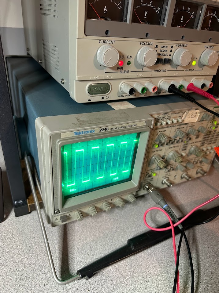

This is what the scope shows
First photos is green, second red, third is speaker output positive, all 40hz sine input
Amp goes into protect whenever I put any input in now

Confirm that you read 0 ohms between the drain of M9 and the point in blue.
Also confirm that you read 0 ohms between the source leg of M10 and the point in blue.
With your meter connected across those two points, move all of the inductors to see if the connection is ever broken (goes above 0 ohms).
What waveform do you see on those two FET terminals when the amp is idling?
I read 0 ohms with both connections, moving the inductors did nothing

The driver board is the green one I recall? I tested pin 1 of it and nothing showed
