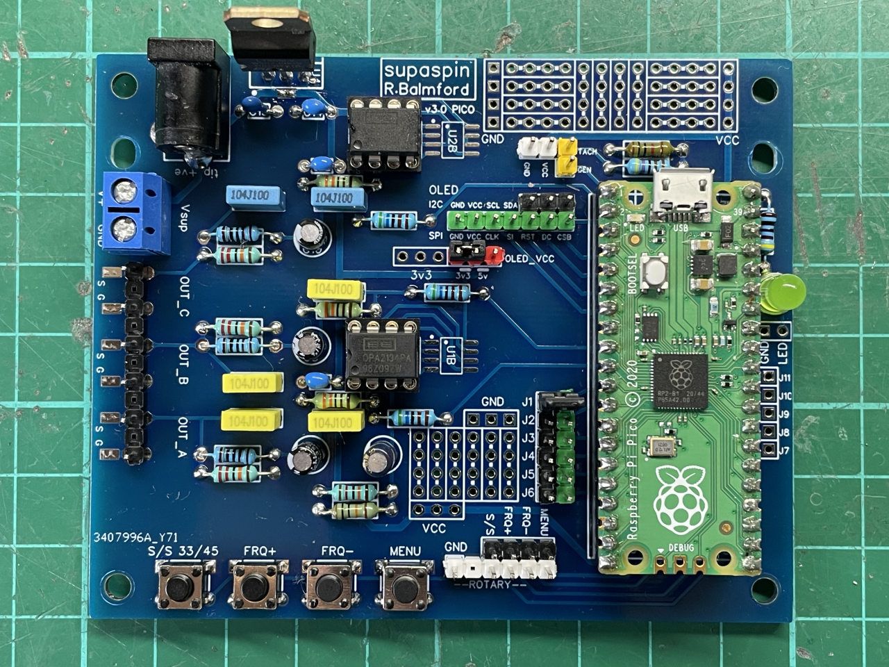

This is a shared DIY project, for non-commercial use. It consists of a PCB and firmware for the chosen processor module:

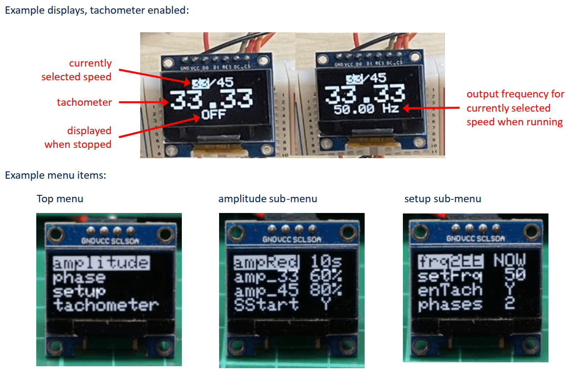

  • 2 or 3 phases of sinewave generation, with electronic speed switching for 33 or 45rpm
  • optional tachometer, with configurable pulses-per-rev (requires external sensor providing logic level pulses)
  • OLED display (SSD1306, SPI or I2C)
  • buttons or rotary encoder support for stop/start, frequency adjustment and menu operation
  • selectable soft start
  • selectable delayed reduced amplitude, separate settings for each speed
  • menu system for all settings with live adjustments, all settings saved in non-volatile memory
  • RP2040 processor based module, with easy drag-and-drop firmware upload

This is the sinewave generator only, and will require amplifying to the target motor's voltage. An amplifier with the required number of channels is needed, to either directly drive a low voltage motor, or line level motors via suitable step-up transformers. (A low voltage amplifier for driving a 24v 2 phase synchronous motors is detailed here).
The two or three phases of PWM at 31.4kHz are generated directly by the microcontroller, which are then low-pass filtered and attenuated to give sinewaves suitable for driving an amplifier. A single button will start/stop the generator with a short press, or switch between 33/45rpm with a long (>1s) press, even when in the off state. The LED shows the on/off state, and will give a short flash on speed change.
This is the latest PCB (v3.0_PICO), using the widely available and cheap Respberry Pi Pico processor module, and is recommended for all new builds:
The original Nano/Uno processor/firmware is retired and no longer supported. However, those with existing v3.0 and v2.0_NANO PCBs can still use them with the RP2040 processor/firmware, configured according to the latest build guide.
v3.0 PCB with RP2040 processor, for 2 or 3 phases............ v2.0_NANO PCB with RP2040 processor, for 2 phase only:
All the past and current PCB/processor options are shown below. Please contact me directly via PM for the latest firmware release, specifying the target processor module.

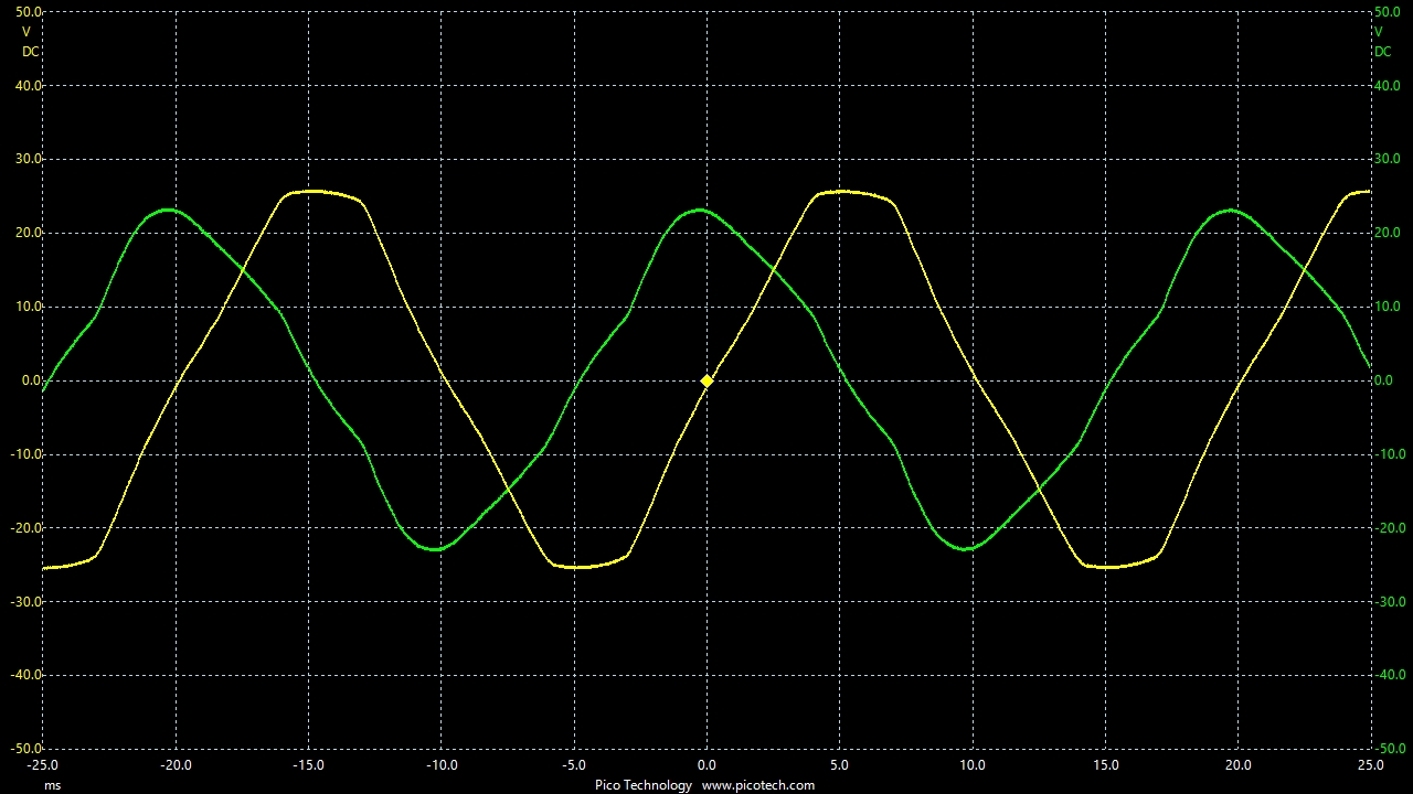

Example 3 phase sinewave outputs:

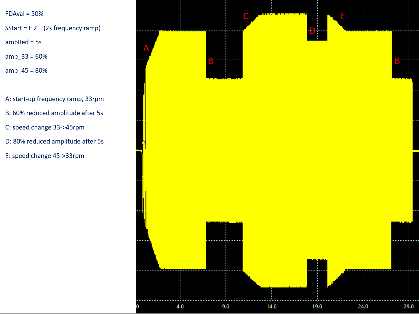

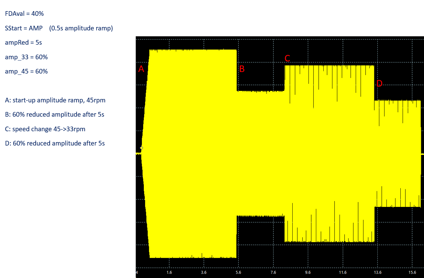

Optional soft start and delayed amplitude reduction:
Gerber files for the latest v3.0_PICO PCB, and build guide for this and the older v2.0_NANO and v3.0 PCBs are included below.
All information also on my GitHub

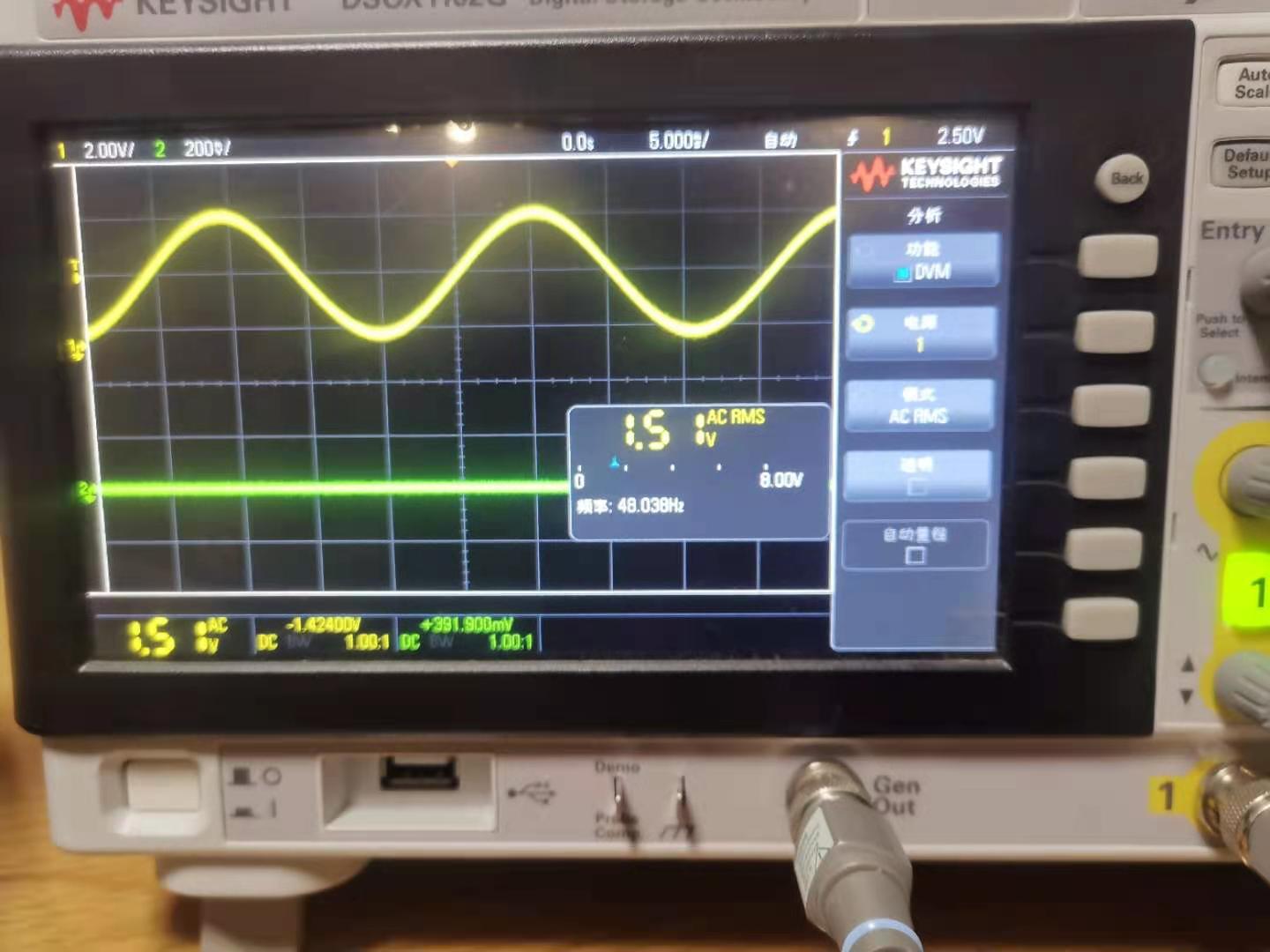

fatastic sharing,what is the voltag for the OPA2134,does the OPA2134 drive the Moto directly or need another amp board to dirve the MOTO?
from the sup-a-spin screen short,I saw the +0.01 and -0.01,does it means frequence can be adjust 0.01Hz,is that correct?
thanks.
Leo
thanks.
Leo
If you mean the voltage at the output of the OPA2134, I have set the LF gain to 3.3k/12k = 0.275, so that the 5v p-p PWM from the Arduino gets translated to a 1.375v p-p sinewave at the output of the OPA2134, centred around 2.5v. The ac-coupling at the output removes this DC offset.
This cannot drive the motor directly, so needs to be amplified up to the required voltage for the motor, which I measured at about 50v p-p, and for this I use a regular integrated amplifier (in my case an old Rotel RA-840 in which I have fixed the preamp gain in order to give 50v p-p at the outputs at full volume).
Yes I have chosen fine-tuning increments of 0.1 and 0.01Hz, whcih translate to <0.01rpm increments.

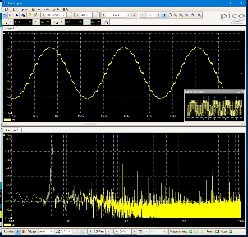

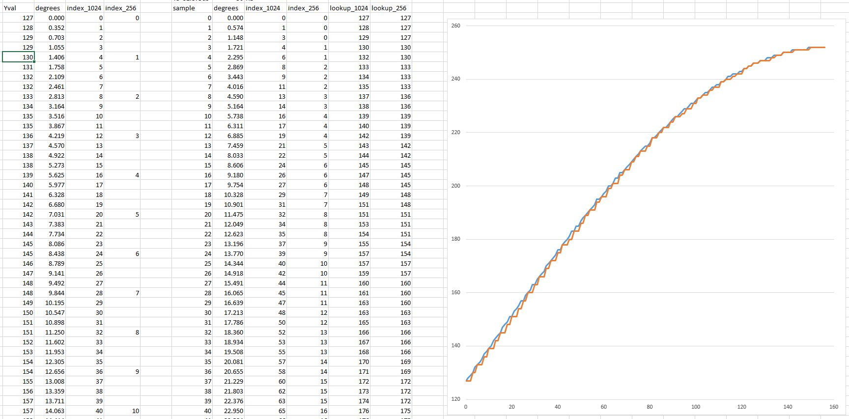

Thanks for the pointers @Pyramid, much appreciated, I dare say there's some arithmetic optimisation to be had, I defaulted to the maximum fixed point precision using 32-bit integers, and was happy I managed to code it fully in fixed point arithmetic and not fall back on floats! Maybe as an exercise I will make these improvements when I've run out of other projects :)
As for the lookup table size, I had an argument for using 1024 rather than 256 points:
At my lowest frequency of 50Hz, the phase advance per sample period (31.875us) is 360*31.875u/(1/50) = 0.57375 degrees. This is equivalent to 360/0.57375 = 627 points per period.
Hence having a 256 points per period lookup table, the table index would only advance (256/627) = 0.408 steps per sample on average, giving fairly coarse time quantisation, leading to some amplitude quantisation.
Going up to 1024 points per period, the table index would advance (1024/627) = 1.632 steps per sample on average, giving both finer time quantisation, and less amplitude quantisation, also due to finer Y resolution of the table.
I've pushed my Excel skills to demonstrate this, as shown in the picture, where the smoother blue curve for 1024 ppp relative to that for 256 ppp in orange can be seen. Hope it is fathomable!

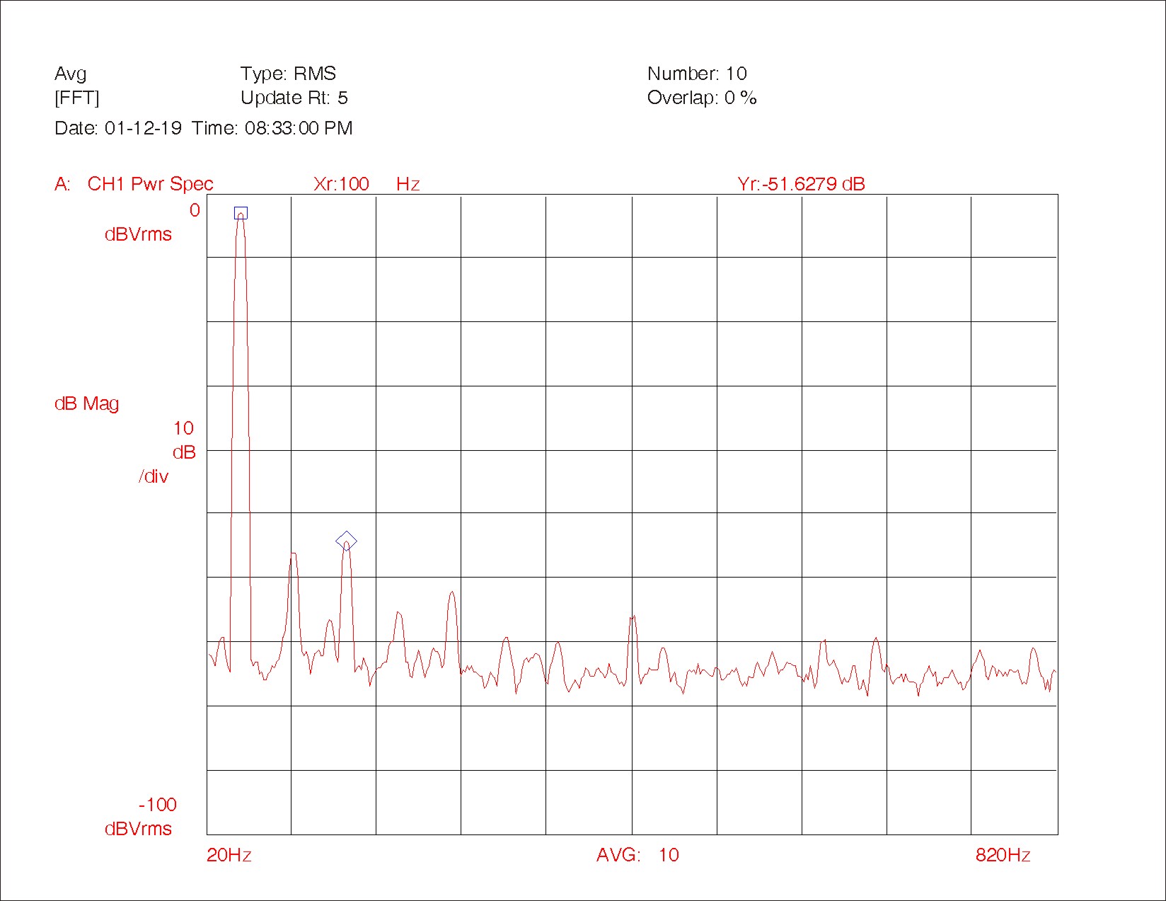

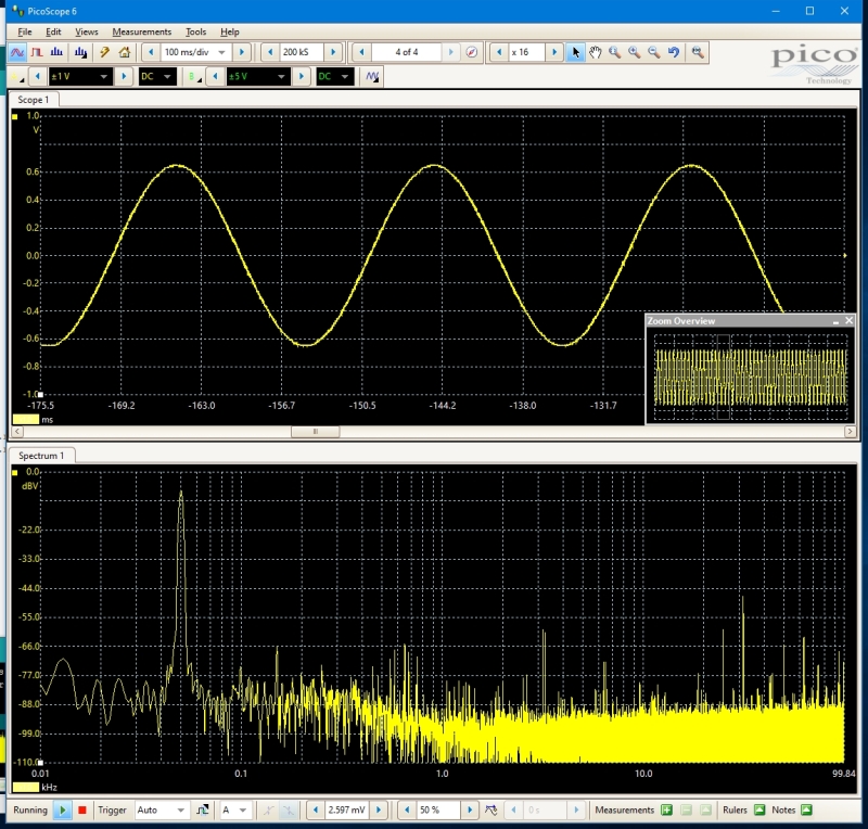

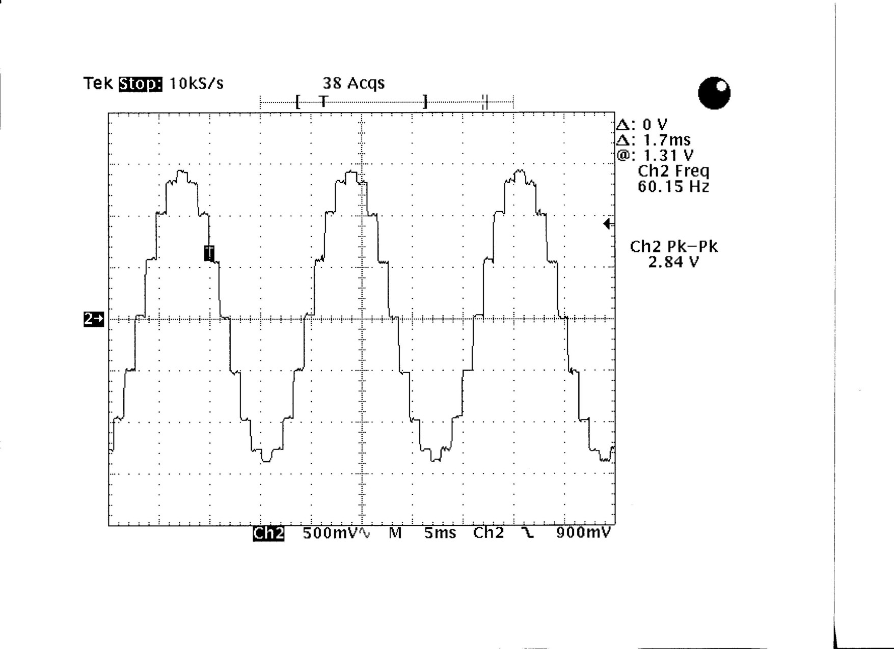

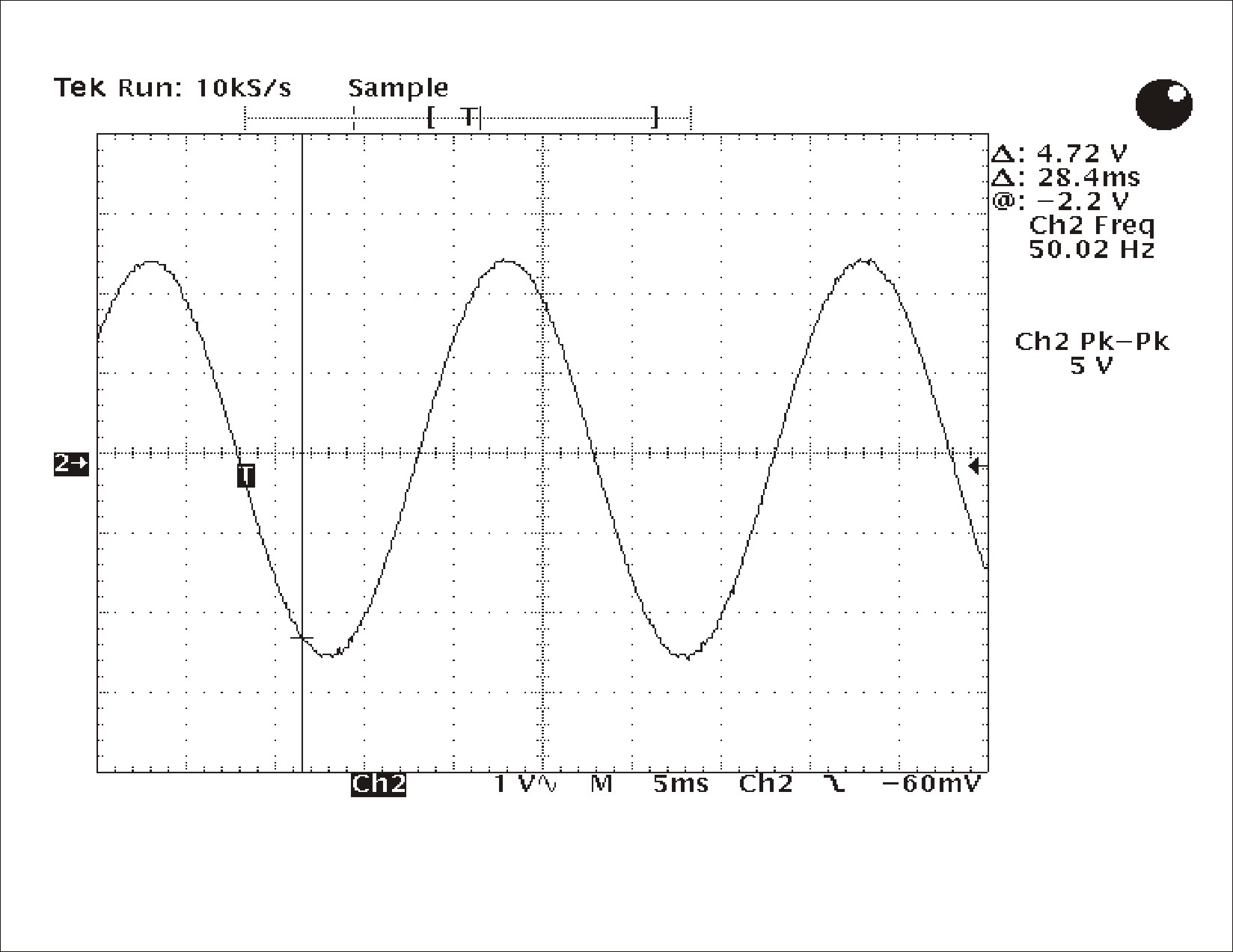

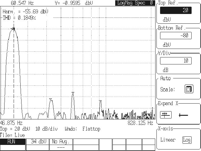

There is a slight improvement over an 8 bit table, but I think the reconstruction filter will remove most if not all of that. The SG4 uses 8 bit PWM with 256 table entries and the 3rd harmonic is ~-51dBc where yours is ~-63dBc? The SG4 has a 2 pole LPF with an Fc of 230Hz; the sampling frequency is also quite a bit lower: 209.7 samples/cylce vs 627 samples/cycle on yours. I think for motor drive applications, this is perfectly acceptable.
I also think you could still use a 10bit LUT with the 20bit phase accumulator; the sampling frequency will be lower (10kHz vs 31kHz), so it would be interesting to see if there was a difference in performance.
For comparison, the VPI SDS used a 3 bit DAC (8 output levels) and 16 samples/cycle. After their 2 pole LPF, distortion was still only 0.2% (their LPF had an Fc of 190Hz IIRC).

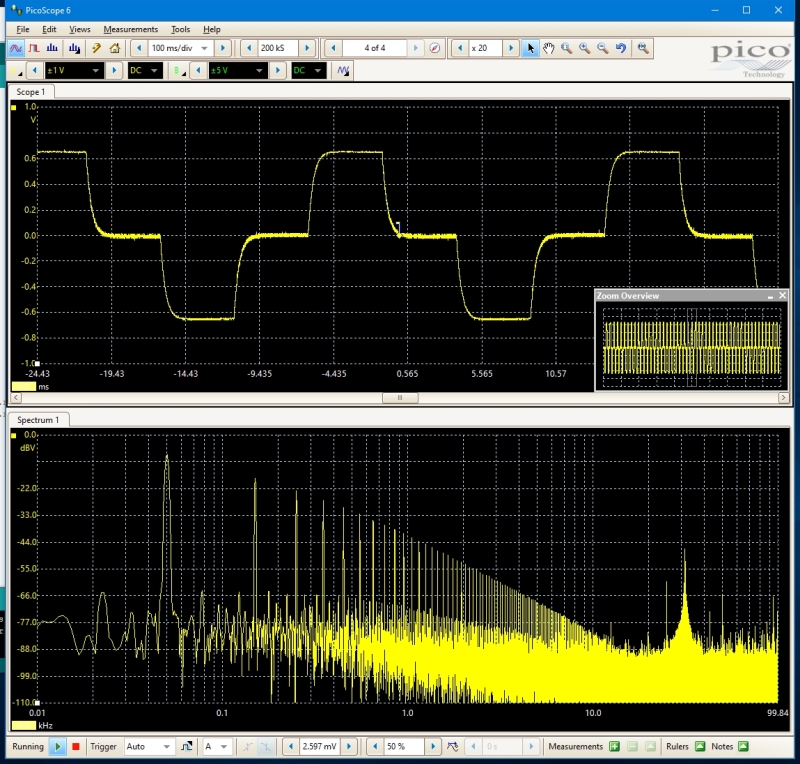

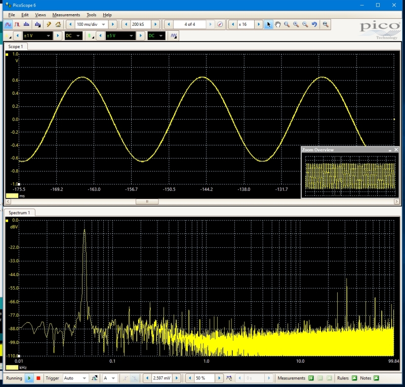

I'm totally with you, all these solutions are way better than what I measured from the default 'wall wart' AC PSU (which most would be happy with), as shown below :eek:,
The main advantage for me of running at the maximum PWM rate, is to give the maximum frequency difference between the sinewave and PWM rate, which allowed use of a simple single-pole LPF high enough above the tone, but still give good attenuation at the PWM rate (plus in my case, as I'm amplifying using a normal integrated amp, I can get further PWM attenuation using the treble tone control).
