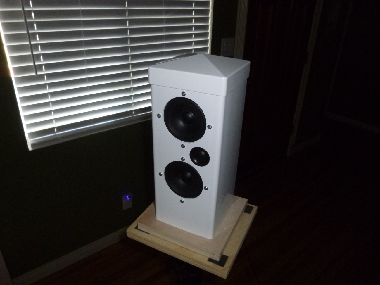

Here is an alternative approach to using plastic, though the finish is possibly beyond the limit of the average DIYer:
Shan Shimna
They use some kind of mineral-loaded composite, which is subjectively very inert. I had a pair of these years ago, and they sounded remarkably un-box-bound, though in my opinion their performance was ultimately limited by the choice of drivers, particularly the plastic-domed tweeters. I eventually sold mine to the original designer, who had been looking for a pair to show his son what he used to do for a living...

It works very well with very thin, very light and massive mass loading as well.Plaastic can work but I think it needs to be thick, heavy and a lot of bracing.
The enclosure can either be very rigid (resonances above driver freq. range) or very floppy (resonances below driver freq. range). By building a very floppy enclosure and damping it, the resonances still exist but are lowered a lot.
