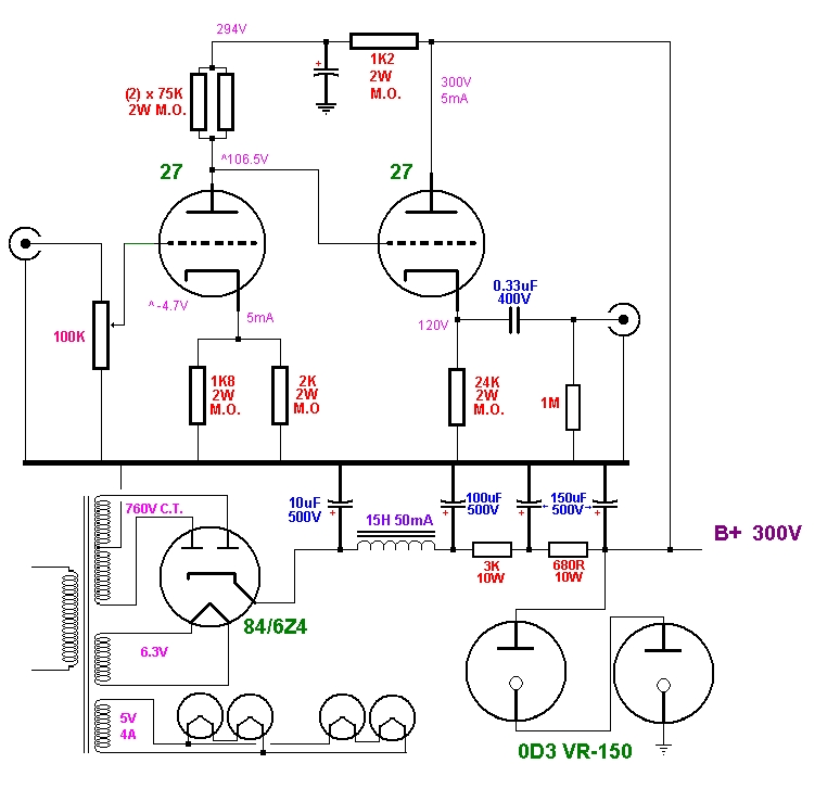

I am in the process of completing Phaeton RC 26 preamp published on http://www.vt52.com/ site (Jim de Kort) as my latest DIY project. But still I am little puzzled with few things with my current project. Hope someone could provide an expert advice to me to figure out those.
One thing I am confused with is the hum coming out from B+. I figure out it is something to do with the grounding however. Lately I found out that if I ground the filament negative with B+ negative with 470uf capacitor, the hum is almost disappearing. But not sure whether this method is right or safe because what I did was sheer coincidental . Need advice on this. I used separate power rail using a SMPS for filament and both filaments were connected serially with 3V supply. Only connection for B+ negative from this rail is 470uf negative to negative (capacitor + to filament's negative and capacitor - to B+ negative).
Second thing I am puzzle with is the bias supply. Should I use separate 12 V supply for bias for 26 tube or should I use voltage divider to get the bias supply? Where exactly should I connect the bias voltage in this schematic?
Greatly appreciate if someone could clarify these for me.

I think the hum is more likely to come from your filament supply and or grounding issues.
The 26 is notorious for humming if the filament supply is not up to scratch.
The cap from negative filament to ground is safe.
What bias voltage do you mean? The design you posted is auto-bias. Therefore the bias you refer to is probably the voltage across the cathode resistor.
The hum is ripple in your filament supply. What you did "by mistake" was twofold. You "star grounded" and added a "C" filter.
You can actually incorporate this into your filament supply circuit.
Maybe increase the value of that capacitor also. 1,000uF??
Make sure the B+ capacitors and chokes are of good quality, but I doubt the hum is coming from there.
By the looks of it the "bias" of that tube is actually more around -15V (~6.2ma thru a 2K2 cathode resistor.
It appears he took the operating point for the 26 straight out of the RCA manual. Vp 180 Grid Bias -14.5V Current 6.2mA
What you might consider is placing the 2K2 Cathode resistor and the 470uf on the center tap of a 50 Ohm 1W potentiometer. The two outer tabs of the potentiometer then go to the filament pins.
This is a "hum balance" pot.
Check your voltages proper operation should be at idle (short the input)
~194 - 195V at plate connection to ground
and pretty close to -14.5V grid to ground.
He is running the 26 kind of "hot" the other designs I have seen show it running more at Vp135 current 5.5mA
Find a copy of RCA RC-10 and look at specs.
Good luck, I am working on a 27 preamp right now.

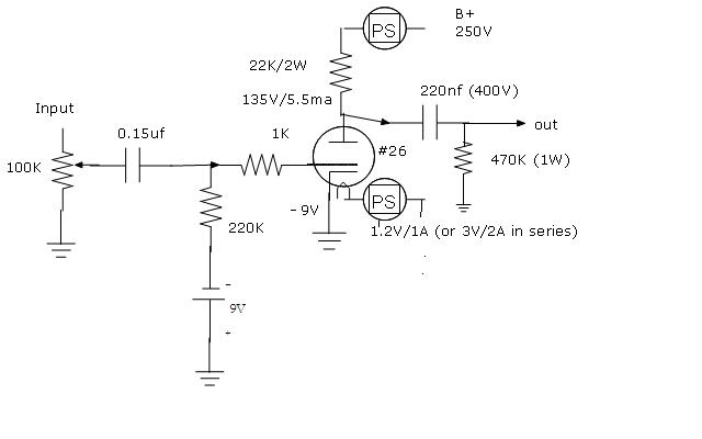

Finally I have completed the pre-amp. Attached the schematic (sort of Kevin Kennedy, Jim D'Cort mixture). Thankful to Kevin for his great advices to come up with this final circuit which work nicely and worth all the efforts. Used a PSU with Hammond 372 X (which I had already otherwise an overkill I suppose) +5U4GB+10K(5W)+OA2/OB3 tube regulators+IXCY CCS (kit module K&K Audio -http://www.kandkaudio.com/accessories.html) to produce 250V hum free B+ which I built out of randomly picked up items I had already. Otherwise, any simple PS schematic would work I assume. For me, use of regulated B+ helped towards reducing the hum drastically. Hum with unregulated B+ was unacceptable to me (even though it sound great). For filament, I used a cheap China made external DVD SMPS which worked greatly with no hum at all. 🙂

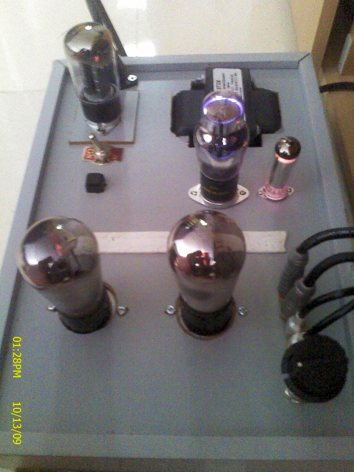

Attached a picture of the final product (pardon for my poor craftsmanship:no:).

Looking at the 220nF coupling cap at the output; isn’t that generally too small?
In normal (not DHT) linestages this is usually 2-4uF. Are there special considerations with DHTs?
A very nice build btw., coolzero.😎
I am confident that a well constructed 26 linestage is one of the best linestages money can buy... regardless of price.

On coupling caps choose the smallest that places the -3dB corner well below the LF cutoff of your amplifier/speaker combo.. Generally I think 5Hz is low enough in most instances.. A 1uF output capacitor into 100K has a -3dB corner in the vicinity of 2Hz which IMO is more than low enough, perhaps a bit too low if you are playing vinyl.

Cap value was taken from the Jim D'Cort orginal design without a change. He had mentioned something in his site with regards to the maximum value of coupling cap. Pretty sure it was not that high as you mentioned. Didn't give much of an attention for that since I was hurried to listen to it 🙂
