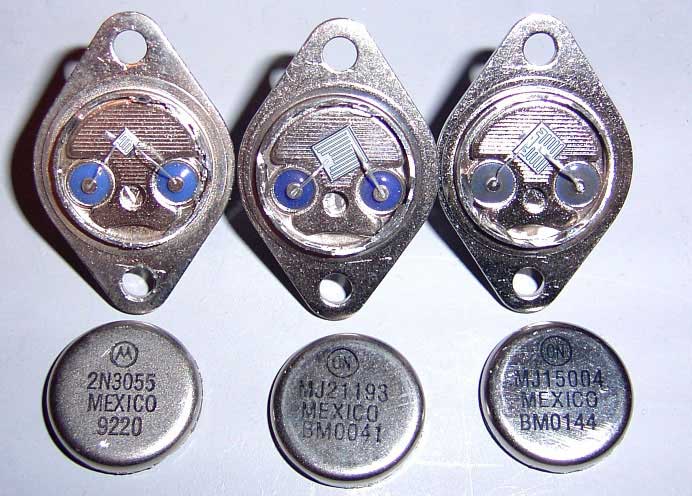

2n3055, mj21193, mj15004 pics (for detecting counterfeits)
The picture says it all - from left, they are:
2n3055 (Motorola, genuine)
mj21193 (On, genuine)
mj15004 (On, genuine)
For those who suspect they were sold counterfeit mj1500x devices, this should provide a good frame of reference.
Note the difference in die size and bonding wire thickness between the two MJ devices and the 2n3055!
I measured the 2n3055 die at 4.41 mm^2, whereas the mj21193 is about 26 mm^2 - that's a difference of almost 6x!
No wonder the mj21193's are so hard to kill in comparison. I'm going to try and get some "off brand" 2n3055's just for fun to see how they stack up to the genuine motorolas as well.
On a related note, does anyone have a good method for getting open a TO-247 or TO-264 flatpack without obliterating the contents?
I have some 2sc1302 and mjl1302 series here that I wouldn't mind sacrificing as well, just to help the cause.
There are more pictures at the url below, including shots of the rear finish of the TO-3 cases, closeup shots of the ink printing on the TO-3 cases, and front and rear shots of a genuine mjl1302a device (I was surprised the rear finish looked as poor as it did, actually.)
http://24.83.100.50/~thingyness/transistorphotos/
If anyone has any requests for better photos of any part of the transistors, let me know - I didn't throw them out, obviously. All three still work just fine, which is surprising considering the hell I put the poor things through.

The one tool I could never do without - my Black and Decker RTX tool, and a simple fiberglass cutoff wheel. It made a shower of sparks about a foot long while cutting through the steel, but it did an excellent and clean job of getting the tops off.

The entire point was to give people an idea of what a *good* device should look like if they think theirs are fakes.
I'm still amazed by the size of the mj21193 die in comparison to the poor 'lil 3055.
It'll be interesting to see the construction of the mjl21193 once I get these flatpacks apart.
It would be interesting to see how the die design of a 1302/3281
differ from these transistors, given their bandwidth and linearity.
