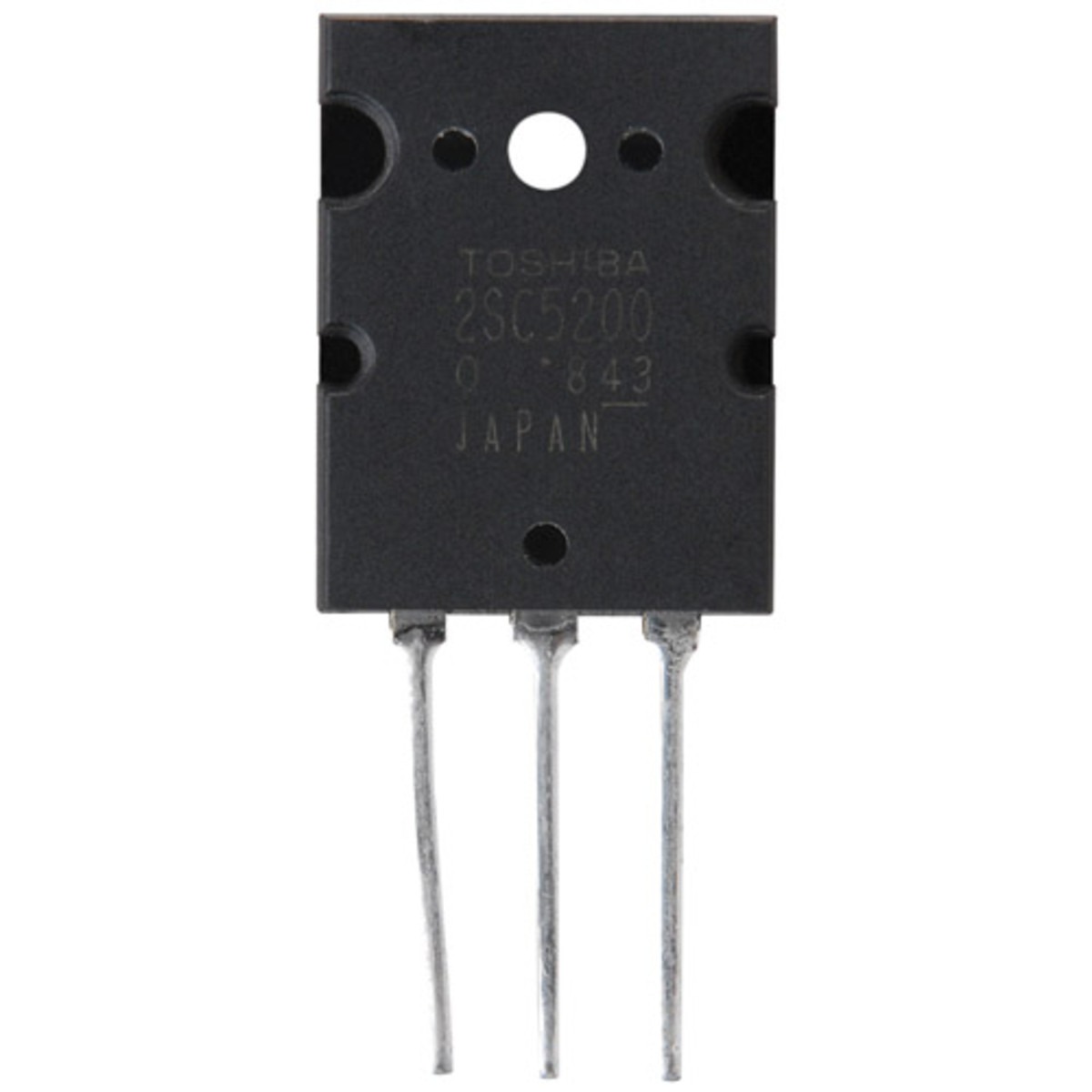

this is what they have in parts express on clearance now...the legs look funny 🙂
but they may be pulls reused?

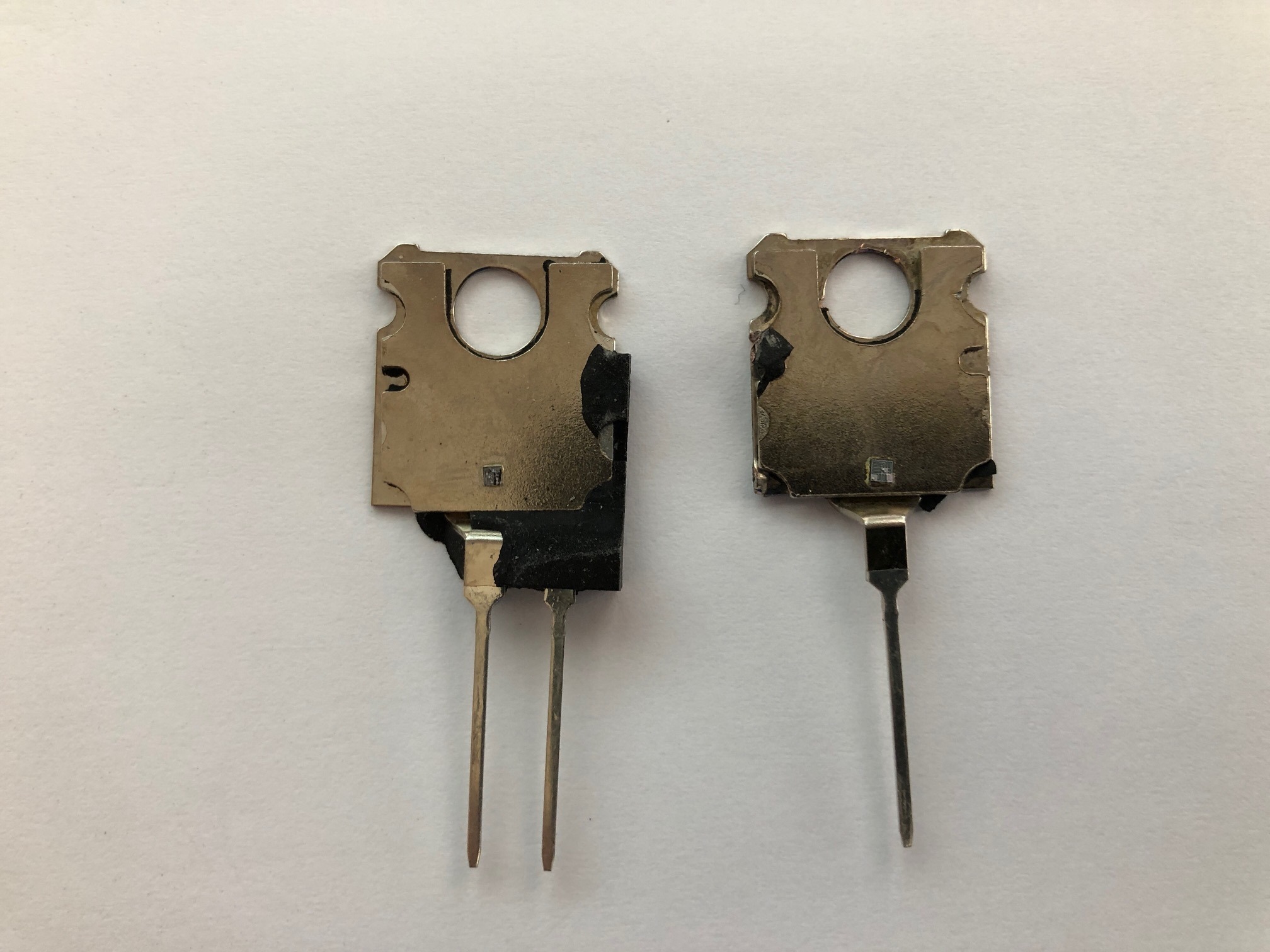

I know this is an old thread; however, I've been building amplifiers and made the mistake of buying 2SA1943/2SC5200 and TTA1943/TTC5200 from both Amazon and eBay only to find they were absolute garbage and here is what they look like:
These are the TTA1943 and TTC5200 from both these eBay sellers (see attached image of tiny little die and magnetic tin coated steel heat spreader):
https://www.ebay.com/itm/392620267303
https://www.ebay.com/itm/123356242155
The 2SA1943/2SC5200 I bought from Amazon also look identical (die size, tin coated steel vs. copper, etc) and they were from "Bridgold Direct" on Amazon here (See attached image, the image is of the TTA/TTC; however, the 2SC/2SA that I cracked open look the same so I didn't bother posting their picture):
https://www.amazon.com/gp/product/B081W6CBHX

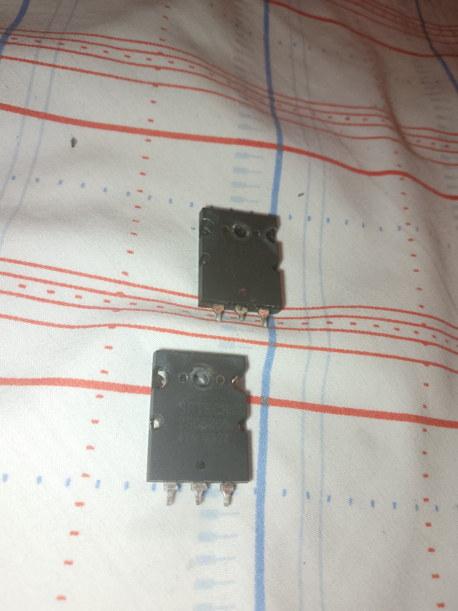

I have been working with these Transistors 2SC5200 and 2SA1943 with name SPTECH both. I worked on three amplifiers with them but after two of these three amplifiers got damaged because the mentioned transistors failed, I have a doubt if they are fake or not. I am sure I did the proper adjustments but I don't what to think. If somebody knows them, here a photo.. now, does a fake transistor stick to the magnet?

One thing is for sure. It’s NOT a Toshiba. That makes it a copy, not a fake. Fakes are always bad, copies vary from as bad as fakes to somewhere in the ball park of original performance. If yours blew, I would in the future avoid SPTECH, because they are obviously not as good. I have used Fairchild’s copies, and they meet my expectations. Supposedly KEC is making them now, but the jury is out - simply not enough data yet (but their driver devices work well so thats encouraging). ISC makes copies too, but their stuff in general isn’t as good. - plenty of field failures reported.
The “magnet test” indicates steel in the leadframe. It is supposed to be copper.

Thanks Wg, for replying. I will open them tomorrow and I will upload some photos of the inside part of these transistors to get rid of the heavy doubt. Thanks.
