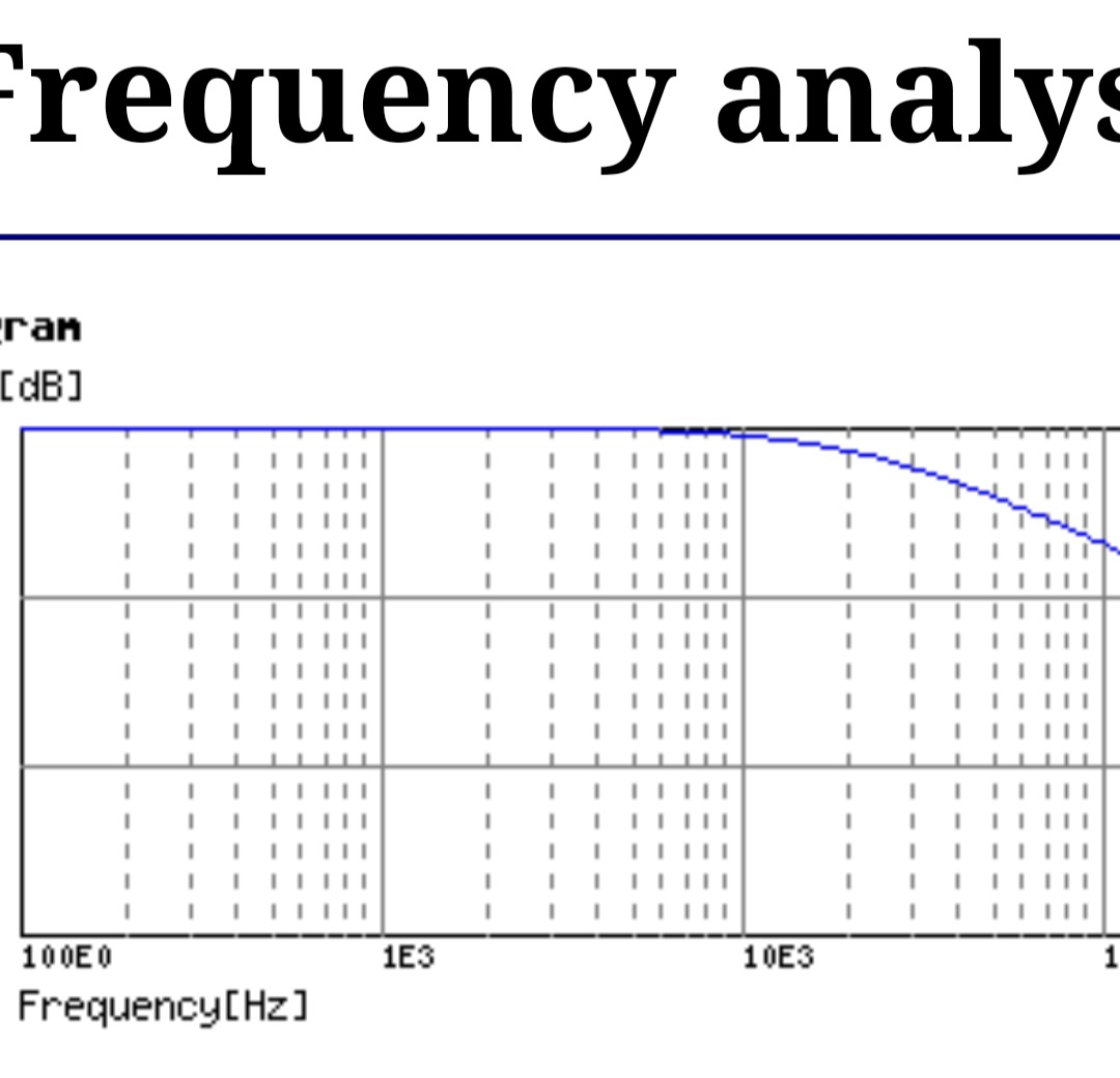

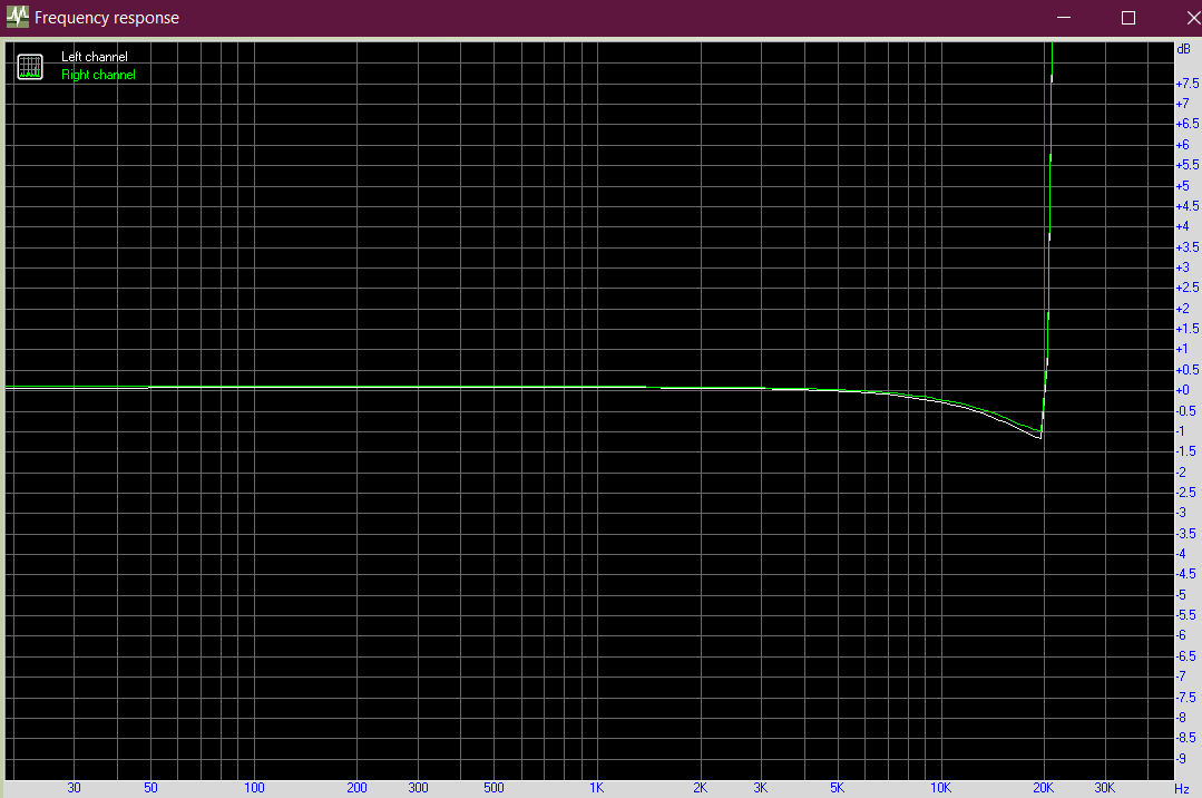

Thanks for the tips, X.
I'd been looking through various texts to learn how to set up an input properly, but most seem to skip that stage and go straight to the VAS. I can't even remember where I saw the 100n, but I must have copied it from other designs I'd seen.
It all makes sense now that I stop and think about it and the calculated frequency response does tally up with what I was using - 75ohm output impedance of the DAC into 100nF gives this:
attachment.php
Vs. real life:
925266d1613989906-3-transistor-hp-amplifier-low-dist-fr2-png
It should be simple enough to retrofit a board with the proper filter values and I'll give it another test and see how it compares.
Fun stuff and a learning process at the same time!

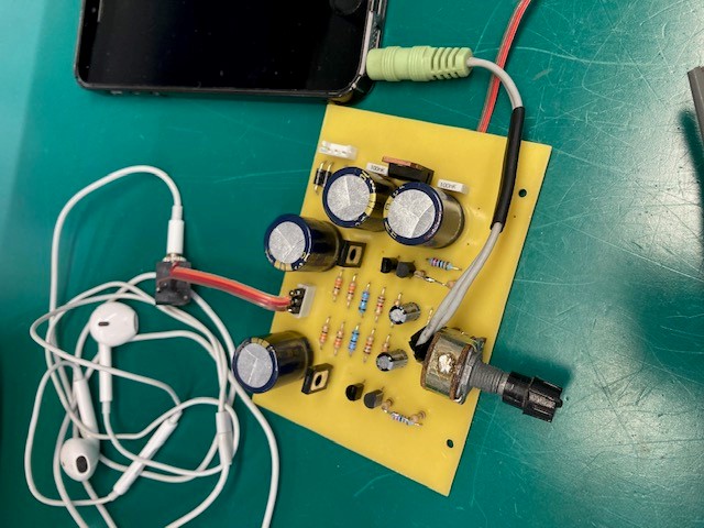

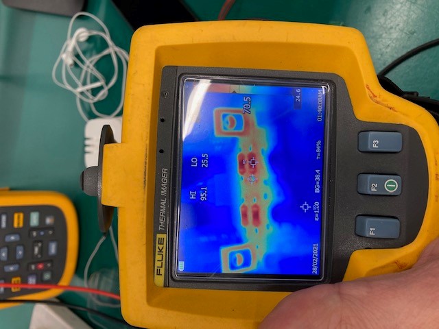

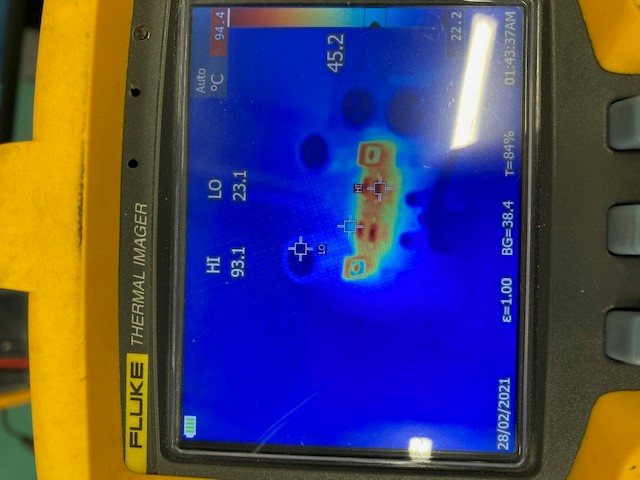

Hello,
I also finished the stereo amplifier.
I used BC546, BC556 and BD139.
It sounds great.
I present you some pictures.
I will have to mention radiators on the BD139 transistors and the 7812 voltage regulator that I used.

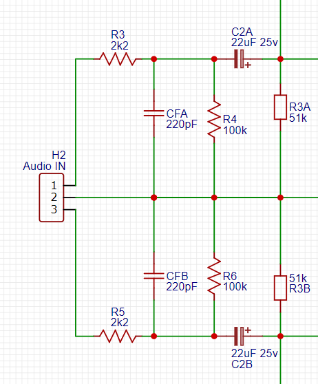

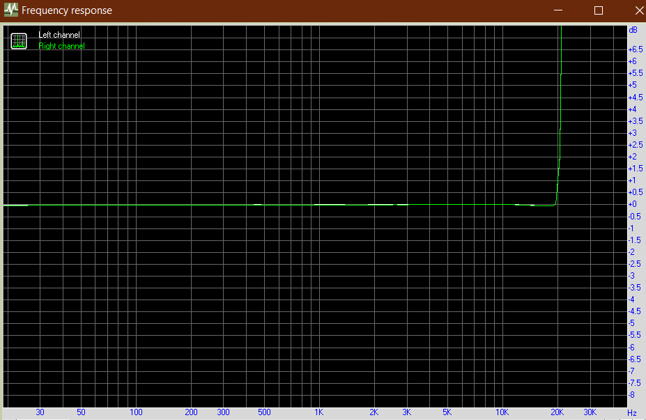

I added the filter to the second board I built as follows:
attachment.php
This has flattened out the frequency response:
attachment.php

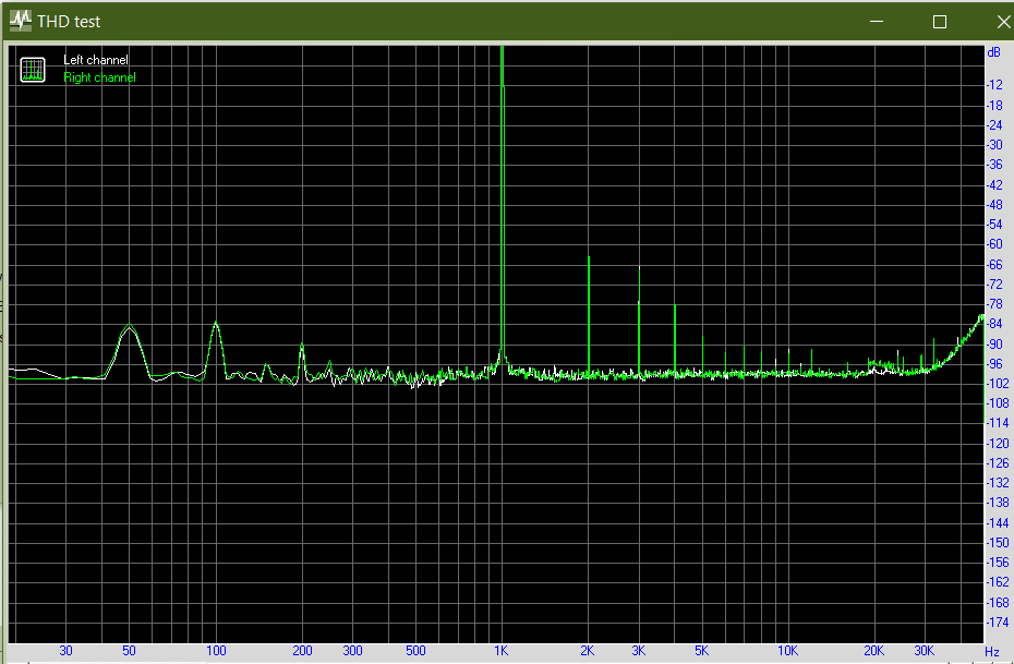

And THD now 0.00362%:
attachment.php
As a reminder, I measured my O2 head amp using the same set up. The O2 is specified at 0.0016%, I measured 0.00490%. The T3 under the same conditions is 0.00362%, so it is in the same ball park.
These are the figures:
Noise: -98.4dBA
Dynamic Range: -99dBA
THD: 0.00362%
IMD+n: 0.00456%
Crosstalk: -70dB
The only issue I have is lots of buzzing when nothing is connected to the input, and the buzzing goes away when I touch the metal part of the case (which is connected to the negative). When there is an input connected (even an ungrounded source such as a mobile phone), the amp is dead silent.
