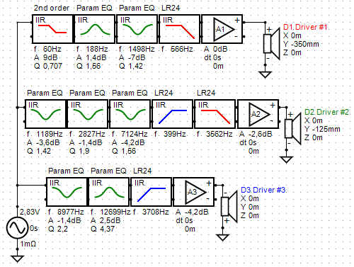

My approach depends on personal taste, and I like simplicity. I prefer shallow slopes because all the speakers I prefer have shallow slopes. But it's not all about filters and topology, the selection of good drivers is more important.Would appreciate any feedback on it (from yourself as well as others), and similarly, I would like to understand reasons for your approach (why you picked these xo frequencies, slopes and EQs).
I aim to have a flat FR on axis with a good PIR and SP responses, so I choose drivers, xo frequencies and filter slopes accordingly, starting from the point that the midrange must have a very good extension (250-2500Hz).

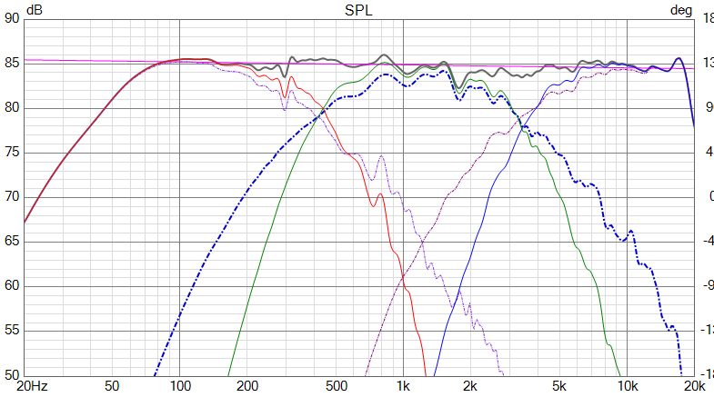

Basically, I use the optimiser to set up my intended filter, like this
e.g., Midrange: red is measured FR, blue is with filter applied, gray is with filter and PEQ/shelving applied.
Do the same for all the drivers and then optimise all the blocks to get a good compromise between on axis, polar FR, PIR and SP.

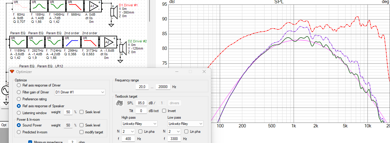

The magenta target response is the one you can create with the Optimizer tool by setting the various filter values (Type, slope, Fc, etc.) in the relative window.
Beside you can import all the FR you want as overlays (dash-dotted lines) and use those as target responses. Then you manually choose the component and its relative value in the crossover tab.
The big advantage is that you do not have to open a new window to modify the parameters (you select the component by clicking on it and use the mouse wheel to modify its value). All the values modifications are shown on the graph in real time.
You can also use the Optimizer tool to automatically get a desired target response but I am not good at it.

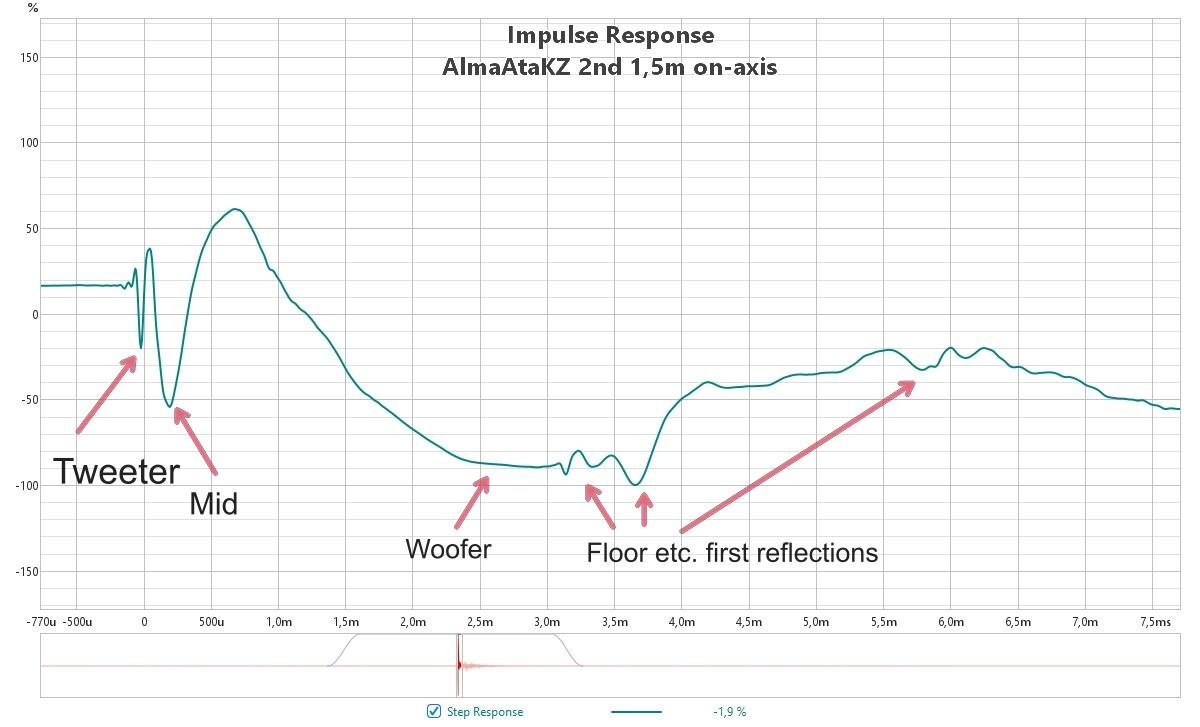

The graph below shows time domain as step response of this project 2nd xo version, measured at 1,5m indoors. Step is another way to look at impulse, it shows polarity of drivers and delays between "ways". Now we can see that all drivers have negative polarity and that T and M integrate well. Intergration is analyzed from how valleys between peaks integrate, in case ot 4th order. Woofer peak comes too late, so mid and tweeter shlould have approx. 100us (0,1ms) delay. Floor reflection etc. appear a bit after 3ms. https://www.audiosciencereview.com/forum/index.php?threads/step-response-does-it-really-matter.1999/
- how to I generate a view like this? this is REW, right? or is this VCAD?
- how do I interpret the M and T delays from this? I do not see where the 100us comes from and why.
Would appreciate.
In a few days I will do the 4th attempt at consistent measurments and will do VCAD simulation and filters/EQ set up based on these.
This view is from the Impulse response window in REW.how to I generate a view like this? this is REW, right? or is this VCAD?
- Open Impuls response window
- Uncheck everything except the Step Response graph. (optional but this will give you only step response)
- Change y-axis to % (top left control on the graph).
- Zoom in.
