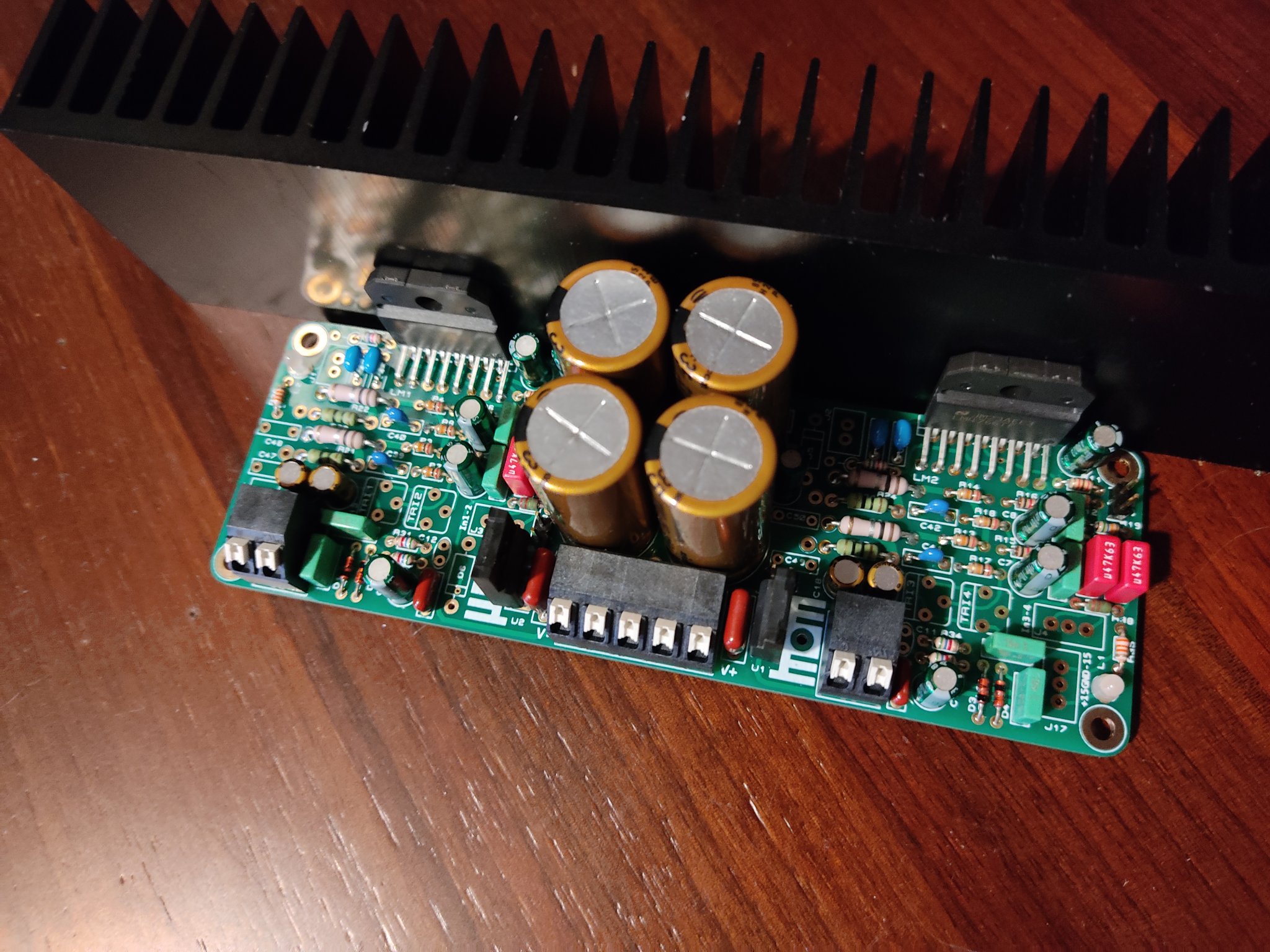

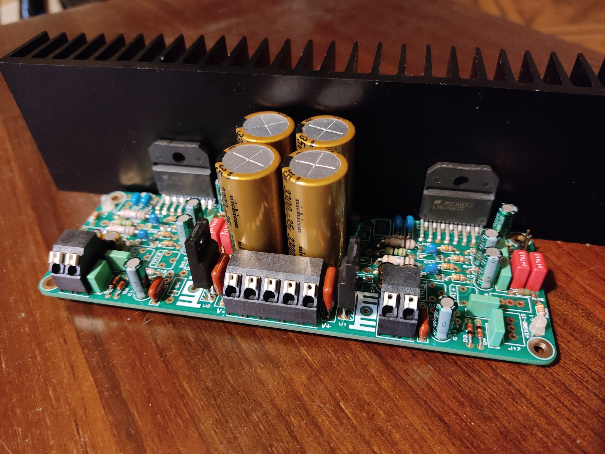

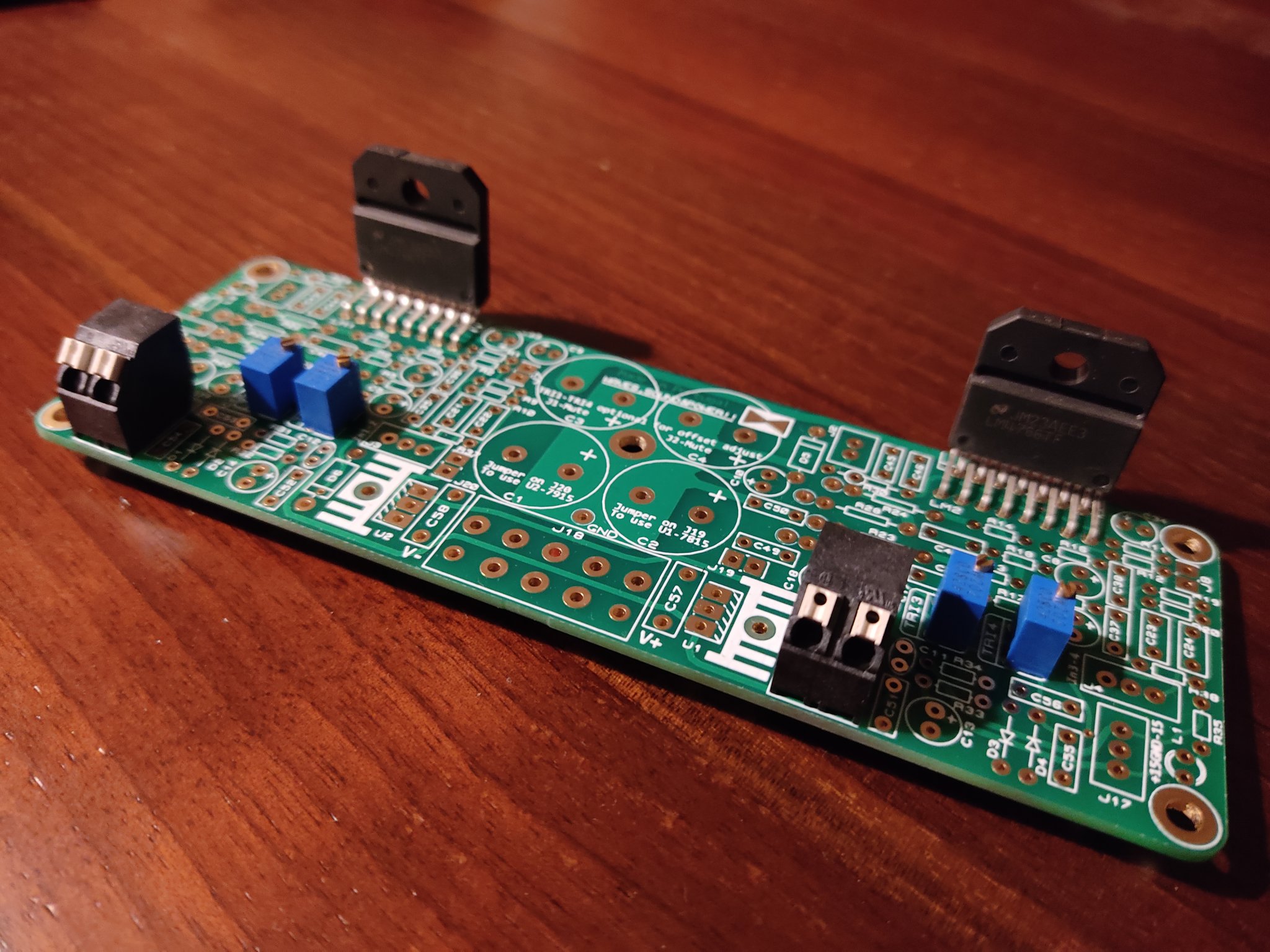

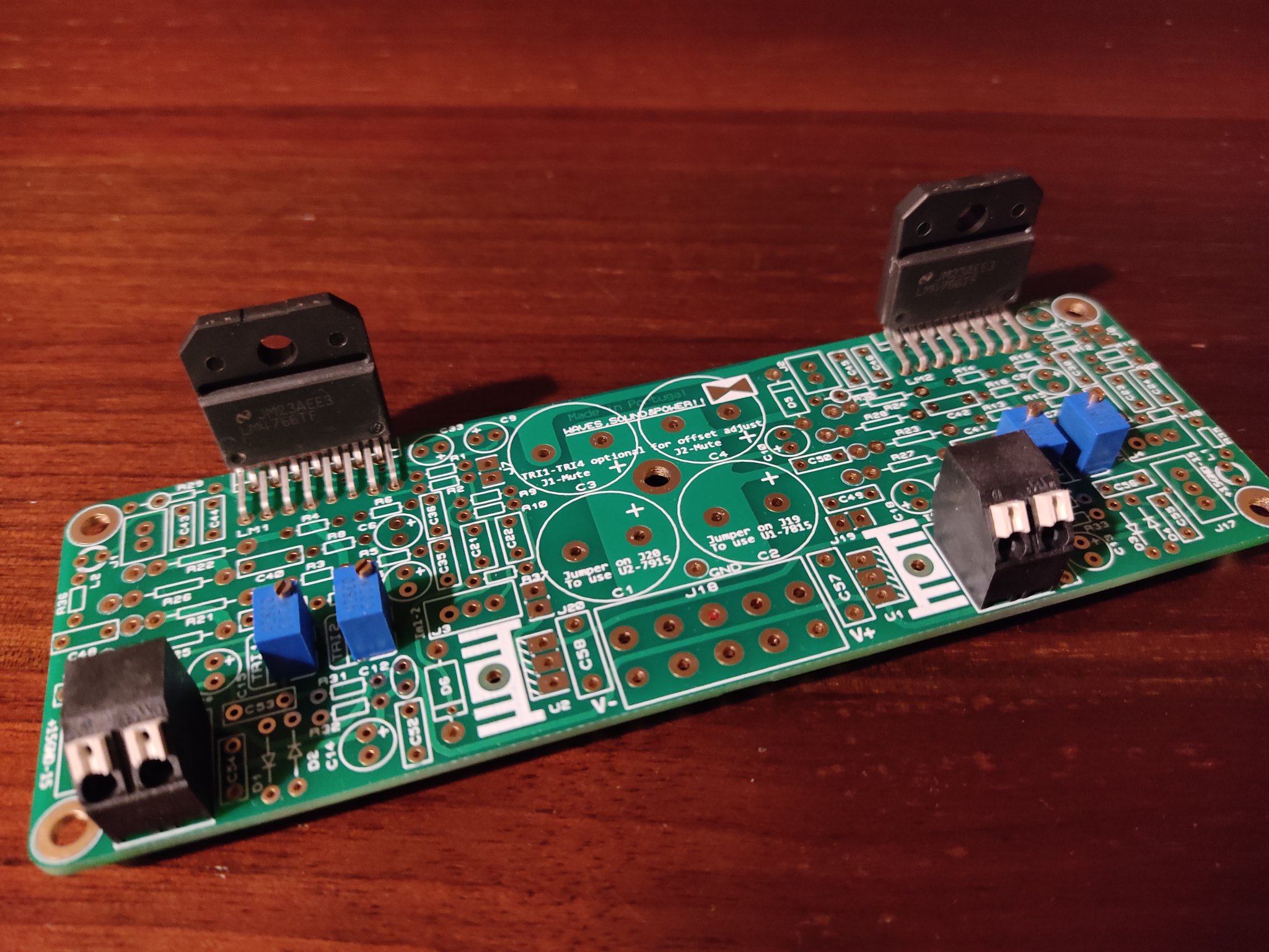

Hello for everyone,
I have recently developed this 4 channel module based on LM4766, I have already a module for powering up a subwoofer mid and high's but don't have enough power for powering up an 8 inch sub only good for about a 5 inch subwoofer.
https://www.ebay.de/itm/325598018547?hash=item4bcf277bf3:g:BlMAAOSw5KpkKCbh&amdata=enc:AQAIAAAAwIMf3ZXyegKd/KV1KqTSkxHlTCZgUp2mxp4uU2nvoyKN5207KlbNhn0COUkDrdBztyAiuQIcuGBHD080SobUrEe7eUlgQo9CXUHMuG9qDEvH63ksYlY1Rm2tw5AZrv8Bxwvpe2M9wqmYcCCGaFLyA6DW9m9CMHfEuJQ+lyEcOR+/KKwFb5Xk5jclNEs2Cj7+Xo6kp48XeTpcEA7qD7wmd+4031/CKJp3GoHVb+ai61HBp7BHz40oSG6783o/rCKZZg==|tkp:Bk9SR5DEtJOKYw
So I develop this module, it's outputs are configurable as 4x50; 2x100; or 2x50 more 1x100, I would like to know if there more people interested on this and if there is someone that know a good power supply SMPS running on 12V that produce +30V -30V to use in car áudio?
In the worst I develop my self,Regards

I developed this module and is almost complete, I will do all the tests, I am reposting because
I would like to know if somebody could suggest a good smps for this amp, that works on 12V,
any tip would be great,Regards

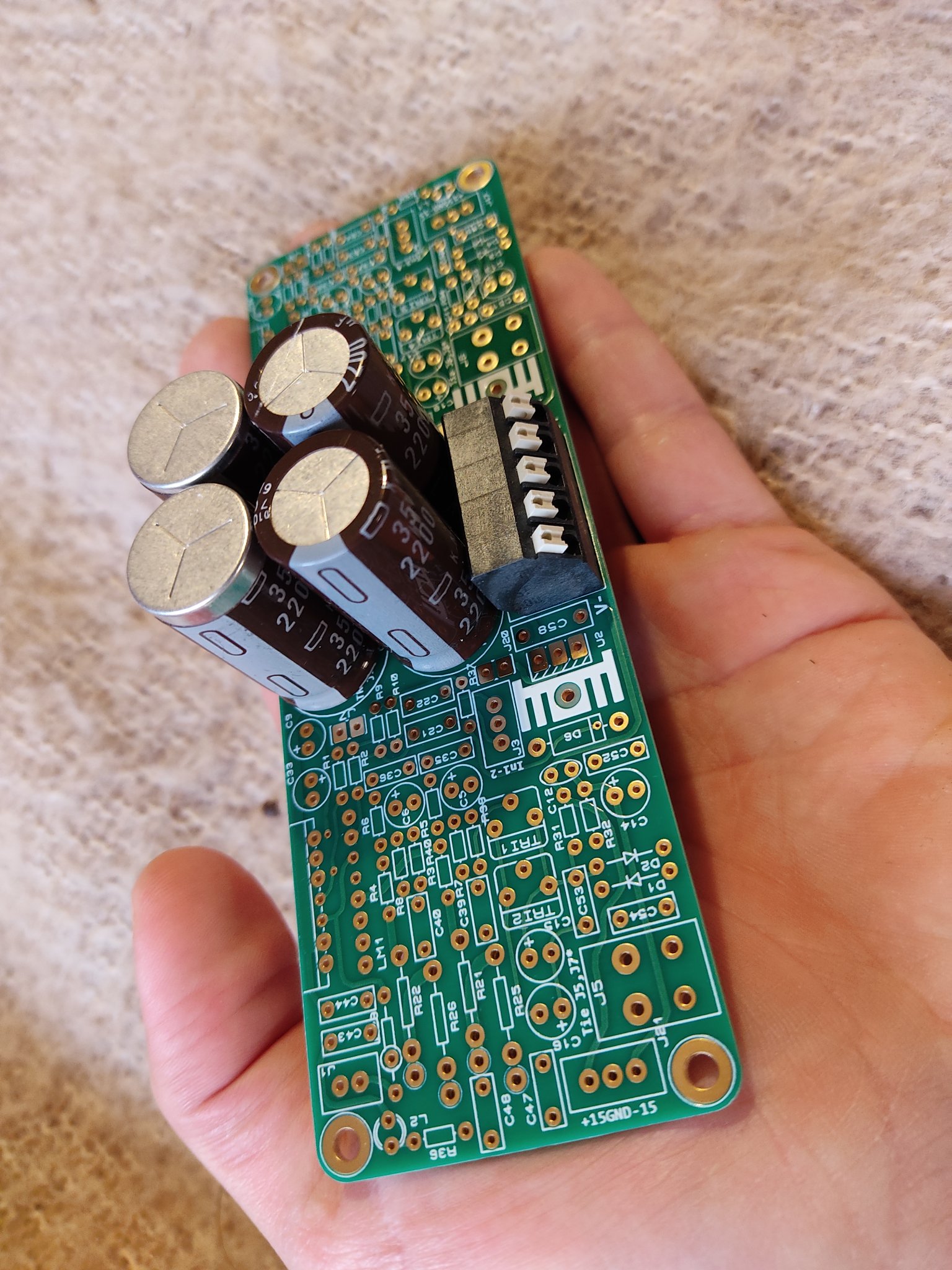

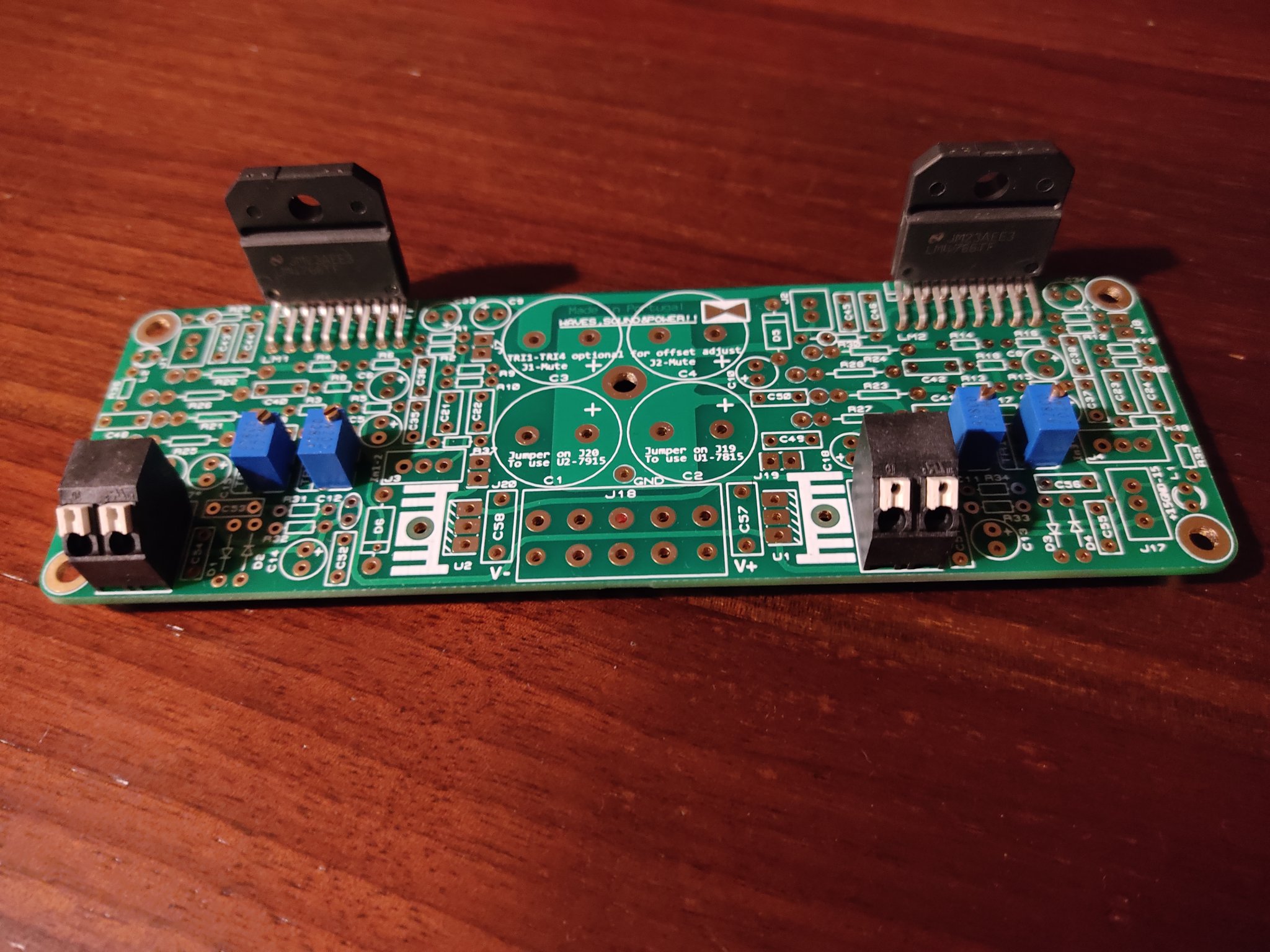

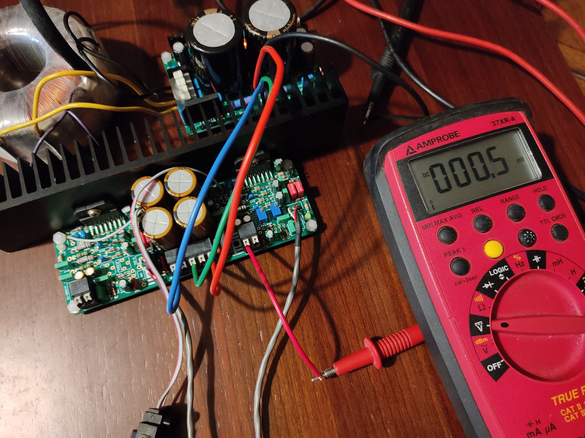

Hello for everyone,
I have done all the testing with this module, I created this post for the people that would have interest in a 4 channel amp module.
I wanted to check if someone knew a good smps from 12V to plus minus 30V in order to use this amp in car audio, until now no one
mention any, and I will develop in order to use this amp module for car audio to use for myself and to other diy people.

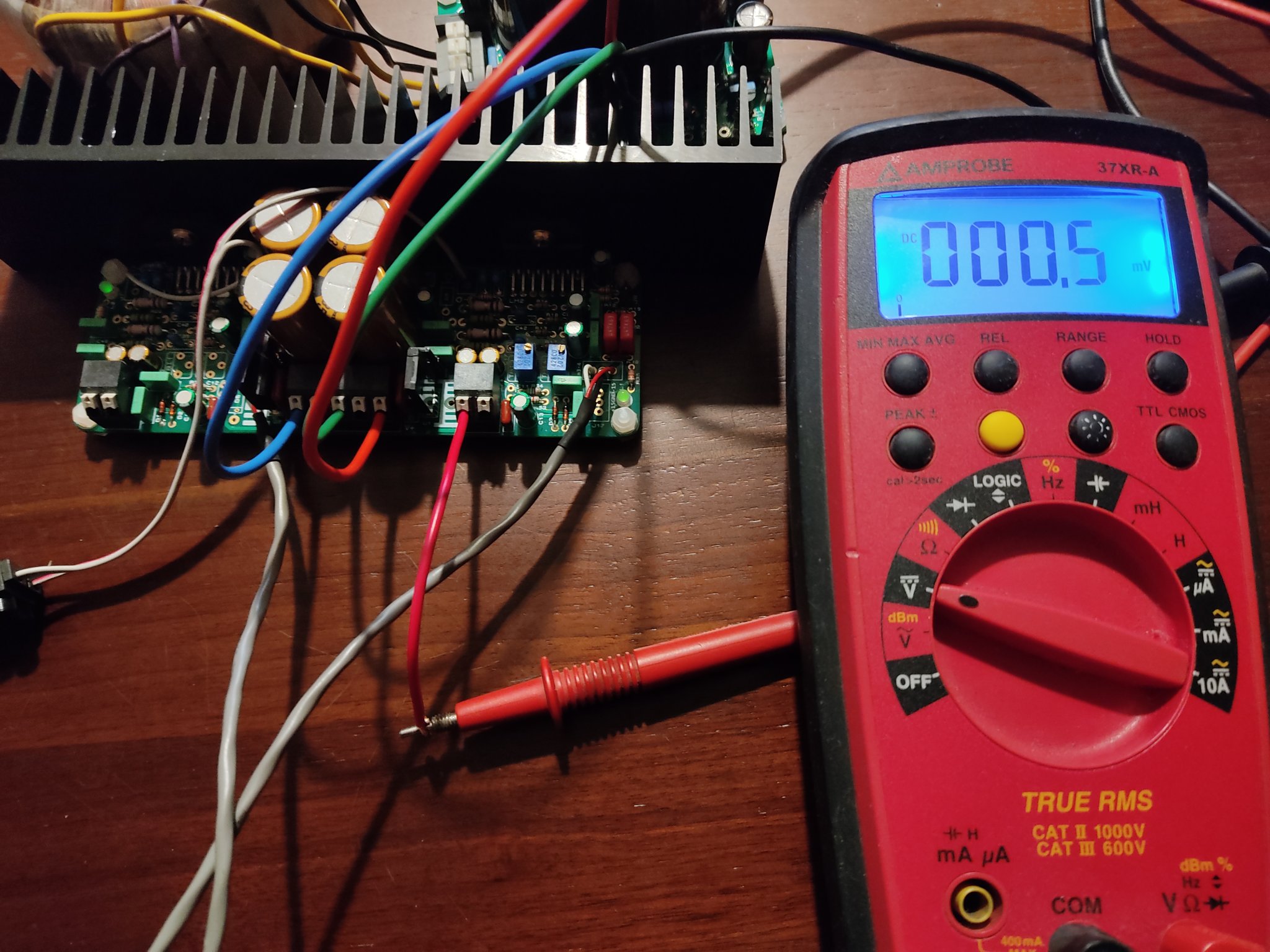

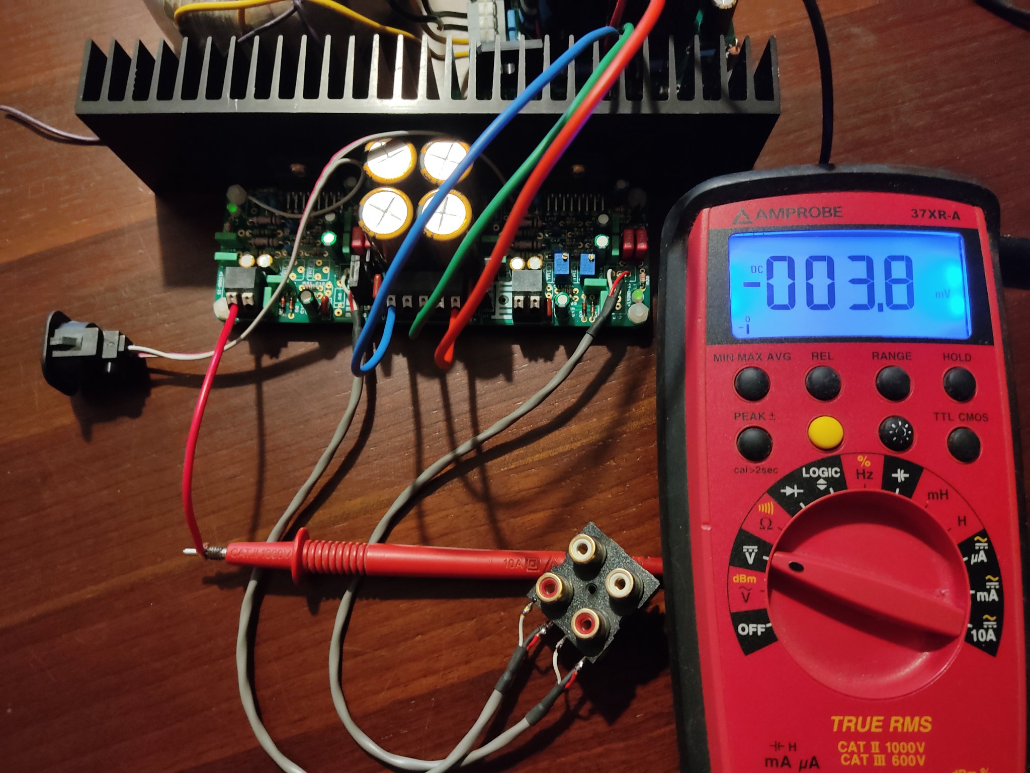

On this module, it's outputs are configurable as 4x50; 2x100; or 2x50 more 1x100 Watt making it suitable for Hifi stereo,bi-amplified speaker system or multi-channel.All channel are free of noise "no hiss" very clear sound.
On the example pictures shows that with the optional trimmers which were applied on channel 3,4 the output offset voltages can be adjusted near to zero, without trimmers on channel 1,2 the output offset voltage was around -4mV.
