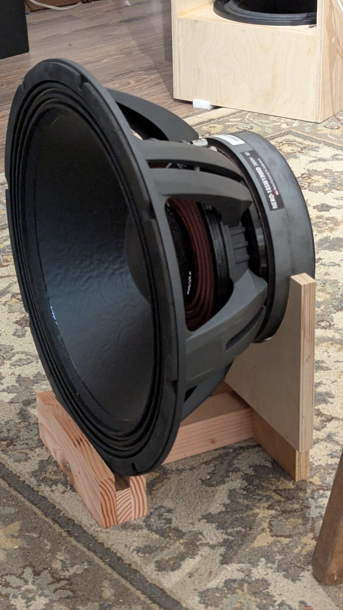

I was too busy to build proper enclosures for the two NERO-18SW1900D drivers, and just had them running naked OB for a while. With enough power and EQ, two of these subs reach nicely below 30Hz, but it's not ideal. Neither are 2 160 liter boxes, to the boss of the household. Admittedly, I would not like such big boxes in my LR either. 😉

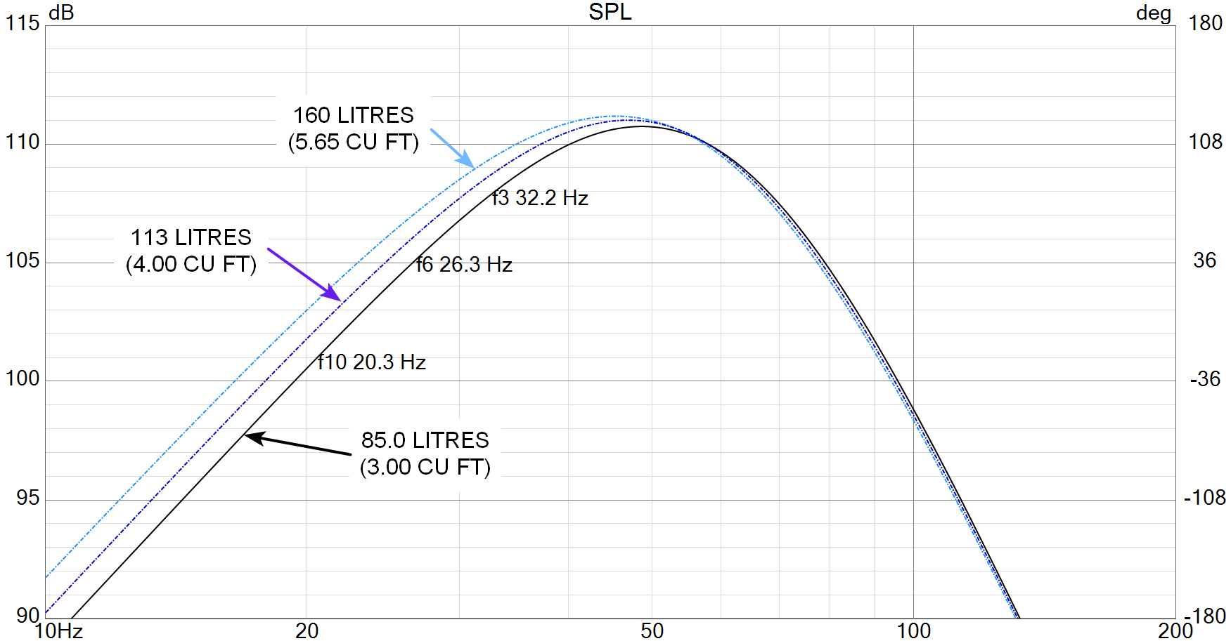

Sure...happy to run the simulations for the NERO-18SW1900D. Below are the results, with QA=QL=30, a 4th-order Linkwitz–Riley low-pass filter set to 58Hz, and the enclosure volumes set at 5.65cuft, 4.00cuft, and 3.0cuft (equivalent to 160litres, 113 litres, and 85.0litres). At 30Hz, reducing the enclosure volume from 160litres to 113litres drops the output by about 0.8dB, and when the going from 160litres to 85.0litres the SPL output drops by about 1.3dB. These certainly aren't huge differences.OTOH, that's asking more than I need. Could you please do your magic for 3 & 4 cf sealed boxes?

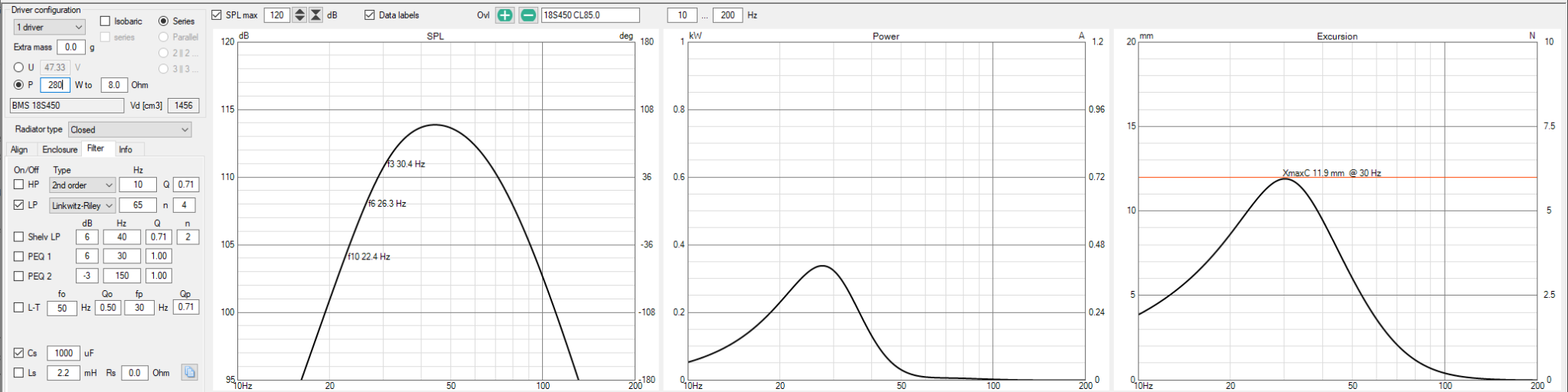

Sticking with the 85-litre enclosure, I've tried adding a series capacitor to see what it can achieve in terms of boosting the low-frequency response. This is a method that I believe Arendal use in some of their speaker systems, judging by the published impedance curves. The solid black curve below is the frequency response obtained when a series 1000µF capacitor is added, but the power input has also been reduced from 240W re 8Ω to 130W re 8Ω. Note that a 4th-order Linkwitz–Riley low-pass filter set to 68Hz is also in the system.
For the same enclosure settings as above, but with the power level increased to 660W re 8Ω, the simulated frequency response, power and driver excursion curves are shown below. Note that the capacitor is providing a 1st-order high-pass filter roll-off below about 25Hz.

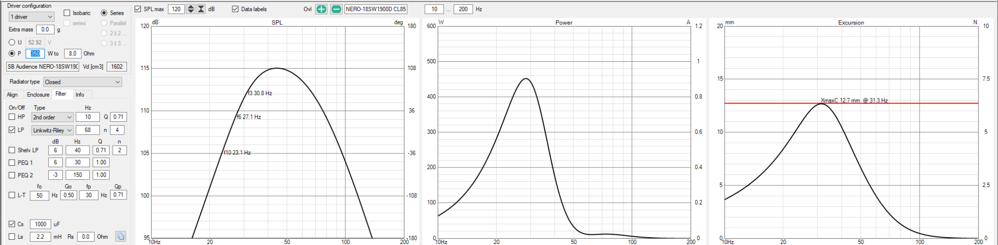

For the BMS 18S450, we get the following response curve for a 85-litre enclosure. The input power level is 280W re 8Ω, there is a series 1000µF capacitor, and the low-pass Linkwitz–Riley low-pass filter is set to 65Hz. The low-frequency extension is very similar to that of the NERO-18SW1900D, apart from the reduction in maximum SPL.
Thanks for the sims! Interesting how little the response changes with Vb halved!Sticking with the 85-litre enclosure, I've tried adding a series capacitor to see what it can achieve in terms of boosting the low-frequency response. This is a method that I believe Arendal use in some of their speaker systems, judging by the published impedance curves. The solid black curve below is the frequency response obtained when a series 1000µF capacitor is added, but the power input has also been reduced from 240W re 8Ω to 130W re 8Ω. Note that a 4th-order Linkwitz–Riley low-pass filter set to 68Hz is also in the system.

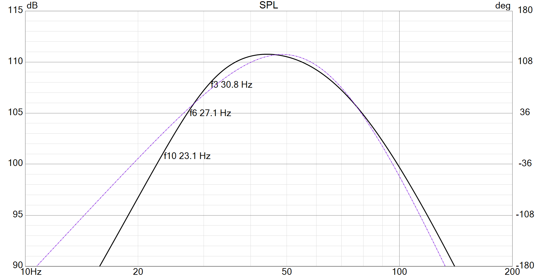

Yes, the series capacitor increases the low-frequency roll-off slope by 6dB/octave. In general, I would say that increasing Vb does not really alter the roll-off slope, but rather it modifies the response around the knee of the curve. This effect will also be dependent on the nature of the low-pass filtering that is being applied. That's because all of these filter functions are interracting together to produce the overall response.

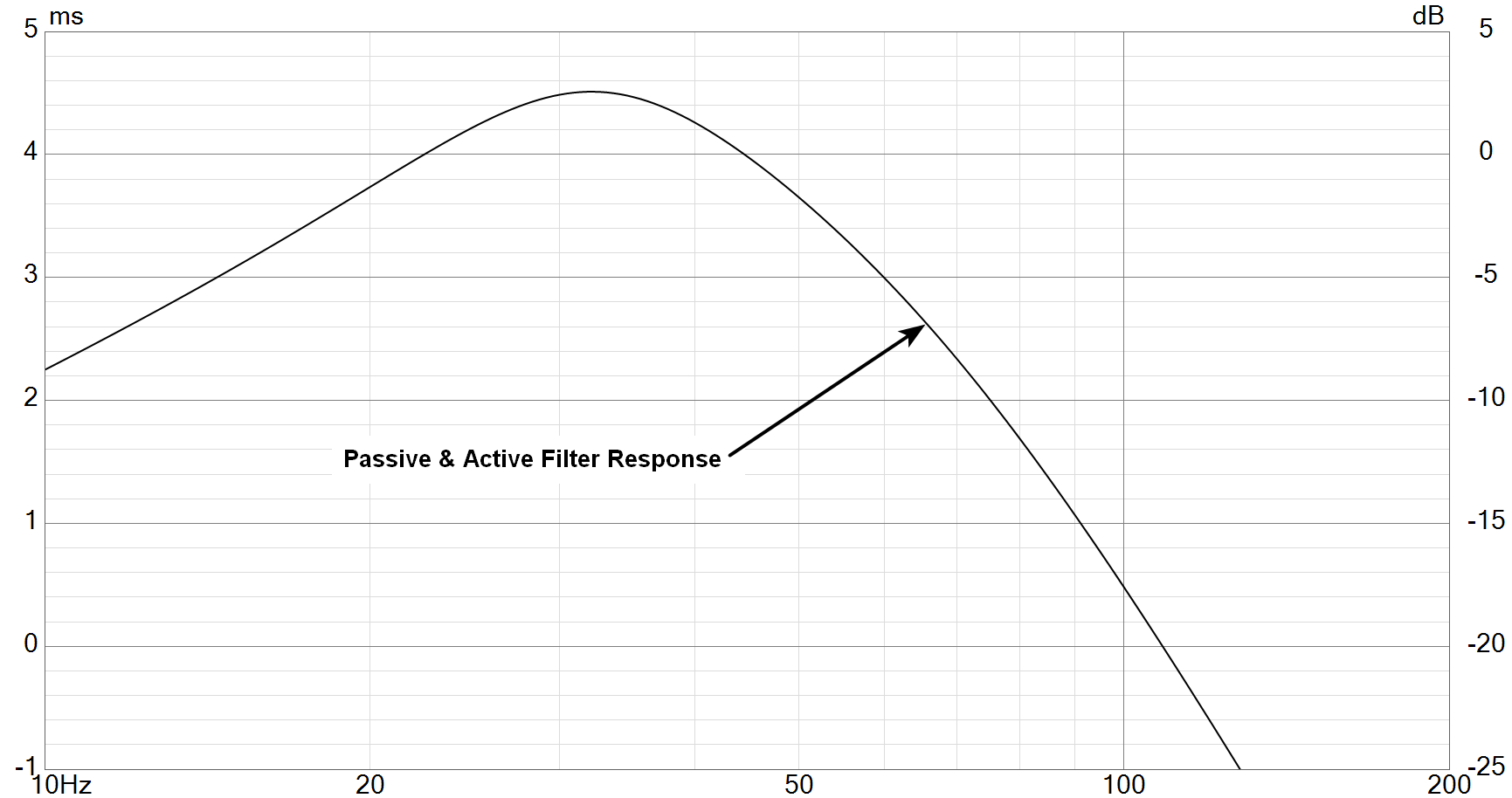

The series capacitor also provides some boost in the band-pass region of the subwoofer. This is illustrated by the plot shown below. The high-frequency roll-off is due to the action of the active low-pass filter that was added to the circuit. The low-frequency roll-off includes a boost region in the 23–44Hz frequency range, with the maximum boost being about 2.5dB. That is simply passive gain that has resulted from the interaction of the series capacitor and the driver's in-box impedance peak. The use of this simple technique was described by Thiele in his 2010 paper "Closed-Box Loudspeaker with a Series Capacitor".

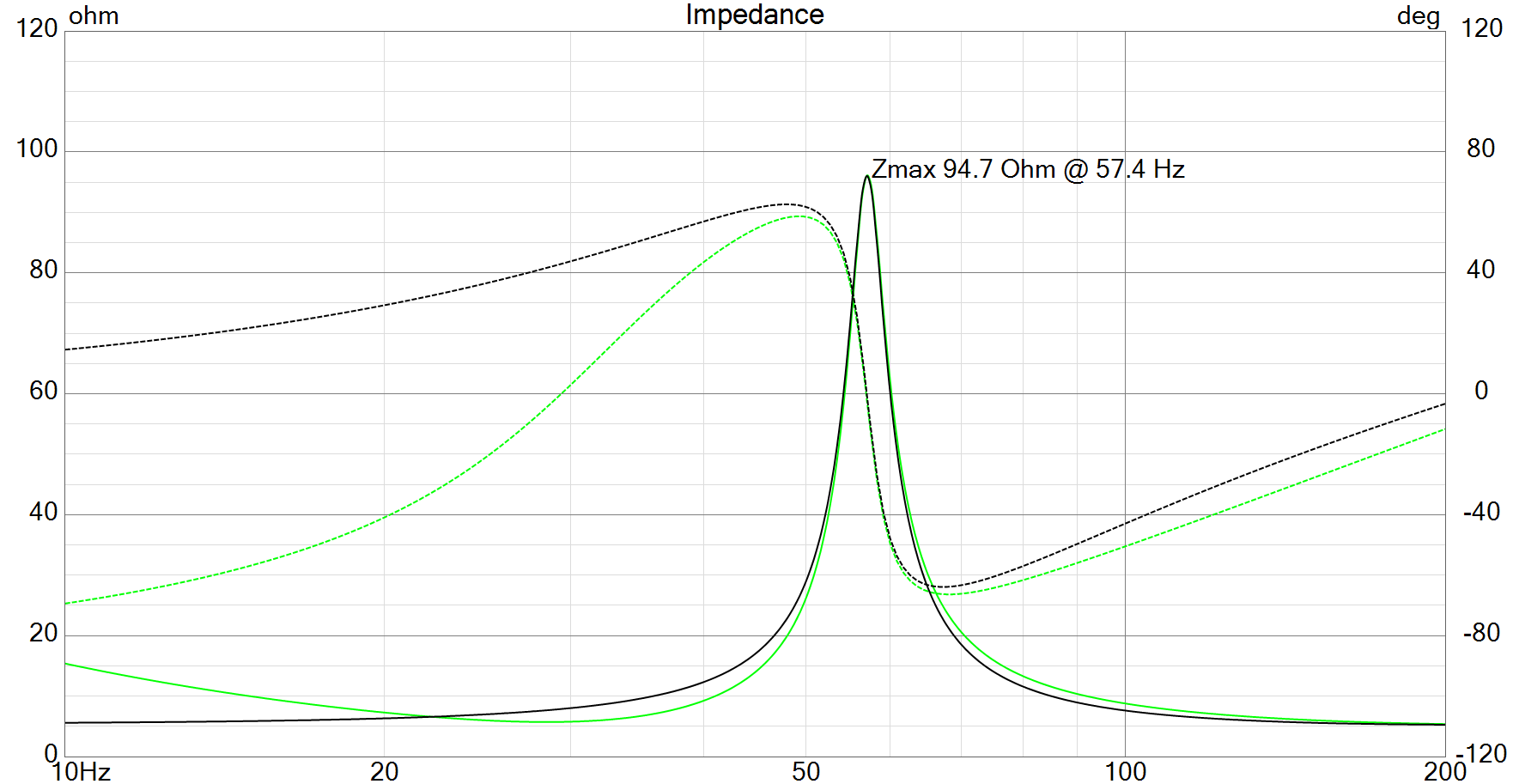

As to what effect it has on the amplifier, that will, of course, depend on the amplifier. It seems worthwhile studying how the series capacitor affects the impedance curve of the subwoofer. In the plot below, the black curves are for the subwoofer alone, while the green curves are for the subwoofer with a series 1000µF capacitor added to the circuit. The solid curves correspond to the relevant magnitude response, while the dashed curves correspond to the phase response. In the frequency above the impedance peak, the impedance is a little more capacitive in nature, as the phase is a bit more negative. Below the impedance peak, in the frequency range from 30Hz to 55Hz, the impedance is more resistive (less inductive). In the frequency range from 10Hz to about 30Hz, the impedance becomes capacitive in nature, whereas previously it was inductive. However, the phase at 10Hz, which is about −70°, is not much less than the phase at 67Hz, which is −64°. Hence, the question seems to be whether or not a typical solid-state amplifier will have an issue driving a capacitive impedance load at frequencies around 20Hz. Maybe some amplifier designers can provide some advice on that topic?

For the BMS 18S450, Xmax = (Hvc−Hg)/2 = (36−12)/2 = 12 mm.
For the SB Audience NERO-18SW1900D, Xmax = (Hvc−Hg)/2 = (39.5−14)/2 = 12.75 mm.
Hence, using this more conservative definition of Xmax, it's apparent that the two drivers have a very similar Xmax, differing by 0.75mm. Re-visiting the simulation for the NERO-18SW1900D using the new lower value of Xmax, the results for an input power level of 350W re 8Ω.

Sorry, not much work on them. Still on those makeshift cradles completely nude. When test signals are run at high SPL, there's some chuffing noise, but I never hear it when music is playing. Usually below 100 dB SPL. I may have taken them past Xmax with test signals and some test tracks, with high EQ boost below 50Hz -- the usual crunching sound, but no apparent damage. Still using 300W amps but might be getting 600W ones.Hi @mikessi,
