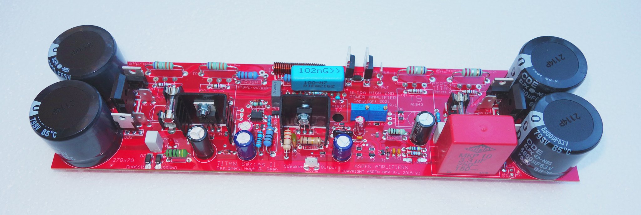

I have continued with R&D and in the last years created the NAKSA, the Maya, the SAKSA, then recently the TITAN. By evolution they slowly improve each time, and the Titan is my middle product, between SAKSA and Maya, and does 125W//8R. It uses a Toshiba bipolar output stages, like the AKSA, but a far superior amp to the old AKSA. Here is the picture below.
