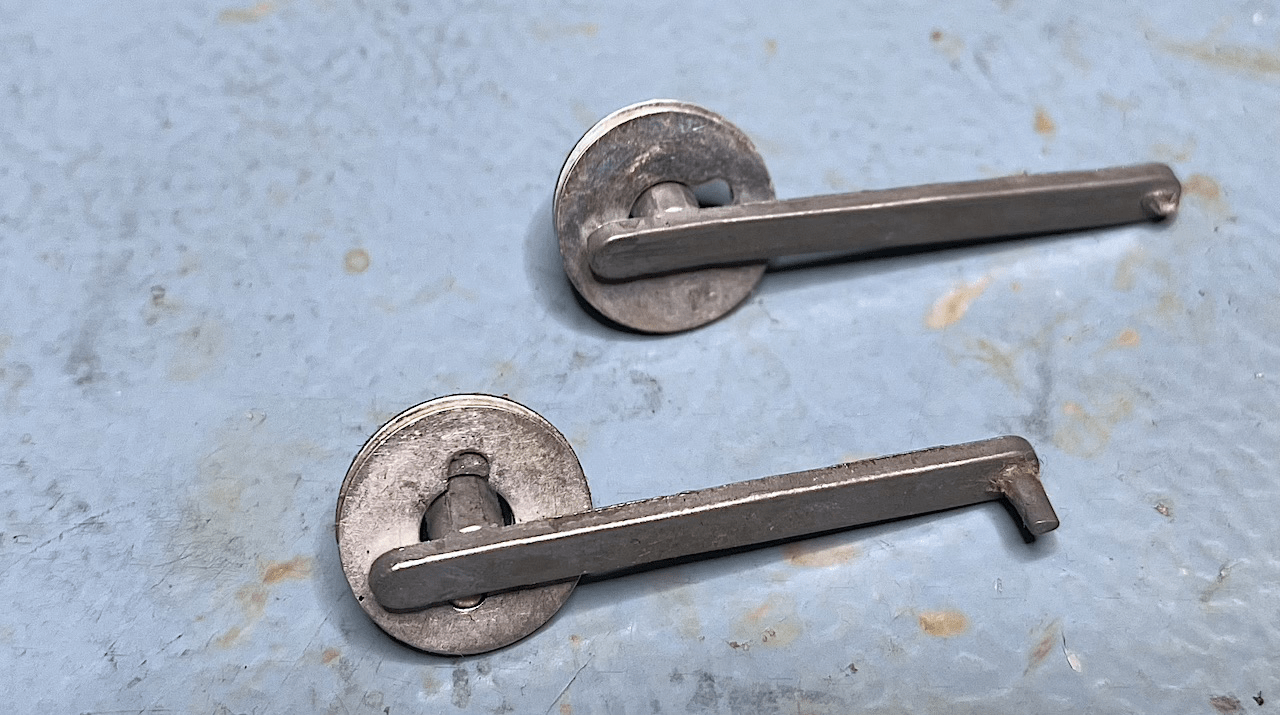

The transformer on the lid is because I'm a V.S.G. (Very Stupid Guy) and I broke the small metal piece that holds the lid on. I managed to rebuild it but I broke it again because I'm a V.S.G:
https://streamable.com/d2bjoh
That's what I broke:
I don't know where can I find a new one. Well, I can repair it but it's better a new one.
