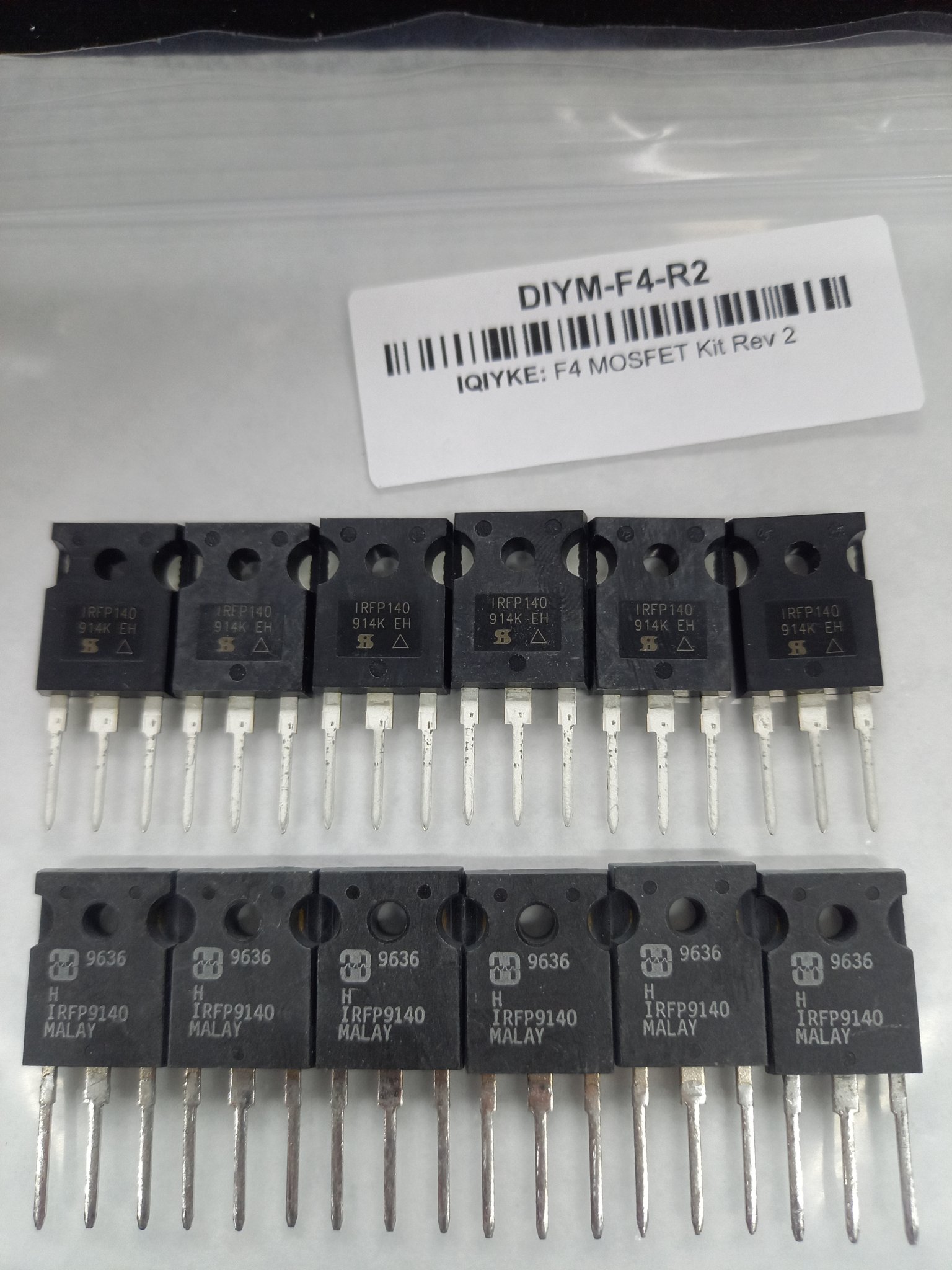

Please help, if anyone is willing. Are these good mosfets for building f4 amps? bought in diyaudio store.
A couple of years ago when I made my first f4 I used these, also bought in the diyaudio store
6L6
Moderator
Joined 2010
I assume IRFP140 is N channel and IRFP9140 is P channel. Will there be a big sonic difference between the left and right channels when I run both amps as monoblocks, since each monoblock has a different type of mosfets?
That’s not how it works.
Each F4 PCB needs three N-channel and 3 P-channel.
How you utilize those assemblies later, Stereo amp, Parallel mono block, Bridge monoblock, has nothing to do with the fact that each F4 PCB needs three of each N and P.

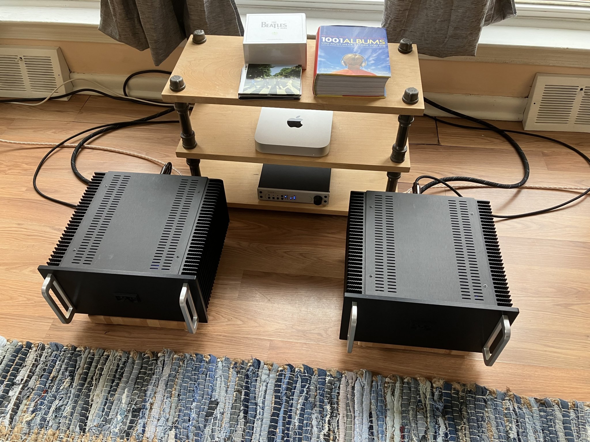

running F4 monsterblocks with balanced input, they are very, very neutral. So neutral, I'm building various preamp circuits as stand-alone front-ends/gain stages to play with flavor. Although, I have to rethink this as, after moving, the listening space is much smaller and the Benchmark DAC will drive them quite handily into hurty volumes.
