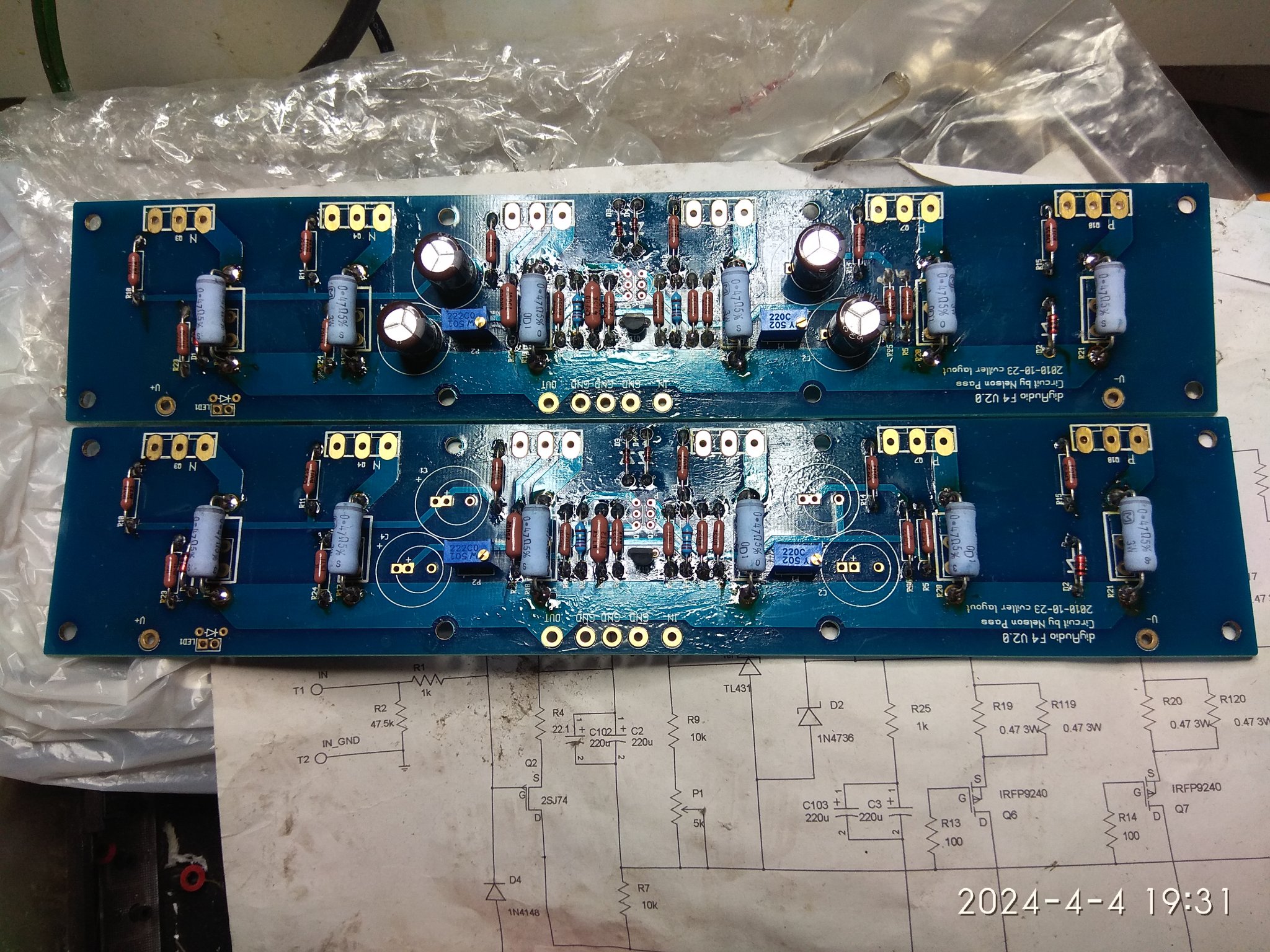

I'm confused because shematic is a bit strange.
C101,102 ,C4-104,C3-103 2x220uf but pcb isn't compatible.
That's why i ask if it's ok to use 470uf. plus i have ended up from 220uf when i have plenty of 470uf/50V.

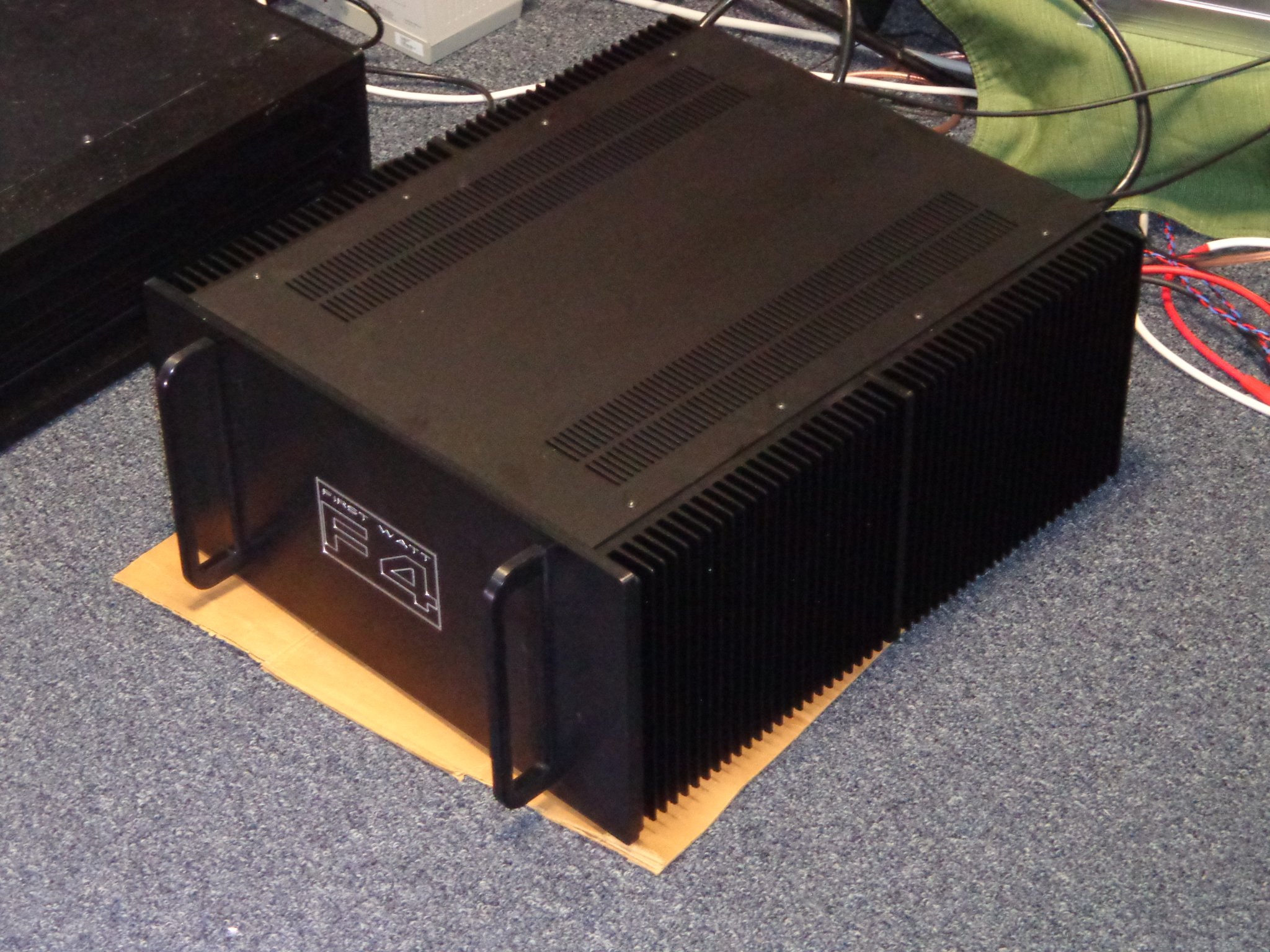

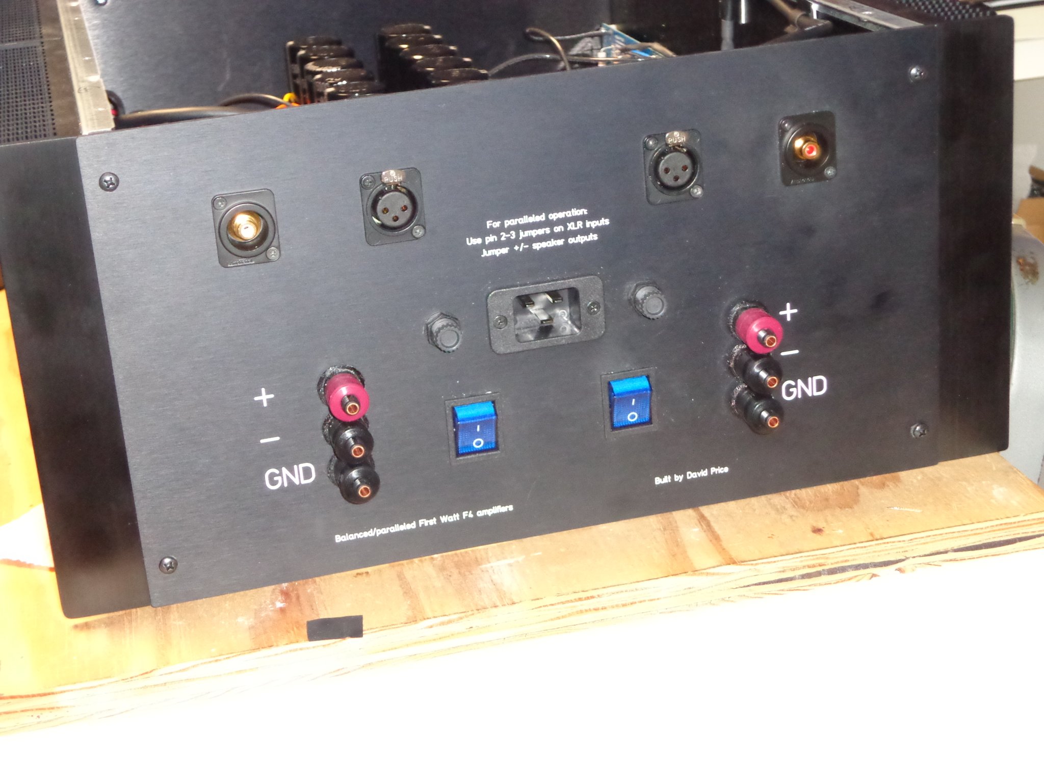

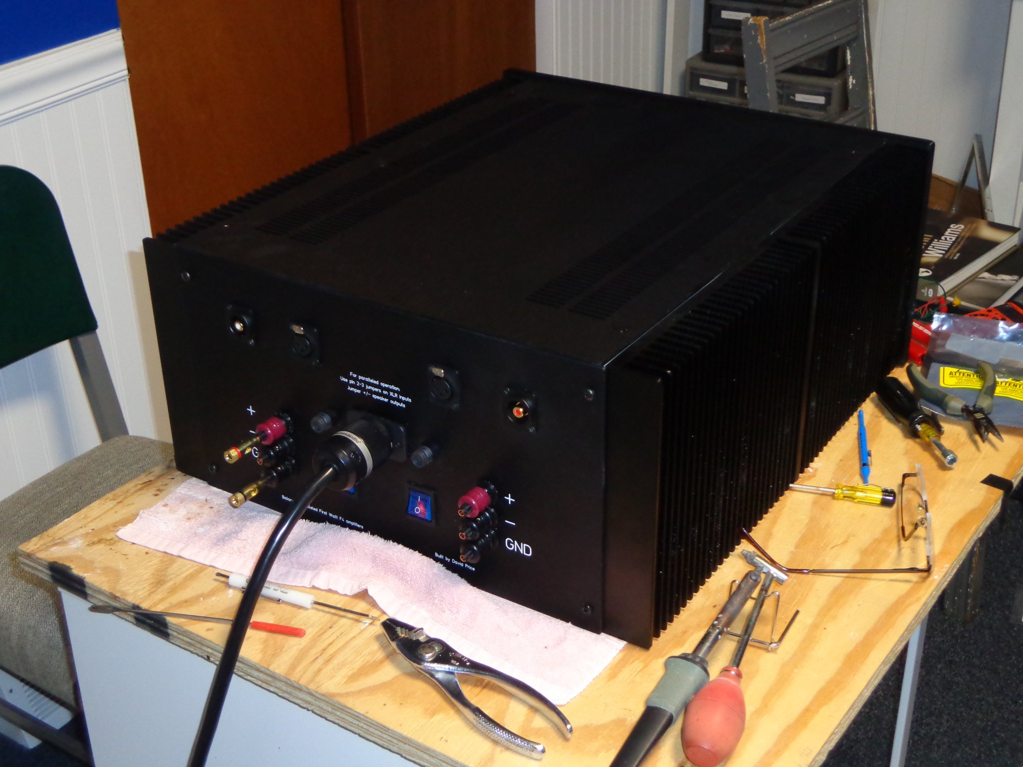

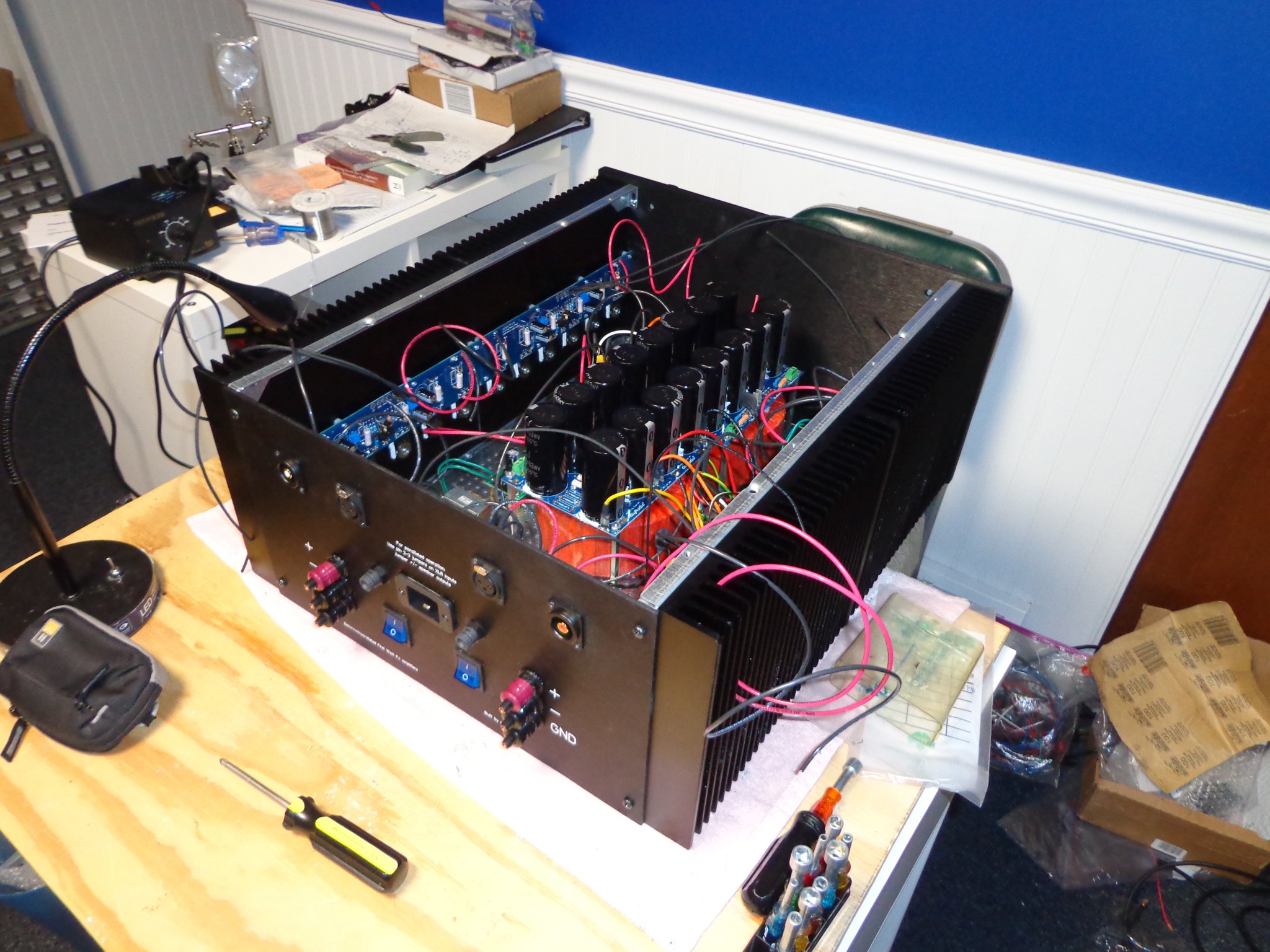

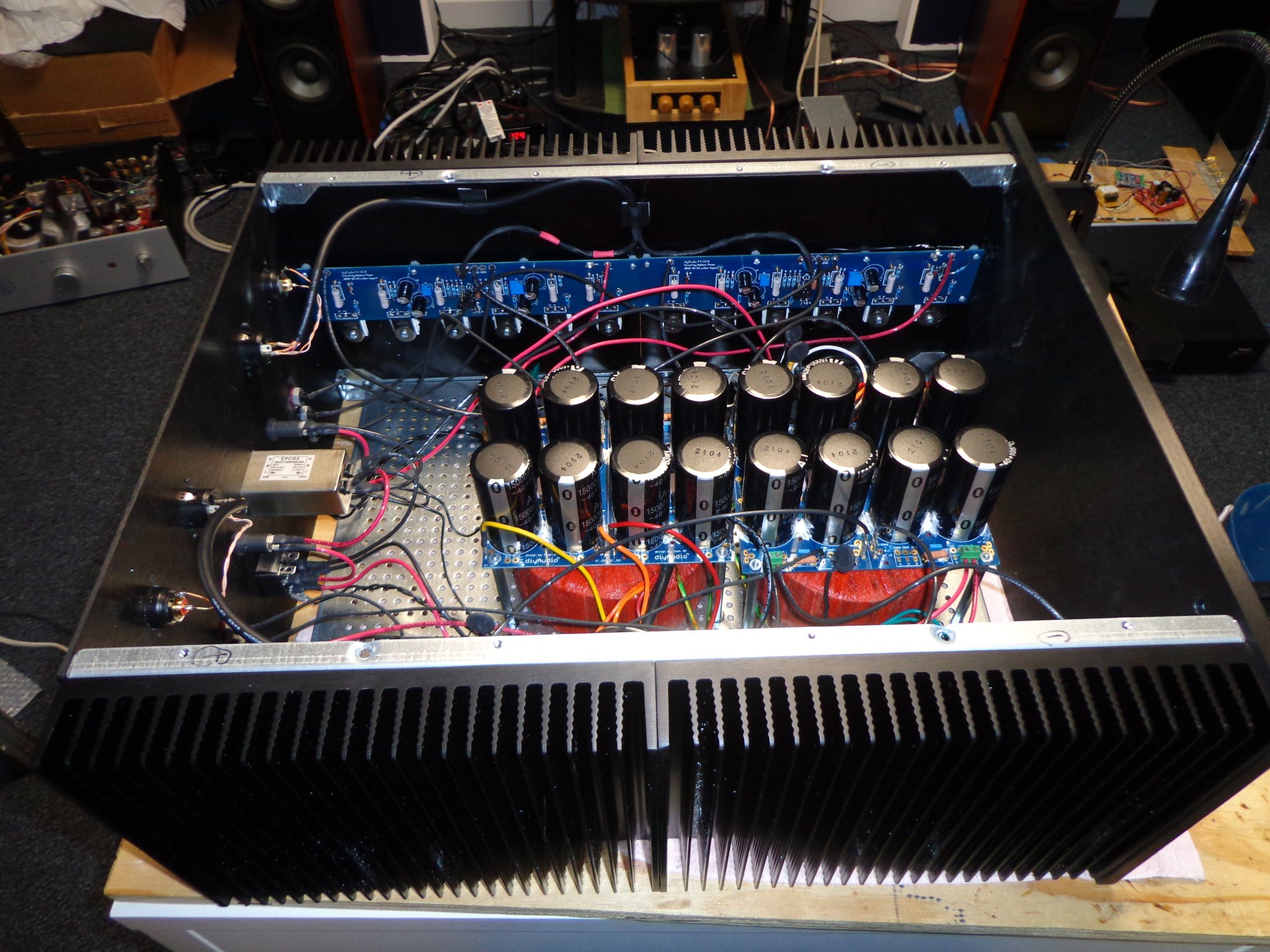

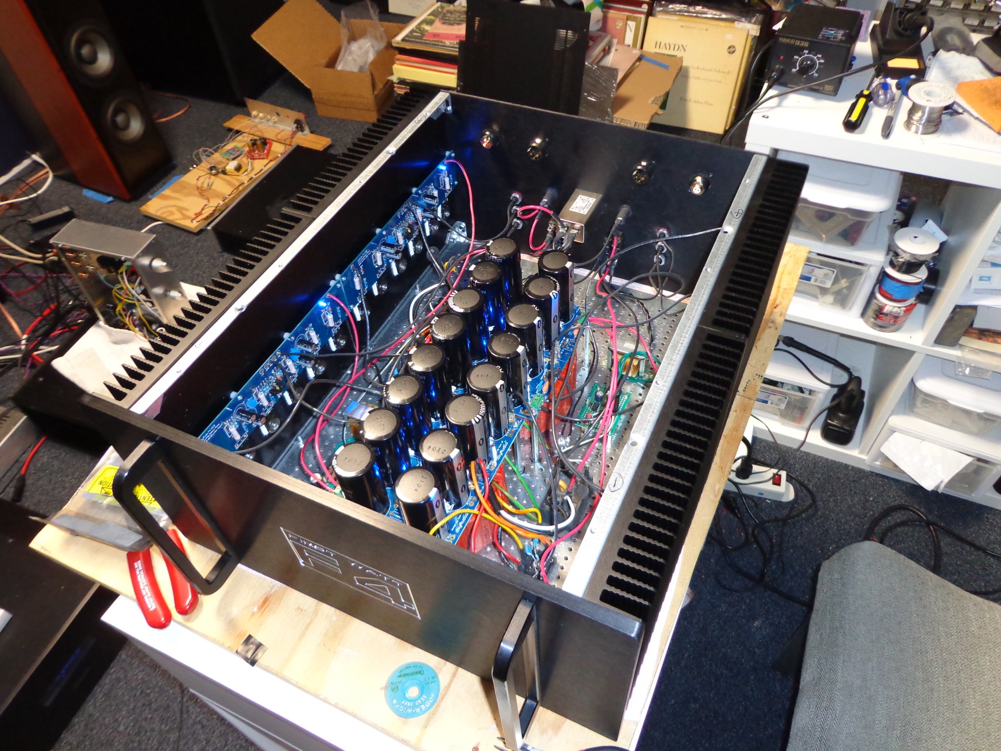

I've put two F4's in the same case - I didn't want to deal with two cases. It can also be run paralleled if jumpers are used. The devices and boards are from the DIY Audio Store, and the transformers from Tiger Toroids. The inrush current limiters are bypassed with a relay after 20 seconds or so. I used the cheapomodo to figure snubbers. Otherwise there's nothing innovative or unusual here. It sounds as you might expect - mighty fine. Please excuse the crappy camera, but I think the pics at least give the idea. The only disappointment - the lovely blue switches I got from Amazon have red LEDs in them, if you can believe it. Ruins the color scheme.
Thanks to Woodworker for his help in the planning stages. The amp runs about 52º on one side and 54º on the other (after running a break-in track overnight) and the biases are pretty close to spec, so I think I'll be OK heat-wise.

David,
Very well done! Wow! Is that a 5U/400 or 5U/500? And a dedicated 20A IEC to really draw some current from your wall! I would love to see harmonic spectra on this ‘balanced F4.’
Best,
Anand.
It's 5U/500 - I wanted to be sure to have enough heat sink. In its current position (next to an A/C vent) it stays below 50º after several hours of idle. Drawback - it weighs at least a half a pound per watt.

There are options there for wide or narrow lead spacing depending on the power resistor you choose to install there. They are available in different package sizes that still have the same resistance (.47r). I think this makes the schematic and part numbering confusing myself.
C1, C2, C3, C4 are the exact same way... different options for lead spacing. But shown in "parallel" on the schematic. But obviously you are installing a single part there.
