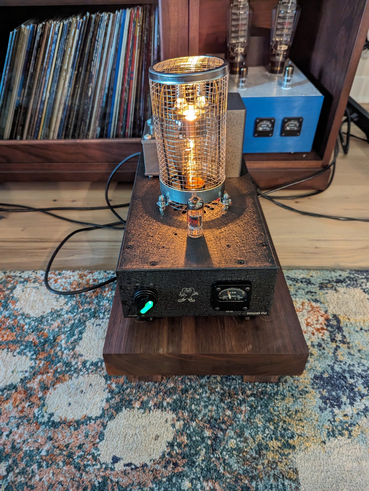

Finally built some amps using the VT-62 (RAF) triode (basically 4304CB or DET12, or 834 with a B4 base). Conservatively about 15 watts out. Hot as heck.
Driver is a triode/pentode with the pentode a DC coupled cathode follower to drive the VT-62.
Details at http://www.pmillett.com/gossamer.html

The blue amps are push-pull EML 520B amps. About 50 watts out. D3a triode diff pair, transformer coupled to the 520Bs, running at 500V, 90mA per tube. Lundahl iron. Never got around to publishing anything on them... But likely my best design 😁

Good to see more people using a cathode follower rather than a Mosfet to slap the following grid around. I understand why Fets technically are better but I like the built-in soft start mechanism in a cathode follower.

I did a two-stage design with a CCS-loaded pentode input and feedback from output tube plate to input tube cathode. I ended up with over 30dB of feedback, keeping the transformer out of the loop. Distortion was quite low, but anything that happens in the output transformer goes uncorrected.

Thank you for the design ideas of 6LQ8. I tried the same topology with 6EM7, but it wasn't successful because the triode's GM was too low. The high GM dissimilar triode-pentode has more advantages.
