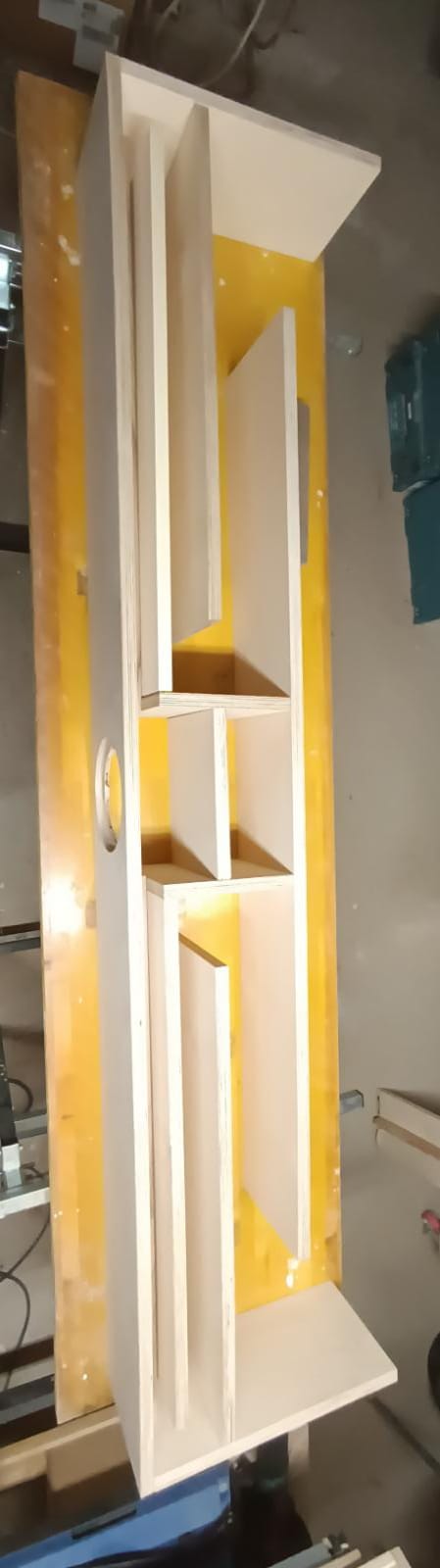

Another upgrade:
I have to say a big big big thank you to my friend Marco, who’s great skills in wood working are permitting this pair of Silbury to be built.
With my total newbieness (is it a neologisms?) I would have committed too many errors and probably they would be now the Pisa Tower limited version of the Silbury.

What is the difference between a front mounted speaker with the back beveled at 45 degrees, and a rear mounted speaker with the front radiused?
Essentially the same to the first approximation, i.e. reducing to inaudibility its theoretically infinite number of summed eigenmodes reflecting back to the driver, though best to make the rear bevel as random as practical (I use(d) a big, coarse rounded wood rasp originally and later a 'drum' bit for a large rotary grinder to 'hog' it out), otherwise more damping is required to quell all the random, yet summing, reflections otherwise modulating the diaphragm.
