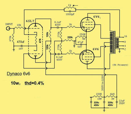

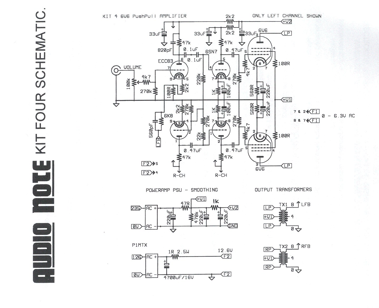

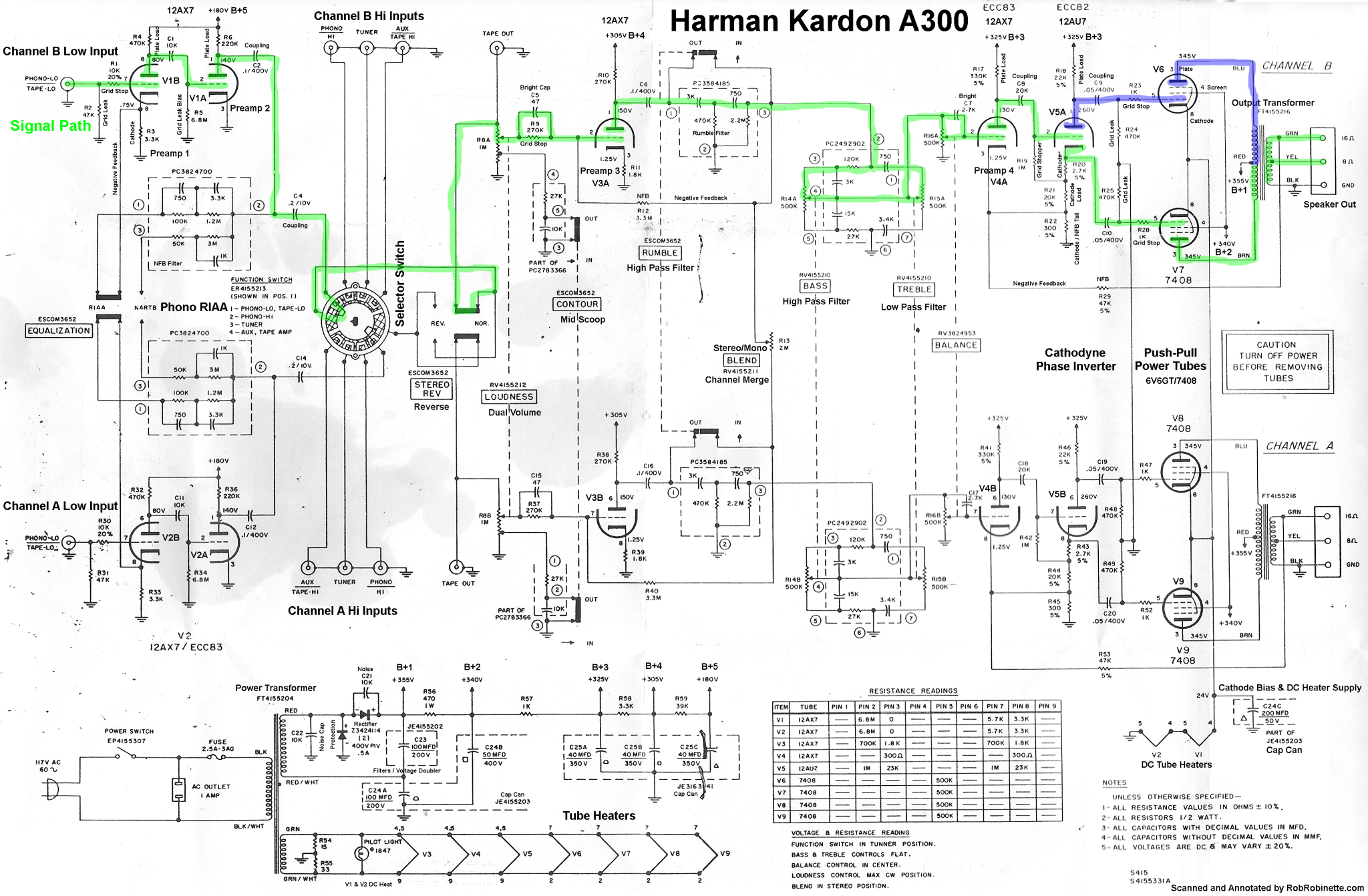

I have bought some used transformers and chokes. Hammond 1650E, and some 193J and 193C chokes. Have built a Tubelab El 84 PP clone and am very happy with the sound. This uses the same output transformers that I have now bought. I want to build an amplifier where I can use the parts I have bought. Thought a push-pull with 6v6? Does anyone have any good advice regarding forms? I build with point to point soldering. Haven't bought a power transformer yet, but that will be done very soon. I have built a few EL 84 PP amplifiers over the years, but was not really satisfied until Tubelab's EL 84 PP was built. Have a lovely winter day! Yesterday it was minus 15 degrees Celsius here, maybe a little warmer outside today?
dynaco 6v6
audionote kit four
harman kardon a300

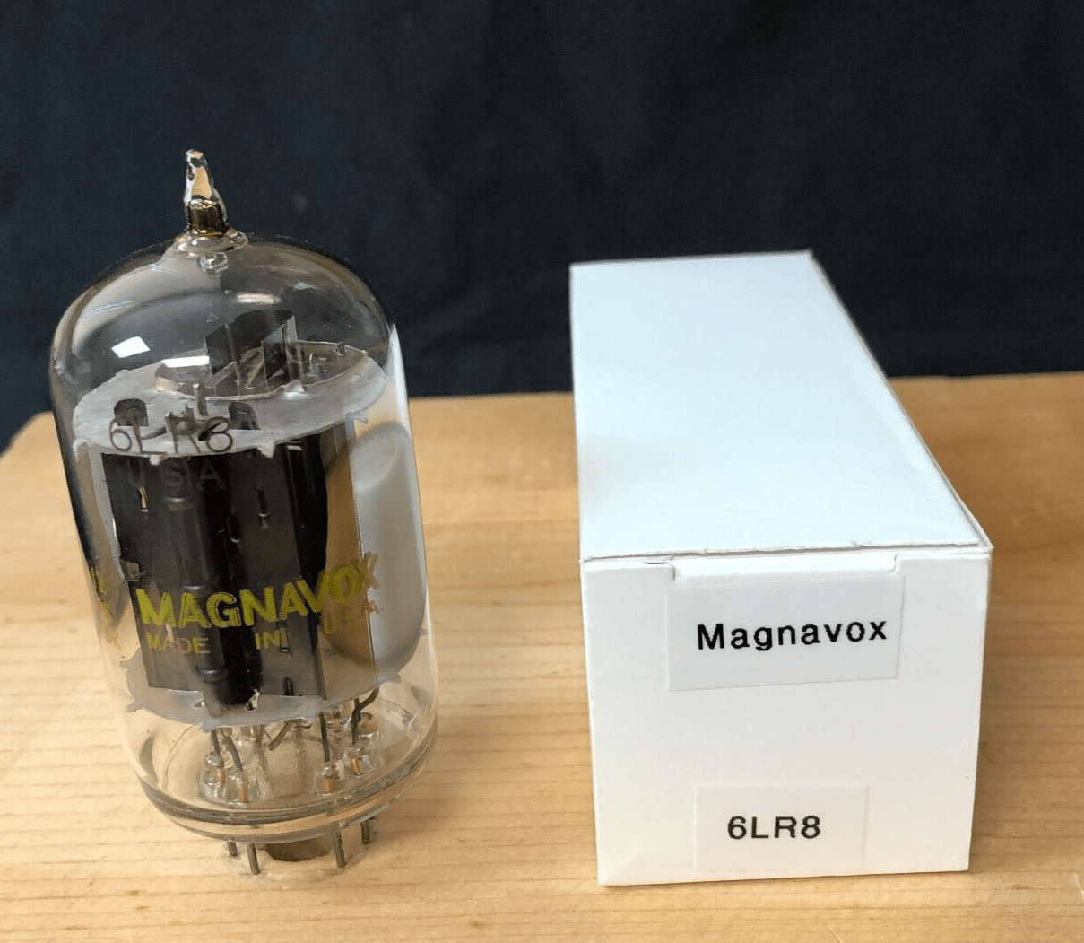

I am working off-and-on designing the PCB for a push-pull amp using 6LR8s, with the triodes operating in differential folded cascode configuration to drive the pentode outputs. The amp will also have a self-balancing circuit of my own devising. If the balancing circuit works out, it will go into other amplifier designs.

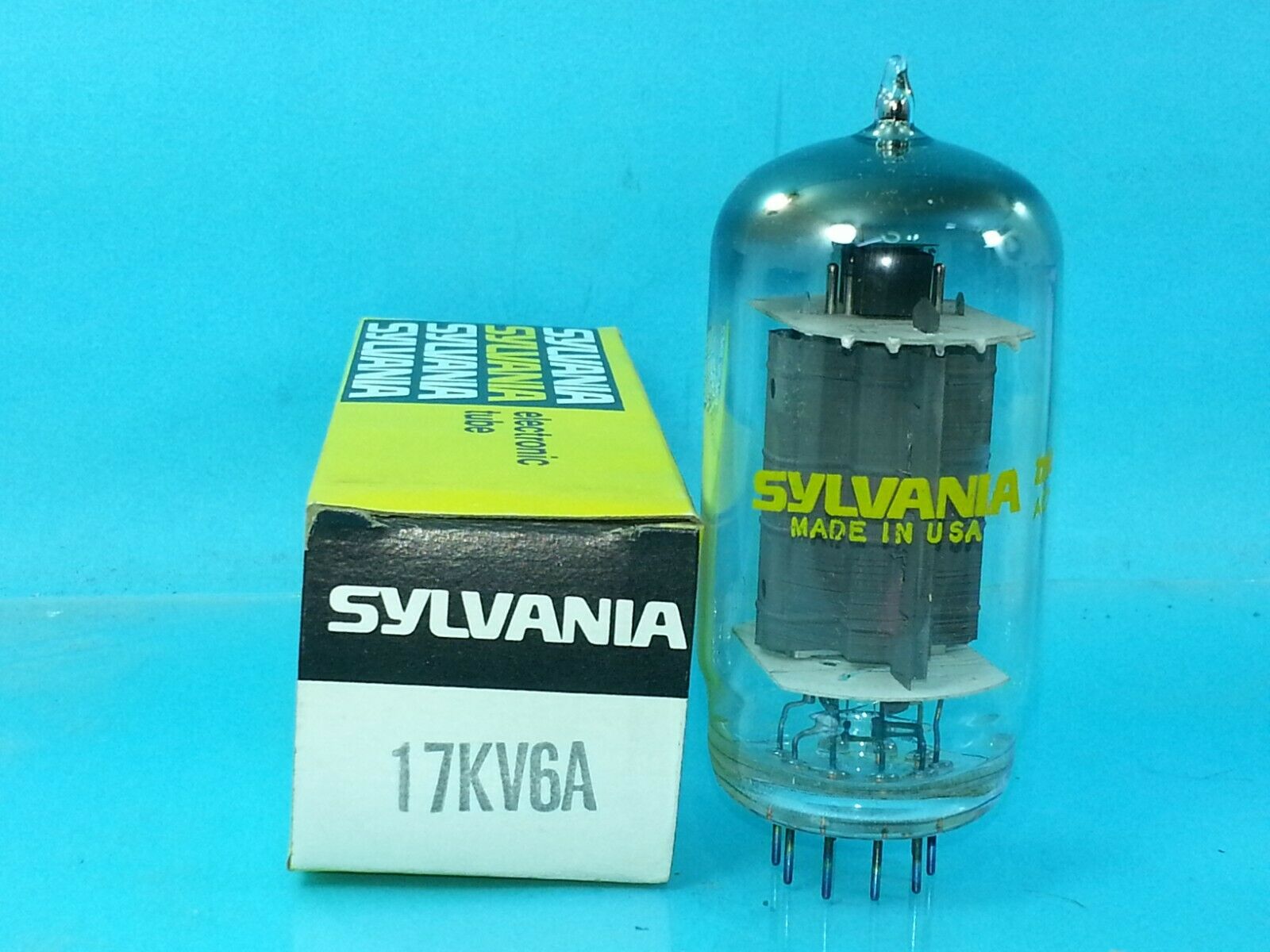

Got Novar sockets.... Which one ?
Hmmm... well Sylvania 17KV6A looks the best, with those old fashioned seal tits on top 😗
Oh, 6LR8 has got them too! (not GE ones though)
OK, 6LR8 then. Never mind what they sound like.
