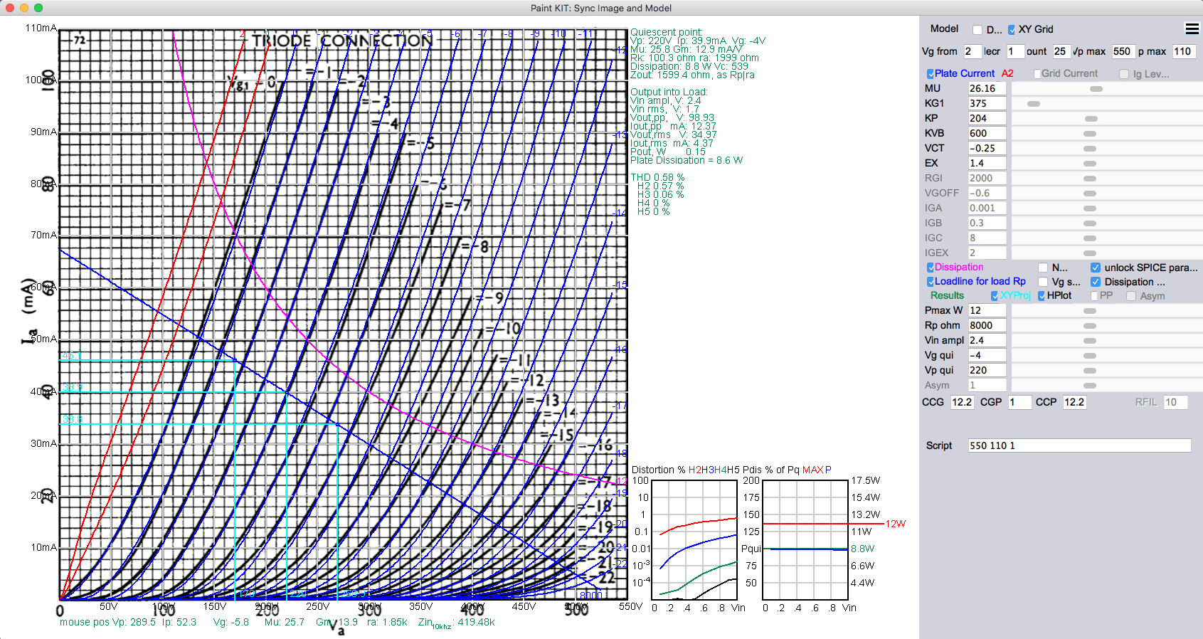

The straightforward answer is that the N78 and A2134/CV4062 have quite different electronic properties. That means that each delivers their best when working with a different quiescent plate voltage and current ("operating point) with a different plate load.
Let's do some quick and dirty estimates from the triode plate curves that Zoran has posted above.
These are the rough-as-guts estimates for operating the N78 and A2134 valves as triodes in Class A1. It shows that they will need different operating conditions of plate voltage (300V versus 185V), anode current (30mA versus 46mA) and grid voltage (-22V versus -14V). You could design a circuit in which the N78 and A2134 were "plug and play" substitutes, but I don't think it would get the best from either of them.
- For the N78, the blue diagonal load line shown corresponds to a plate load a bit under 8kOhm. Choose an operating point on that line and about half way between the 0V and -22V grid voltage curves. For the N78, this is where the load line is cut by the -8V grid curve. Reading down from that point (the "operating point") to the horizontal axis, we get a plate voltage close to 300V (measured from the anode to the cathode). Reading across and left to the vertical axis, we get an anode current of about 38mA. We now have the quiescent conditions of Vak=300V ia=38mA at Vgk=-8V with a plate load of about 8kOhm. Now work left along the load line from the operating point to where the the load line is cut by the 0V grid curve and read off the plate voltage - it's around 130V. So, for this load line, the maximum voltage swing is about 300V-130V=170V. Square that (28900), divide it by 2 (14450) and divide that by the 7.9kOhm indicated plate load to get 1.8W output power into the load.
- Now for the A2134, we have an indicated plate load of about 4.6kOhm. I chose an operating midway between the 0V and -30V grid lines where the load line is cut by the -14V grid curve. That gives an operating point around 185V and 46mA. The 0V grid line cuts the load line at a plate voltage around 75V so that the maximum voltage swing is about 110V. That would deliver about 1.3W power into the 4.6kOhm plate load.

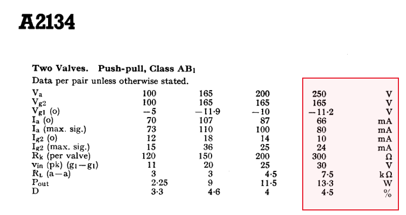

My push pull amp was also made specifically for tube rolling but it can get much closer to ideal performance because of the variable settings. So I’m looking for good starting points for the push pull amp.
- Notice that the N78 data specifies both the grid bias voltage Vg1 AND the value of the cathode resistor Rk, which indicates that the data was most likely for the valve operating in cathode bias. A few data sheets will also cite the value of the cathode bypass capacitor used.
- Where grid bias is specified but Rk is NOT, it usually means that the measurements were taken with the valve operating in fixed bias. The first page of the Mullard EL84 data sheet is an example (here: http://www.r-type.org/pdfs/el84.pdf)
GEC specify one for the A2134 in push-pull using a 7.5kOhm plate to plate load (close enought to 8kOhm) though you WILL need to hold the screen supply voltage to 165V.
And go from there .... have fun!
