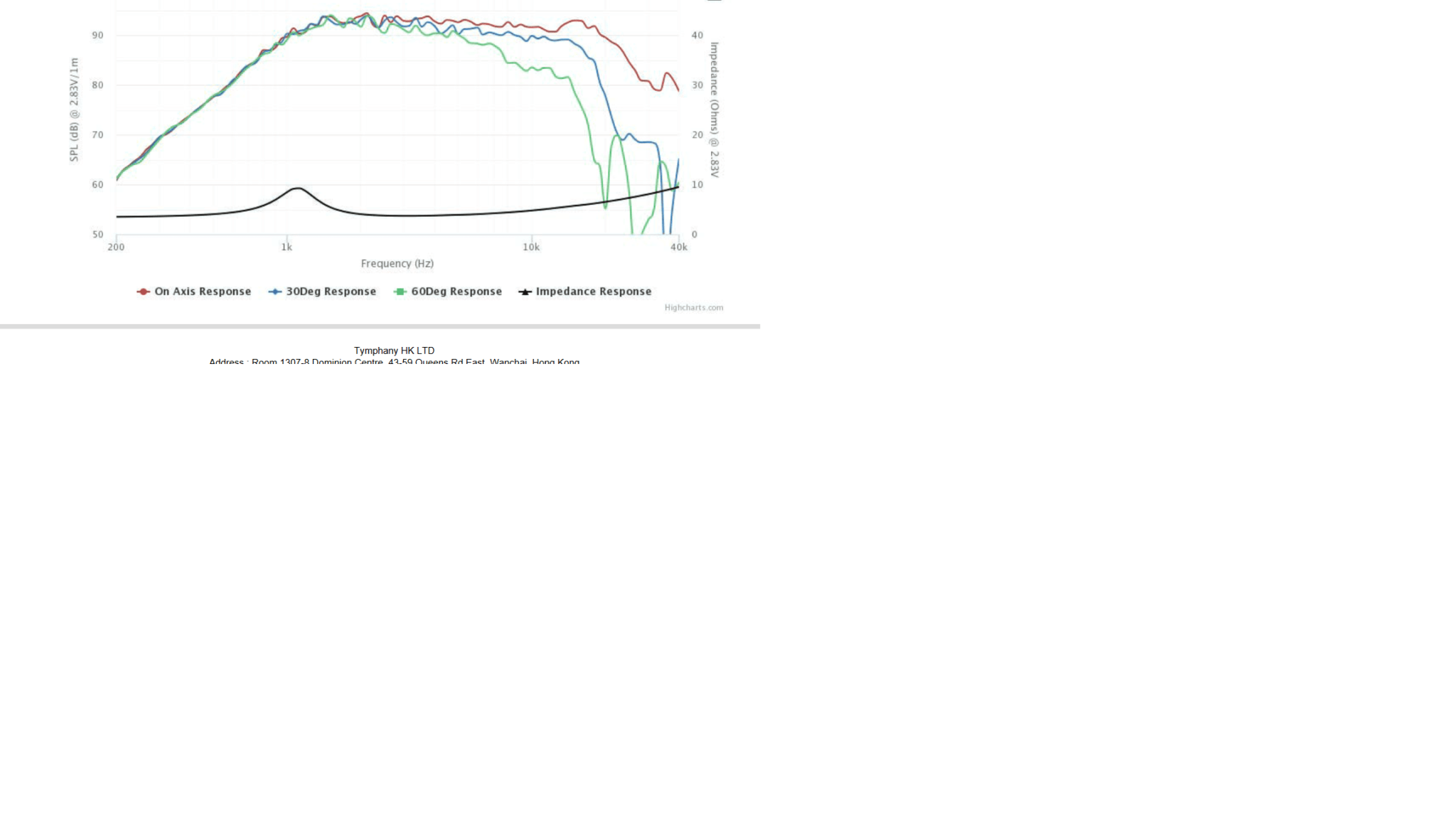

When I look at the graph of spl by frequency of a tweeter I can't find the same thing that I see in the midranger and wooder... the graph is always growing.Can you rephrase that sentence?

If you're talking about the tweeter from Ali Express which you were looking at for a three way speaker, its frequency response is very unusual in the way it keeps rising: most tweeters don't do that. That tweeter would need some extra parts in the crossover to make it behave; I wouldn't use it and I don't know enough to explain why it behaves as it does.
Have a look at at the frequency responses for tweeters such as Vifa BC25TG, Morel CAT378 and Peerless DA25: they're all reasonably flat and easy to work with. They're all viewable at the Parts Express web site.

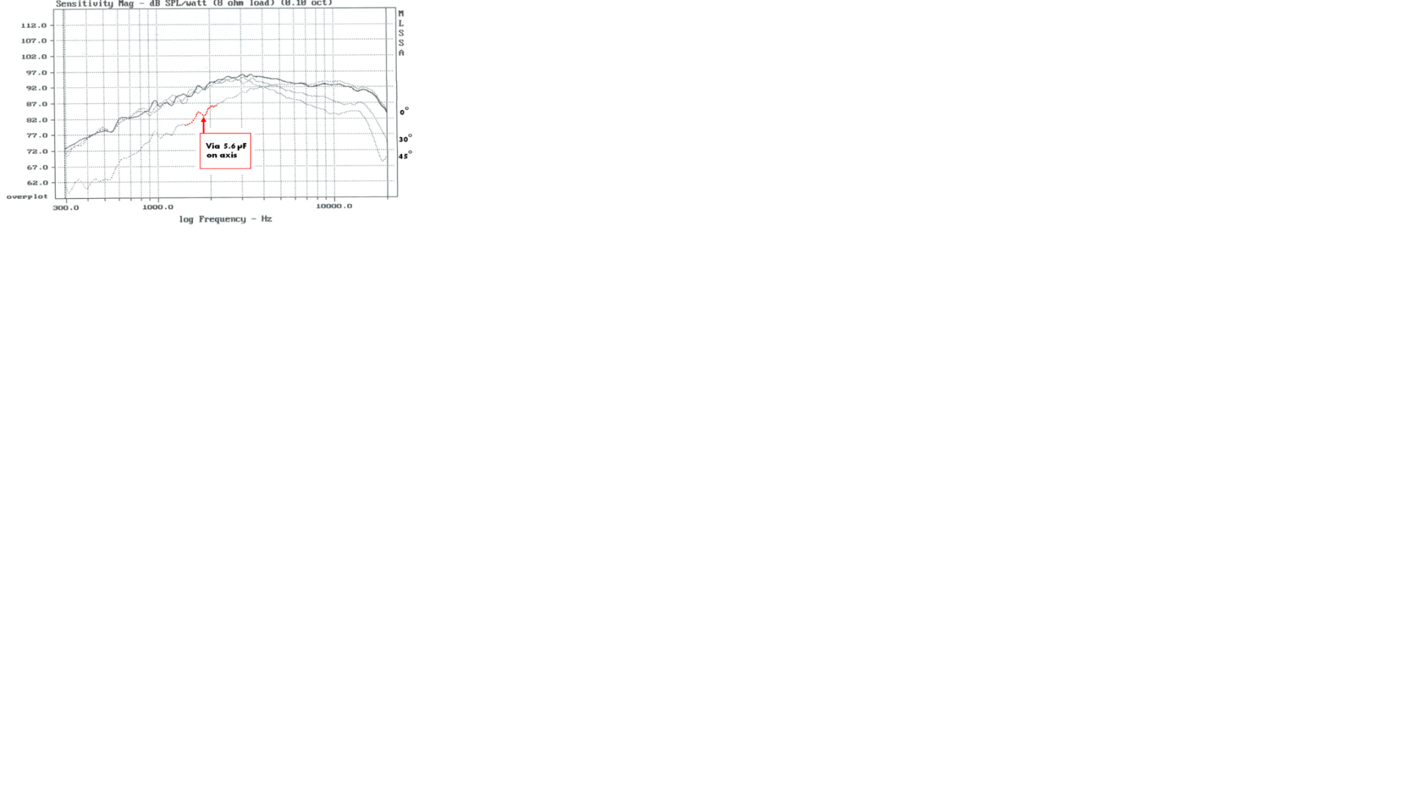

I was going to post a screen shot of that tweeter (if that's the one you're talking about), but the website is blocked by my browser for 'malicious software'.
Compare its response with the frequency responses for these tweeters, all widely used in many successful projects: all quite smooth, all sound good : Vifa BC25TG, Morel CAT378 and Dayton DC28. If I recall correctly, the one you're thinking of had a rising response after about 3,000Hz, although it was at least relatively steady.
I will read what you sent soon
Perhaps you should have made clear, in this new post, that you were referring to a particular tweeter.
As Geoff says, tweeters don't normally have a rising response, i.e., an SPL that rises with frequency.
Regarding where to place your "frequency cuts" in a 3-way speaker, there must be sufficient frequency range between the high pass frequency (Fh) and the low pass frequency (Fl). This ensures a good combined response.
Pick Fh and divide it by 8 to get Fl. Alternatively you can pick Fl and multiply by 8 to get a good Fh.
One example of a good choice of crossover frequencies is: Fh = 3000 Hz and Fl = 375 Hz.

But now you showed me an error about the tweeter having lines growing
Your thinking is mostly correct. When the drivers have a large overlap range of flat frequency response it usually makes it easier to build a simple crossover filter. It is not always true, because you can use the driver natural drop in frequency output as part of your filter design. For example, a tweeter might have a drop in the low range output at about 12 dB per octave. If we want to achieve a 24 dB crossover, we can simply add a 12 dB electrical filter circuit. The combination of the tweeter natural frequency response and the electrical filter will give us the desired 24 dB crossover shape. To calculate how the natural frequency response of the driver and the electrical filter combine we can use a simulation program such as VituixCAD.
