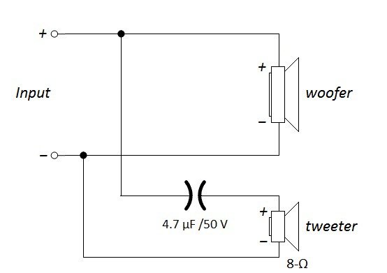

I have a set of speakers I intended to use in a DIY project - each has one 8 ohm 20 watt and the tweeter with 8 ohm 10 watt (or would that qualify more as a mid? I don't know . But, I haven't got the idea on how to connect them, and if if I need a crossover or a resistor between them. I've looked inside some older speaker and saw the tweeter/mid is connected to the woofer from the right and left, and on the right side there was a resistor. Any advice is welcome and please be patient with me

Depending on power and ussage, woofer may be directly wired to the amp's output or through a low pass filter. ITOH tweeter needs always a high pass filter. The inertia of woofer mechanics rejects per se high frequencies. But the more delicate movements of the tweeter may result damaged by high power low frequencies audio programm.
Eventually an attenuator in the tweeter's signal path may be desirable.

Thank you! - I meant capacitor and wrote resistor I think this should work for me - will give it a go - what would be the "recommended" setup - provided this is the minimum?Minimum you need capacitor before the tweeter, otherwise it will burn.

The power of 20W woofer and 10W tweeter is not really helpful to working this out. Often speakers include this power value prominently so that newcomers have something less complicated to look at. You can ignore these for now.
Do you have any other specifications on these units?

This is what I've seen on the box:
Transducer: Φ114mm (15W) * 2 | Φ30mm (5W) * 2
Output Power: 2 * 10W
Impedance (ohm): 8Ω
Frequency Response: 20Hz-20KHz
Sensitivity: 20HZ-4K ± 3DB.4001-7K ± 4DB, 7001-10K ± 5DB , 10001-15K ± 6DB
THD: 1
Start with adason's circuit in post #2.
The 4.7 uF capacitor must be a non-polarised one suitable for a loudspeaker crossover so choose a film type like this:
https://www.soundimports.eu/en/dayt...J7*MTcxMzE4NTIwNy4xLjEuMTcxMzE4NTI4Ny4wLjAuMA..
Try this and report back if the tweeter is too loud.

Apologies for taking this long to respond - finally managed to give it a go, and yes, the tweeter is too loud.Start with adason's circuit in post #2.

You can add a combination of a series (R1) and parallel (R2) resistor in front of the tweeter. The circuit, known as an L pad, is shown below:
For a noticeable amount of attenuation (-6 dB), R1 = 4 ohm and R2 = 8 ohm.
The resistors should have power rating of 5W or 10 W.
Search for ceramic wirewound resistors that look like this:
