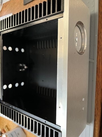

Making some progress now that I have nearly all the parts. I had to order the adapter separately to use with the Mean Well 36V PSU from the store so that will be the critical path item before I can bias and get tunes playing. It's only a couple bucks on Mouser, but man it sure would be nice if the store kit included the adapter (PLUG-R7BF-PM1).
I used 47ohm gate resistors based on @PSz. post #24. I'm not sure what is the ideal value here for gate resistor, but felt if the lower 47ohm that PSz. used works vs the 100ohm on the schematic, I'd give that a try. Other than that I'm populating based on the components in the BOM/schematic.
Should be ready to power up as soon as the Mouser order arrives with the plug adapter late next week.
Thank you to everyone who made this build a reality! What a great kit to have in the store in the not too distant future. A fun and relatively straight forward build so far!

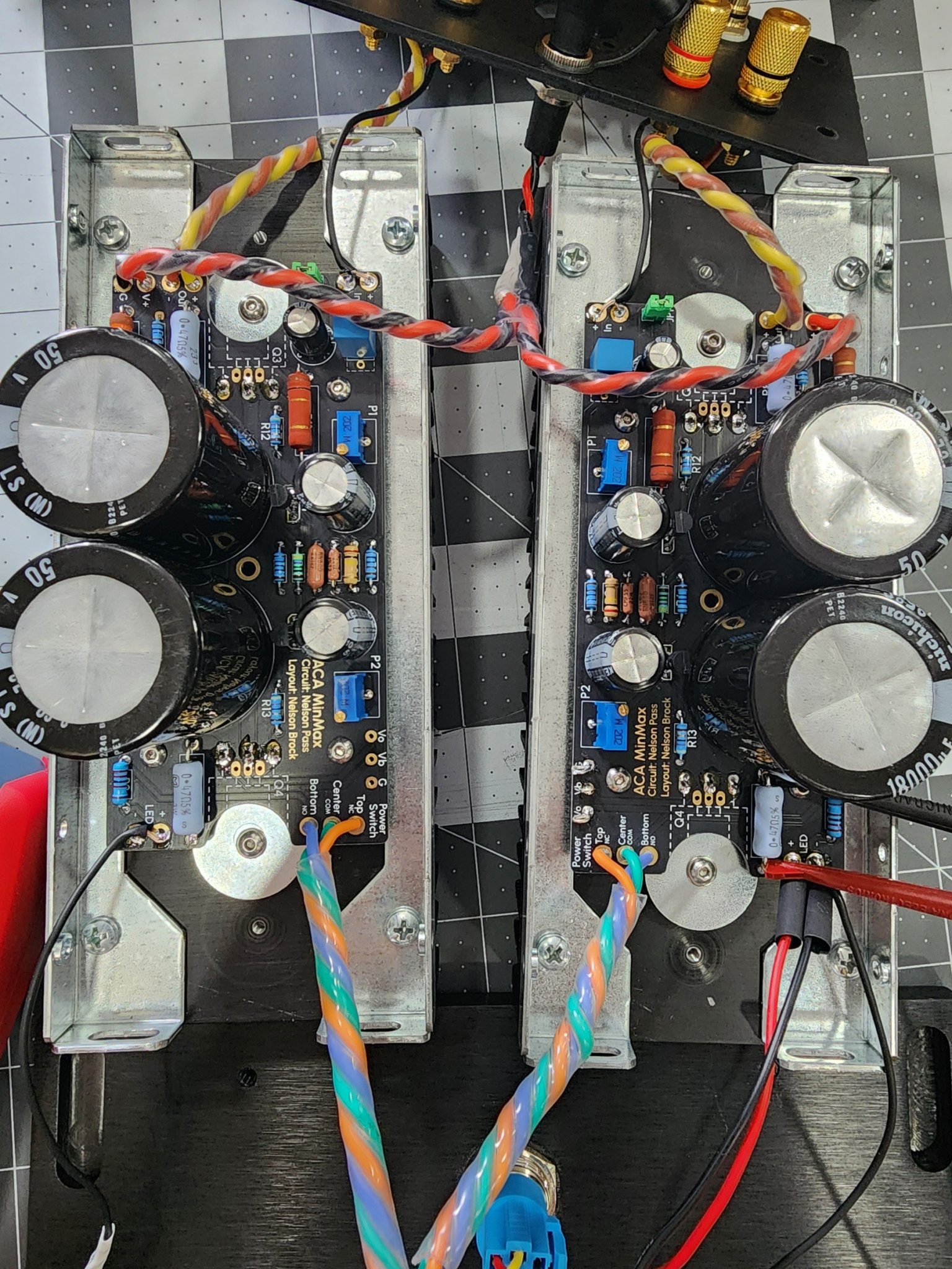

Well, I was so excited to finally have everything wired up, but alas, I'm getting the dreded SMPS pulsing that's telling me I probably broke something. I did have the switch originally connected wrong, but I don't think that should have fried anything. All pots were full CCW.
Scratching my head staring at a schematic right now. I'll reread the thread and see if I can get some measurements using my bench power supply and limiting current. I should have started there, but didn’t have a barrel connector that fit. Should have just bought one and waited for it to arrive.....future builders, learn from my impatience.
It's a good question to ask, but I paid close attention there, used extra tall standoffs and was sure to cut the wires extending through the board very short.
Very good point for anyone building this to be extra sure you don't short any wires if using a washer.
My only thought is my misswired switch may have fried something. I double and triple checked my connections, but somehow got "COM" mixed up with the thought that meant ground, so I was triple checking the wrong assumption. So its possible I applied -36Vdc in where I should have been +36Vdc.

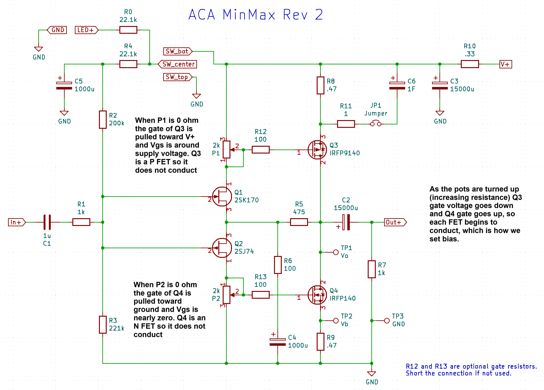

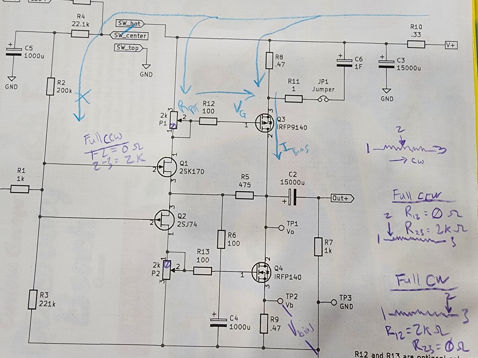

[EDIT: So with all pots full clockwise I measure basically 0 ohms across all pin combinations (1-2, 1-3, 2-3). Before I apply power, I'm hoping someone can confirm starting at near zero resistance is correct. I'm not smart enough on the how the circuit works to feel confident that's correct. My mind tells me "start with high resistance" to keep current down. Clearly that's just my lack of understanding of how the pots control the bias/offset. I'm gonna stare at the schematic a while and see if I can apply some smarts (still have a tiny bit of those left) to figure this out.]
Starting at zero ohms is what you want ;)
A bit of explanation in the attached image. Hopefully that helps build some understanding. I've always found it easier to avoid mistakes when I have some intuition about how things are working. And I often learn the most shortly after making a mistake :flame:

Here's where I was when you sent out the "full assist" post...
Not doing bad as I had the 3296 schematic out and studying that, but was still a little off on the key to understanding how the pot resistance affected the bias current through MOSFETs. Sharing my chickenscratch for "funsies".
Now, on to power up with significantly more confidence and a little better understanding. Thank you again!

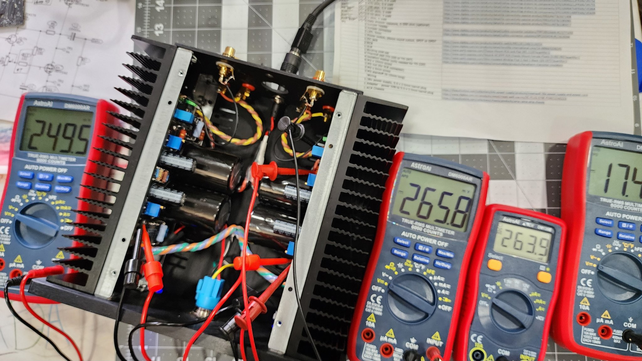

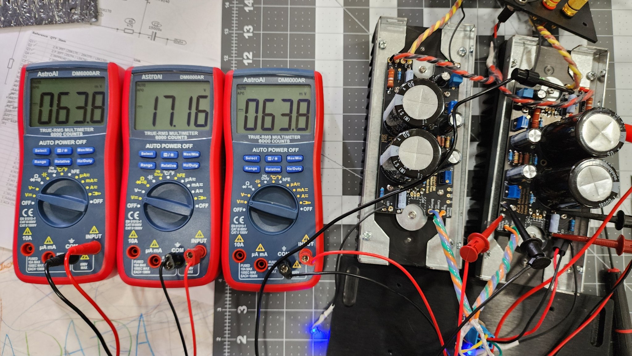

Finally got the chassis back together and a good starting point to really dial in the bias. I'm going to likely target 0.8A, but I'll let the heat sinks make the final call.
What offset voltage is a good target? 17.1-17.4Vdc would match the same ratios as Nelson's article on ACA Mini, so that was going to be my guide unless someone has another suggested target/range.
Reactions: 5 users
I'm not gonna worry about DC offset. It's basically at 0V now and the music sounds so fantastic, nothing else really matters.
Bias is 0.82A on both channels and Vo of 17.4V on both channels.
