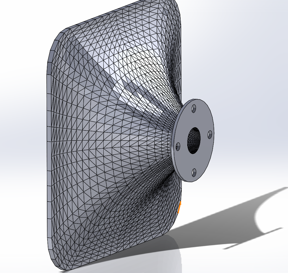

I skimmed through your documentation, which looks great, and noticed that you mention that you need a way to export coordinates. Why is that?
With modern cad software like Fusion 360 or Solidworks, the STL mesh can be turned into a surface body, which can be thickened and manipulated with holes, driver flange etc etc;
If the horn is eventually ending up in a 3D printer it will always be converted back to an STL so there is not really any need for a perfectly smooth surface.

Marcel, I have not run your software yet. That was an STL file that you posted in a different thread, which I just imported to solidworks as a surface body, thickened and extruded a flange to show that this is doable.
Best, Fredrik

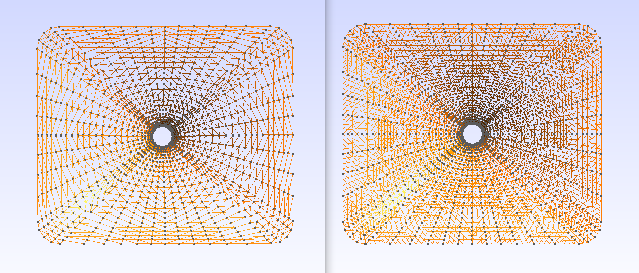

Great, just tried the ATH15 example and it generates the STL and the Abec project files, but ABEC freezes when I try to open the project file. The STL looks fine.
Does it matter that I use Abec Pro?
Where to find the dll should be in the documentation or perhaps distrubte the .dll with your software if gmesh allow it.
EDIT: My bad, it just took some time to load because the mesh was so fine. Much finer than the STL??
Joined 2004
My bad Marcel, I overlooked the SDK part. Now that it is documented here, people will probably not repeat my mistake.
No idea why the STL and mesh file is so different in resolution yet.
Do you have any such issue Patrick Bateman?
I'm seeing the following:
In the STL, I have 1344 vertices and 2592 faces.
In the MSH, I have 849 nodes and 1588 triangles.

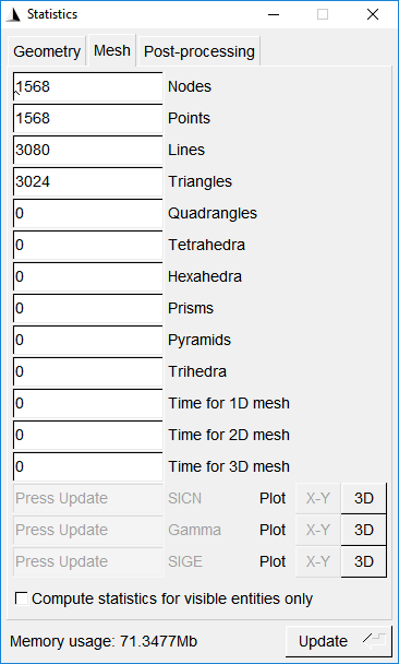

Joined 2004
Patrick, how did you get your numbers? When I open my ath15.msh (not the ABEC one) in Gmsh I get these counts -
I will try to figure out, it must be some Gmsh thing. Like it took some smaller values for the mesh size at each point. But why?
