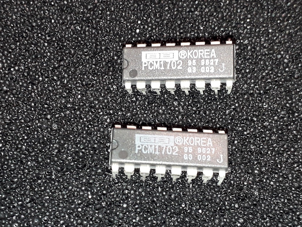

Today I received a lost shipment with two PCM1702, I hope I will be able to insert them into the DAC at the weekend. Then I will have 4 pieces per channel and the current will be 9.6mAp-p, so I will be able to reduce R2 to 1k, which will give me 9.6Vp-p at the output.

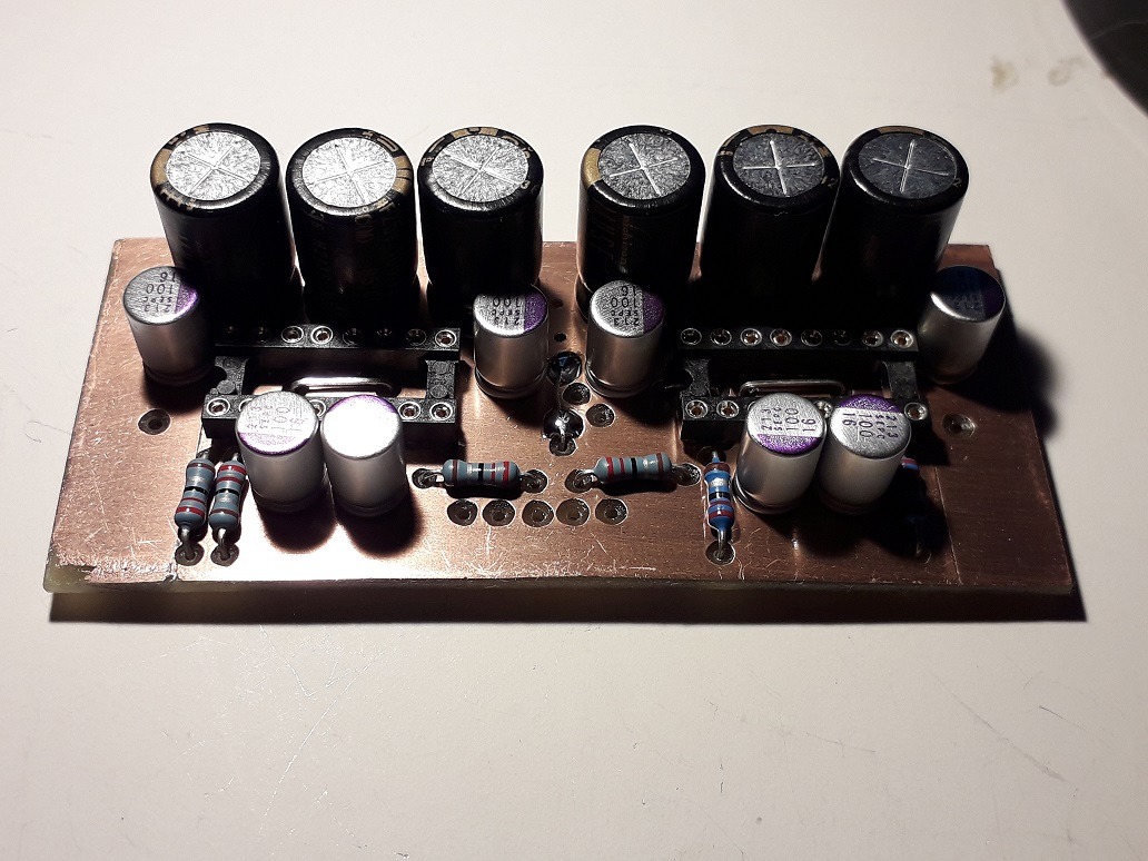

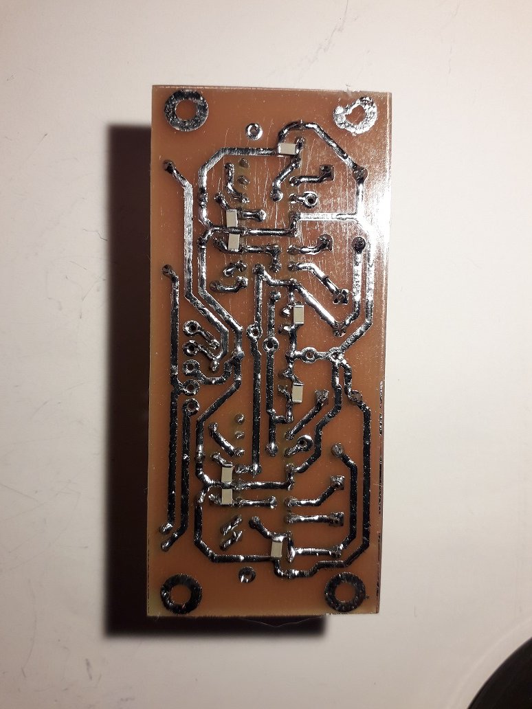

Today I finished the PCB and tomorrow morning the installation in the DAC with a small correction of the currents in the shunt regulator and the value of R2 in the I/V stage.

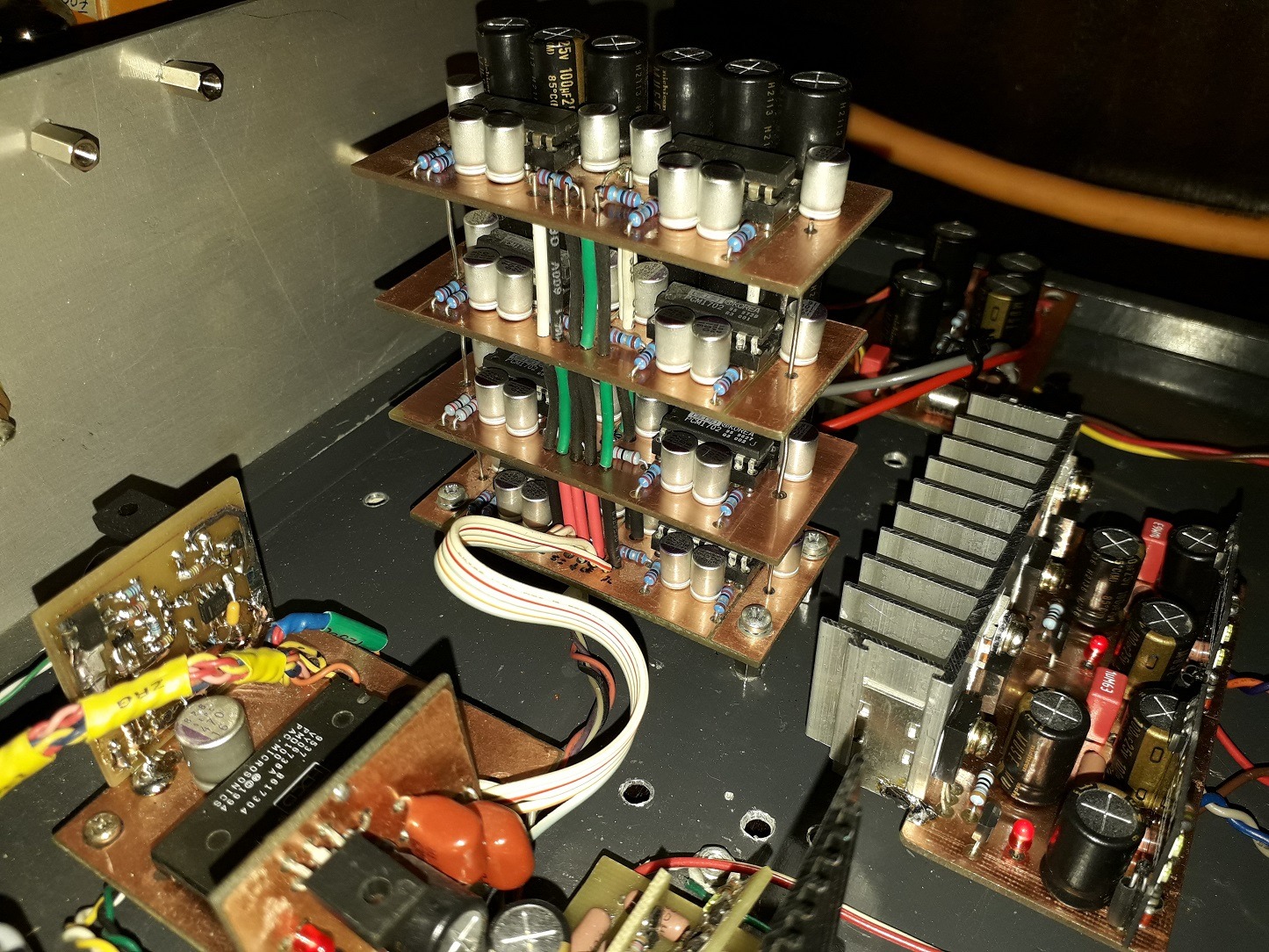

This morning, all 8 pieces of PCM1702 finally played. The sound is excellent, the installation of two more PCM1702 was worth it.
I made only the correction of R2 in the I/V stage due to the higher current of the dacs. The output voltage is 8.64Vp-p or 3.02Vrms.

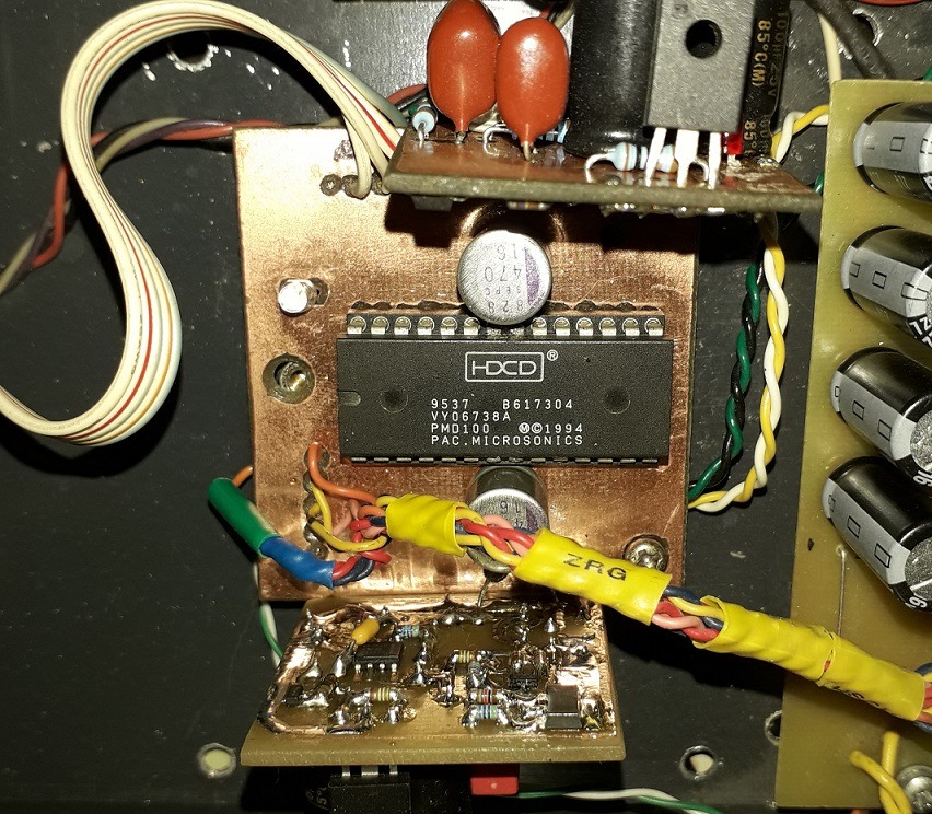

I think they were bought by Microsoft and discontinued the production of PMD100 and PMD200, unfortunately.
The PMD100 is an excellent digital filter, it just requires separate supplies for VDD1 and VDD2 to achieve the DS specification.
