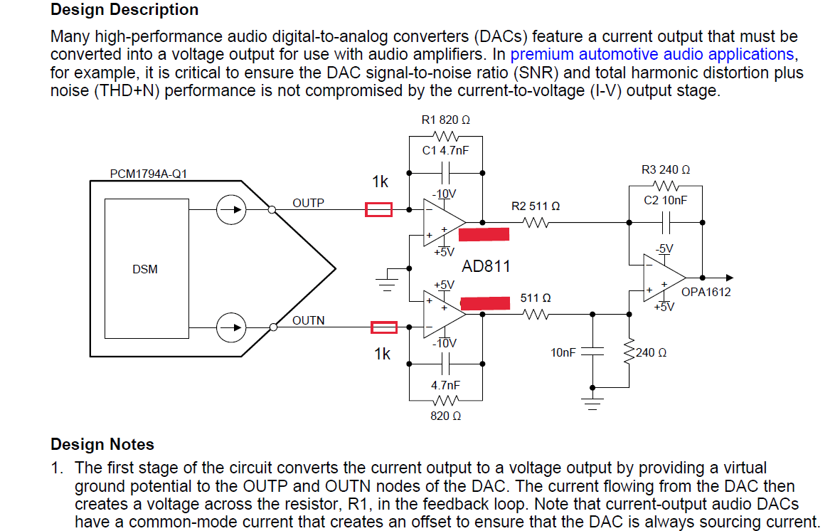

In that case(balanced output), you need four AD811s, as I will use in my new DAC with two PCM1794s.
Thank you for your answer.
Not been clear sorry, I am using a balanced output chip (a pcm1794 per channel) into a single ended integrated amp (currently with passive iv stage). Since a single ended output is needed, what would be the best way to menage the negative ouput of the dac chip using the ad811 single ended output from the positive?
I understood correctly, it should look something like this, four AD811 for two PCM1794 ;) .

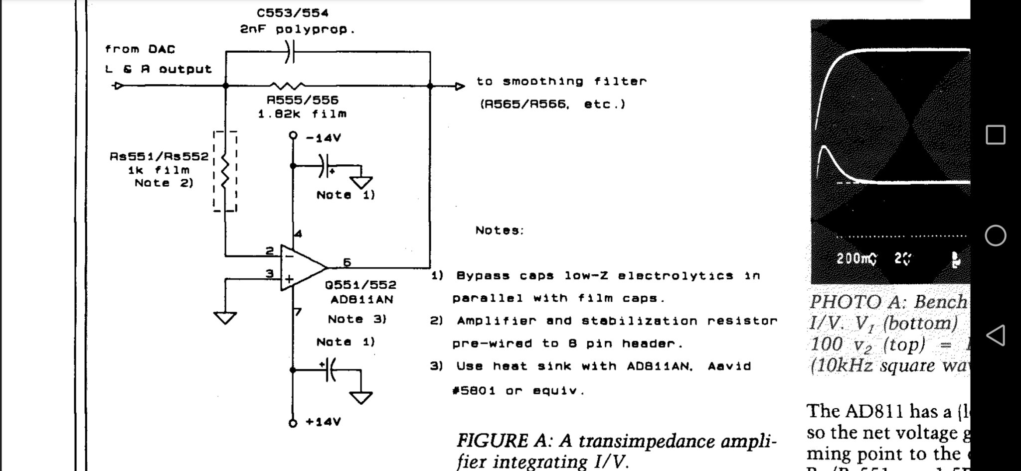

Grunf, I think you have mis-interpreted the application of that 1kohm resistor..
The original Jung scheme is applying it !behind the feedback node. (below)
Your schematic means that you have eliminated the 0 ohm virtual ground that the Dac output wishes to see and now there is 1kohm I/V resistor in place, with some Volt of voltage compliance to tolerate for the Dac..

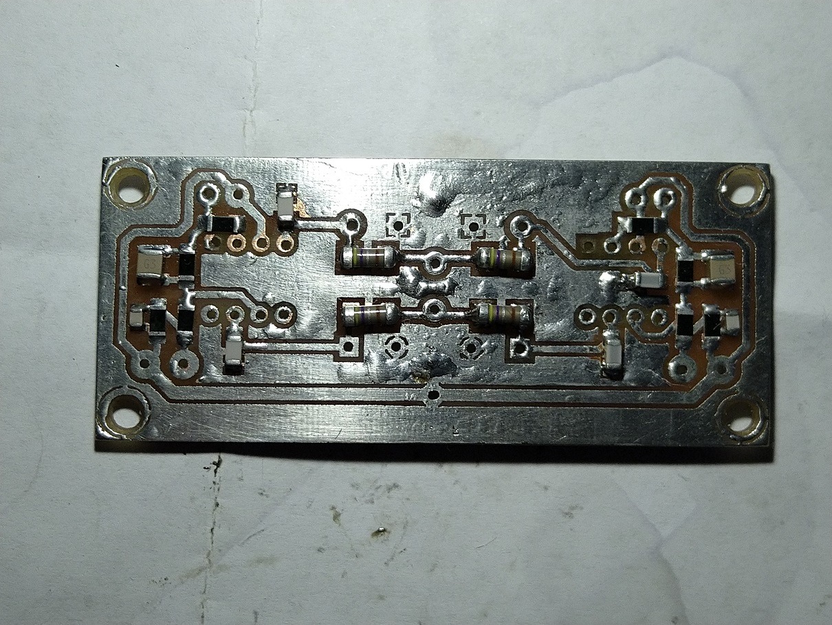

Today I finished the prototype PCB for IV with AD811 but this time everything with SMD components except four 100uF/50v ukz and two AD811 with heatsinks.
For the first time I used DALE PNM non-magnetic series instead of RN60, and instead of polystyrene and polypropylene TH capacitors I used non-magnetic SMD COG capacitors. AD811 is soldered direct on the PCB.
So far I can say that in this application the PNM is much better than the RN60.
