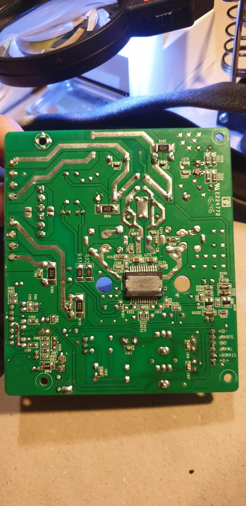

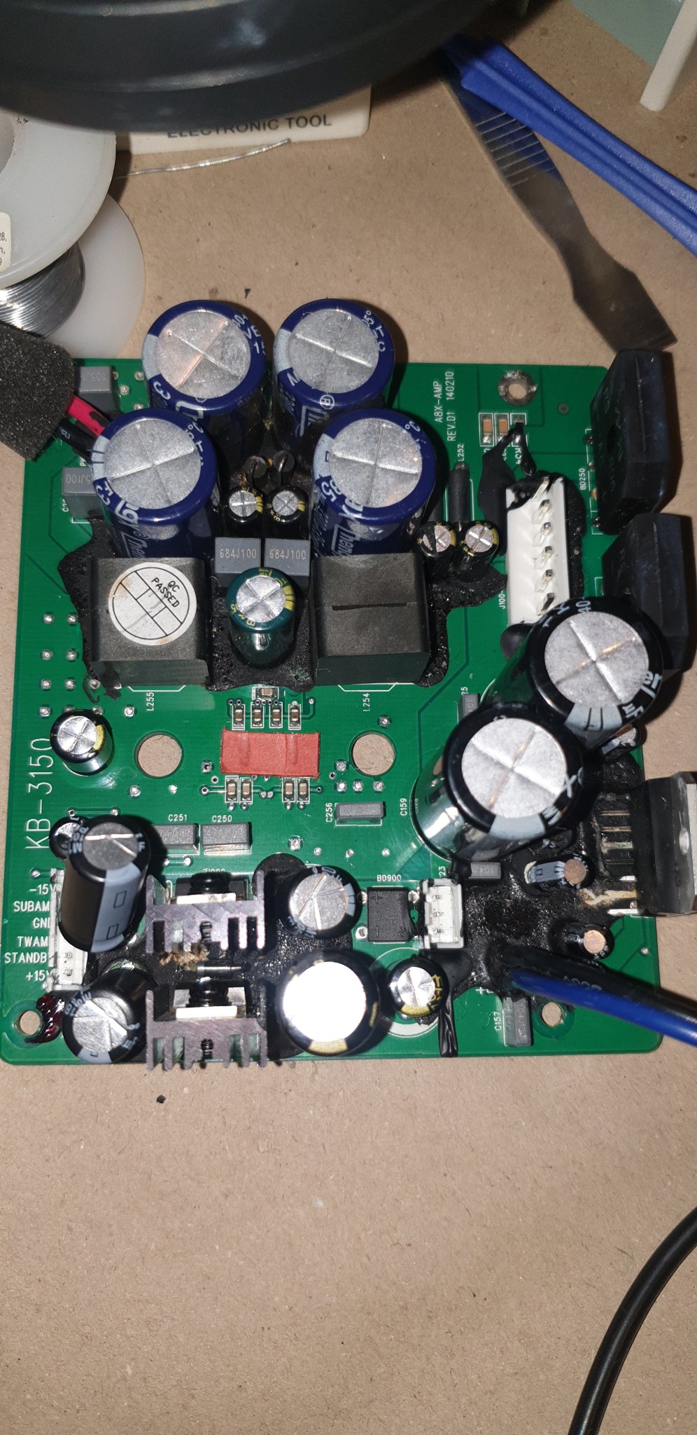

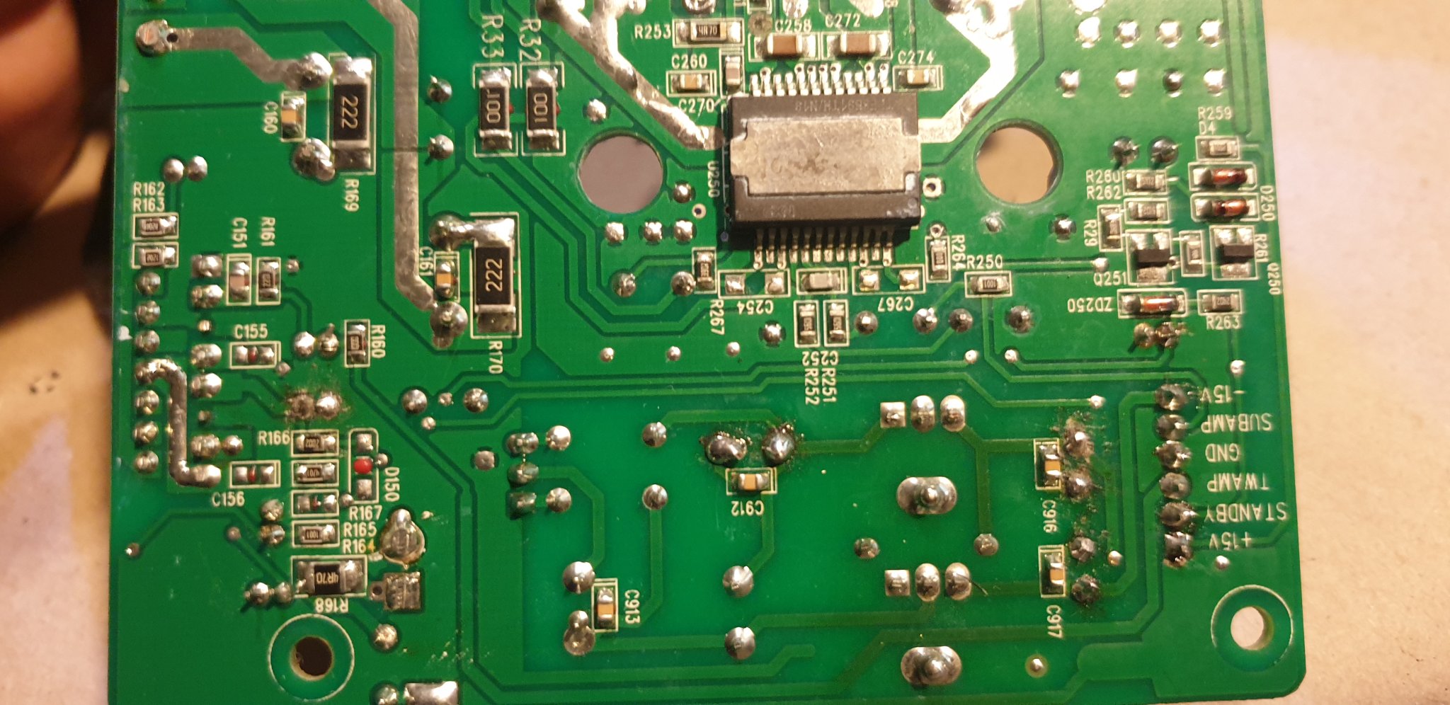

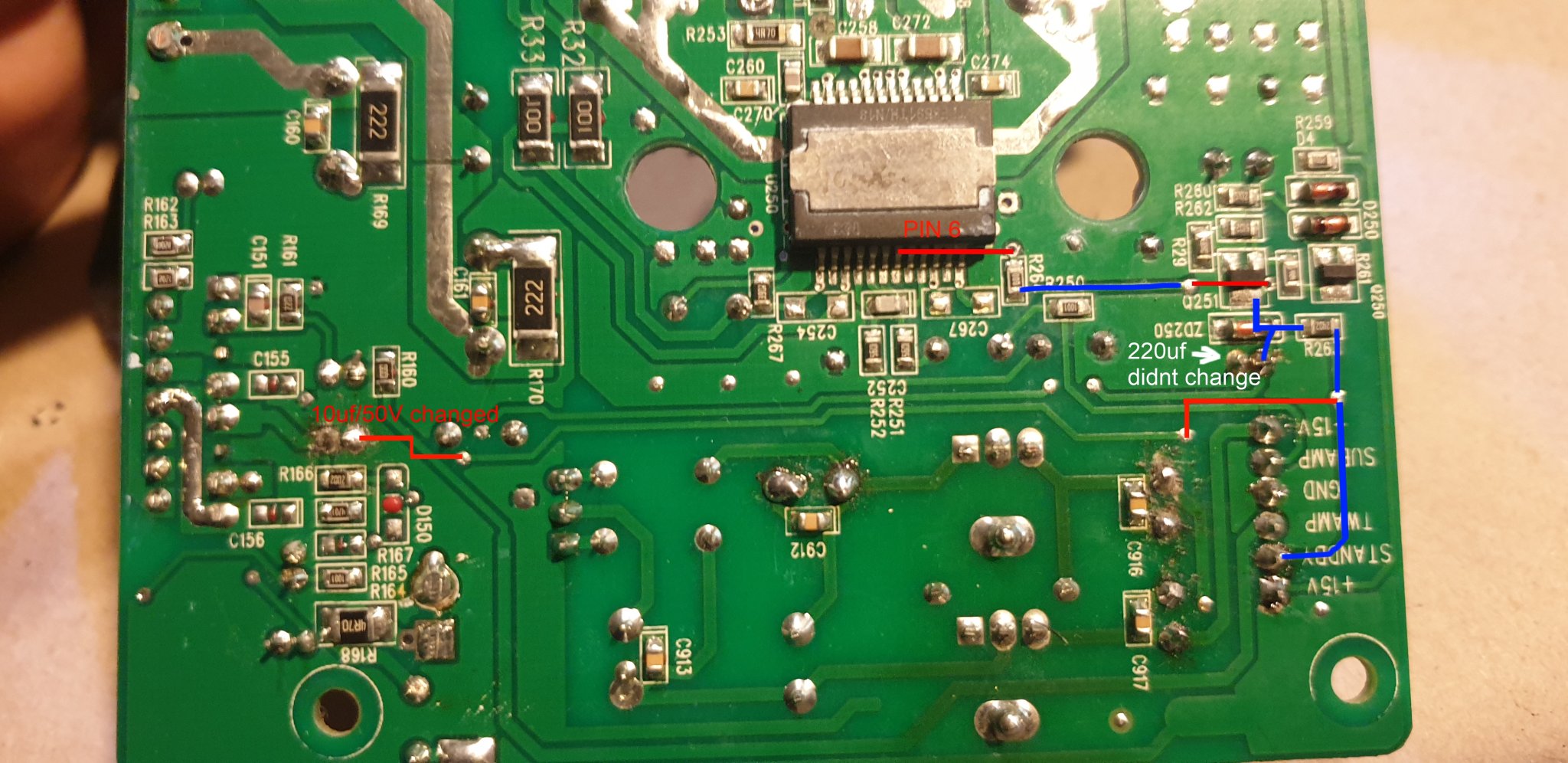

I know that AX is still in service, I just said if someone sometimes get schematic, soon or later, it would be good to share with us.
I upload images, if you need front part, I can upload it too. I changed some big caps and some that were suspective, but nothing fix the problem. Also I post picture with marks where is pin 6, blue traces are visible side, red traces are back side. So pin 6 goes to R264, from it next contact is with R 263 and standby pin.
Btw. Thanks for help.
