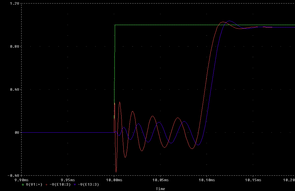

Please be aware that allpass filters do not actually delay the input signal but they shift the phase. With clever choice of dimensioning an allpass can be made to behave like a delay up to a certain frequency. The higher this frequency - for a given delay value - the longer the allpass filter.
Enclosed you can see the step response of a 10th order allpass with a delay of 100us approx. The allpass is consisting of five equal 2nd order inverting allpass sections witha a Q of 0.5 (therefore the output signal is inverted).
The same delay can be achieved with 10 first-order allpass sections like the ones shown on SL's homepage.
2nd order sections have the advantage that Q-values can be chosen at will and they should have a slight THD+N advantage -but first order sections are less demanding regarding loop gain of the op-amps.
One can clearly see that the circuit doesn't give a perfect delay and that higher frequencies are delayed less than the lower ones.
I used a 40 kHz lowpass after the filter in order to emulate the upper cutoff of a tweeter. This signal is shown as well and it looks a little better then the one coing from the allpass directly.
Green: Input step
Red: Allpass output
Blue: lowpass- filtered allpass output
Regards
Charles

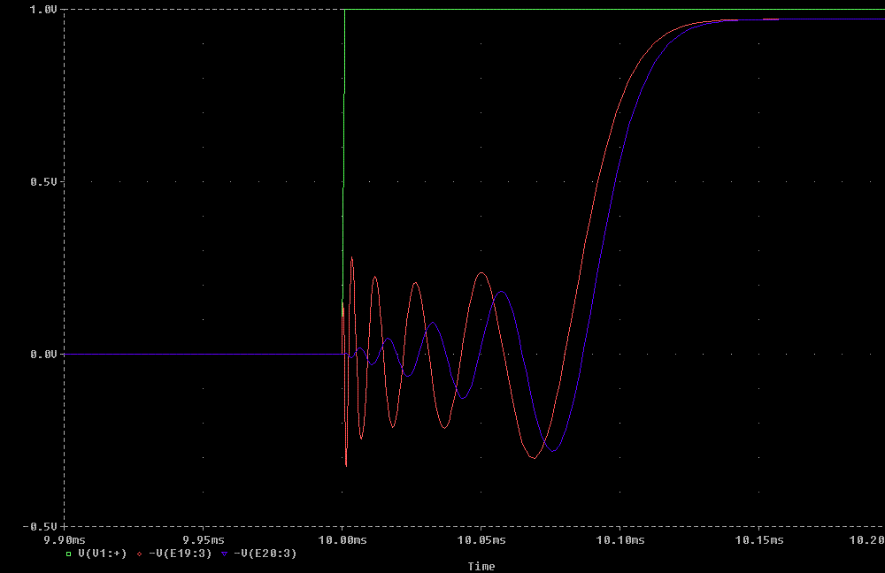

Here you can see the result for a 10th order Bessel allpass of the same delay approx. The result is definitely better due to less group-delay distortion. But this comes at a price: Only 2nd order sections can be used and tighter parts tolerances are asked for.
Trace colours same as before.
Regards
Charles
