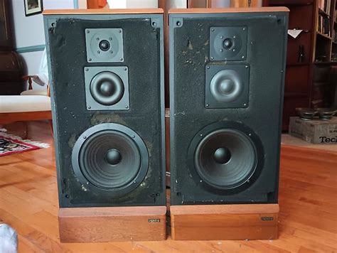

I've got a pair of Advent Maestro speakers that were given to me today. They are in good condition and the woofers were refoamed a few years ago.
I already ordered new caps for the crossover.
Two things I've noticed.
1. The speaker wire terminals on both speakers has separated from the terminal cup with the crossover on it at the bottom. What should I use to secure it back down?
2. I've read where the woofer doesn't play high enough causing a hole in the frequency response near the crossover point of the woofer and midrange which is 900Hz. Listening to them, I believe I actually hear that, but will wait until the film caps come in and are installed to see if that fixes it. If I still hear the issue, what is the best way to eliminate the issue? Normally I'd just use a different inductor value for the woofer, but the inductor is part of the dish where the fuse, speaker terminals and other crossover components are and I'd have to add an inductor which would require mounting it somewhere in the cabinet.
What I should do is disconnect a midrange and test it using my DATS V3 speaker tester so I can see what the impedance of it is as in order for the 14uF cap value to be correct the midrange impedance would have to be 12.5 ohms provided the specs I found are correct. That's not exactly possible though given the speakers are at work now.

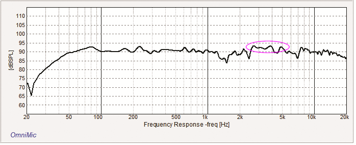

However the response graph I found seems to suggest there is no hole in the frequency response.

The best way to describe it is the terminal block on the rear of the terminal cup looks like it was either molded into the terminal cup or it was glued in.
The part at the bottom is separated from the plastic.
I'm thinking maybe some plastic epoxy would work with something to hold the terminal block down while the epoxy sets.

Looked at the crossover schematic again and saw the midrange and tweeter were wired out of phase with the woofer.
I wired them in phase with the woofer and the issue I was hearing is gone.
Not sure why they were wired like they were? Maybe Advent was trying for a certain sound?

The change made the speaker sound better and the hole in the frequency response around the woofer and midrange crossover frequency is no longer there.
