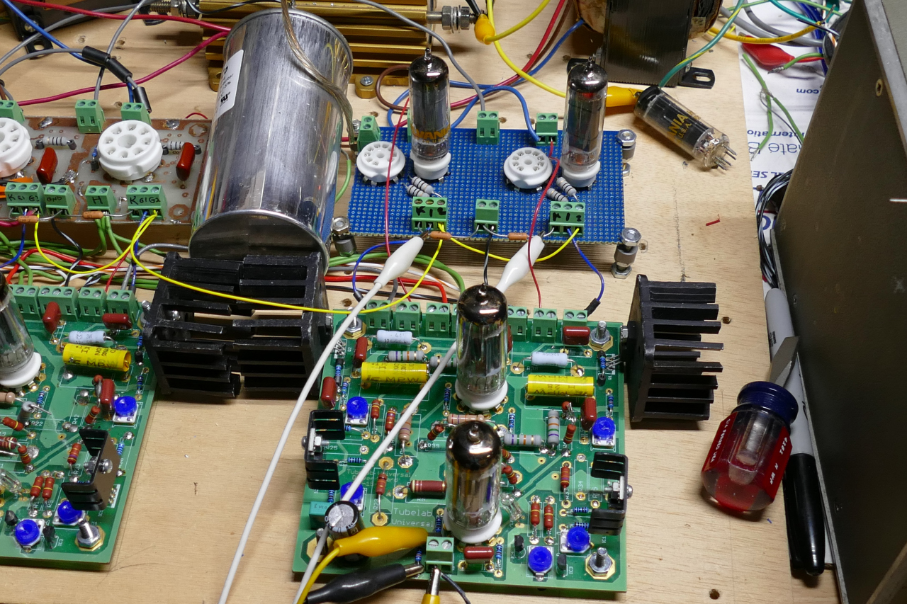

.....From the above posts it seems that there is quite a bit of interest in the modular approach. When I first talked about a modular approach to amplifier design, AKA "Amplifier Building Blocks" there was virtually no interest. This was however about 10 years ago. I designed a Universal Driver board for a Push Pull amplifier, made three different test boards, then got really busy squeezing the life out of my dying engineering career. The driver board, and most of the tube stuff lay dormant.
In 2014 I left Motorola, sold, gave away, or trashed much of the "stuff" that I had accumulated throughout my life, packed up what was left and moved it all 1200 miles north into temporary housing while my retirement home was being built. During the year of living out of cardboard boxes, I took one of the best driver board designs, polished it up and sent it to a board house and had 35 boards made. Why????? I don't know, boredom maybe. They came back, looked neat, nice and shiny......then sat on a shelf, ignored.
In 2015 I moved into the new house, and set up a workbench. I got one of those boards out of it's package and build it. It worked, so I built another. There were several random tests over the next two years. Test boards for output boards in several flavors were made, 9 pin miniature, octal, 12 pin compactron, and 9 pin Magnoval. Some test amps were made. Why am I explaining this?

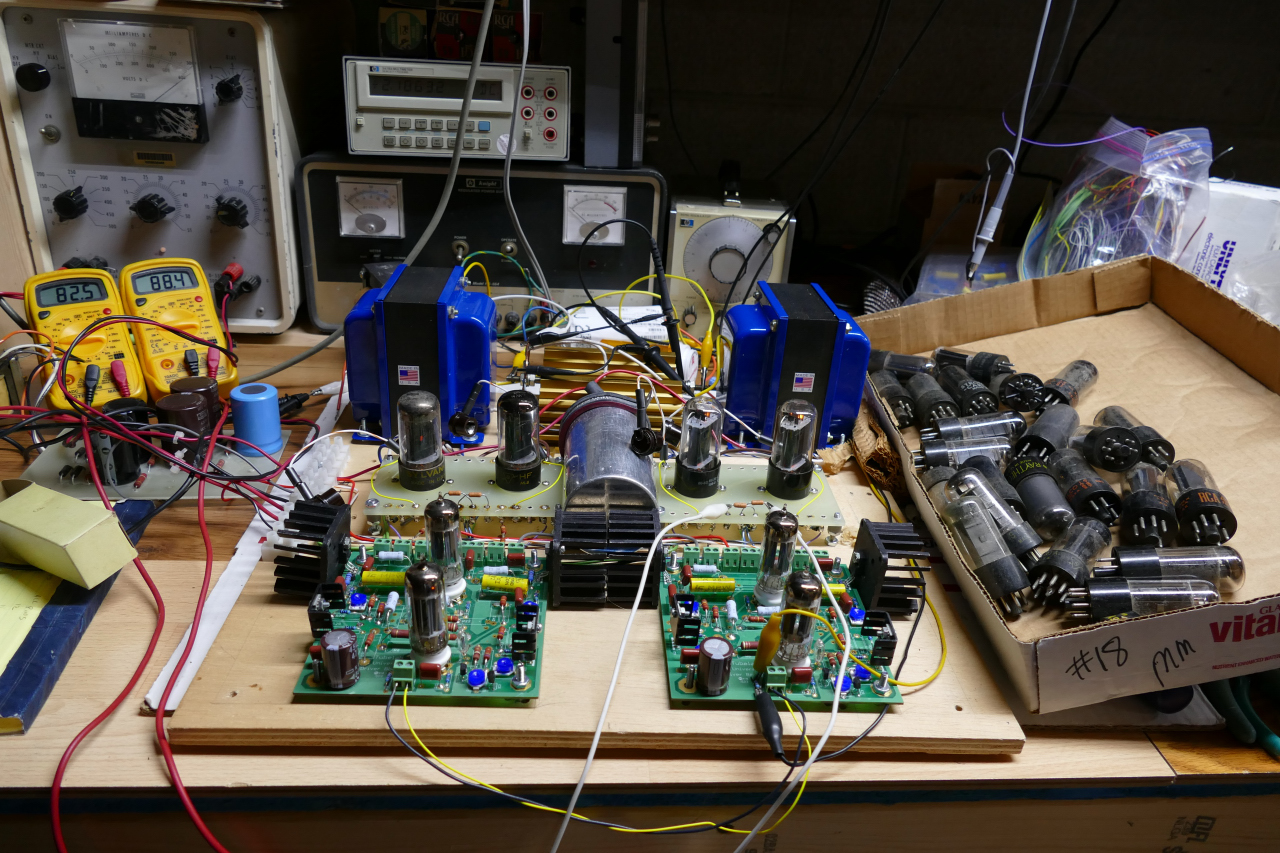

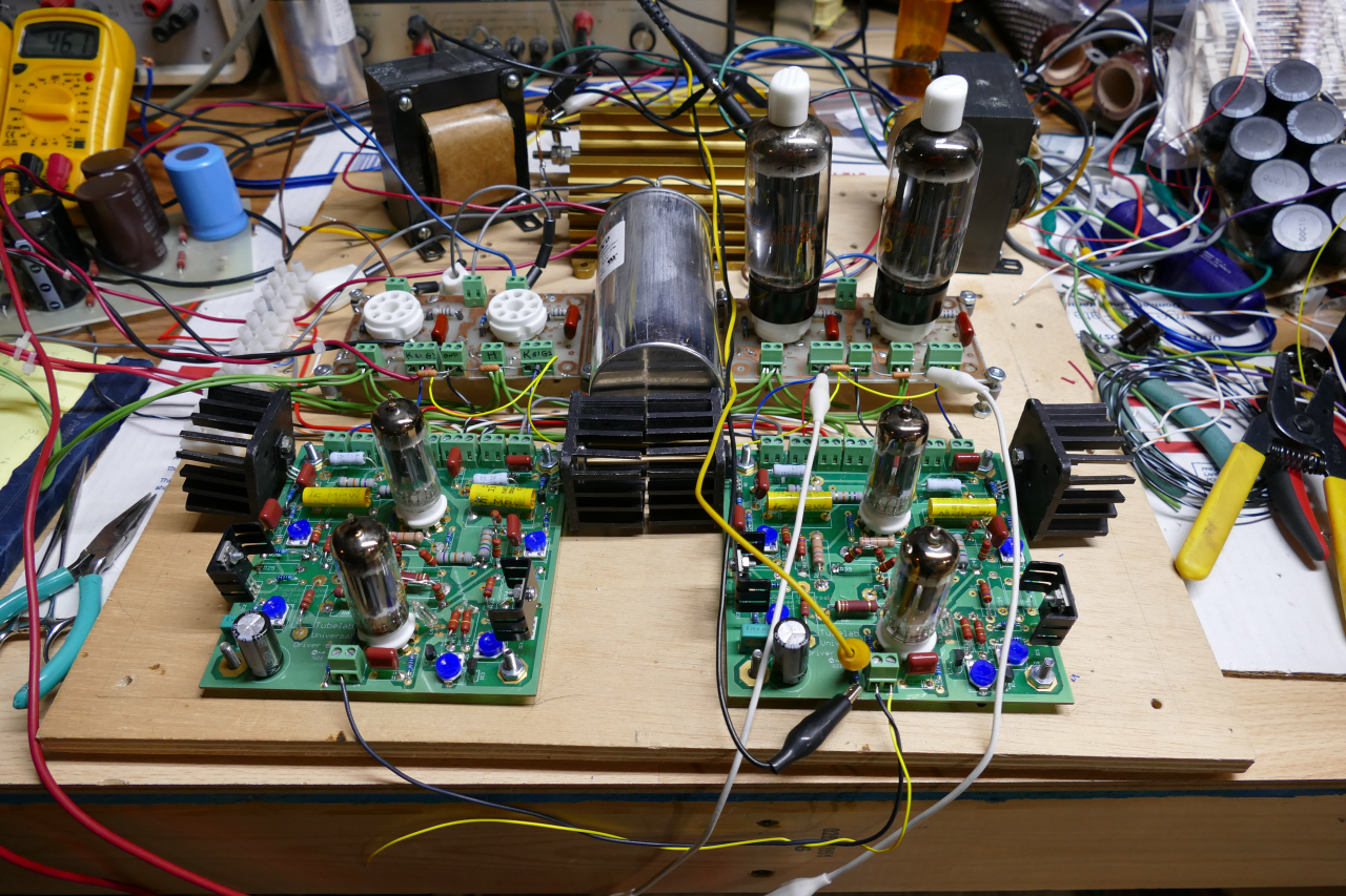

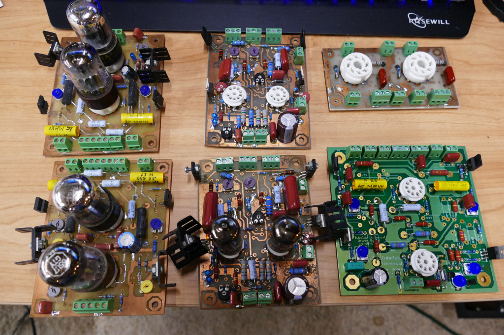

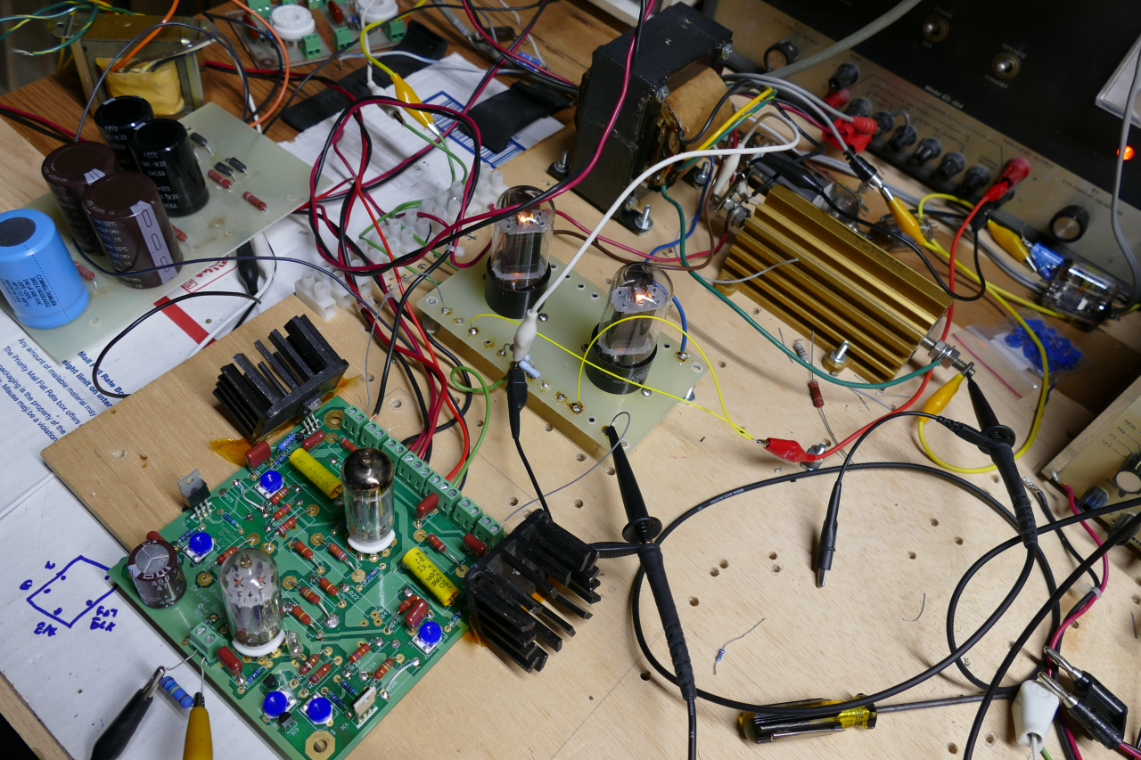

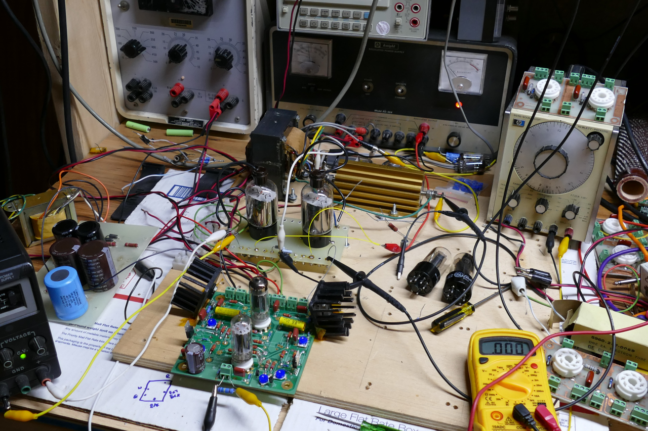

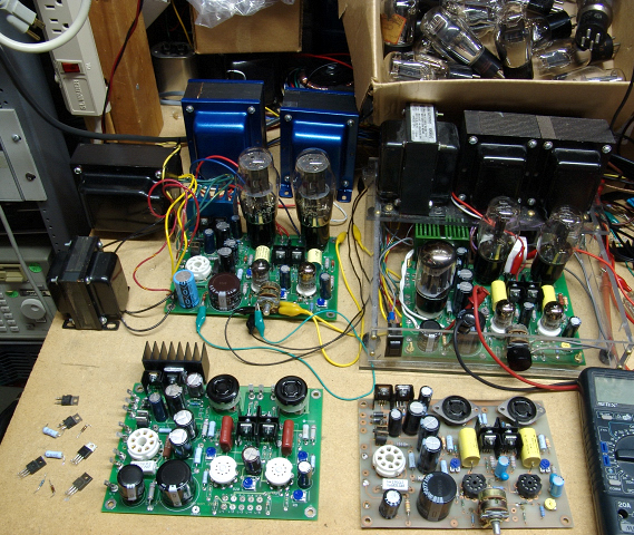

These are the first few "modules" or Amplifier Building Blocks" In that modular system that seems to be interesting now. That package of 35 driver boards? All gone, I built 4, saved one to replace one I fried, and sent the last two boards out yesterday. There were no instructions, no mention of these on the web site, nothing but this thread:
Tubelab Universal Driver Board, 2015 version
And this mediocre video shot entirely with my cheap cell phone:
YouTube
I ordered 50 more of these driver boards.
It takes some testing and a complete re-layout to turn one of the output boards into a design worthy of being a Tubelab product. This takes time, since I will do at least two test board passes before ordering a batch of production boards. There are two more Push Pull driver test boards that are operational, but not fully characterized and another that's still in "furball" (flying parts) state. The existing output boards can be used for SE (stereo pair) or P-P amps, but need to be made bigger. Boards for 4 pin (45, 300B) and 5 pin (307A) tubes need to be designed and made. It's pretty easy since the pinouts are common and no jumpers are needed.
There will need to be a few similar boards designed for use as SE drivers, and a few power supplies ranging from simple to fully regulated.
Maybe a complete amp strip, driver and output without power supply (choose one from the "building blocks" or make your own. Heater supplies, again, chose a "block" use a Coleman, or make your own. Want to use a driver block and make your own output board, or wire it point to point, go for it.
1st picture, several driver test boards, one octal output board, and one of the new push pull Amplifier Building Block drivers.
2nd pic, One of the driver blocks feeding a pair of 25L6's mounted on Turret Boards from AES. One of the 12 pin Compactron output blocks can be seen at the top left.
3rd pic, same block warming up some medium size sweep tubes.
4th, stereo, some nicer OPT's and a whole box full of used 6V6GT's.
5th, some 6DQ6 sweep tubes in stereo make for a rocking loud 100 WPC.
6th, a pair of octal output boards. They can be used for about 25 different tube types depending on jumpers and parts placement. These are set up for 36LW6's and pound out 160 WPC.
7th, a test board that accepts 7 pin or 9 pin miniature tubes. How much power can you squeeze through a 50C5 radio tube?
Any thoughts?

Not to be a party pooper, but I'd recommend against the modular approach. Inventory management becomes a pain rather quickly that way. My DG300B consists of four circuits: A power supply board, a driver board, a B+ regulator board, and three filament regulator boards. Maintaining inventory in the right amounts of the various circuits is a pain.
Just saying... :)
If the main issue with the TSE is that the Sharp IC has gone away, I'd look at the LMZ-series or LM2267x-series from National/TI. They're switching regulators, so there's very little heat to worry about and you could place all the components right at the tube socket for minimal voltage drop. There're probably some newer options that could be interesting as well.
Tom
I was part of the industrial revolution in a factory that hand stuffed PC boards for two way radios, then hand assembled the boards into product, each of which was a custom order since each had to have individual crystals and tunings for every different police department in the customer base. There were over 100 different PC boards, and several hundred different piece parts that had to be hand built to make each HT-220 police walkie talkie. It took a week to pre-assemble the average walkie talkie, another two days in final test and assembly, and several more days for QC, audit, and packing, then another few days to get them into the UPS truck.
When the factory left the USA parts were loaded into an automated line, the GO button was pushed and 10,000 Nextel Phone boards were done by the day's end.
When I joined the phone team in 1999, I was asking complicated questions that had no answers, like how much does it cost you to place one part on the board. If we can replace 12 parts with one part that costs a bit more than all 12, you need that number to make the decision, since it improves the throughput of the line....
....the biggest question I popped, and the REAL EYEOPENER, "how much does it cost your factory to ship an empty box?" The factory had evolved from a system that sold and shipped $2000 walkie talkies. It was now shipping $100 phones, the cost of individual boxes in individual wrappers does not make sense when you have only ONE customer and he wants 10,000 units at a time! BULK PACK!!!!!!
I started my career as one of the hand assemble and tune guys. This was in 1973 and the only "computer" in the building was the IBM mainframe which printed out the paper "pick" and "build" sheets for each order. They were attached to the plastic tote for each radio. All the subassemblies and piece parts for each radio were then placed into the plastic tote which would travel down the final build line to a technician like me who would tune, test and assemble the final product. All tracking was done on paper. Mistakes were many and also hand tracked. Products had an associated quality number called DPU, defects per unit which for most products was greater than one, and for complex versions of the UHF HT220 was in the 3 to 5 range.
I would leave the line in 1974 to join the test equipment calibration lab where my job was to optimize that factory, improve the yields, and increase throughput. I was in that job for 10 years. During that time the entire factory was torn down and rebuilt 4 or 5 times, once moving to a new much larger building. MODULAR radios were introduced, which reduced the number of individual kits (PC boards, plastic and metal parts), at the expense of making, warehousing, and tracking the individual modules. This reduced the DPU to well below 1.0, eventually replacing the "DPU" bench mark with "DPHU" (hundred units). Mixed SMD and through hole radios were introduced, again reducing the number of kits, and improving the yield and throughput, ATE (automated test equipment) replaced a lot of the manual testing. DPHU was now under 1.0.
Obviously having too many different parts to track leads to problems, and increased costs. The flip side of this is the one board for EVERYTHING, and the differences are in the software. This also leads to problems. Let's just say it's well known that you can buy the cheapest model of a certain DSO, download the code for the most expensive model, reflash the cheap one and save yourself $1500!
There certainly is a happy medium somewhere, and it differs widely depending on your business model and sales rate. I have averaged 135 boards sold per year with several years below 100, and none over 200. It really doesn't make much difference whether I stock 4 different boards, or 10 different boards at my sales volume. Inventory management is by eyeball. All boards are in clear Tupperware containers on the shelf in plain sight. When they get low, I order more. Simple system, but it works.
At one time we offered parts kits for the boards. That may be an option in the future, but it does increase the complexity, and opportunities for error. The SPP board can really only be built one way, with two different output tubes, so we added the extra resistor needed for both tube options.....only one parts kit.
The SSE is pretty much the same. We had made parts kits for those once, and they were also not a big deal. The TSE however gets more complicated due to the wide variety in possible operating voltages, and the multiple driver boards would make matters worse.
I have often been asked why I don't offer a complete kit of all parts including tubes and transformers. It is not possible to stock all the possible combinations of transformers given the wide variety of operating voltages and OPT quality levels needed. It would also incur two sets of shipping charges for the transformers, once to get them to me, then again to send them out.
The only way that would make sense would be for a low cost minimal build, sort of a one size fits all "Model T" (all exactly the same) amp. That was going to happen in 2009, but two terminally ill parents, Sherri losing her job, and the beginning of Motorola's undoing, slowed my progress, and your copy of my design left me with several hundred unsold tubes, transformers, and parts. This created the biggest financial loss ever for Tubelab.
Any new ventures / boards / kits etc will be self funded in advance, parts kits may not return, and would only be viable for stable proven designs. New boards will only be ordered once there are funds in my account to pay for them in advance, and of course the really new stuff may be hinted at, but NOT divulged until I have boards in hand ready to sell.
OH, yeah....UN-SET and the CED are coming, but delayed until I finish the contract job so I can fund everything at once.
