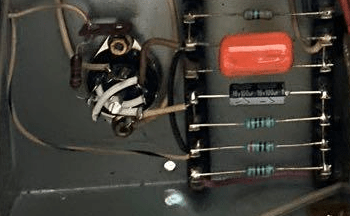

Just wondering if there is a schematic of the Air Tight M101 floating around? I found some nice interior pics and could reverse engineer it if i had too.
Is it just a 12AX7 SRPP into a KT88 UL with some global feedback?

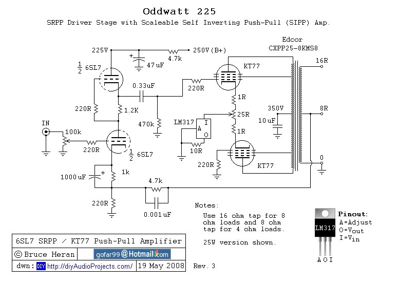

Not the circuit you are looking for?
The original of this topology originates from the late 1930s.
They didn't have 3-terminal regulators in those daze for the cathode tail.
But a resistance works, altho not very well. Lots of 2H, no one cared!
For radio, a slick marketing trick, the selling points could claim PP output.
Along with other at the time new buzzwords such as superhet,
screen grid tubes & octal metal tubes. (y)
