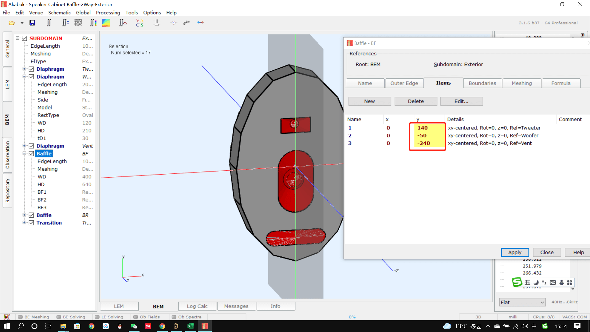

In the example project-Speaker Cabinet Baffle-2Way-Exterior. the position size of Tweeter and Vent is modified there, and the yellow one shown in Baffle cannot be modified.

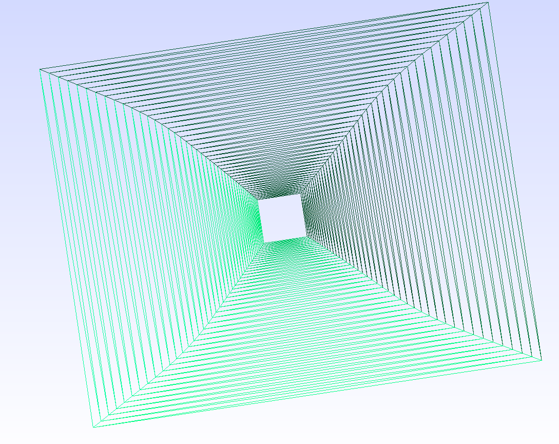

This is how I currently generate the surface of the horn, rectangles divided into two triangles. I have 32GB of ram and can have upto 8 threads. Visualy everything looks very smooth. I do have the considerable optimisation available of simulating a quartered horn which will get me to 4kHz just brute forcing the thing with the global edge length parameter. Anyway will have a play around to see if I can get this working better!
Joined 2007
n BEM there is in principal a small exclusion zone around each boundary element within which the sound-field becomes undefined. In theory this zone is infinitesimal small but because we deal with finite elements the size of this zone is finite as well. Normally the auto-mesher makes the elements small enough so that in turn the mutual distance is large enough compared to the wave-length. However, elements can also be too close when, for example, a narrow duct is modeled. Elements of opposite walls may then violate this criterion. Another case is elongated triangles where the distance of the center points is much smaller then the length of the sides. In general, picture a small halo over each triangle having a radius of the inscribed circle. In a good model there is no intersection of these hemi-spheres. Narrow ducts need to be modeled with a higher resolution.
Confirmation in the manual that elongated triangles like I generated are bad for the AKABAK meshing algorithm. I have almost completed my changes that allow adjustment of the mesh resolution across the horn and producing quartered horns so should be getting higher frequency results faster soon!

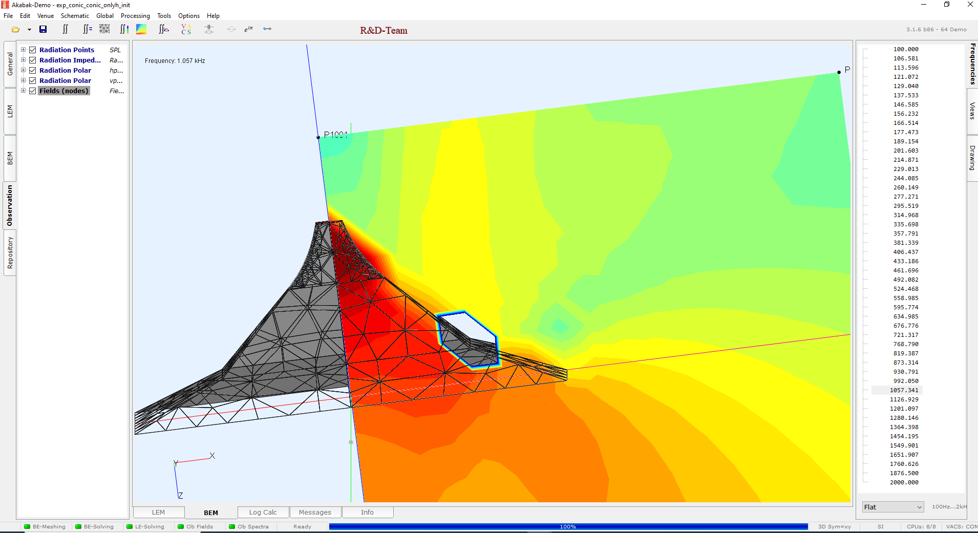

Any ideas what is going on here with the diamond shaped hole in my observation plane?
If you click on the Field element in the 3D view, you’ll see the triangles generated by your current meshing parameters. Those can be modified separately on a per-element basis, and I’d advise that for most models using elements that are not meshed in advance using external tools.
If the elements don’t line up due to different resolutions or the like, there’ll be a ‘hole’ in the mapping. That doesn’t mean there’s nothing happening there, just that the data points span multiple other elements on the main geometry.
You can supposedly define an observation Field by an imported mesh, such as a flat plane in your CAD software that is intersected / ‘punched out’ by the main geometry. That should then follow the surface element profiles more accurately, but it didn’t work for me and I never got around to investigating properly. I think this method also limits the sort of data you can map onto the Field surface too.
