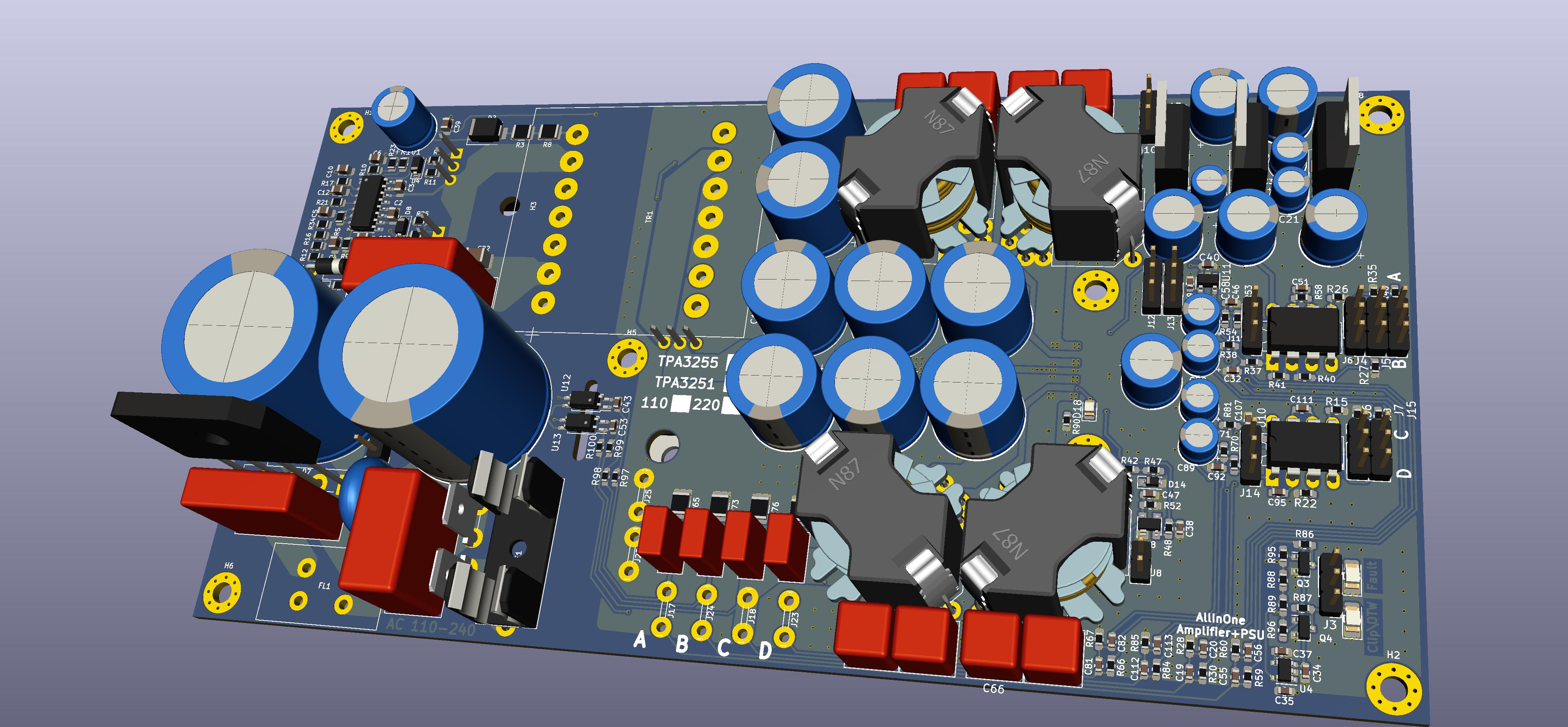

Akita "AllInOne" Amp based on TPA325x PFFB+ and LLC PSU in one board.
Version 3

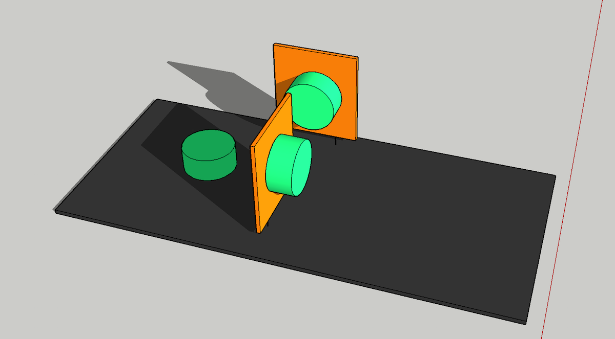

In speaker crossovers, one are always advised to mount all inductors ortogonal to each other i.e. in a x, y and z direction. Is there also here a problem with cross induction interference? If so, it might not be soeasy to solve.. It would need a small board mounted upward... and there are 4 of them :-/
TPA3255EVM has them all parallel and in close proximity to each other. I've read through a few of TI's documents and have not seen any comments about this... a lot of other designs have this as well.
