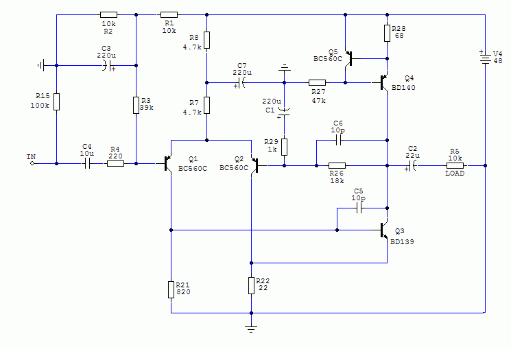

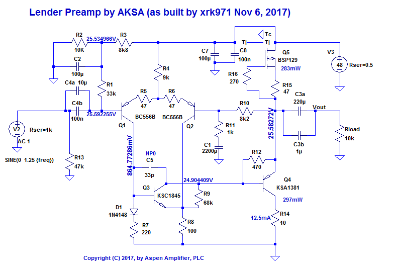

Here is the schematic of Hugh's Lender Preamp. As you can see, it is quite simple and I was able to veroboard prototype it quickly:

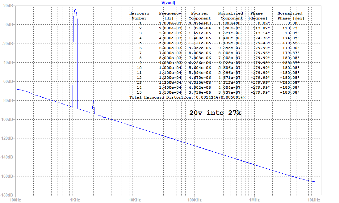

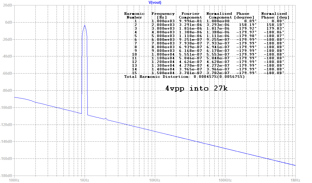

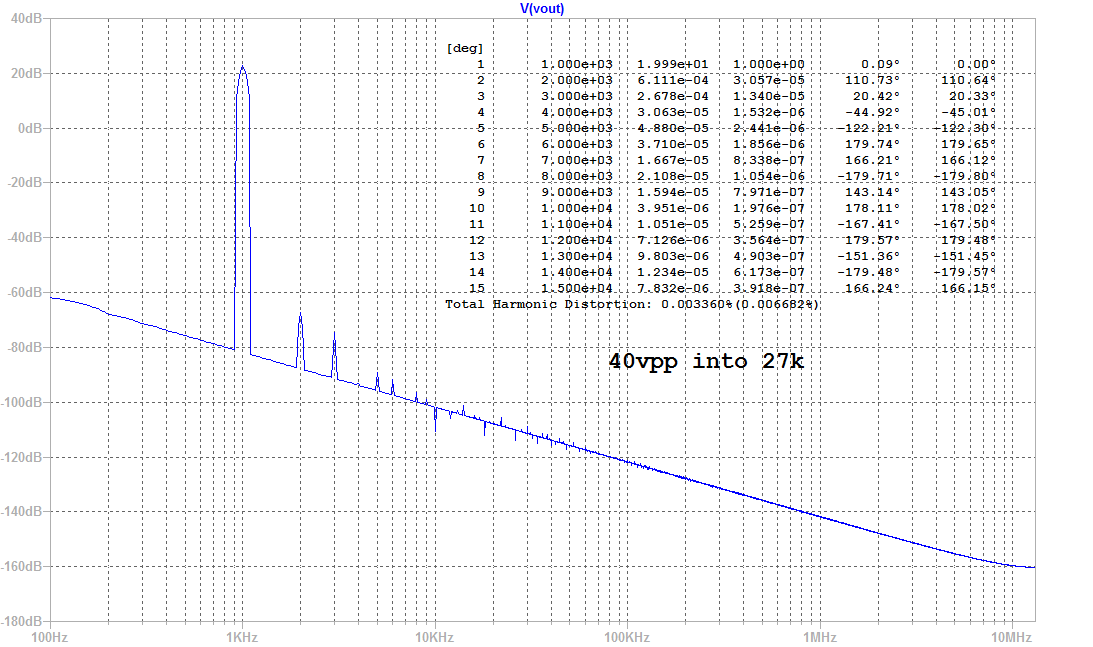

Before we go into the implementation, here are some predictions of the performance. I am assuming that the power amplifier input impedance is 27kohm, although 10k still looks very good. First at an output of 4v peak-peak and this is representative of typical very high volume levels one would ever need in a line-level preamp connected to a power amplifier with circa 20dB to 30dB gain. The distortion is exceedingly low in the ppm's and the nice thing is that it doesn't rise with frequency:
Here is the predicted FFT for 20v peak-peak output, a serious level and if driving a buffer power amp, only gets you about 6w rms with 8ohm speaakers, meh... but look at the low distortion figures (0.005%THD, the figures in parenthesis is the one I am using and think it includes THD+N?) and the nice descending higher orders from dominant 2nd order:
So, what if you need to drive 25w rms into 8ohms? Well, you need to swing 40v peak-peak. The predicted THD is still quite low and the harmonic profile is still beautiful with no higher orders going nuts. So this preamp can do it all: works well with normal high gain amps, and with unity gain current buffer amps like MOSFET followers:

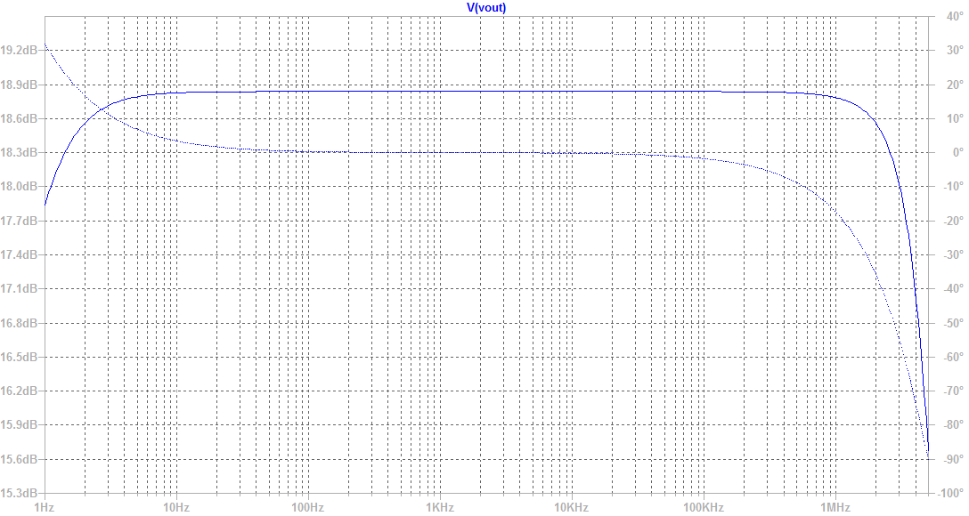

For completeness, here is the predicted frequency response and phase. Nice and flat from 10Hz to 1MHz. Phase is very flat too.

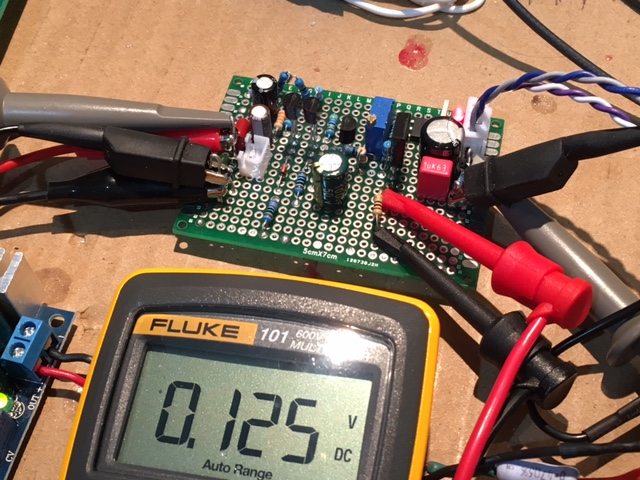

Here is my quick veroboard proof of concept build. I am using a simple DC-DC step up converter followed by a CRCRC to get 44.5v PSU rail that is pretty clean, shown is the 12.5mA (125mV over 10ohms) bias setting that I was adjusting using the pot (R15) on the BSP129:

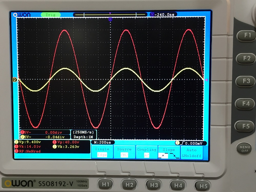

Here is the obligatory scope shot to show that indeed to makes 40v p-p. This was with an initial gain of 4.3x, which I later boosted to about 9.2x for later with still excellent results:

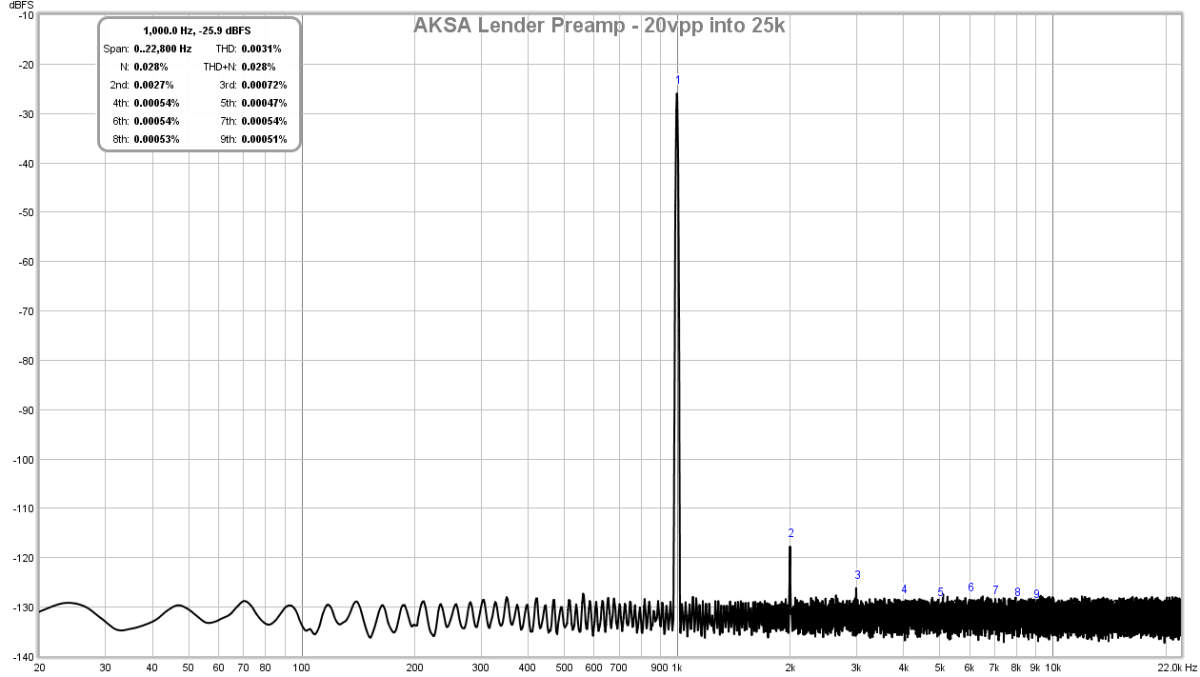

Here is the measured FFT for 1kHz input and 20v p-p output into a 25.3kohm load (27k plus a 10:1 voltage divider comprised of a 22k & 2k2 resistors):

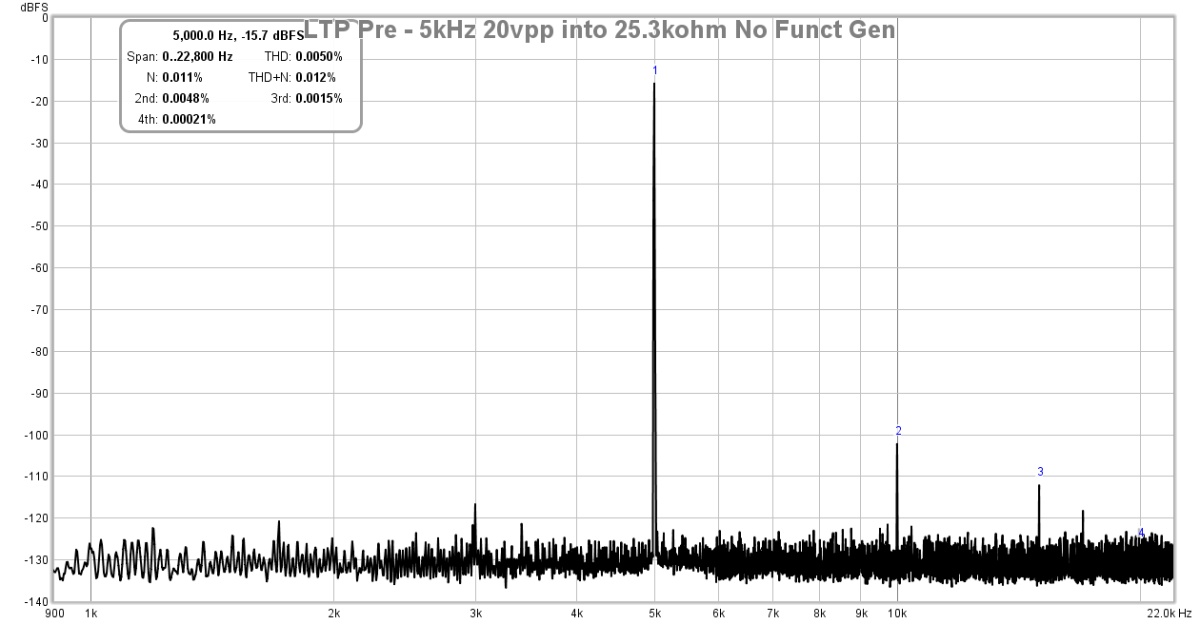

Here is the measured FFT for 5kHz input and 20v p-p output into same load. As you can see, there is no rise in the THD:
The FFT signal looks low because I was using a 10:1 voltage divider to drop the signal to a safe level for the Focusrite 2i4 2nd gen audio interface.

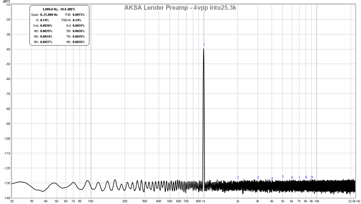

4vpp into 25.3kohm:

I think the measurements speak for themselves, this is a superb measuring and sounding preamp.

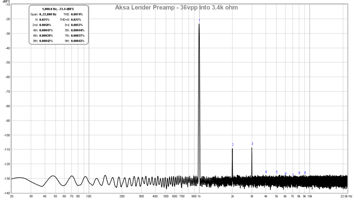

Edit Nov 13, 2017: Looking at performance into a lower 3.4k ohm impedance load.

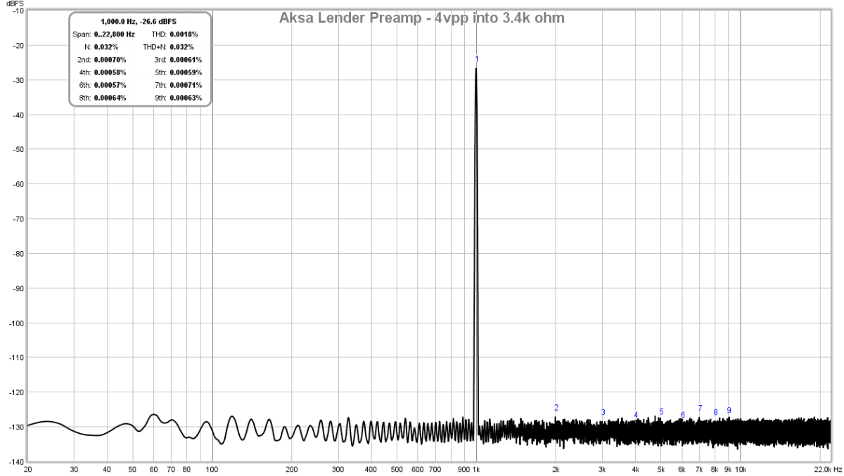

Here is FFT for 4v p-p into 3.4kohm load:

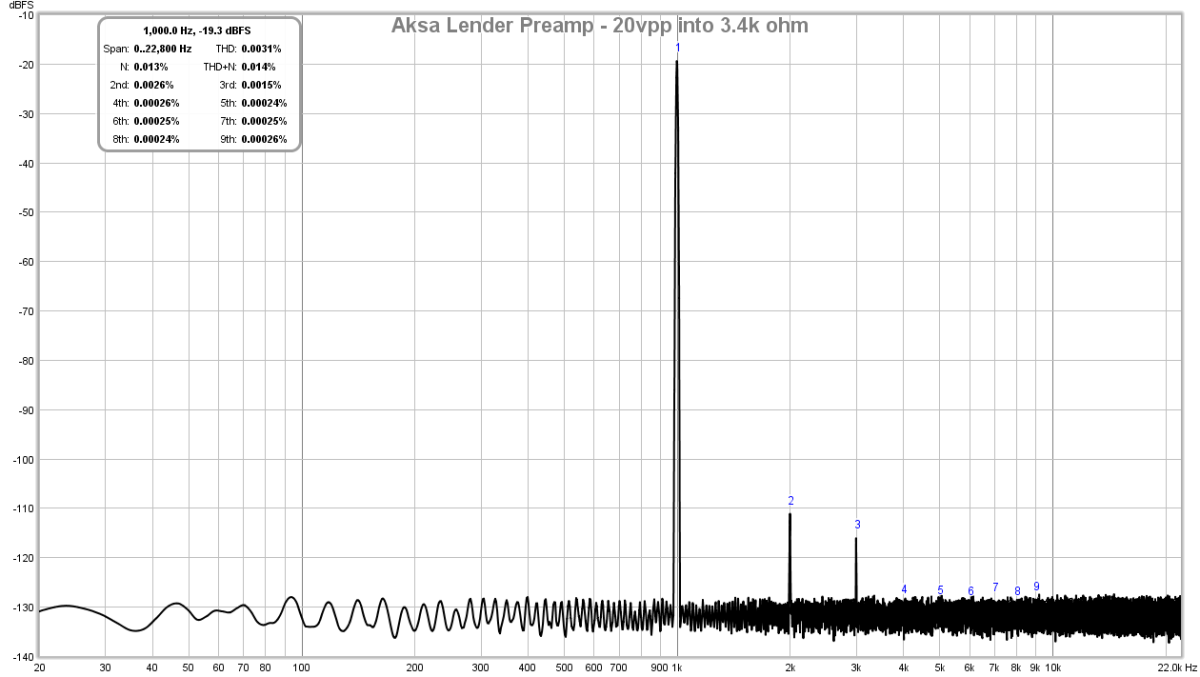

Here is FFT for 20v p-p into 3.4kohm load, still very admirable performance:
Here is FFT for 36v p-p into 3.4kohm load, here the H2 and H3 are about the same and any higher in amplitude results in clip:

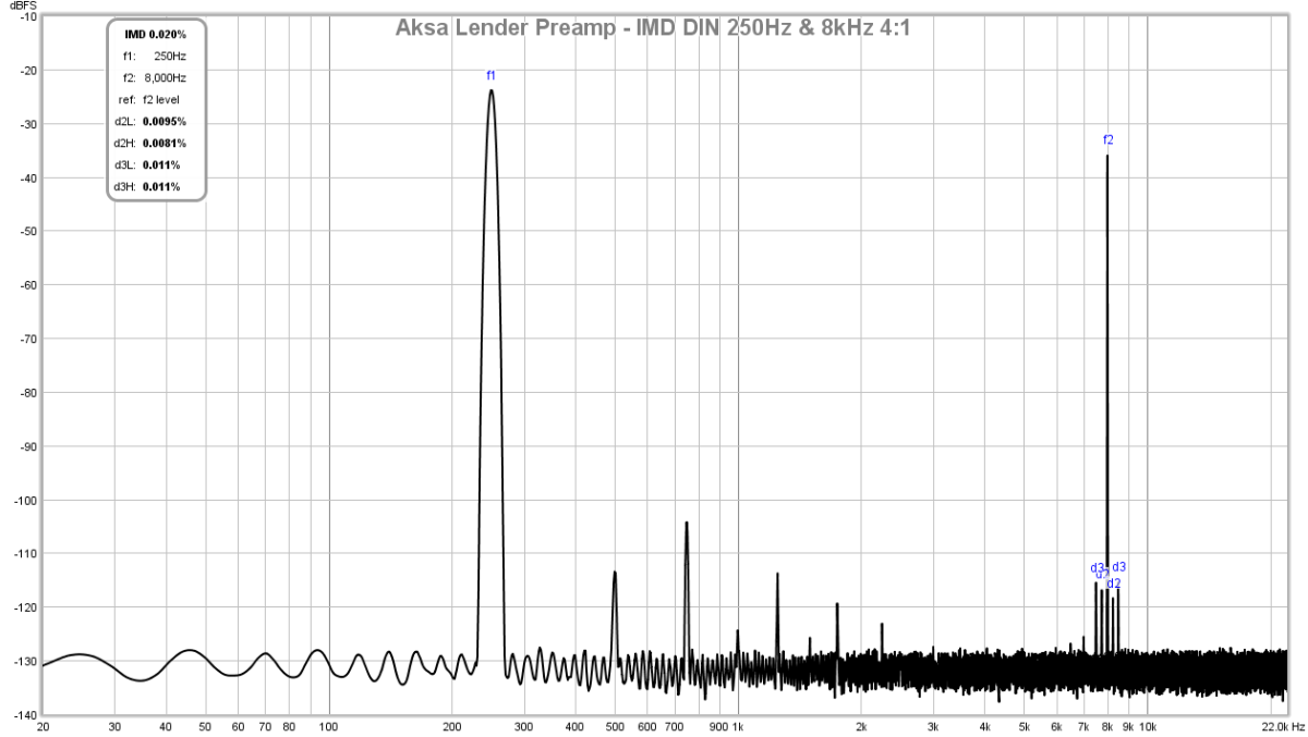

Here is IMD (DIN standard 250Hz and 8kHz 4:1) for 20vpp into 3.4kohm yields 0.02% IMD:
Here is IMD ((DIN standard 250Hz and 8kHz 4:1) for 20vpp into 25kohm yields 0.01% IMD:

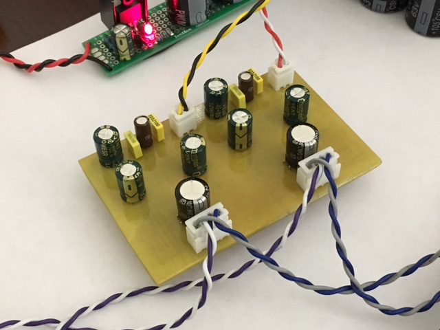

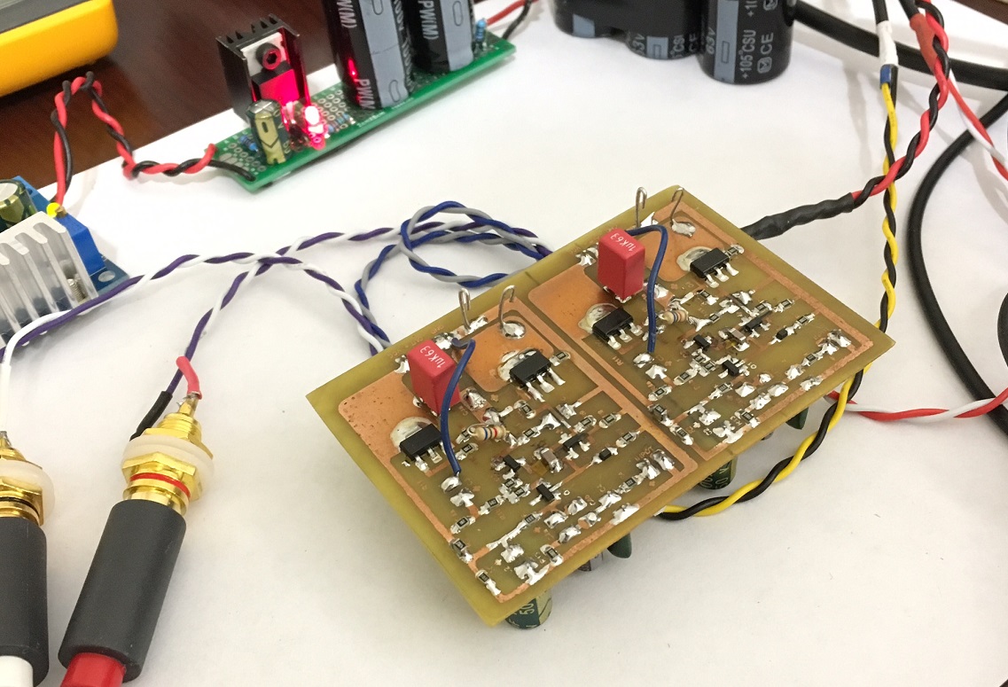

Edit Nov 17, 2017: Here is the final design laid out in SMT with exception of 1 resistor (R10) is a carbon composition and you can find out why here. The feedback resistor is 6k8 and the LTP emitter degeneration resistors are 47R. I am now getting -85dB for H2 and -100dB for H3, and nothing else. It is a superb sounding profile - engaging, great dynamics, full of energy yet natural sounding. Here is 20vpp driving 7kohms. Noise floor is deep deep black with no hint of any mains peaks.
Preamp looks like this:
Other side:
I love how it sounds. Sublime.

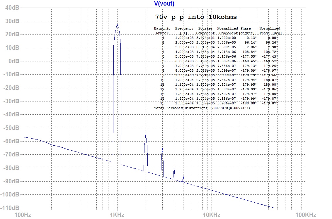

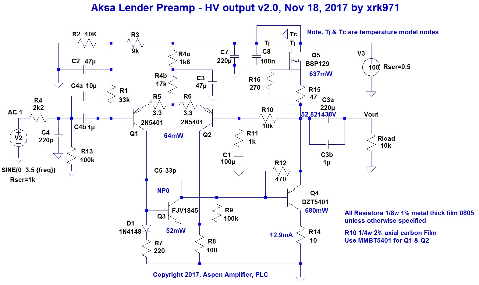

Edit Nov 18, 2017 - perhaps the title should be modified to 70vpp? Here is a recent simulation with 100v Vcc showing a nice result for 70vpp output into 10kohm load with a 20dB gain setting on the amp. THD is predicted to be 0.0077% with a nice profile.
To do this requires changing the input LTP devices to MMBT5401 (or 2N5401 for through hole builds) and adjust R4b to 17k to keep 2.5mA current in the LTP. Change the degen resistors R5/R6 to 3.3ohms, and R9 to 100k. Make sure all electrolytics are revised to handle max voltages of 100v on rail and output node and 63v elsewhere.
Here is schematic v2.0 for the HV amp:

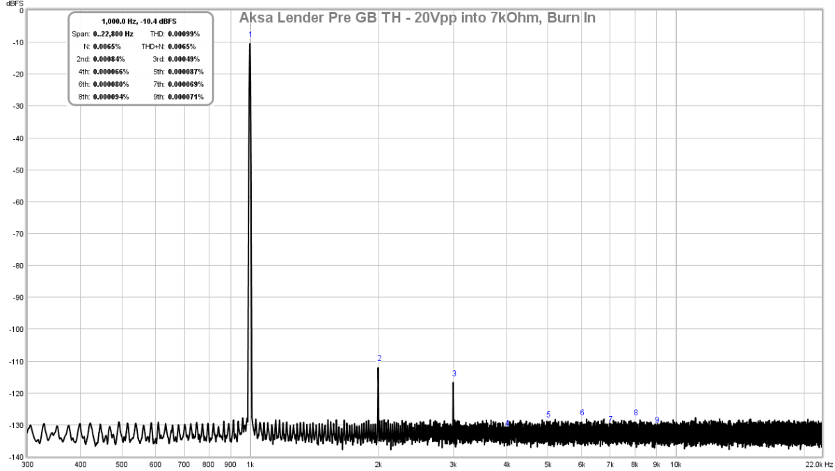

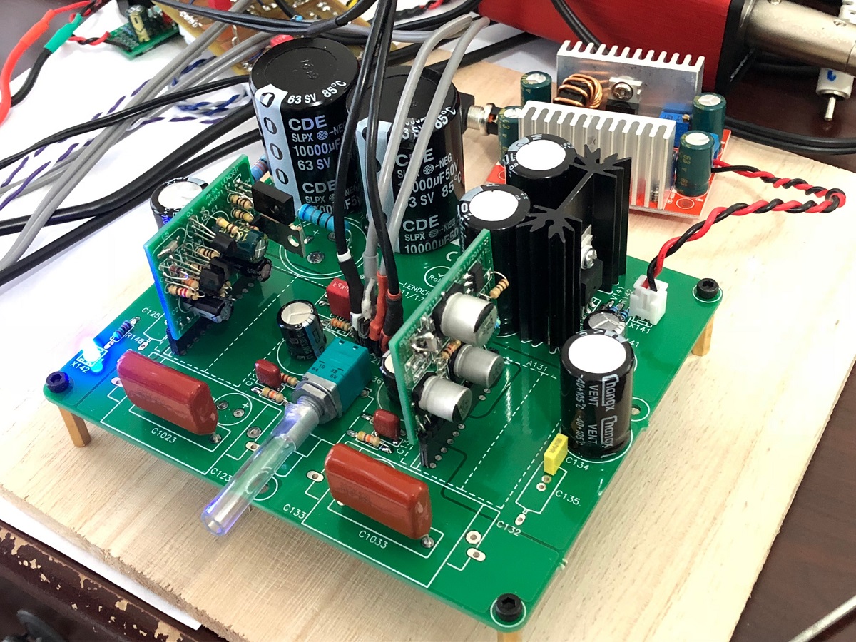

Edit Dec 10, 2017: GB boards verified to be working. Here is MB with TH and SMT daugterboards installed.
Cloesup of SMT board:

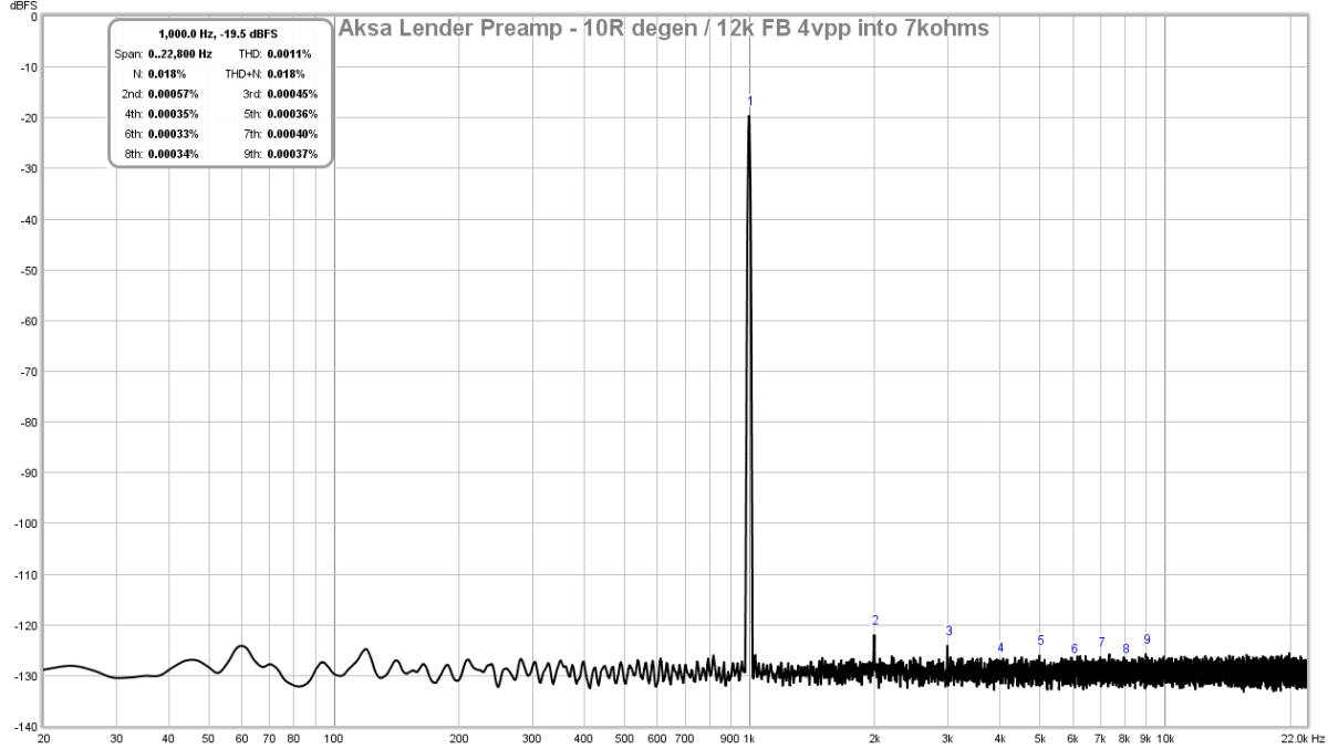

Here are measurements from the TH and SMT boards:
TH has 0.001% THD for 20vpp into kohm load:
SMT has 0.0012% THD for 20Vpp into 7kohms:
http://www.diyaudio.com/forums/soli...lender-preamp-40vpp-output-5.html#post5242398
Other side:

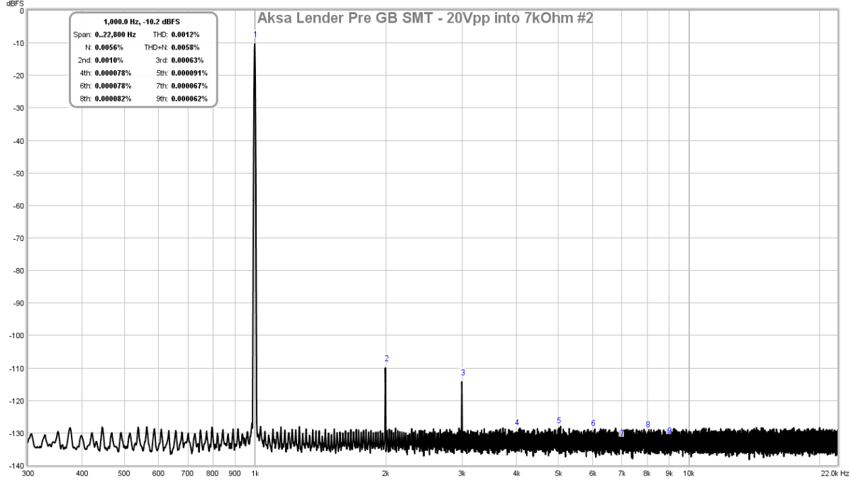

Try using the Blackman-nuttall window selectable in the FFT dialog. It will push your drift floor down a bit more. You could also make C1-C4 100F.
In LTSpice or in real circuit? I don't have 100F caps so probably the simulation
Thanks for the tip. I was trying to model the as-built components.

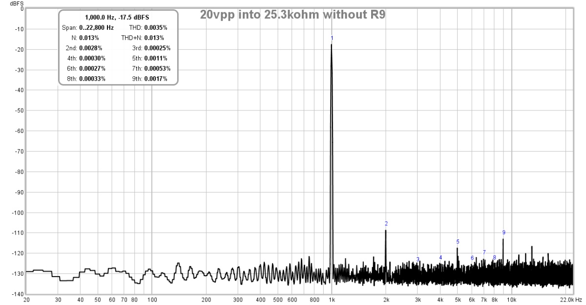

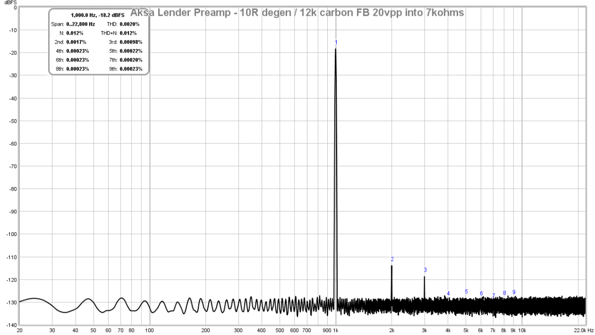

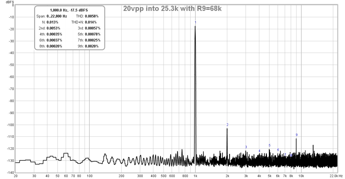

You never expected the THD to be so low, and I tried your suggestion of removing R9 to see what happens. Here is an FFT with R9 and without it - I literally cut the leg of the 68k resistor in the live circuit so that I could see definitively the effect in real time while watching the FFT. For 20vpp into 25.3k load, the THD was 0.0058% with R9 and 0.0035% after I cut R9 to remove it. The profile is still H2 dominant but lower overall THD. However, it places the level of the H5 and H9 higher relative to H2, albeit the levels of all the distortion is quite low, near the -130dB noise floor of the Focusrite.
Let me spend some time listening to it without R9 and will let you know what I think of the sound quality subjectively.
FFT with 68k R9 in place:
FFT with R9 snipped off:
Beutiful result!
Can someone explain why we choose P devices in the IPS?
I asked same question 3 days ago under the link below where a similar schematics was presented by Zen Mod (~4 posts above mine), but no answer yet.

Output is low impedance (<5R), but limited to 12mA CCS. This can nicely drive a small output stage, single ended or PP. The buffer, Q4, could be made a FET or even increase current to 30mA. That would boogie!
UT, if you use pnp for the LTP, it mandates npn VAS, and my experience is that npn VAS has lower parasitics and greater GBW than pnp in the same role.
HD
HD
Also generally PNP in LTP gives lower current noise, doesn't it? Reason why a lot of phono preamps were designed that way. Not sure if it matters here with signal levels involved. Ofcourse, as Hugh said, it also allows for NPN VAS which is just what you want for its desired characteristics.

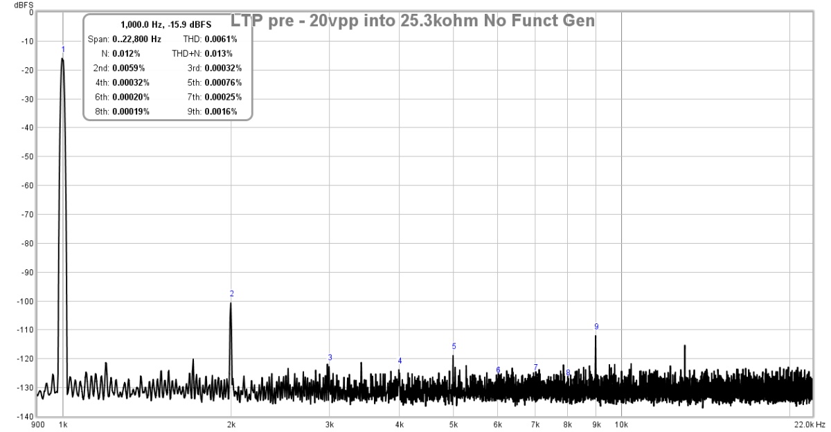

Yes, and the 5th is way too high - maybe some measuring setup artifact ?...why is there that ninth ...
Using PNP LTP in single rail PSU circuit is good for the PSRR too.
Anyway I'd lose Q4 and unstrangle Q3, let the LTP breathe, change CCS and at least bootstrap the tail of of the LTP. Gain should be higher so that weaker sources and/or quieter recordings can bring enough voltage swing at the output. Drive capability should stay about the same.
Roughly, something like this (R1/R2 divider might need some adjusting to ensure symmetrical clipping and freq.compensation should be checked in vivo. Practical details like PSU bypassing and similar are logical addition) :
I'm wondering where the 5th and 9th are from too as not in sim. I should change audio interface and PC to see if it clears up.
Juma, thank you for the suggested schematic. I don't believe it is the same topology anymore though. Have you simulated it yet? Looks interesting. It could be a headphone amp with a larger C2 and higher bias, as could Aksa' circuit.

However, what is shown in post#1 is not quite the Lender circuit. The original circuit, 'invented' by Rudolph Lender when he was at Motorola uses a different arrangement with two transistors. I do remember asking Hugh about it too...

Tried the Lender, simulated it also. No OLG advantage over a single ended drive to a stock common emitter VAS, and no discernible advantage sonically. However, it does combine some elements of CM, tending to force current balance in the LTP by adjusting VAS current. But this may not be very useful if the VAS current is fixed anyways, as it normally is.

Agreed, hence which is why I said "inspired by" Lender. Nice amp design the TGM4, what does TGM stand for?
