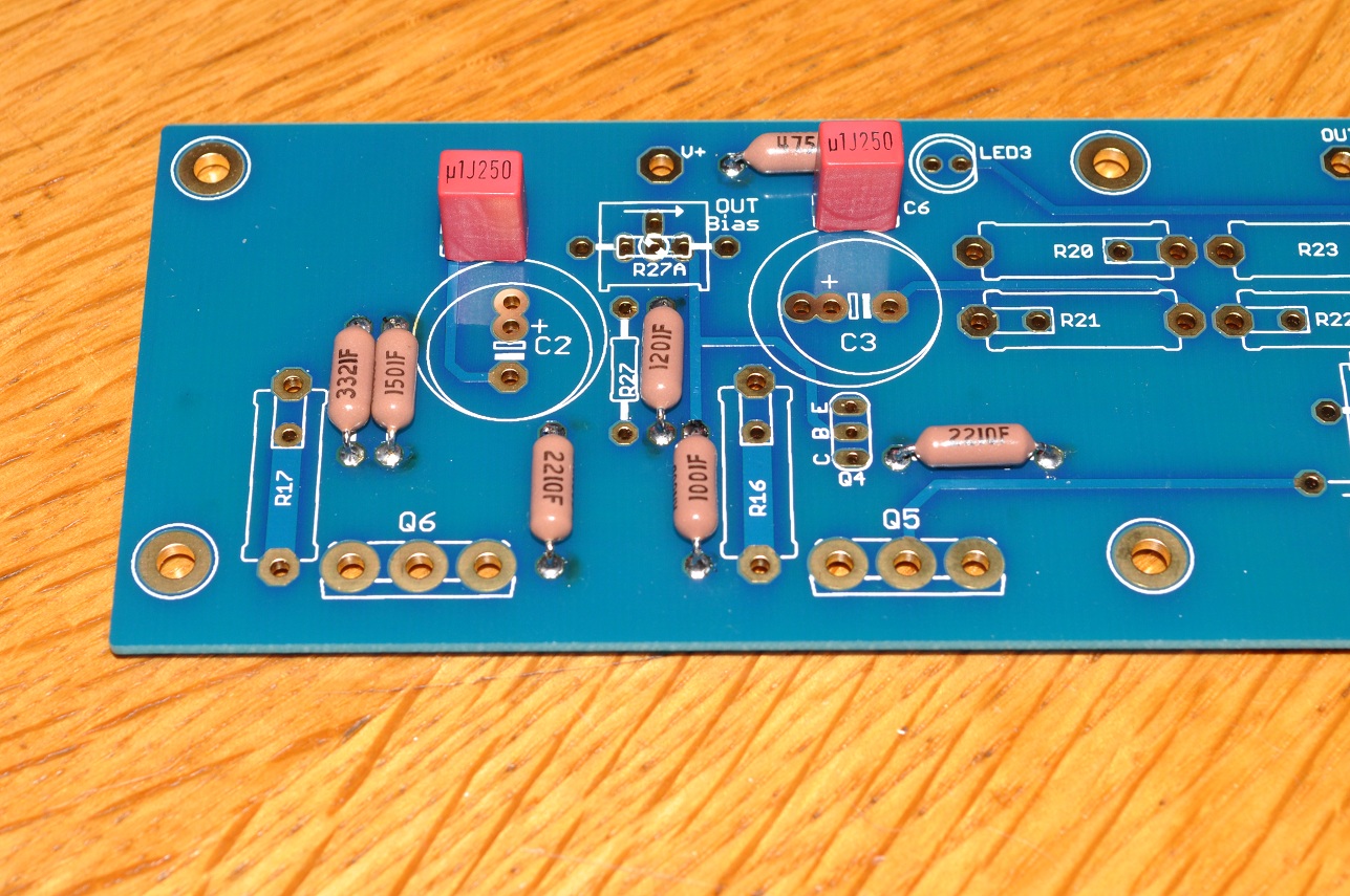

Also I see with the newest layout that the resistors around C2 is very tight if you are going to use the RN60D resistors. My suggestion to fellow solder slingers is to rather avoid that annoyance and use smaller resistors in these positions if they are super fussy about a neat layout.
I will post a pic later tonight. At the moment I have a few steaks on the barbie, so I can't do it right now.
Attached is a pic where one can see the tight area around C2. With the new layout allowing for a bigger cap things will be very tight when using that bigger cap, and with RN60 resistors might even be impossible to mount a bigger sized cap for C2. So beware.
There are a number of ways to avoid having a problem, the first is obviously to use smaller components.
But in lieu of that, the resistor can always be mounted higher and bent out of the way, or
You could mount it soldier-style and have only the thin lead on that side, or
You could mount that resistor on the bottom of the PCB.
All those solutions work well.
