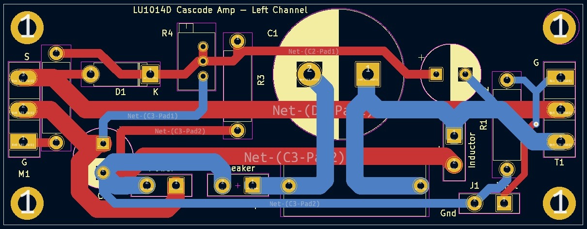

I've routed my speaker returns to the power supply ground (along a minimum loop area path) as well as just back to the output stage and I've had success with both methods.
My last amp build, the LD1014D follower, I used a circuit board for the output stage and returned the speaker ground to the ground terminal of the decoupling capacitor on the PCB. My test measurements at 1 watt output do not show excessive noise.

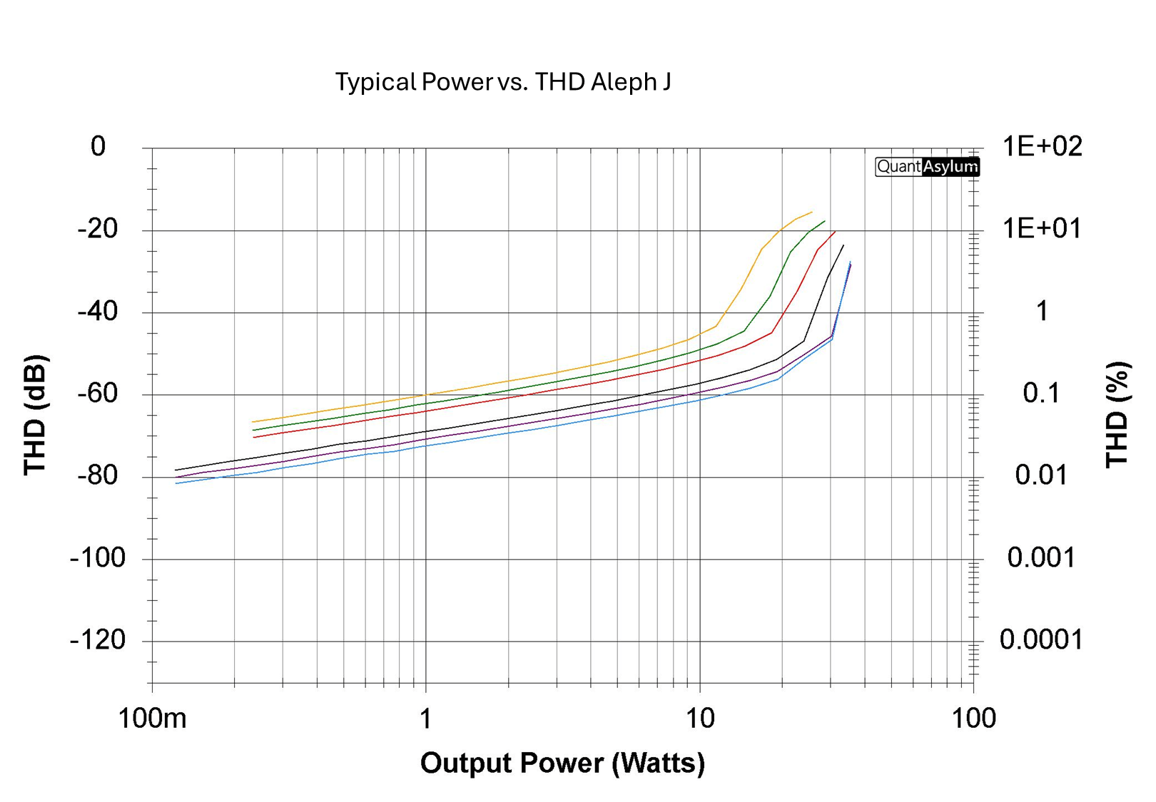

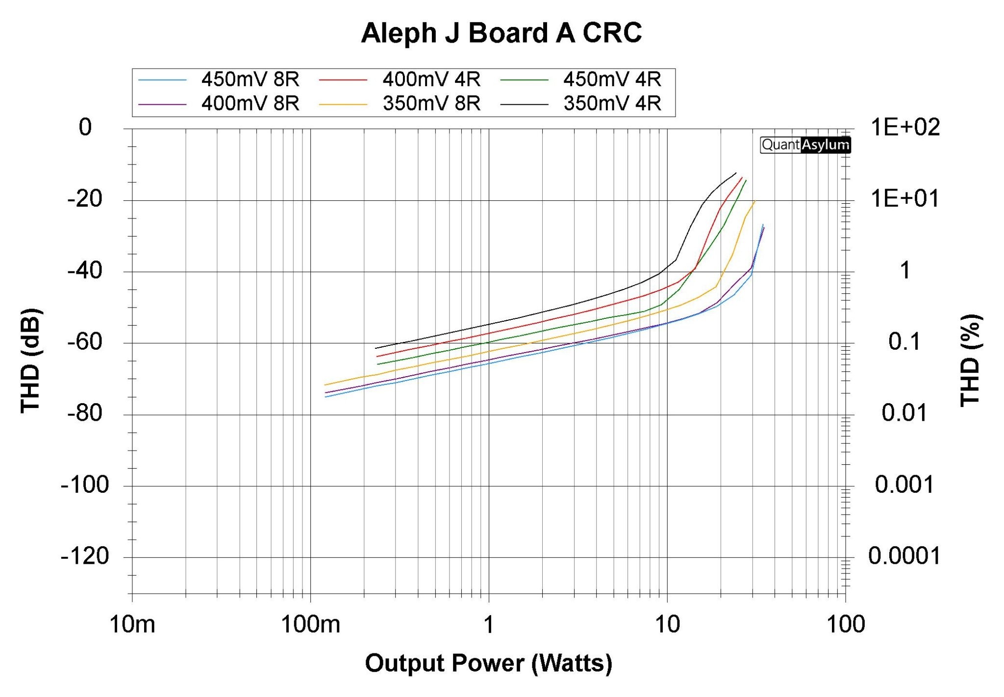

With that said, with a slightly different Aleph J, my ears and measurements match your experience. I have a variant running at ~2A bias current per channel, which is roughly the same as your "460 (warm)"

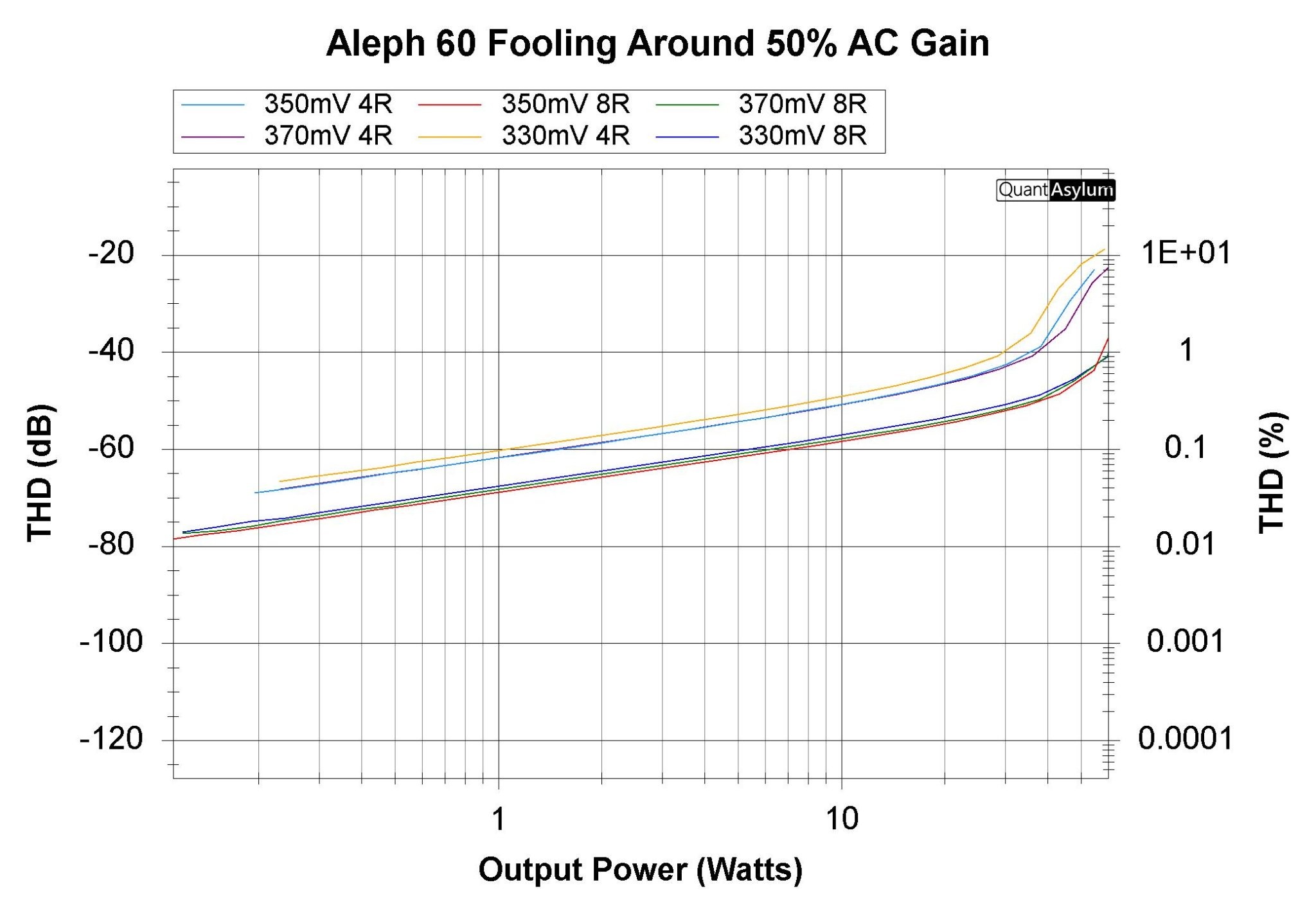

With every Aleph variant I've tested (several iterations of the J, and an A60 variant) the THD reduces with increased bias. Some iterations and variants more so than others. The A60 trends the same way, but my measurements (and ears) don't detect quite as much difference. I have no idea why, but it's fun.
Thanks as always for sharing your experiences. They're always on my list for things to try and learn. I've had swapping out my offset pot with a fixed resistor on my list for a while now in one of my builds. I may have to get off my rump and give it a go... even if I haven't the foggiest of clues why it acting like an I/V matters.
:cheers:
'Typical' AJ built with the boards offered in the store and with 'standard' parts. This was done rather quickly, I'm not sure that 4R trend beyond the knee would hold at the highest bias, but... ?
Another AJ variant. Same rough trend.
A60
Note - Should folks take any data I post as gospel, NO. Still learning. Posted for entertainment only. :)
