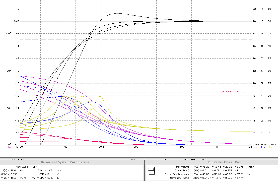

If I may ask your advice, do you think the 12PW would work well as a mid/bass driver in a sealed cabinet and partnered with one of the smaller Mark Audio drivers handling the mid and higher frequencies?
I was thinking of a 7 or 11 MS (or an alternative if you would recommend it) operating down to 200hz or so and then the 12PW working below that.
Assuming this word work, regarding the ’top driver’ what do you think the optimum sealed enclosure size would be and would you operate it full range of with a HPF below 200hz?
Ref the 12PW does it require a large sealed cabinet volume? Would it also be beneficial to run two per side in parallel or would the cabinet for this be huge?
Any thoughts on this or suggestions would be appreciate.

Sealed A12pw does not go as low as Joan/Pencil/other TL, but 30 Hz F10 is not at all bad.
Both Scott & i have done A12pw WAWs, except for the modular A12pw miniOnken, they all use ML-TLs. All use aperiodic midTLs (half [sealed] or quarter wave lines).
I would suggest a 4” driver like A7.3p7hd/A7ms if you want to cross that low. In my wide WAW the MAOP7/A7.3 is crossed at 200 Hz (but to twin SDX7eN. At these frequencies it almost becomes mandatory to biamp. A7ms strengths could really shine in this applucatiion.

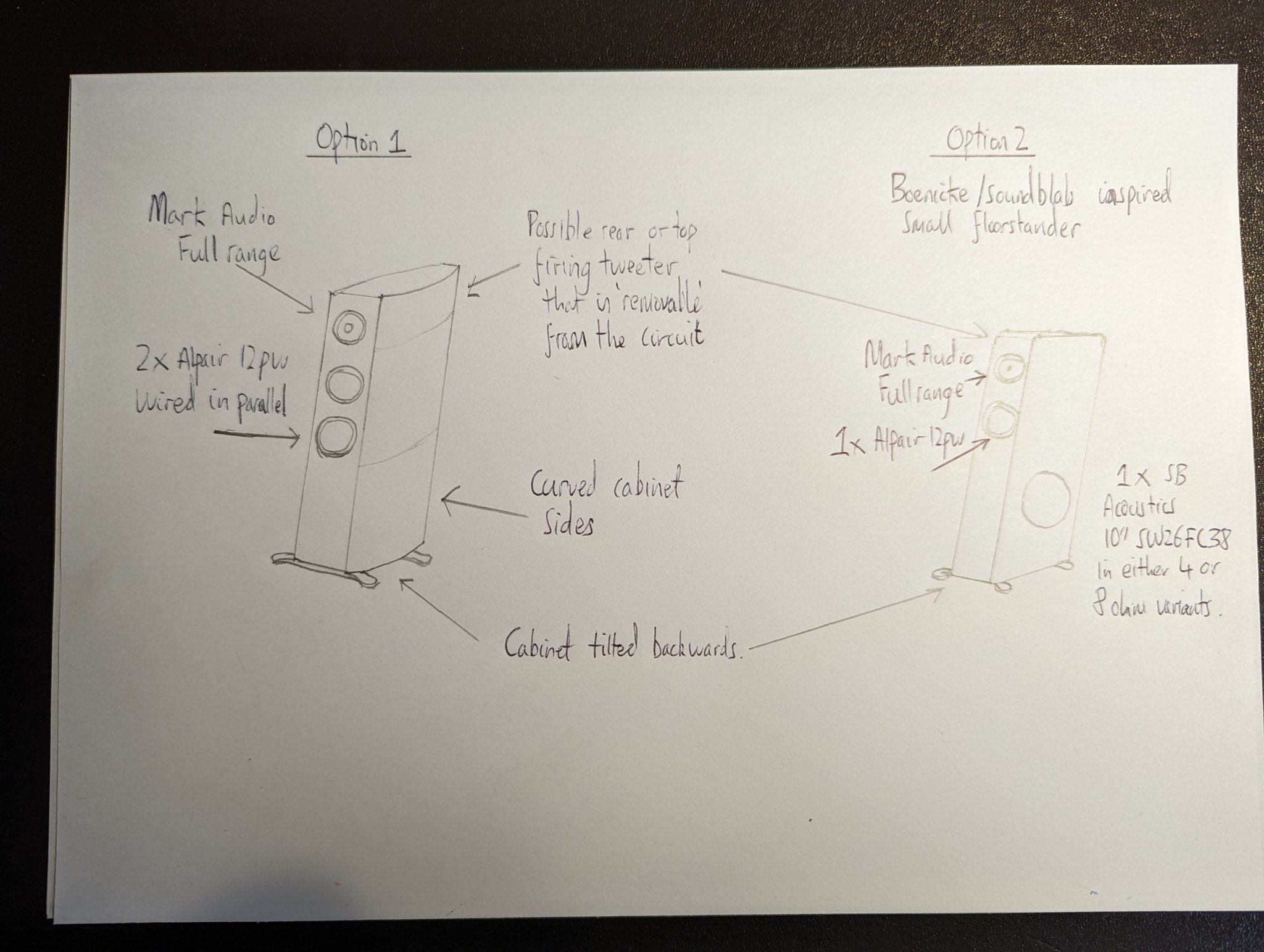

I have attached a 'proof of concept' of what I have in mind. Option 1 is a curved cabinet design visually inspired by some Tannoys and Sonus Faber. Option 2 is a Beonicke W8/W11 inspired design. Both would involve the woofers being driven actively. Clearly I need to do some research on cabinet volume etc. Regarding sealed Vs aperiodic for the full range, am I correct that the latter behaves like a sealed but also gives a slight dipole effect?

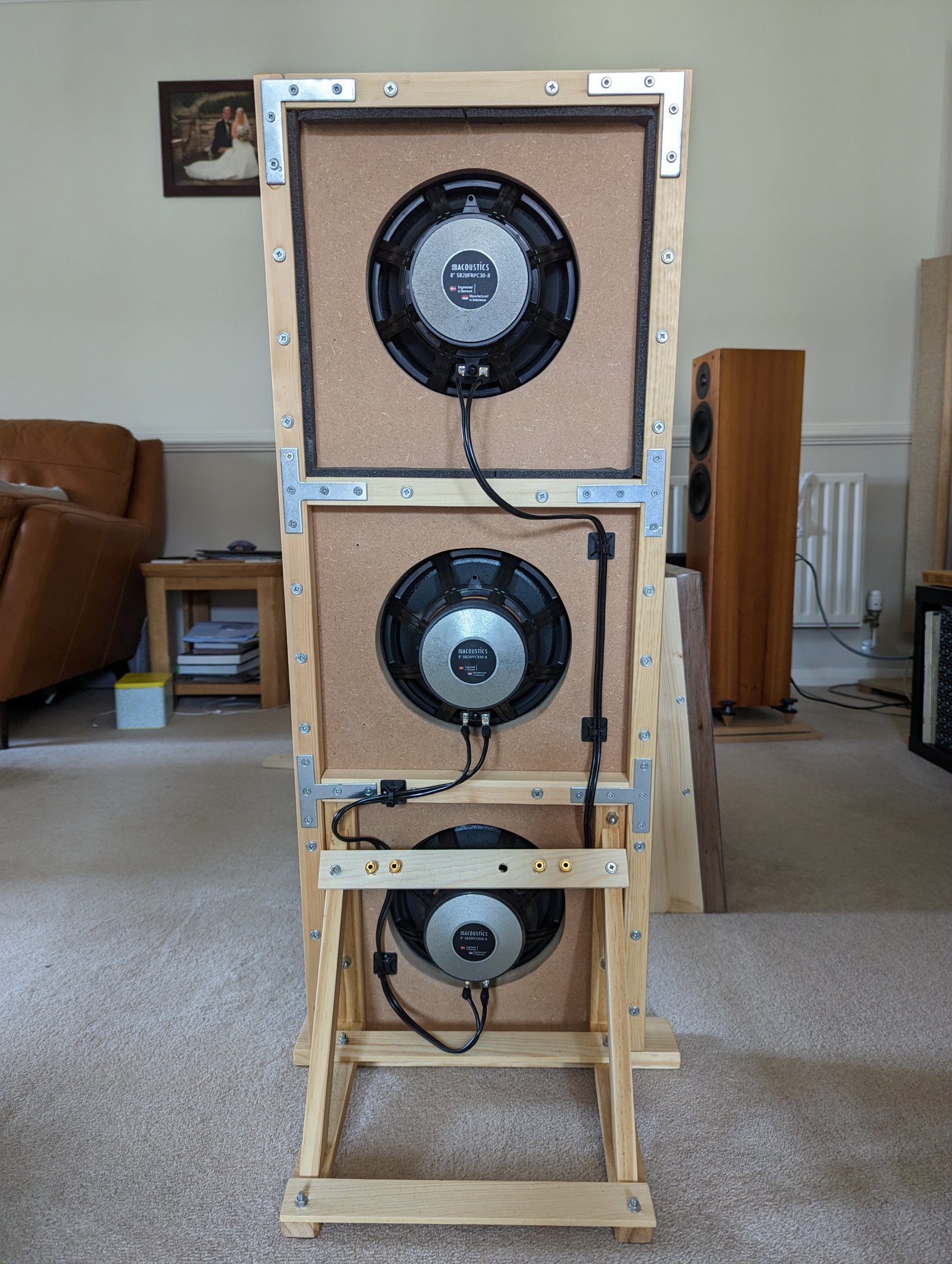

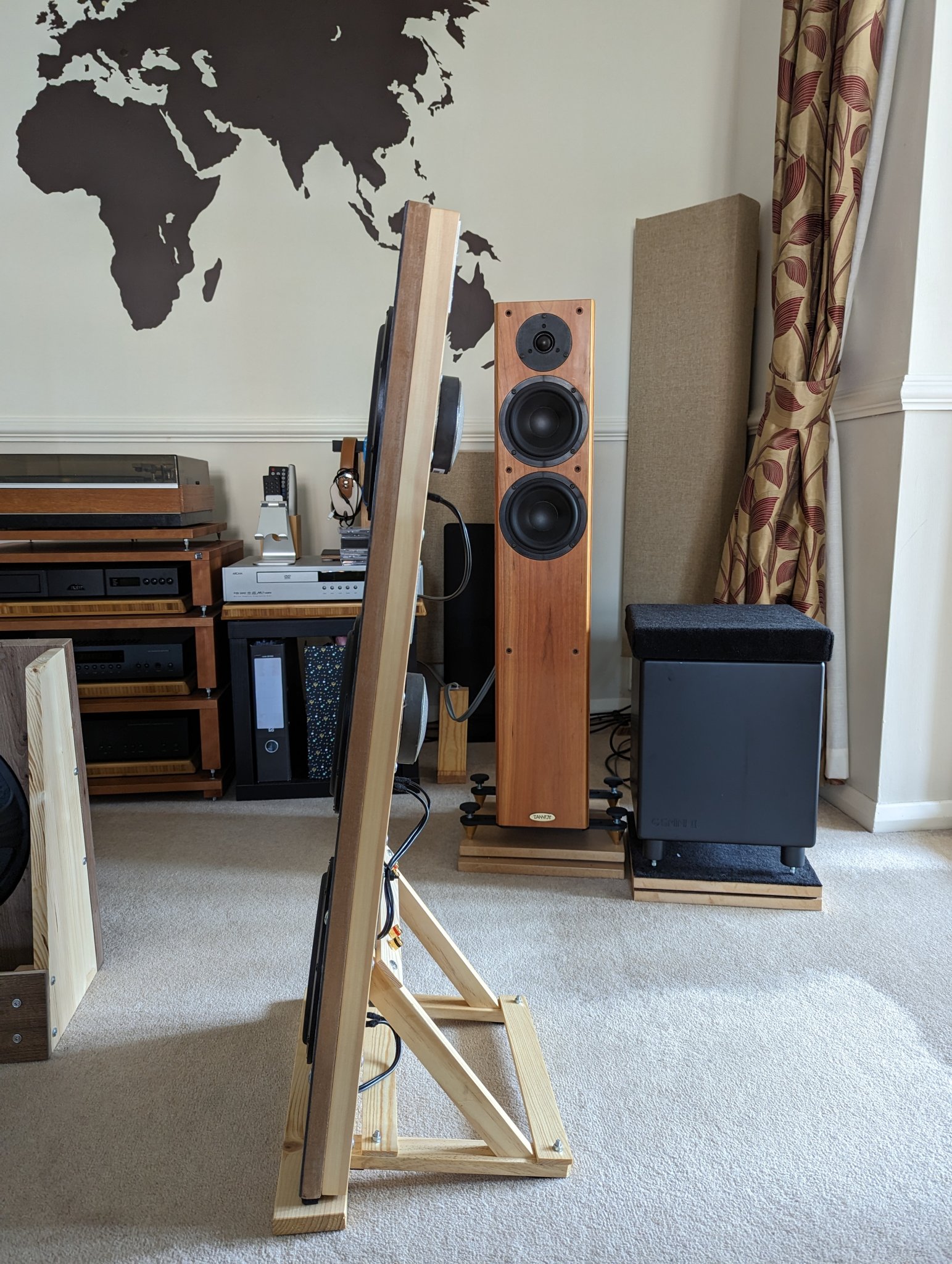

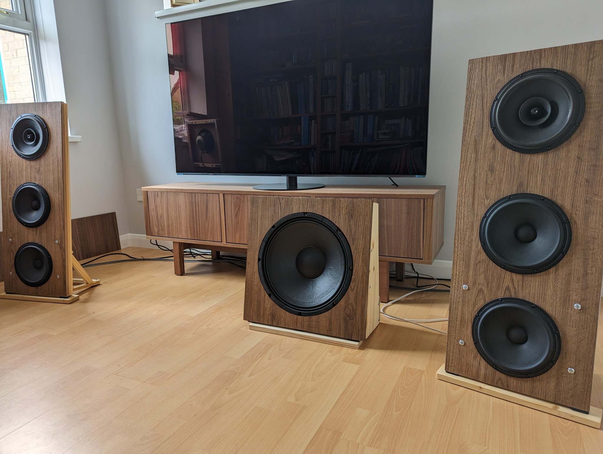

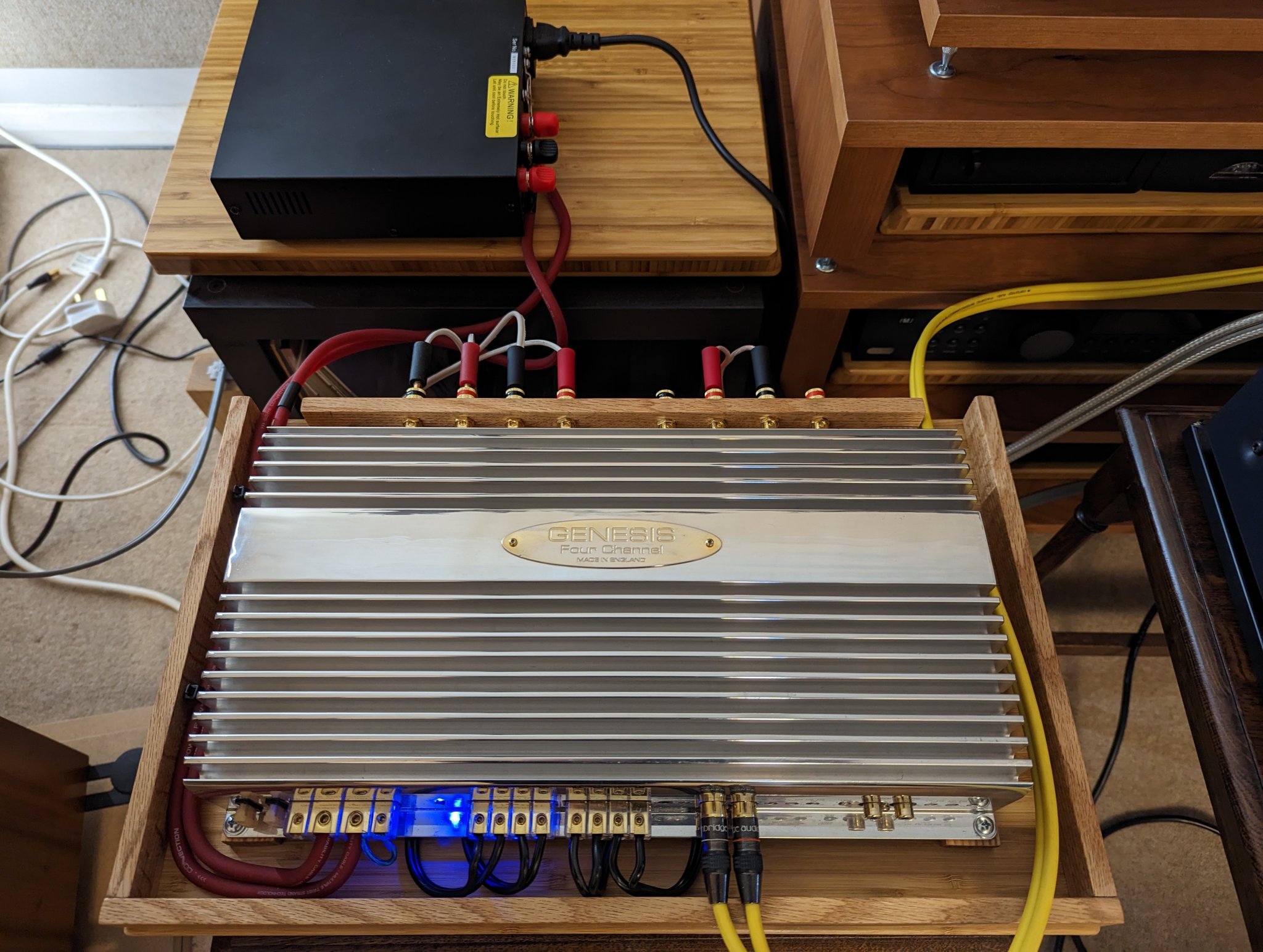

Regarding WAW I guess I have just built some, though open baffle. These involve the newish SB Acoustics 8 inch full range and the SB Acoustics and SB Audience bass drivers. The bass drivers are actively low passed at 180 Hz in the baffle and circa 80hz for the 15 inch. The bass side of things is managed by a high quality car amplifier from Genesis using a radio power supply. Probably not for everyone but I like the results!
