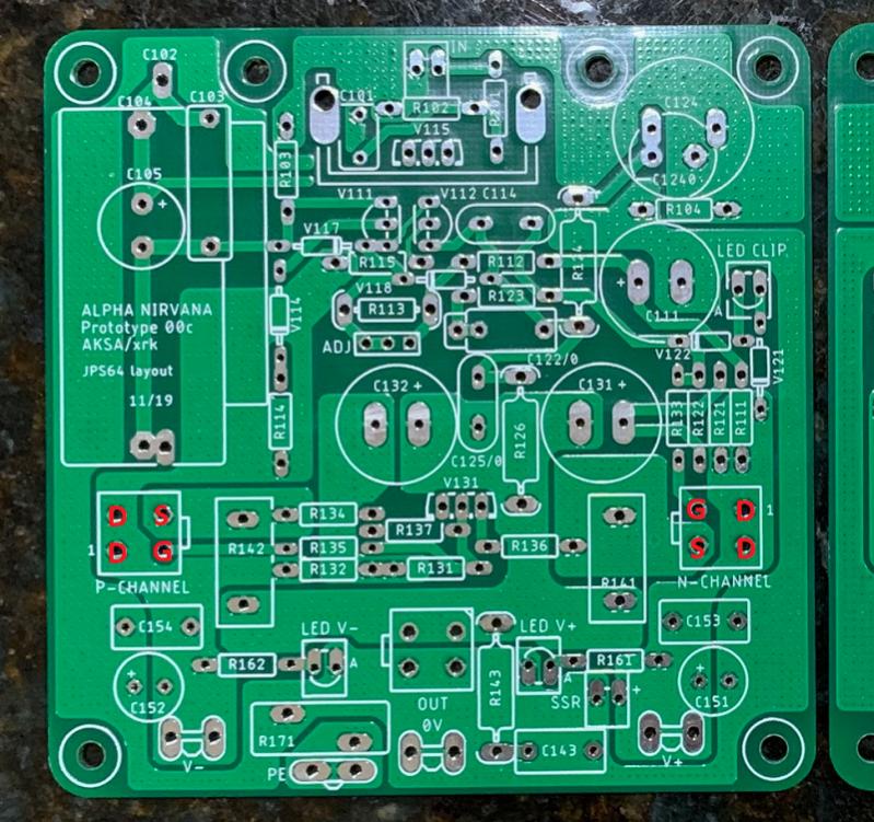

PCBs:
795976d1574122101-alpha-nirvana-39w-8ohm-class-amp-0b1b27aa-1350-49e2-a594-304e256b0462-jpeg
Production ones will be 2mm thick, 2oz Cu, ENIG gold finish, and Blue solder mask.

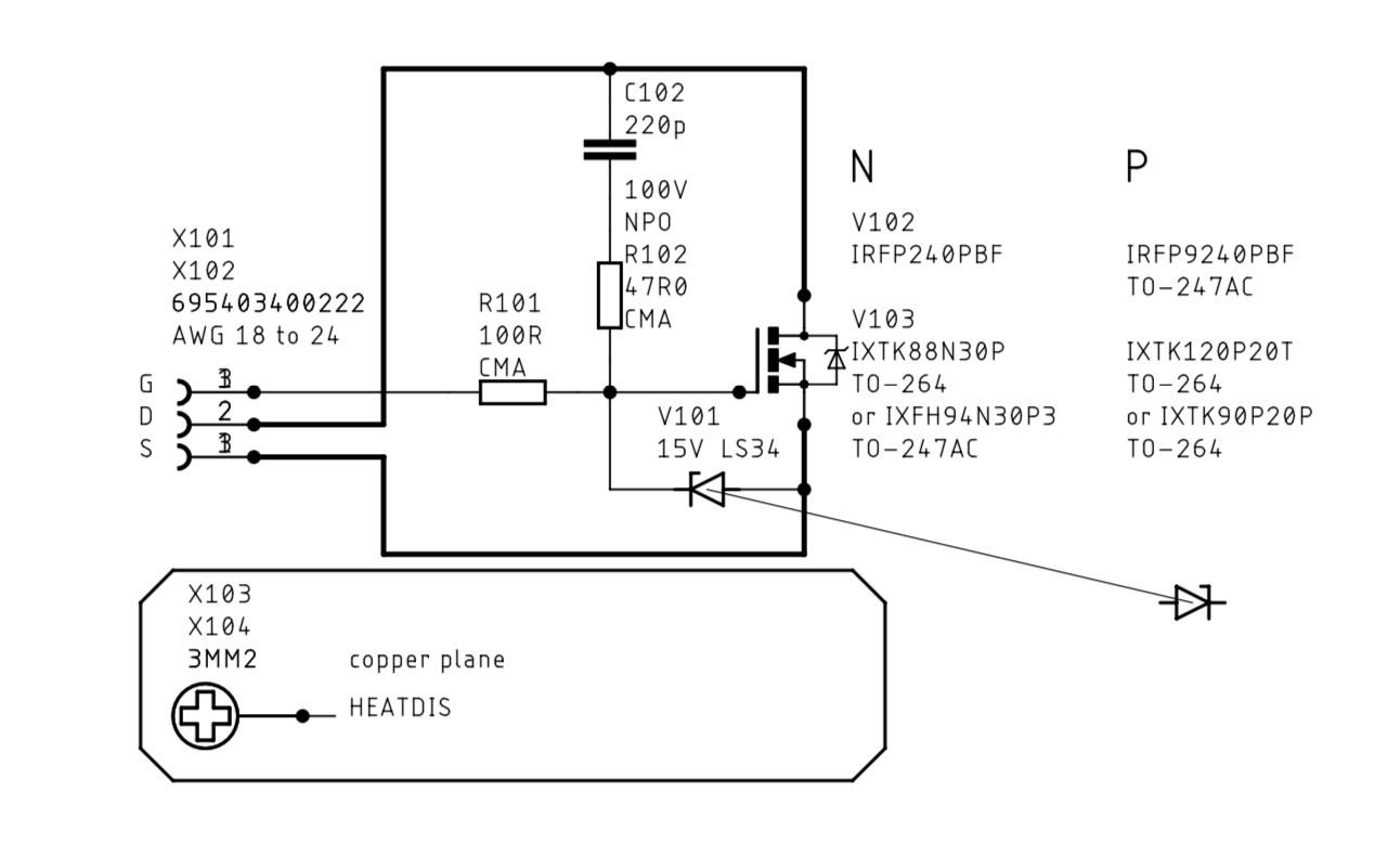

Schematic of snubber boards:
802740d1576585812-alpha-nirvana-39w-8ohm-class-amp-5783c1a2-a042-4257-b3bc-b51a85b88505-jpeg

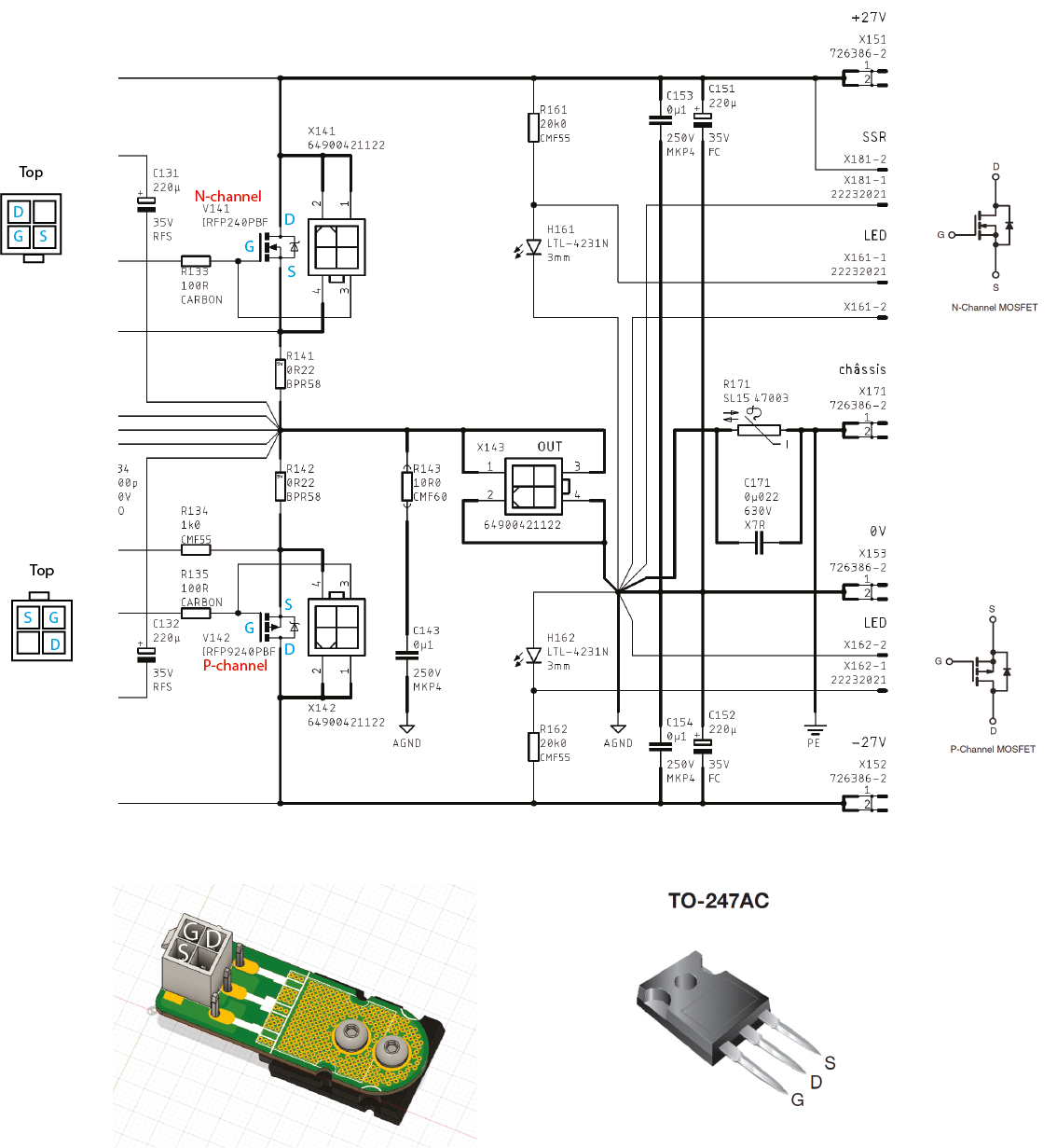

Edit Feb 7, 2020: Pin diagram for Molex quick connects to MOSFETs
815078d1581102749-alpha-nirvana-39w-se-class-amplifier-gb-alpha-nirvana-molex-pinout-jpg
Edit Mar 11. 2020: helpful pin diagram for MOSFETs
824010d1583864664-alpha-nirvana-39w-8ohm-class-amp-a_nirvana-png
