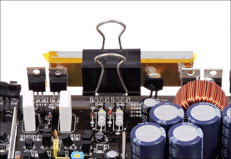

thank you for all your help. I am done with this amplifier. the configuration and the sandwich type boards and having to unsolder everything is very tedious. the fact that every time I want to look at something I need to unsolder 4 output transistors and 2 thermisters is a pain in the butt. I should have left it alone!! I purchased a pair of these on eBay. 1 still works, but I won't be attempting to mess with that one. obsolete parts are another factor I just don't want to deal with.
You could have used temporary heatsinks (1" x 3/8" aluminum stock, insulated with Kapton tape, and binder clips) and extended the wires.
You may not be able to get identical replacement parts but that doesn't make it un-repairable (not generally).
Don't throw it out. You may change your mind.

Hi Perry, I was never able to check for voltage. Pieces of the capacitor that exploded ended up stuck to an output transistor and started to smoke. the output transistor was not damaged lucky for me. After replacing 2 resistors and the 2sc2824 ... I now have a working amplifier I've played music through for 3 days. thanks again for your help... I will now attempt to recap fearlessly the 2nd amplifier.
