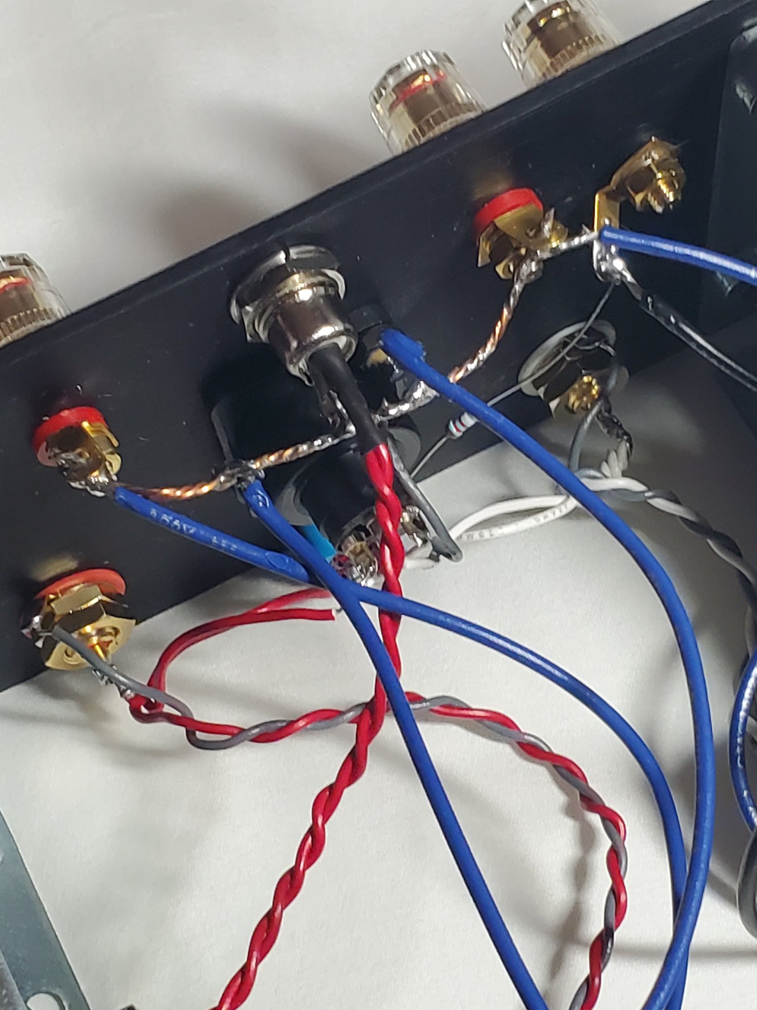

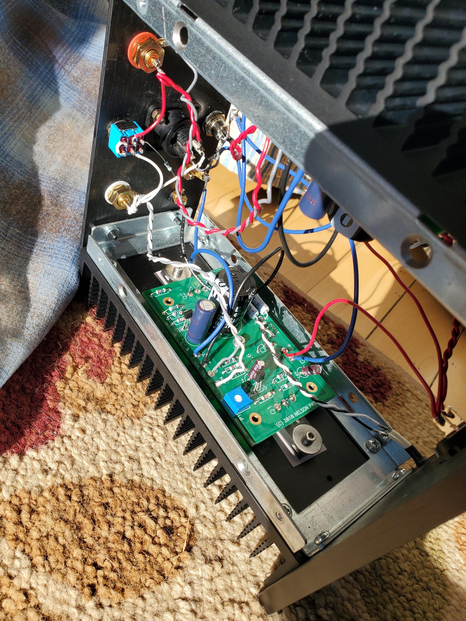

Continuity - I now have it from both inside rca conductors to their respective r11's ( had to re solder the right channel positive pin ) But I am having trouble getting it from from the common conductor on the left channel rca barrels to the bus wire. I think these were my issues. Still have to get the left channel input to ground. More checking underway. I did order some electronic Flux and some larger tips for my iron. I am learning which is a valuable byproduct of diy audio. Success is near. I was stymied by newbie mistakes, nothing at all wrong with the kit or build guides of course.

In this photo, you have the left and right inputs cross-wired to the opposite PCBs,
And the left RCA input pin is attached to ground input on PCB, and the barrel to input.
Has this been sorted out? (The photo is a few days old…)
Not sure what you are asking about continuity, something getting lost in the board?

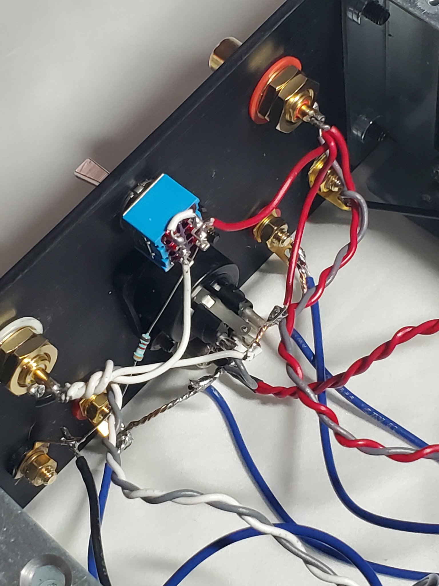

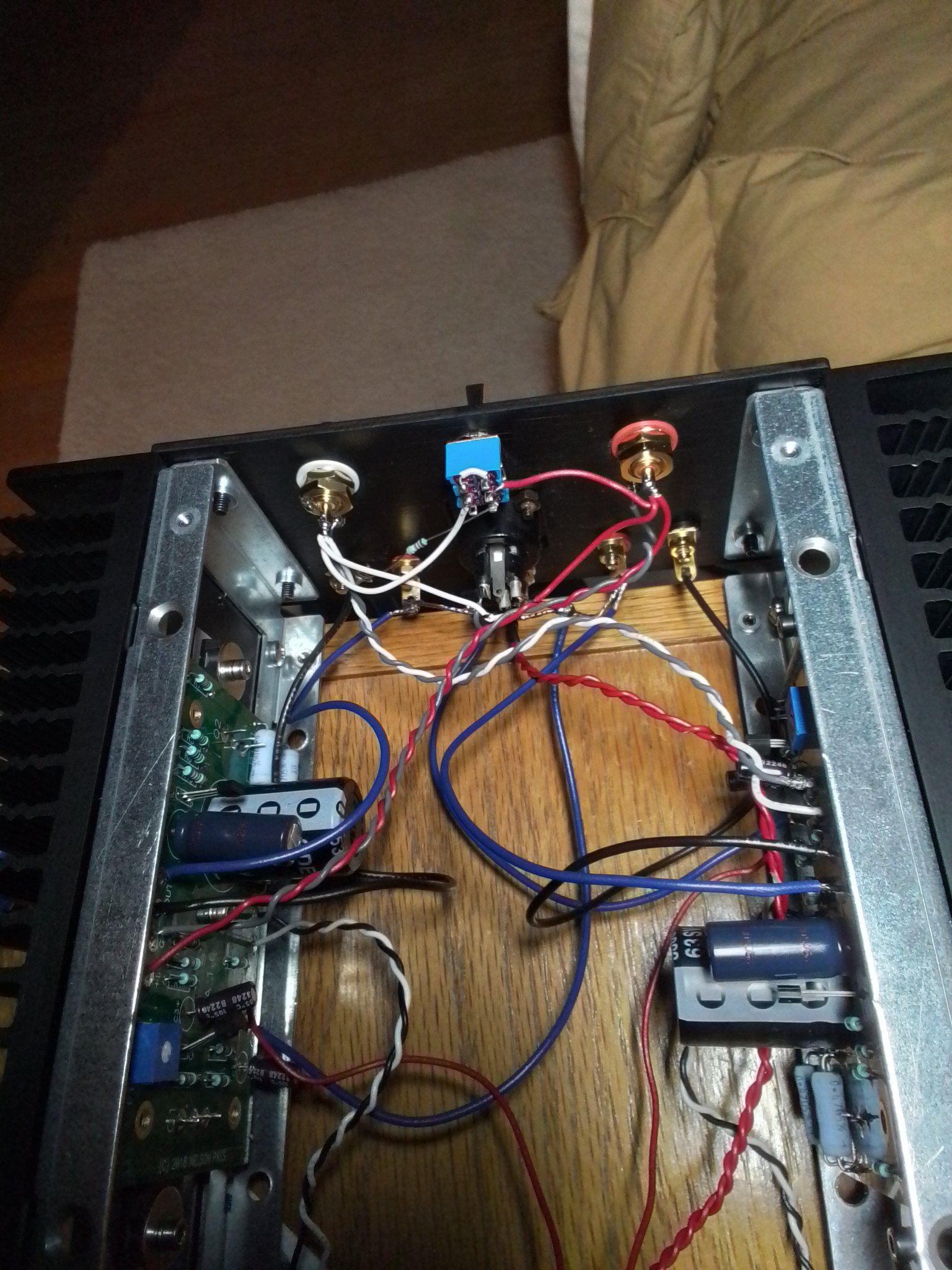

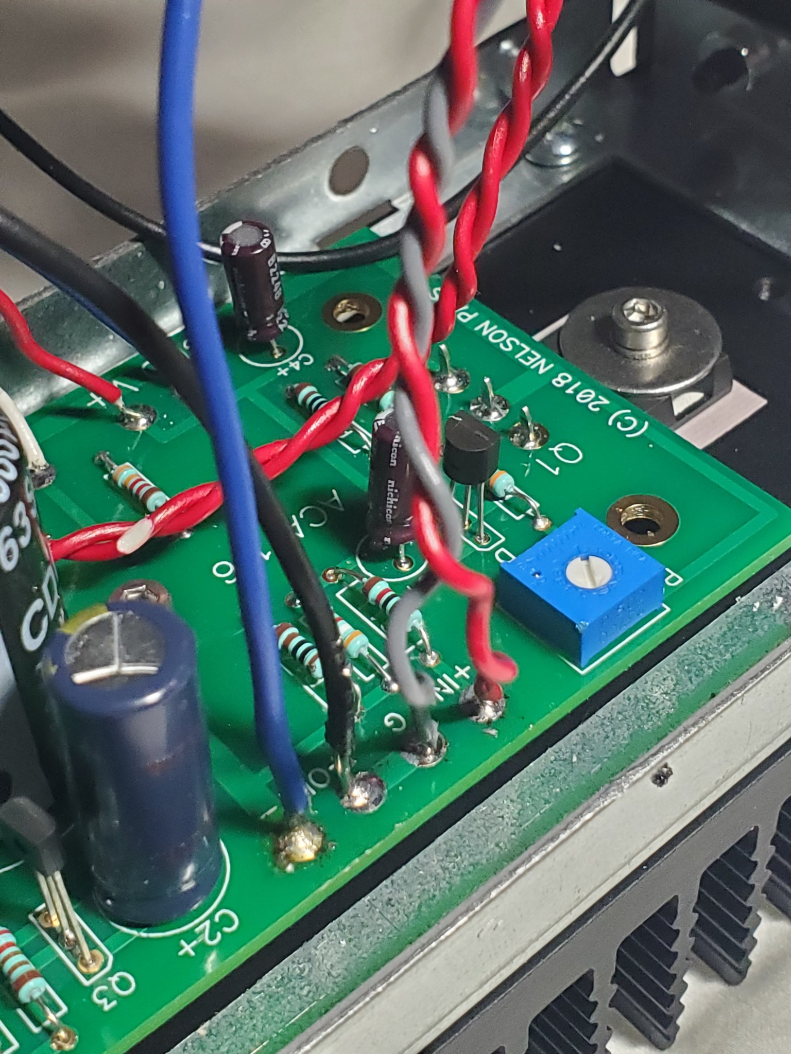

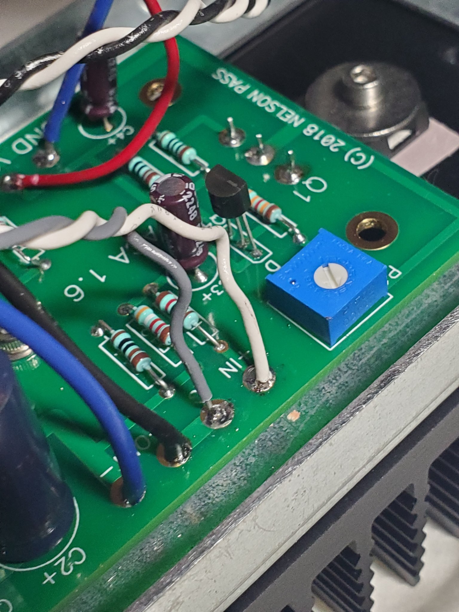

I am following the ground from the rca to the board. Near were it enters are the speaker outs. On the channel that seems good I get continuity on the positive speaker out. But not on the one I am having difficulty with. So I am losing the ground signal in the pcb before the positive speaker out. remember I had crossed the input leads to the boards so left and right are not correct. The problem is on input A's ground signal though it goes to the wrong board.

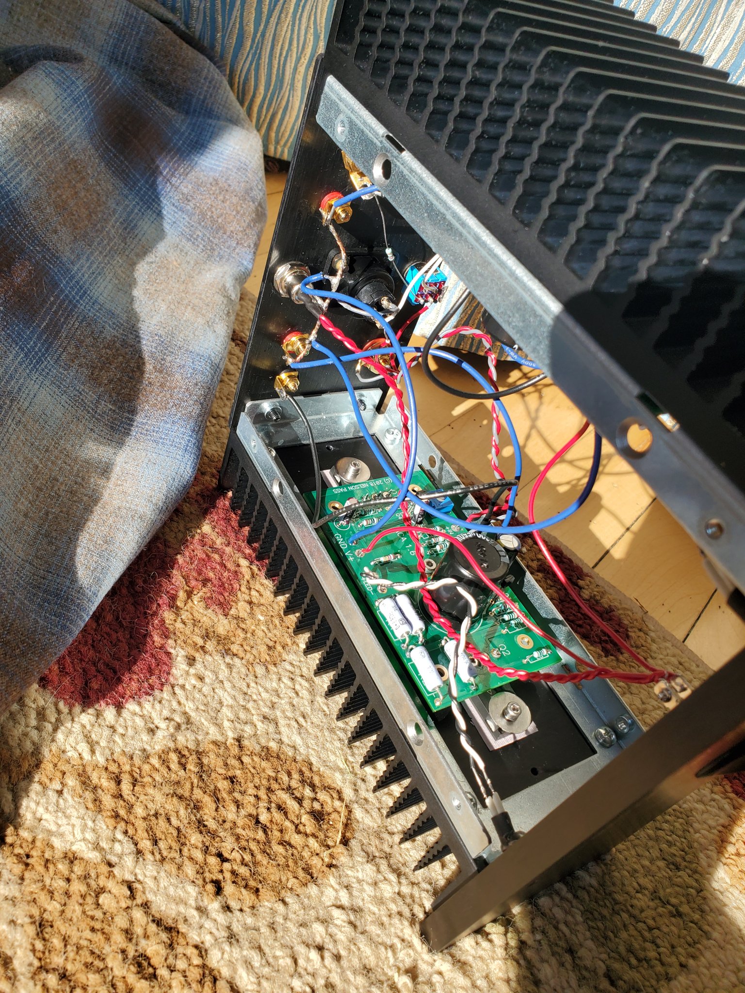

Ok, this is a head-scratcher for sure. Not sure what’s going on.
All the DC voltage measurements are good, so all the transistors are operative.
Do you have something shorting to chassis or heatsink underneath the circuit board? It’s worth a look…
Can you post a photo or two so we can see all the current wiring?
We’ll get this going, I promise.
